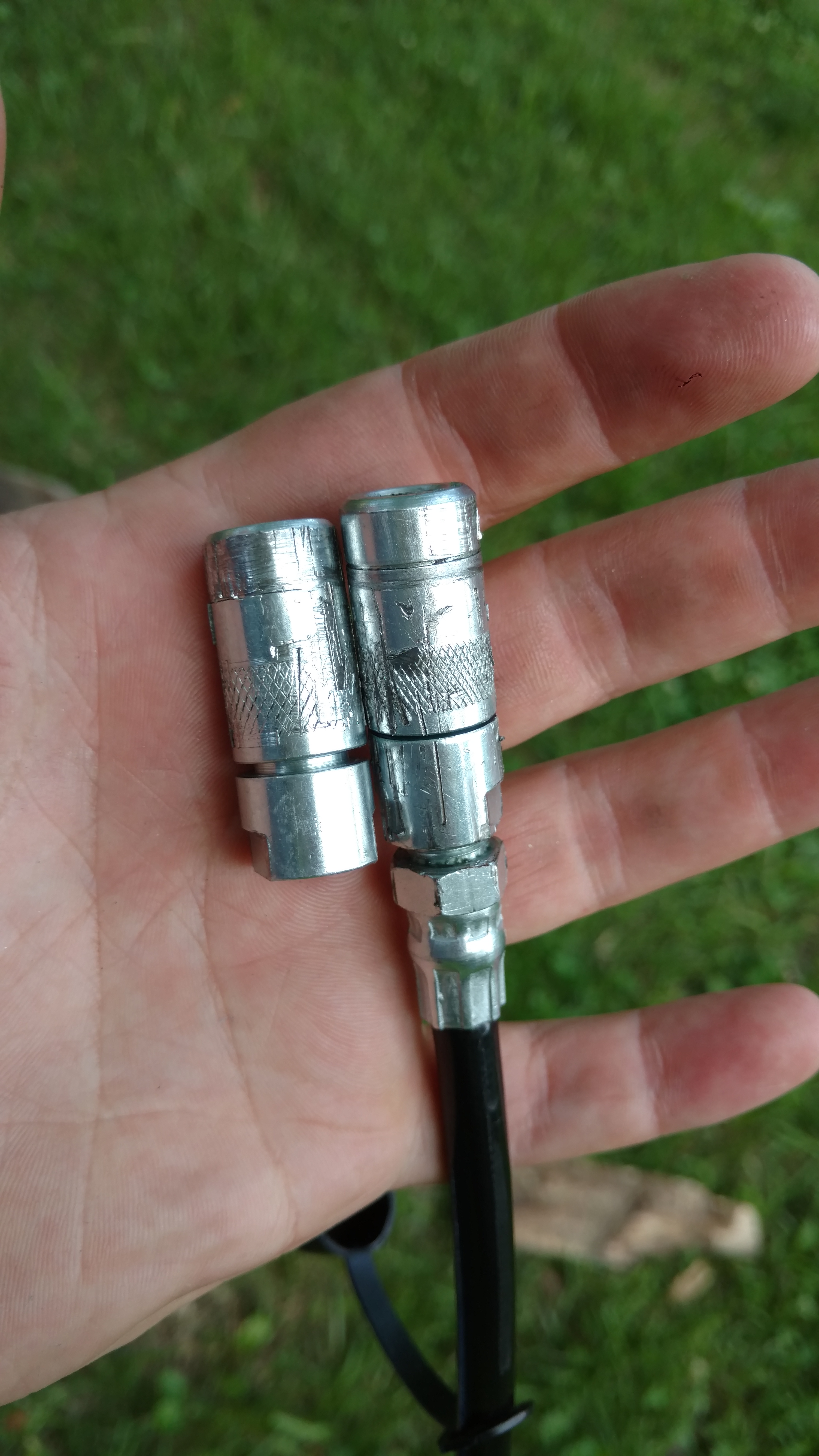

Remember grease gun nozzles are adjustable:. Loosen it a bit.
If you still have questions: please read this thread.
http://www.tractorbynet.com/forums/...ase-gun-screwdriver.html?highlight=grease+gun
Thank you! I read some of that thread. Looked at the two nozzles I had (different brands) and was still stumped. I showed my wife and we got a vise grip and wrench. After mangling the nozzle some more I finally got it to turn. I don't know why they tighten it so much, but it is ridiculous! Now I can grease the recessed zerks.

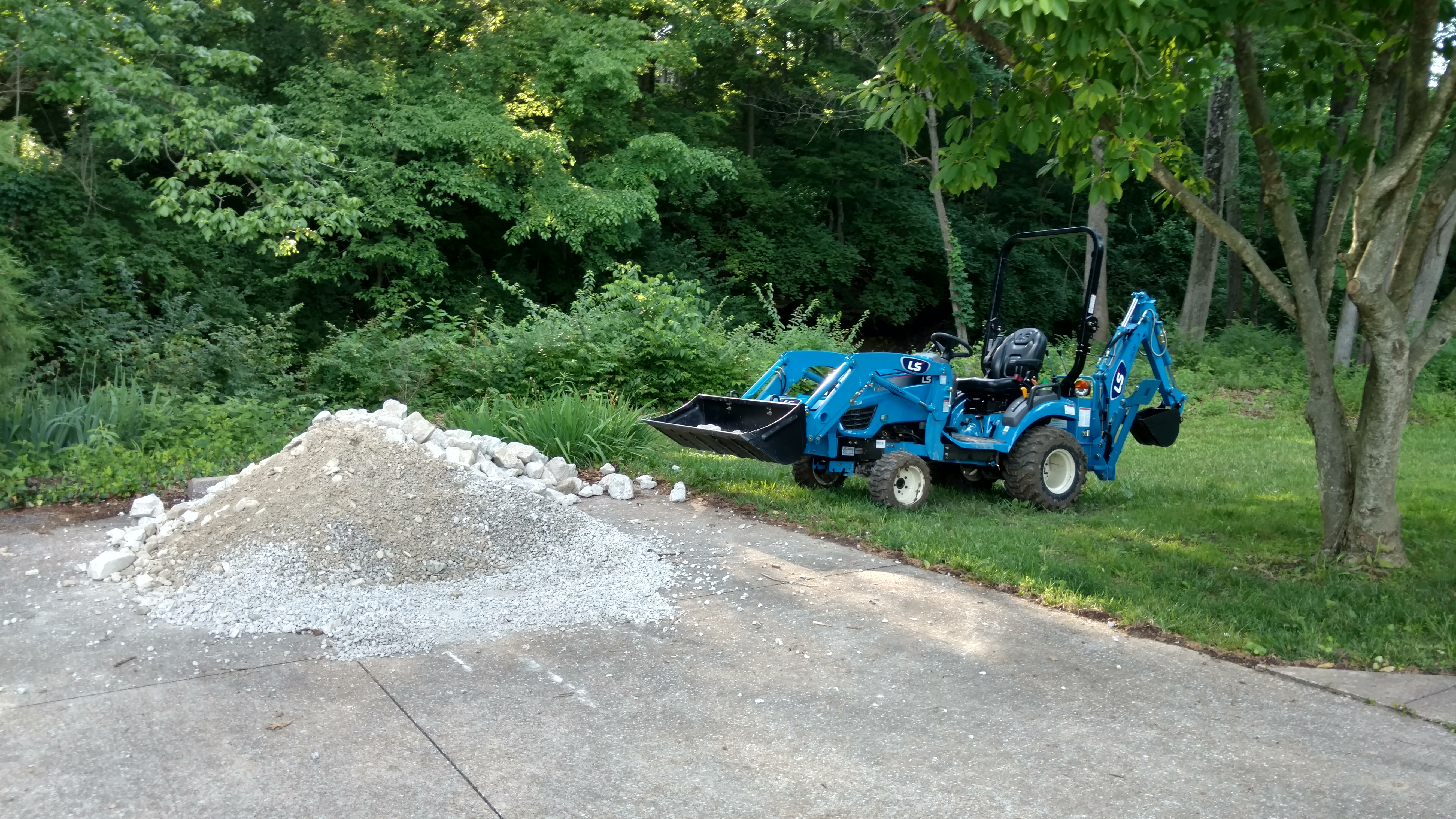

I had 4 tons of rock delivered. The MT 125 was able to scoop up a full bucket of the 1 inch clean. We only did that twice, most of the time we were taking about 3/4 full loads. Not lifting to full height except to settle the rock even in the bucket. Still getting used to the loader and trying to reduce the jerkiness when making adjustments. I move or release the stick and the whole tractor jerks. The backhoe seems to be adequate ballast for this work.

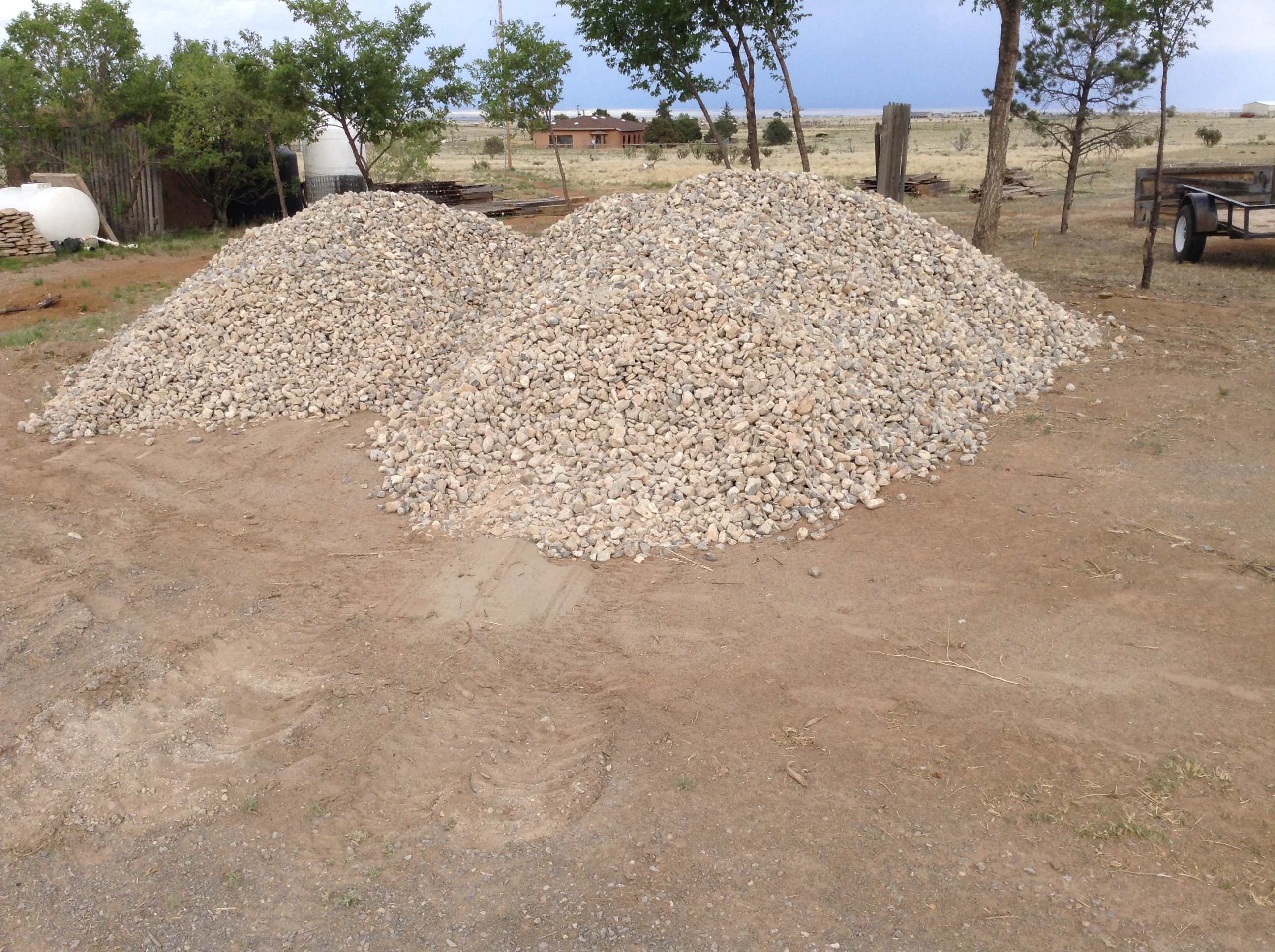

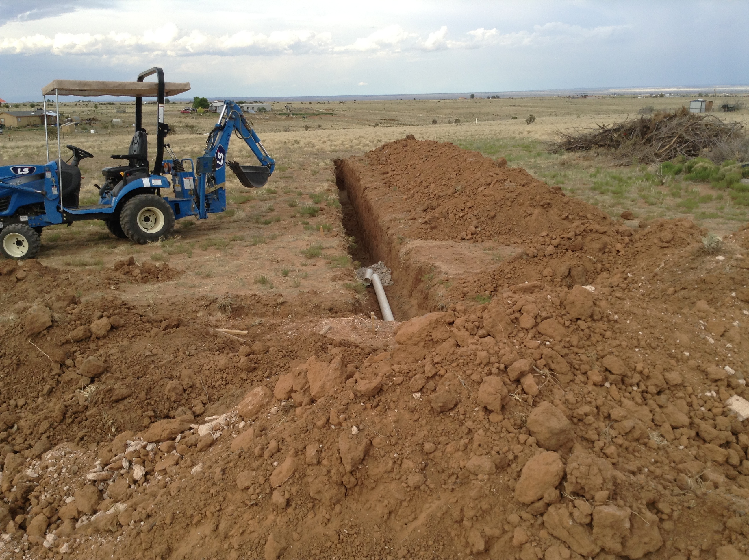

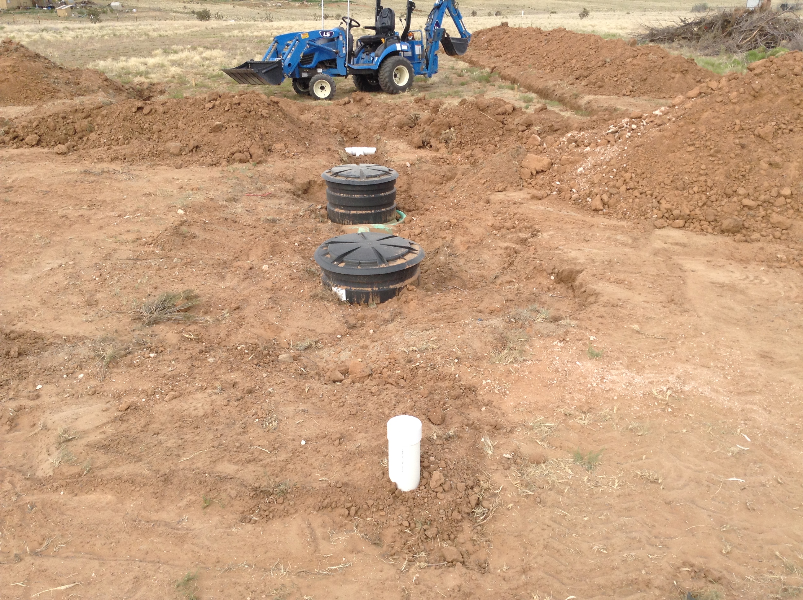

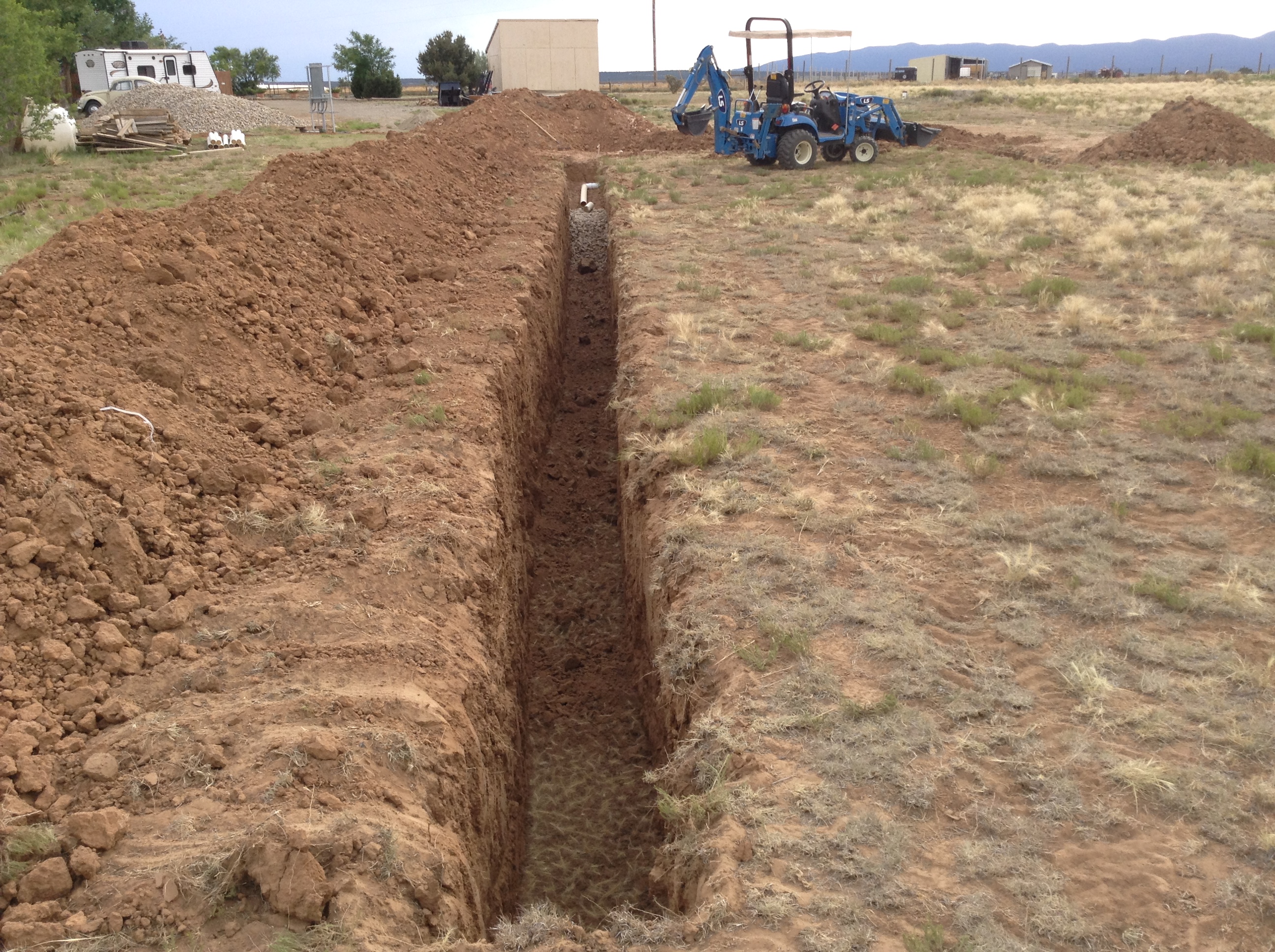

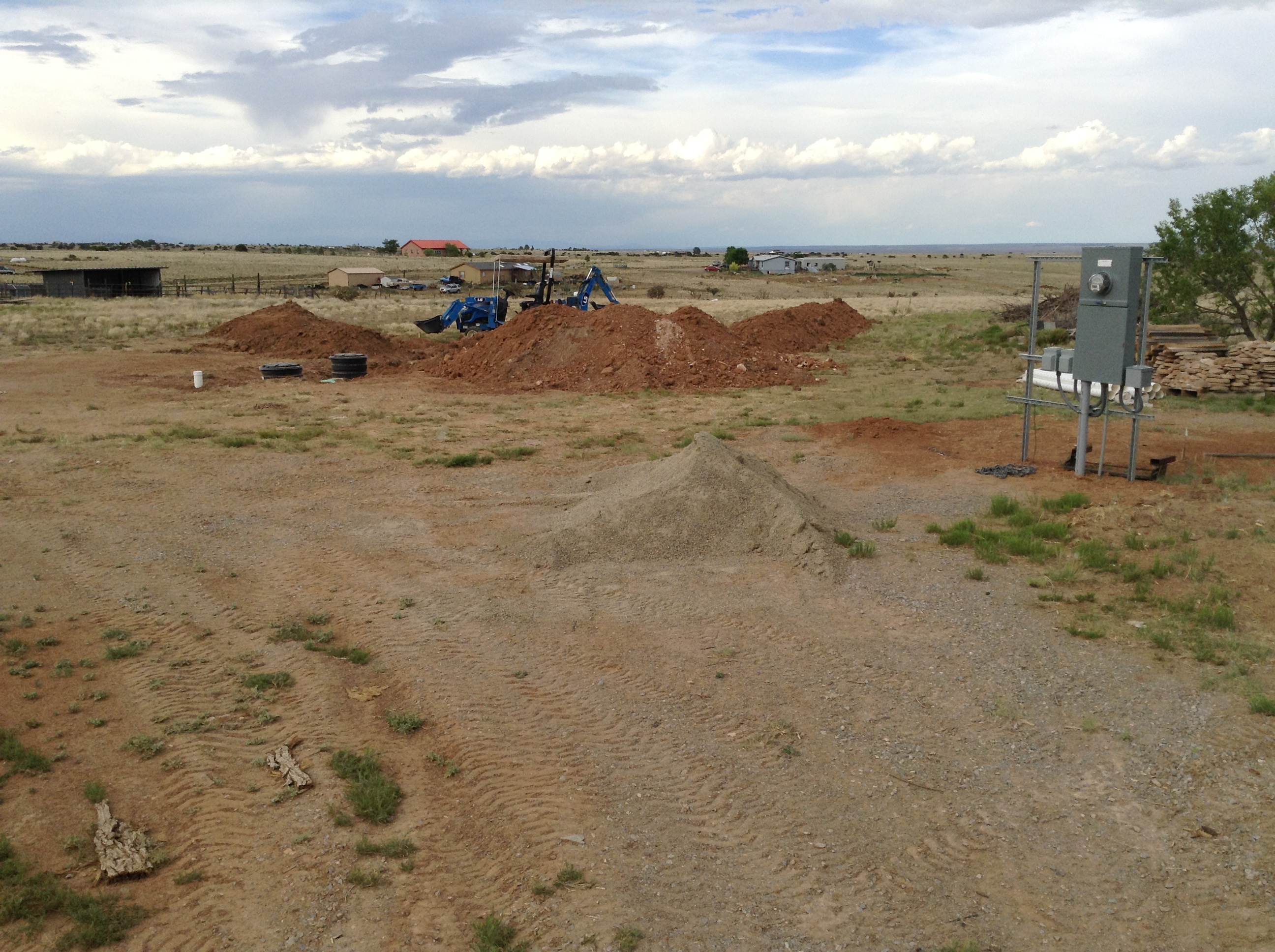

image.jpegimage.jpegimage.jpegimage.jpegimage.jpegHere's a few photos of my current project: doing a septic system for the new house I'm going to build. So far have the 1000 gal tank in place (the hole was 8' wide, 12' long, and 6' deep), the cross trench, and 1 run of the leach field ( need 2-56' long and 5' deep)dug. There's a pile of 38 tons of 1-2" rock that will go into the trenches. This little tractor does not cease to amaze me! Have 36 hours on it already and ordered all the filters for the 50 hour service.
