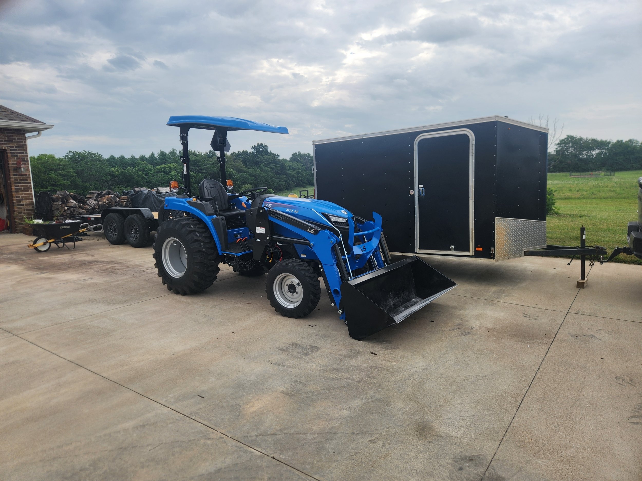

New here, question on LS MT242H and a Brush Hog
   / New here, question on LS MT242H and a Brush Hog #11
just go on Marketplace and look for a used 5-6 ft B-Hog , save some money compared
to new , that what i did
   / New here, question on LS MT242H and a Brush Hog #12
Enjoy your new equipment. I ran my 6' cutter for years on my 40 HP TC40DA, which is 33 HP PTO. Also, if no pictures it is just an internet rumor.
   / New here, question on LS MT242H and a Brush Hog #13
You can run the 6' cutter easily through light to medium duty work. If you really need to do much of the rough stuff work that a heavy duty bushog can do youre going to need a bigger tractor that can deliver near 10HP per foot mower width.
#14
   / New here, question on LS MT242H and a Brush Hog #15
TractorGunn, I know its over a year later but I'm having the same conversation with myself and my tractor. I'm looking at rotary cutters for the new property. I like the RhinoAg models and I want a 6' width with a 2" cutting capacity. Which, like you drops me off at the TW26 model. Buuut, they want 35hp min. And I don't want to have to run the tractor maxed out to run a cutter. But I do need a cutter that'll withstand running through oak limb dead fall under some tall grass and brush. Anyway, the hunt continues. How is your LS rotary cutter doing? I'm sure my dealer has one but I was looking for outside options.
#16
I've had zero issues with it, cuts like a charm. I just put the throttle on the indicator and it has more than enough power.
Question since you have the same tractor. Have you found any oil filters cross references that work other than having to use the LS brand?
I made a thread here. I'd like to be able to find something off the shelf that works and is good quality rather than paying LS $30.00 for one filter.
   / New here, question on LS MT242H and a Brush Hog #17
That's good to know. I did a little more homework and discovered when I looked at my dealer site for an LS rotary cutter, they carried the Bush Hog brand. So, I looked up their lineup and the BH216 would fit the specs...not so much the price, but the specs. I'll keep thinking on it.
