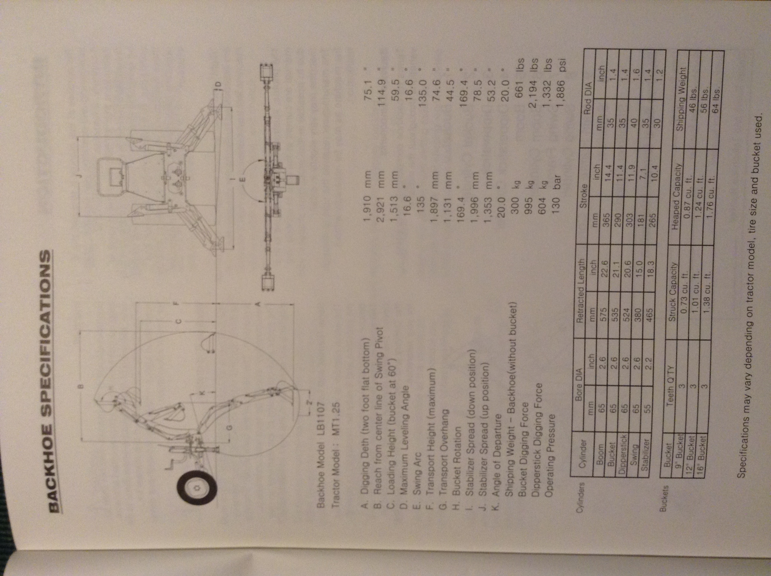

Here is the specs out of the LS manual:

If I read that right, the specs out of the ls manual say that the backhoe on the MT 125 with 2194 pounds has more bucket digging force than the backhoe on the xj2025. LS's website lists bucket force for the XJ at 2096 pounds. I'm kind of blown away by that.
   / New LS Sub-Compact #109
Interesting that the bucket digging force in the manual is about 100 lbs. more than the brochure. I think that is the second most backhoe force in a SCUT after the GC1720.
