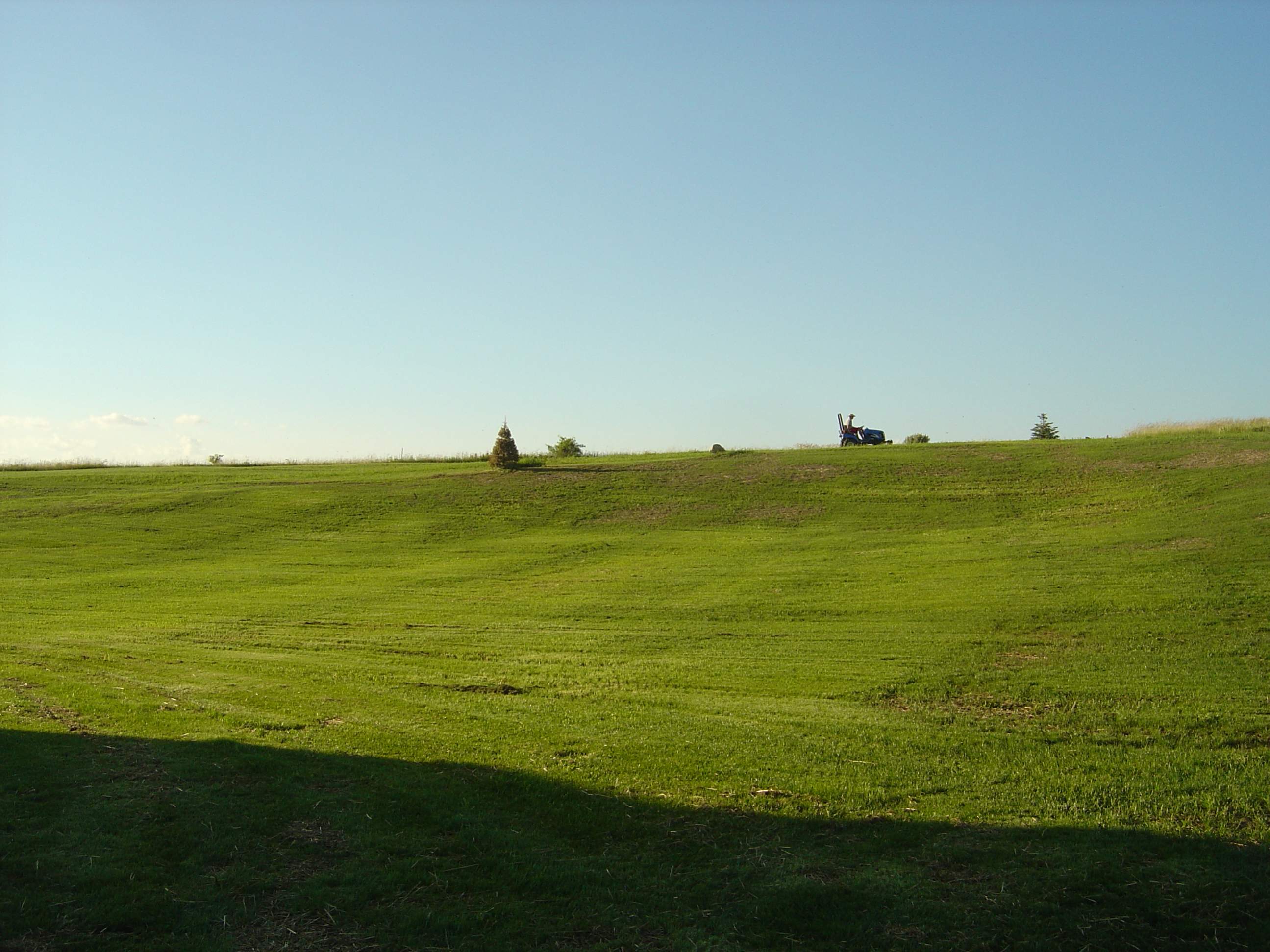

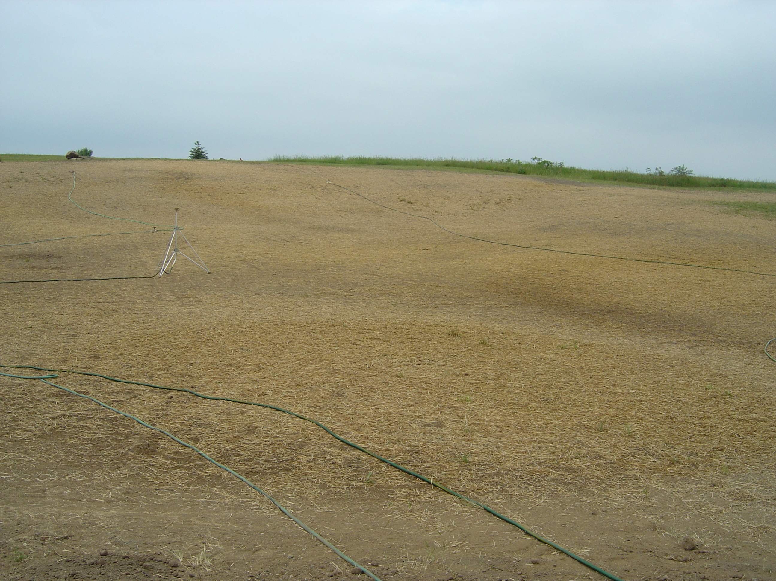

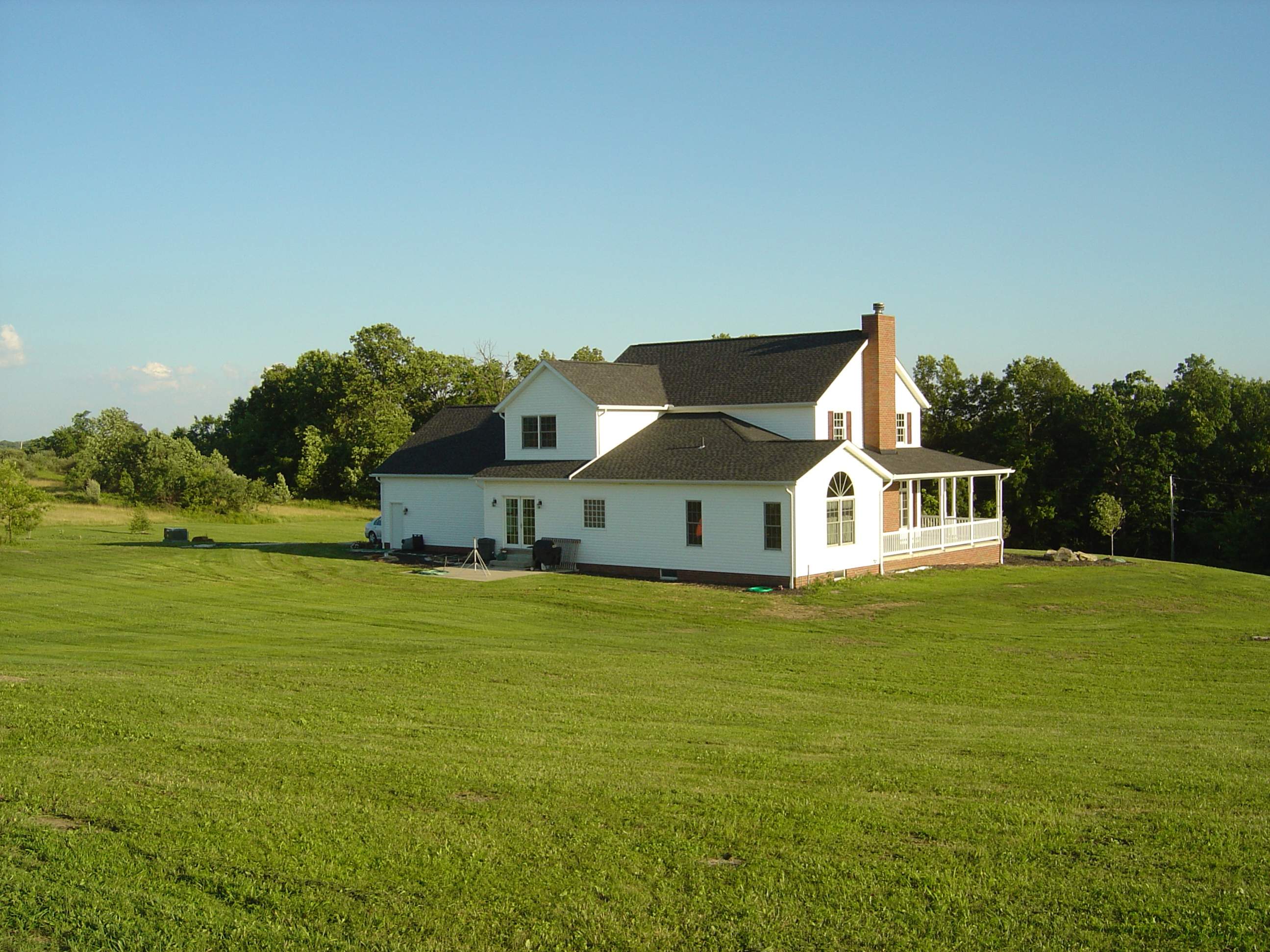

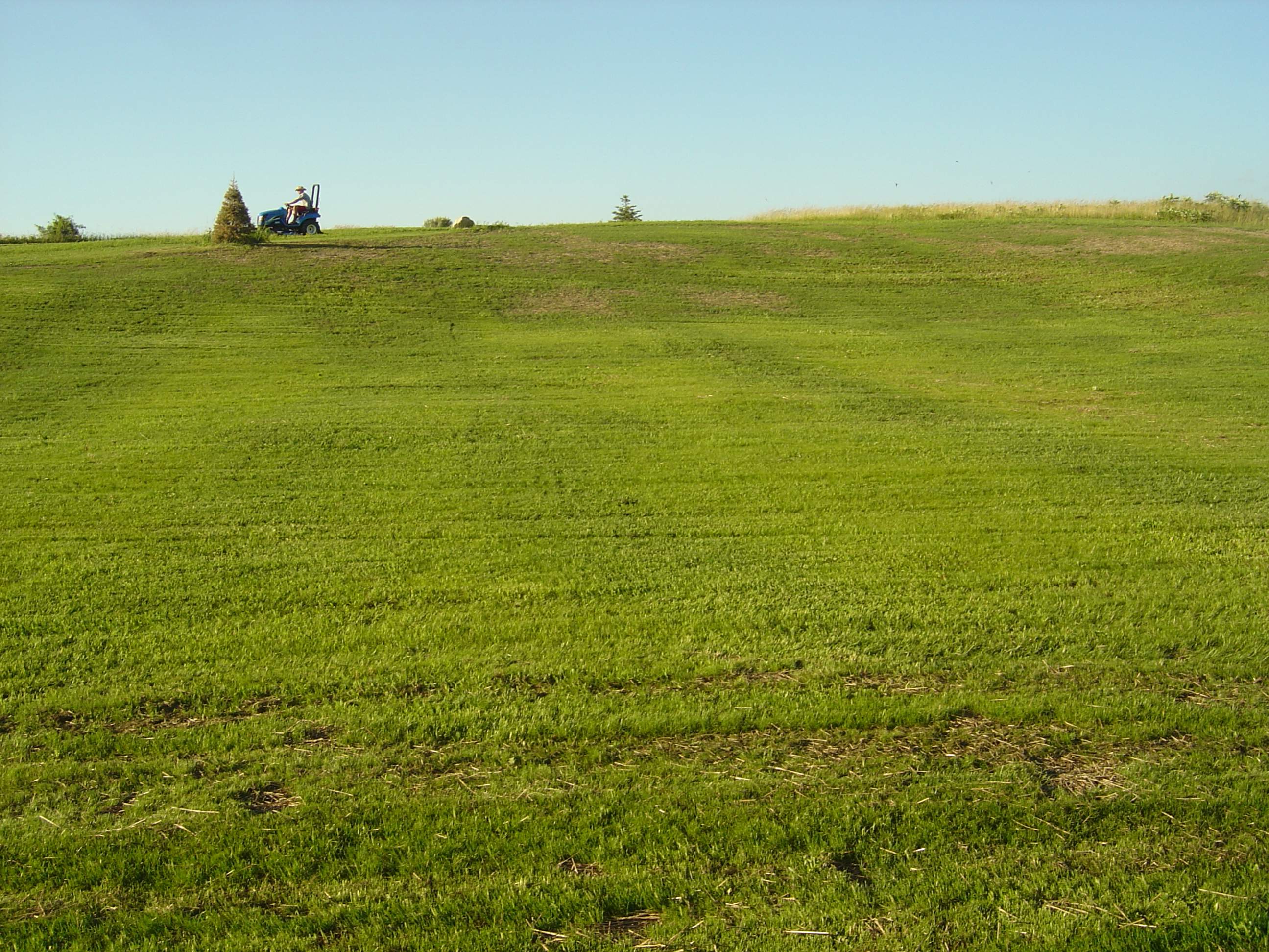

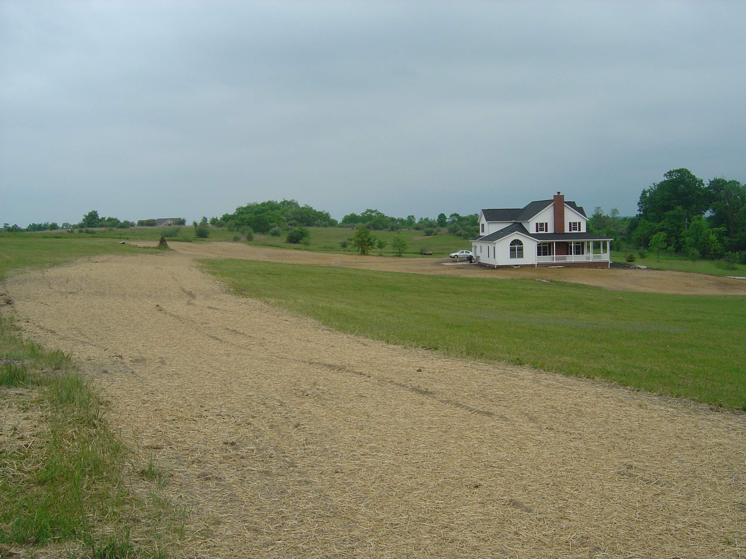

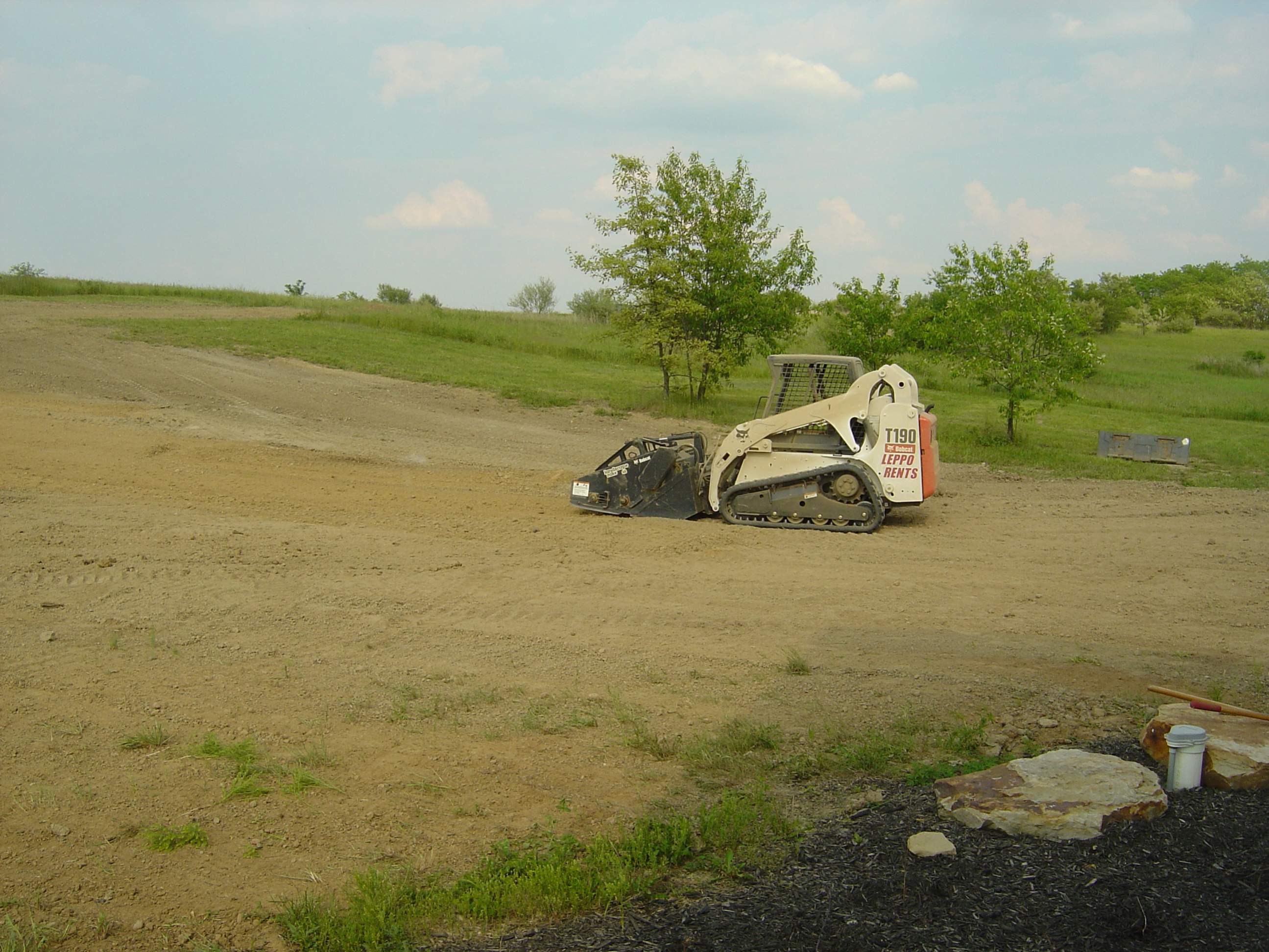

I recently just finished a 3 acre section of new lawn over Memorial Day weekend. I also did 2 acre section in the summer of 2007. My soil is heavy clay, that was stripped in 1951. I trucked in topsoil and mixed it with the existing soil with good results.
I used a box blade to break up the existing soil, spread the topsoil, graded the area (I have some slope toward the house), and then used a rock-hound (or landscape rake) to pick up the rocks. I rented a bobcat with the rock-hound implement for $225 a day. Well worth the money for a project of this size. The straw blower rented for $50 for a four hour period, which was more than enough time to blow the entire area. I used about 45 bales for the area. Also well worth the money.
I used the triple rye seed from TSC (~$90 a bag) and their 12-0-12 fertilizer. I spread both products a little higher than manufacturer specifications, and then I watered the heck out of the yard until this past Sunday, when I cut it for the first time. It has been very dry this year in my part of Ohio, and I had a hard time keeping up with the watering, but the grass came in ok.
I have attached a few pictures of some of the area as a very dusty work in progress, a picture of the rock-hound, and some results of the mowing on Sunday. As mentioned in some preceding posts, I did have weeds, as they love the water and fertilizer as much as the grass seed does, but those will go away with time and care.

/ New Lawn Advice #11
peterssj4034 ,
You did good, nice lawn. Is that triple rye, three kinds of rye, or other grass seed mixed in. We can put down rye here in Florida, but when the temp gets above about 85, it dies out. It is just for a winter green here. It will even grow on cement, trailer bed cracks, if given enough water.

/ New Lawn Advice #13
peterssj4034,
You did a great job. That rock picker on the bobcat is one of my least favorite tools. I rank it right up there with a manual posthole digger. It is the best tool for the job you had to do, though. I can't believe that you were able to manually water 3 acres. I installed alot of grass in NW IN and did it in a very simular way to what you did. Keep mowing, fertilizing, and use spot weed killers and you will have a golf course in no time.
/ New Lawn Advice #14
aggiehortguy91,
Thanks!
I agree with your assessment of the rock hound. I have used them a few times and they just about beat you to death, and you suck a lot of dirt in dry conditions, but they are useful tools.
