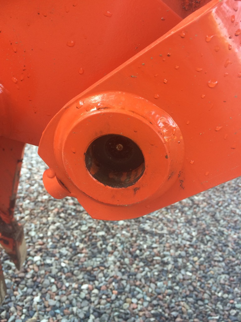

I remembered I had some pictures a fellow L45 owner took of their factory setup when I was researching thumb options for mine. I think I see a bolt through that pin.
/ New L45 TLB
#23
Thanks, it is a different style quick connect unfortunately.
The dealer phoned me back this morning and said there's a set screw, I dropped the bucket and it was hidden under the ear.
It was tight, but not touching the pin, the set screw lines up with a hole in the pin meant for a bolt, which the set screw should protrude into and keep it from moving around. However it appears to be bottoming out before doing so. I may see if the local parts store carries one that has a longer taper to it. Or could spin the pin 90 degrees and see if it will hold like that.
/ New L45 TLB #24
Well, I tried. LOL
I'm glad it looks like you understand how it is supposed to work, shouldn't take much to make it work properly.

/ New L45 TLB
#26
Ok, so the set screw hole was not tapped all the way through and would not allow the screw to even touch the pin, nothing a tap couldn't fix. The other issue is the pin is designed to be used with a bolt passing through, so when it was assemble the bolt hole was in line with the set screw, but the diameter of the hole is larger than the screw and goes right through which would not allow the set screw to bottom. So the proper fix would be to have a small flat spot machined 90 degrees to the hole in the pin where the set screw could bottom onto and not allow the pin to shift side to side. For now I tightened it down onto the surface of the pin and it seems to hold well, but will talk to the dealer about having it machined or replaced with one that is designed for it.

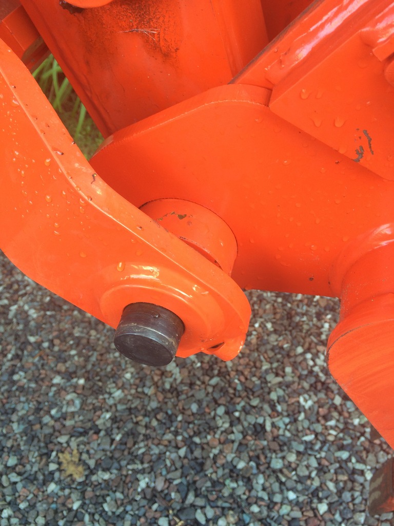

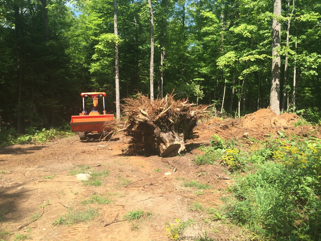

Was down to help the neighbor dig out this maple stump today, figured we would use both tractors to make it go quicker. If you look closely his Mahindra 3016 is behind the stump. Should have gotten better picture with both machines beside it.
Can't believe how much faster pulling a stump is with this machine, both tractors digging took about an hour and a half, maybe two hours to have it out of the ground. We weren't exactly in a rush, so not too bad. We also stirred up a bees nest, but they didn't seem to care about us, just all over the place looking for their nest we think.
That bucket pin will not stay put, kept having to knock it back to center while digging. Hopefully the dealer comes up with a fix for that soon.

WOW! That's a serious stump! How'd you move it after that?
ac
/ New L45 TLB
#32
Just pushed it with the front loader, I doubt it would be able to lift it up completely, but had no problem flipping it over a couple times to knock some dirt off.

As for the backhoe pin issue, I ended up going to a Brafasco and getting a 1/2"x13TPIx2" set screw, it passes right through the pin and bottoms on the opposite side of the coupler, and the bucket ear covers the open end. So far it has been holding the pin in place and have used it for few hours of digging.
