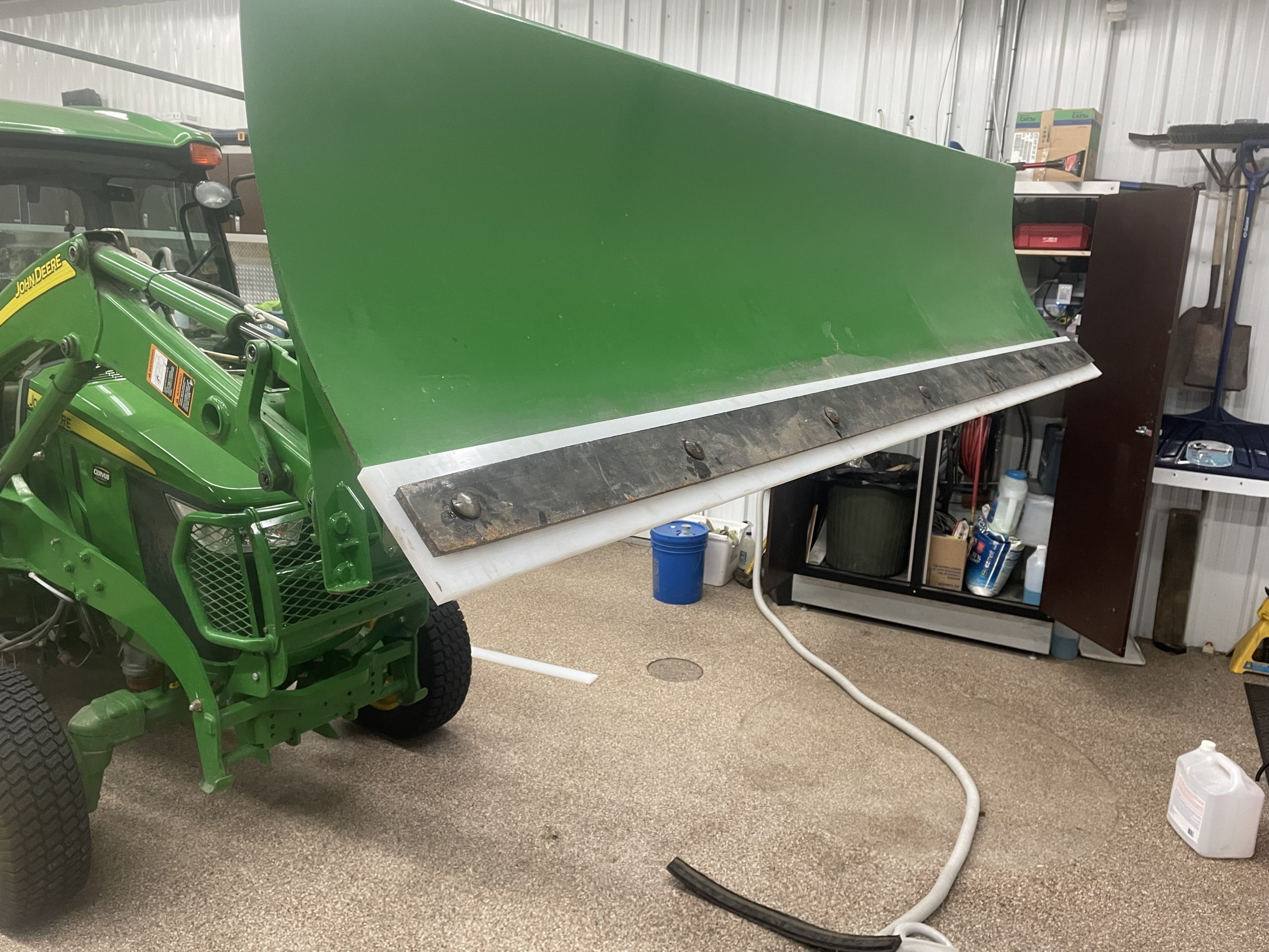

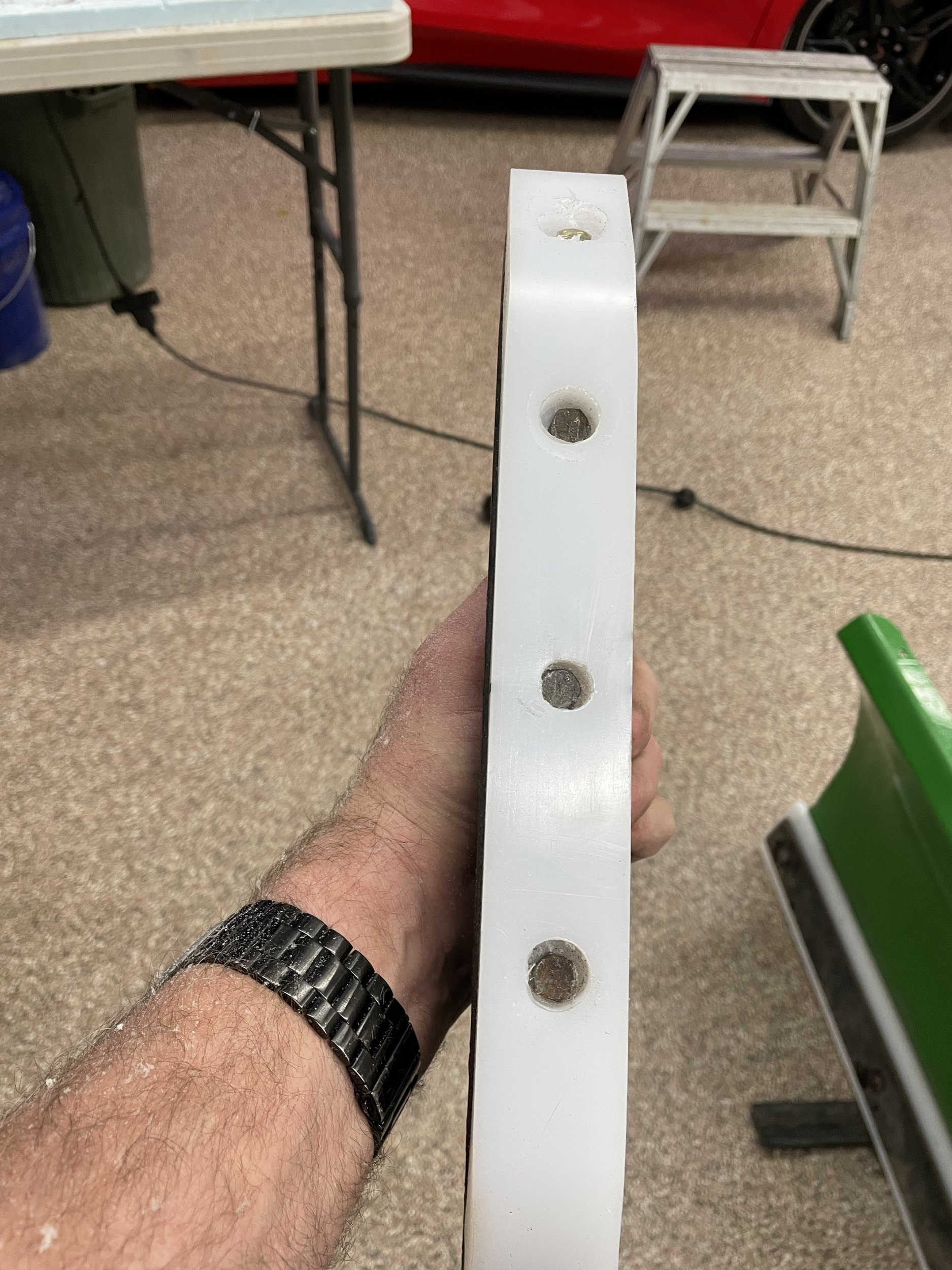

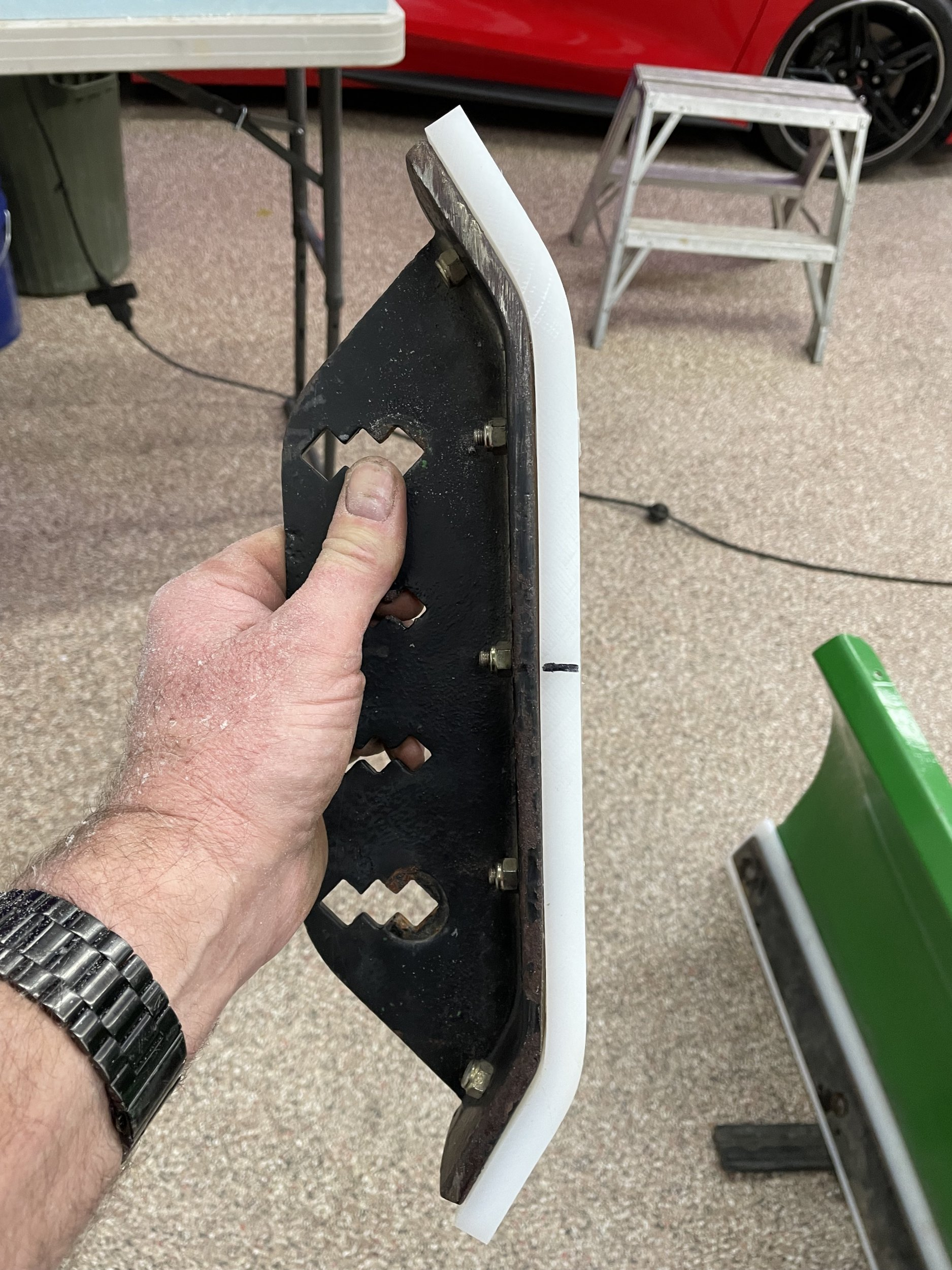

I searched this topic a few days ago and came up with this thread. It got me thinking about how I have to avoid a decorative concrete area on my property. I found a supplier locally that had various UHMW sizes and thicknesses. The sheet was easily cut on a table saw and I used an old cutting edge to drill mounting holes. As well, I used the old cutting edge as a doubler, although I am not sure I need it. I then used some of the scraps to make a couple shows for the snow blower. With a bit of heat, I was able to make the plastic follow the contour of the shoe. I just did a maiden voyage in -26C temperatures with no surprises. I would imagine that it will wear quicker, and I would consider using 3/4" thickness next time as opposed to 1/2".
