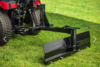

Oh man... no!!! The Tractor Supply blades are made by Tarter Manufacturing, Dunnville, KY.
The Tractor Supply blades looks way worse than the Frontier RB2072 I sold! Seriously, not good.

Just stopped by there a month ago coming back from Nashville and chatted.... they make Frontier rotary cutters and blades for many including Tractor Supply. If you look at Tarter's web site they even list Tractor Supply as their retailer... doesn't matter though.
The moldboard on their blades suck. Might scape out a hog pen just fine but it will NOT roll snow. I mean c'mon! LOOK at it. I had a Frontier blade that had more curve than TSC's and IT sucked. Going 50 ft in a 3" nuisance snow is all it could handle before being completely overwhelmed. IT WOULDN'T UNLOAD. Don't tell somebody here to buy this for snow! C'mon!

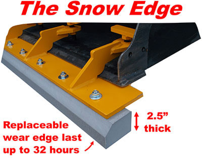

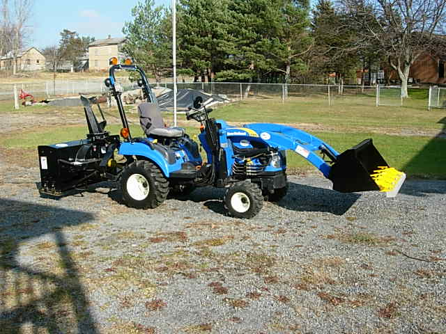

I have a small tractor BX25 and I need something to protect the bucket edge and the driveway for those areas where I need to use the bucket to clear snow. The Edge Tamers look interesting but I notice that the BX Expander also has a straight bar that bolts onto the bucket (BXpanded Piranha Straight Bar). The Ratchet Rake Snow Edge also looks interesting since the way I read it there is no need to bolt on the device. (Ratchet Rake, LLC - All Terrain Rake, Snow Edge, Tractor attachment, Bucket attachment, Loader, Skid loader, Kubota, Skid steer, Landscape rake, Brush remover, York Rake, Harley Rake, Rock Rake, Tractor rake attachment, Construction attachment, New Holland, Bobcat, Fire safety, Home fire safety, Fire prevention, John Deere, skid steer attachment, tractor implement). Any thoughts or preferences on these choices?
/ New Kubota..loader edge? #56
The Edge Tamers are great, but will leave 1/2" or so of snow. The bolt on edge from bxpanded is still a steel edge engaging the pavement, with potential marking likely. The Snow Edge is damage free, easy on/off with large hand tightened clamps.
I have the Tamers, and for the price are a great option to have for a bucket. I used a Snow Edge on my previous tractor, and it was ((IMHO) the ideal bucket addition for damage free snow removal, if you must use a bucket.
/ New Kubota..loader edge? #57
edge tammers mark driveways such as asphalt, they are metal, they will leave marks. they are great for gravel. if all your doing is concrete or blacktop i would not use tammers.
/ New Kubota..loader edge? #58
Thanks, after watching a couple YouTube videos the Snow Edge looks like the best option for my situation.
/ New Kubota..loader edge? #59
Another factor with the snow edge is ......... it makes a novice operator like myself much better in that the angle of the FEL does not have to be as precise. You have maybe a 15 degree leeway on the bucket position to be effective when pushing off snow.
When I bought mine I included a spare sacrificial wear edge ..... but after three seasons the original has yet to show any significant wear.
