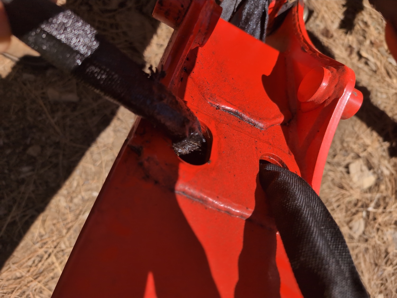

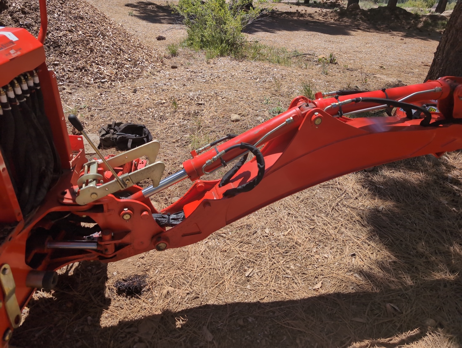

Called the dealership. Problem is the backhoe has a one year warranty on it. I bought it in spring last year, but I didn't actually get it installed on the backhoe (at the dealer) until early fall, and it wasn't on the tractor all winter because it snows here and I had a plow on it. The dealer said it's warranty just ran out. I went back out and started tugging on hydraulic lines, and found the problem, the thin nylon wrap where the hydraulic lines go through the frame back to the valves is really torn up. It doesn't look like the nylon protection did ANYTHING to protect it. I've got a call into the dealer to see what they think. I think I need to get that hard plastic coiled wrap for the hydraulic lines if 20 hours of work does THAT to the hose.

" I think I need to get that hard plastic coiled wrap for the hydraulic lines if 20 hours of work does THAT to the hose. "
The tearing on the nylon sheath is likely due to a burred/sharp unfinished edge/weld on the inside of that hose opening.
Just a guess here, but quality control missed it so when you replace the hose, get a die grinder in there and smooth things off. If you don't get the rough edge finished even a hard plastic coil shield will not solve the issue.
Ya, it is a factor defect. Too bad you did not catch it before warranty expiration. A good dealer would have went to bat for you with the Kioti warranty manager.

So, me- not being flush with money to waste, pulled out the wrenches and extended the boom, as noted in the photos and supported everything. I pulled up on the hydraulic line on the push side of the first cylinder of the boom, and right there the nylon cover was warn away as was the rubber coating reveling the braided wire of the hydraulic hose- I'm going out on a limb and going to guess that is my culprit. I took off the line from the cylinder and the valve body and tomorrow I will drive to Carson City to get the dealer to make up a replacement hose for me. He said he'd do that for me (70 mile round trip, but cheaper than spending $600 to have it shipped to him). I'm looking online for the plastic hose wraps and since I have the tractor backhoe somewhat apart, will add the hose wraps to the hydraulic hoses going from the boom to the valve body at stress points. Hopefully, that will resolve the problem without having to haul the whole backhoe down to the dealer.

Lowes sells those 1" wire looms that would probably work. I used them to coral winch wires on something else and they're decently stout.
It would be a great time for you to get in there and smooth out those rough edges either with a dremel, hand file, or other.

It's a pretty tight squeeze to get into the portion of the boom where the hose rubbed raw. I stuck my hand in as far as it goes and the only "sharpness" I feel in there is the edge of a steel plate- not feeling any welding imperfections. Could it be that the hose was damaged before they installed it in the frame? Another possible (but doubtful) thing was it was apparent that some sort of rodent created a nest in there over the winter. There is only one hose where the sheath was worn through (at the point of the apparent rubbing) and "maybe" the rodent ate through it, but I would think: a) if a rodent was knawing on stuff it would have worn through the other hoses, and b) a rodent isn't going to chew through the steel banding- so I think coincidence. I plan on replacing the hyd line and putting hose wrap on all the hoses that could potentially rub and go with it. If it happens again, I will do a more thorough examination or perhaps send it into the dealer then.
