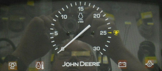

Fresh off the lot 3038e. From all indications in the owner's manual there should be a speedomter on this thing. Anybody know for certain if it's a. not available. b. optional c. not working.

It looks like the 3038E has a techometer but no speedometer. I'm not aware of any JD CUT that has a speedometer.

The 4x20 series has a dial face tach and digital hourmeter like shown; however, the hour meter toggles itself to spedometer while you are moving then back to tach when you stop - or you can press the button and toggle manually as well. I don't think the 3038 has that feature.
Regardless, you can calibrate your rig using a set distance and stop watch. That is what we did when I was a kid. Even if a tractor has a speedo it isn't usually super accurate and my Dad would set use the stopwatch anyway.

On my Kubota (wrong brand, I know), the digital display serves various functions. You have to toggle through them to select the one you want. See if your dash has a button labeled "display mode" or something similar.
/ New JD 3038e No speedometer
"See if your dash has a button labeled "display mode" or something similar." It does and works. Owners manual shows and discusses the speedometer but it must be for a higher end.
