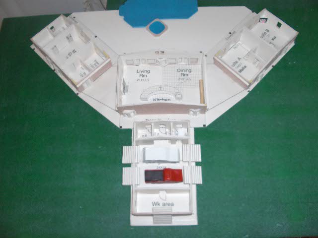

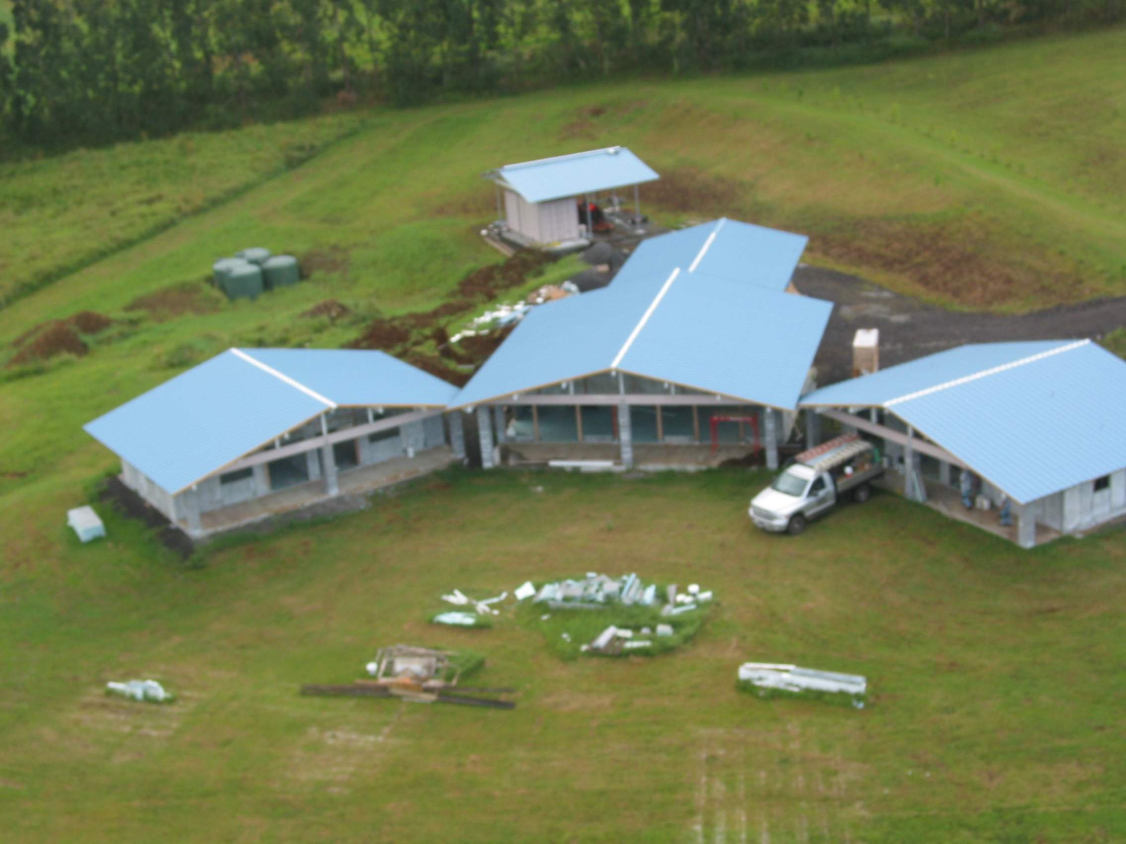

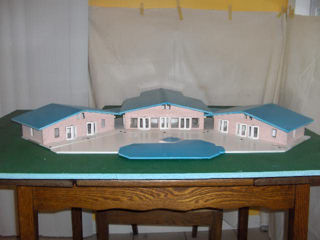

So, done plenty of graph paper with the multi erased pencil lines...
Progressed to a computer drawing that both you and wife feel is really really close...:thumbsup:
So how about making a scale mode?? :confused:
I'd never done one before, but I was also have a challenge with my roof line that just looking at drawings was giving me the warm and fuzzy I needed. I still had some spacing issues
Once I had my model, I also made things like kitchen counters, cabinets, even vehicles to scale. It was a great experience and a valuable tool.
BTW, the actual house pic is not current, I just don't have a newer on same perspective

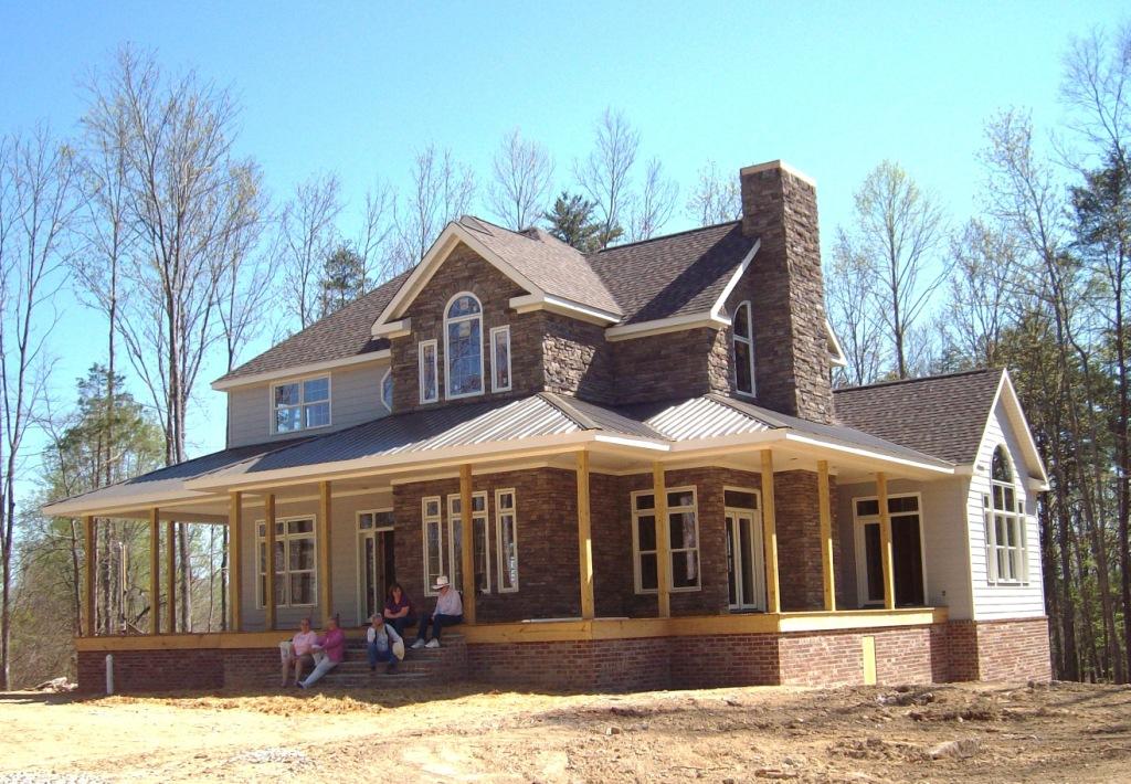

Exactly what we (she) are doing - just not screened in except for a 8x12 area in the back.
