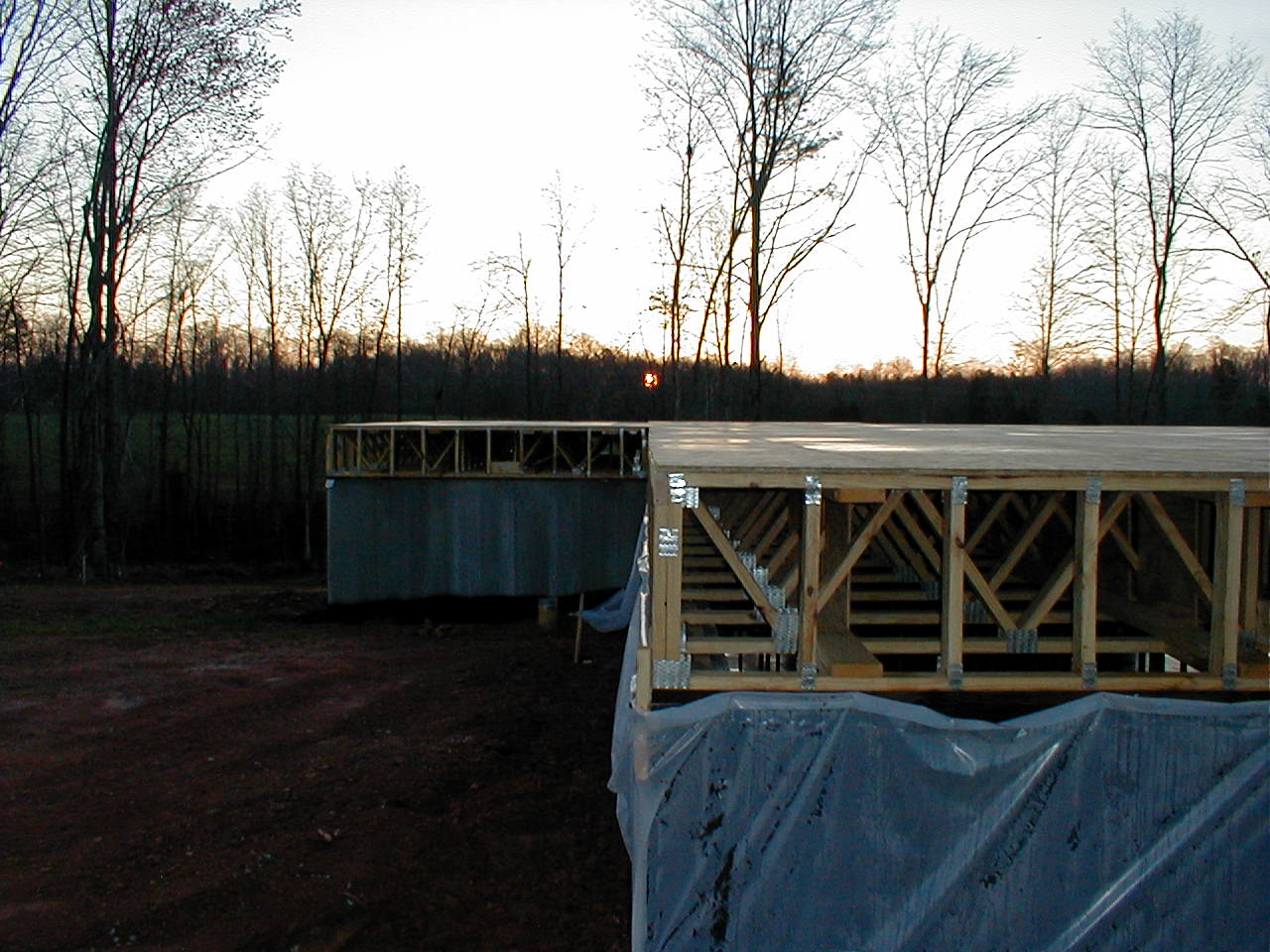

Our main windows face North, and it is a real blessing to not have the sun come in the windows, and to always look at a spectacular view which is lit by the sun at your back.
I designed the house this way and when I hired the contractor I told him I was picky. He said that was fine and that he could work with it. Then I told him that I wanted the house square to the points of the compass within +/- 1 degree. Told him that I meant true North, not magnetic.
He asked how he was ever going to do that and I told him that a surveyor could probably establish a baseline for him.
Within a degree is just fine, and the accuracy of any good surveyor will be all you need. I took this picture at sunrise on the spring equinox. Other than having fun sending the survayor an email asking what the arc width of the sun was, becuase it looked like he was off by about half the width of the sun, this picture told me all I needed to know. It's still fun to complain that I might be off by .15 degrees or so.
If your timetable and state of site preporation allow, you can do the sunrise on the equninox and get a line that can be referanced while siting the house. Cheap to do, good results :thumbsup:. You'll have to do a little extrapolation guess work unless you have a really flat, clean horizon. But for the purpose of where windows face and how overhangs help it will be just fine.
Pete
