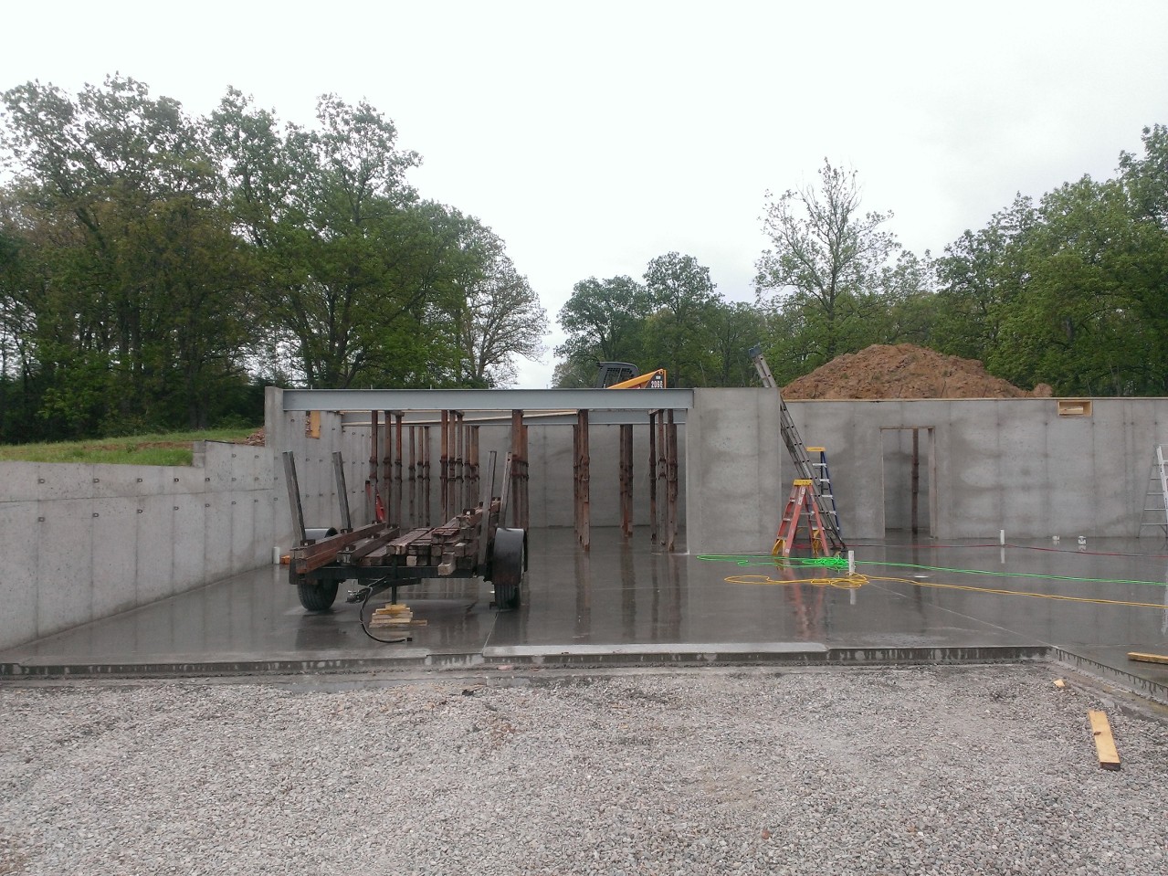

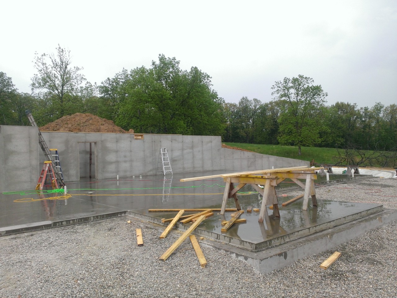

Trusses showed up today! We've also got steps to the basement (my kids were super excited about this), and they poured the suspended concrete deck today (which I forgot to snap a pic of, but did get one of it formed up last night). They had to drill a few holes in the floor to push the 1/2" of water sitting on it down through. Hopefully it can stay dry until all the roof is on.
WP_20140611_005.jpg WP_20140611_007.jpg WP_20140610_004.jpg WP_20140610_002.jpg WP_20140610_003.jpg
