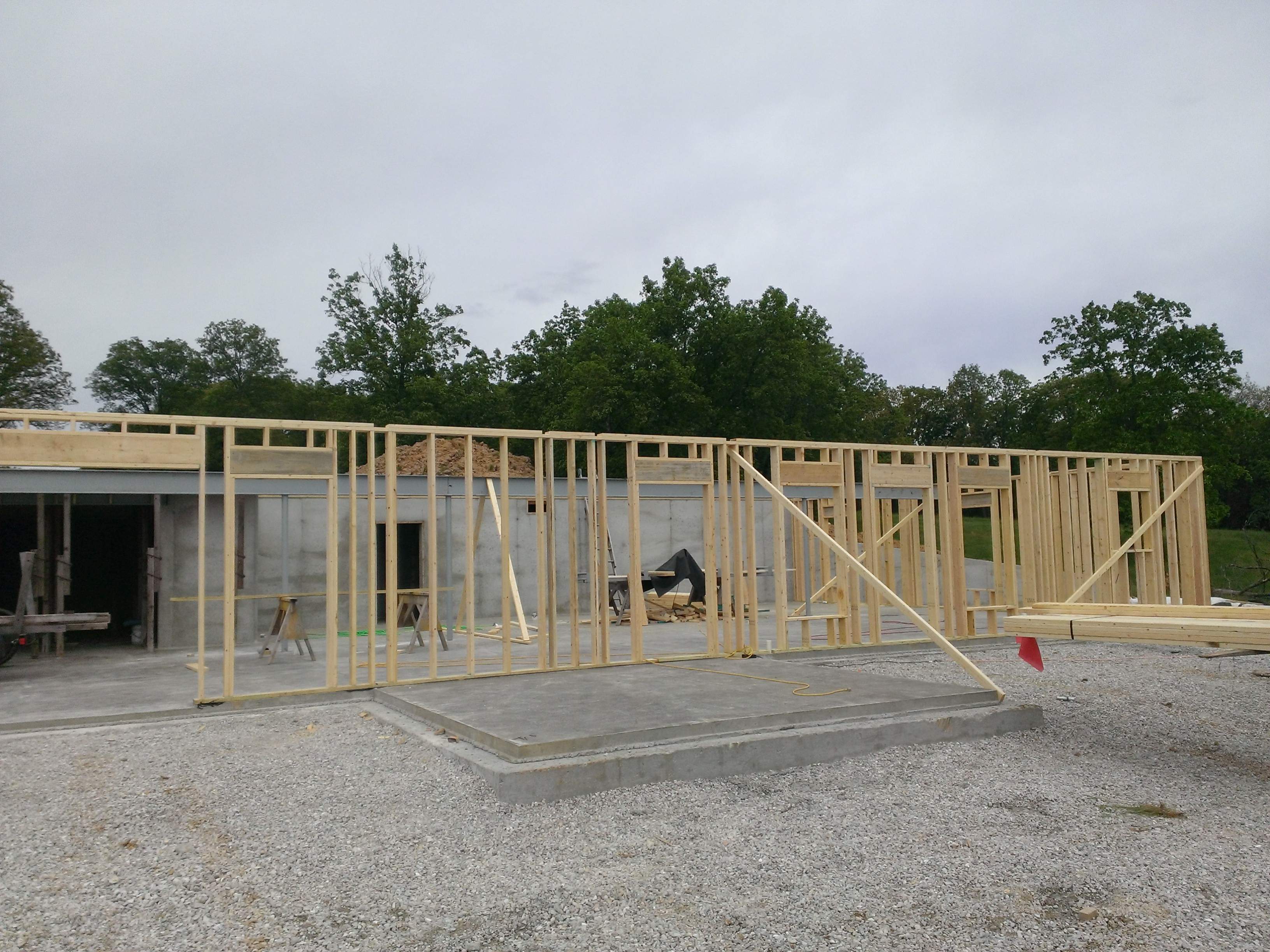

I'm not sure which area you are talking about. Are you talking about where the floor trusses are? If so, they just hadn't gotten to that yet. The put it on the walls of the main level before they stood them up, then came back later and finished the rest.

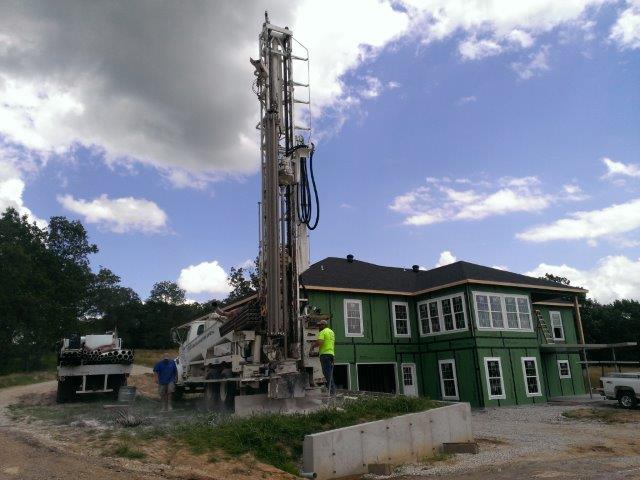

Geothermal wells going in:
382455-new-home-construction-wp_20140702_004-jpg

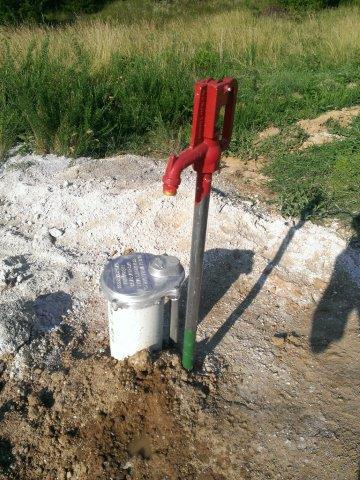

Missed pics of the water well being drilled, but the pressure tank and spigot are in:
382456-new-home-construction-wp_20140710_001-jpg
382457-new-home-construction-wp_20140710_005-jpg

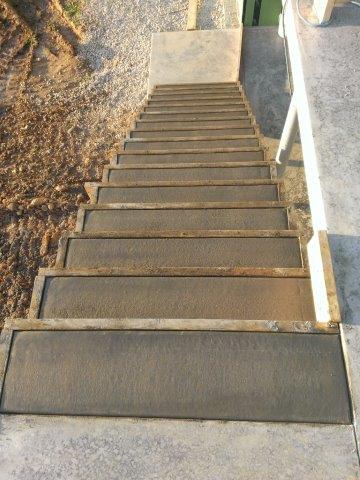

The concrete steps for the deck:
382460-new-home-construction-wp_20140708_007-jpg

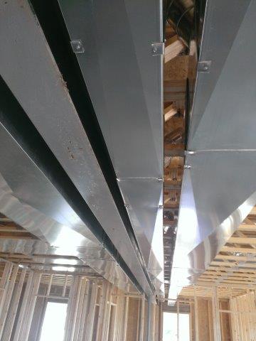

And most of the ductwork for our 5-zone heating and cooling system:
382458-new-home-construction-wp_20140710_003-jpg
382459-new-home-construction-wp_20140710_004-jpg

/ New Home Construction #105
How many wells did they end up drilling? I thought hard about geothermal when we built a few years ago and am still thinking about it.
#106
We ended up with 5 wells, enough for 6 ton of capacity. We are putting in a 5 ton unit, but added the extra well for added efficiency. We have geothermal in our current house and love it! Our bills went down while keeping the temperature cooler in the summer and warmer in the winter after we added it to our current home.

/ New Home Construction #109
Normally it's 1 ton per well, or 1 1/2 tons per well. with 5 wells and 5 tons, you probably don't have extra capacity. What size are the loop pipes in the wells and lengths, that is usually a good indication. I have designed and installed geo systems.
The house looks great. I was unfamiliar with zip panels, I have seen them used here but didn't know what it was.
#110
Yeah, it's normally 1 ton per well. I think they just went a bit deeper in each well instead of drilling an extra well. I'm not sure of the size and lengths of the pipes.
#111
I double-checked with the drillers today and they did just go deeper on each well. He said they needed 900' total for 6 ton and just did it in 5 holes. That would make it 180' / well.

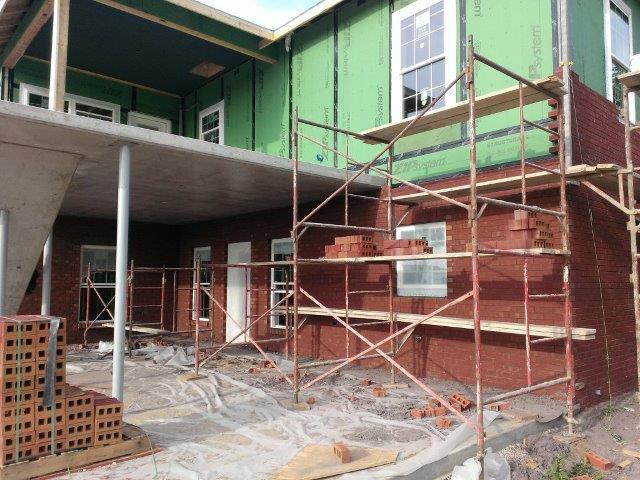

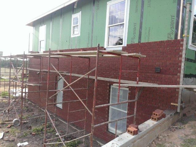

Bricking began yesterday. It's amazing what a difference a little brick makes!
attachment.php
attachment.php

/ New Home Construction #115
Nice of them to lay plastic down. I've seen it where they just destroy everything around the house by the time it's done and you have to spend a week just cleaning up their mess. Looks like you got a good crew!!!
Eddie
/ New Home Construction #116
#117
Eddie
Yes, I was very appreciative of that! I've been impressed with the crew so far. Our contractor (who is VERY particular) was even impressed. His normal brick layer was backed up and couldn't get to it, so we chose this crew. They seem to pay great attention to detail.
