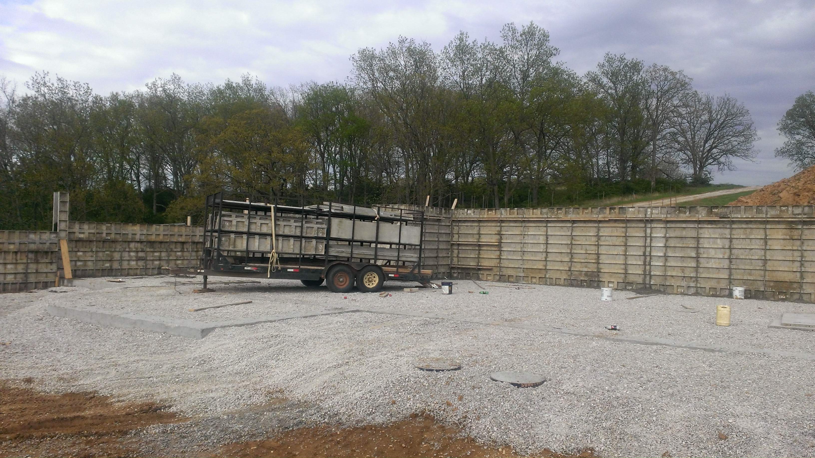

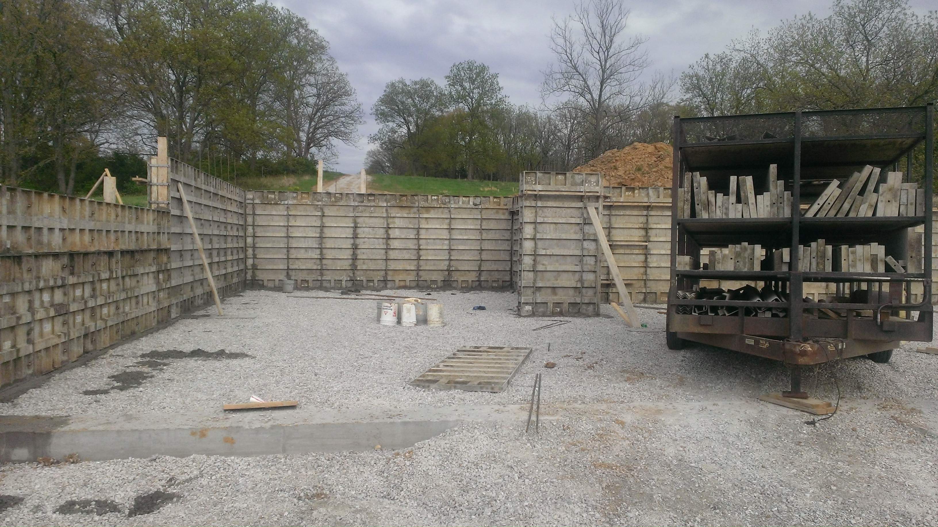

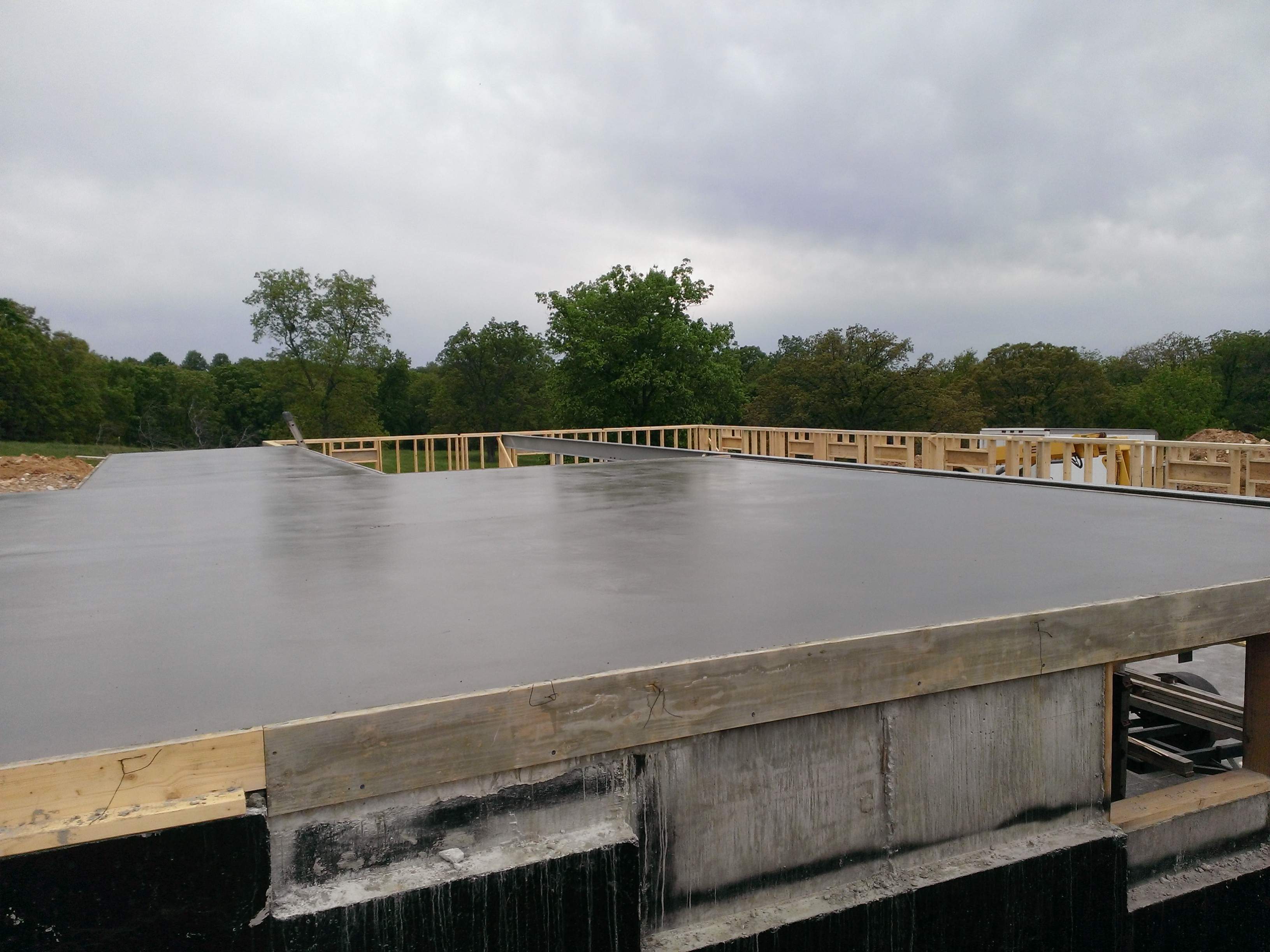

Think he is asking what are they using to form floor,probably metal,like in high-rises.
/ New Home Construction #42
The floor looks great. Can you post some pictures of the forms for the suspended garage floor? I've always wanted to do something like that.
/ New Home Construction #43
Sorry i should of been a little more clear. Are they using corrugated steel decking for the garage floor?
#44
I see what you were asking now. I thought that may be the case, but wasn't sure. :)

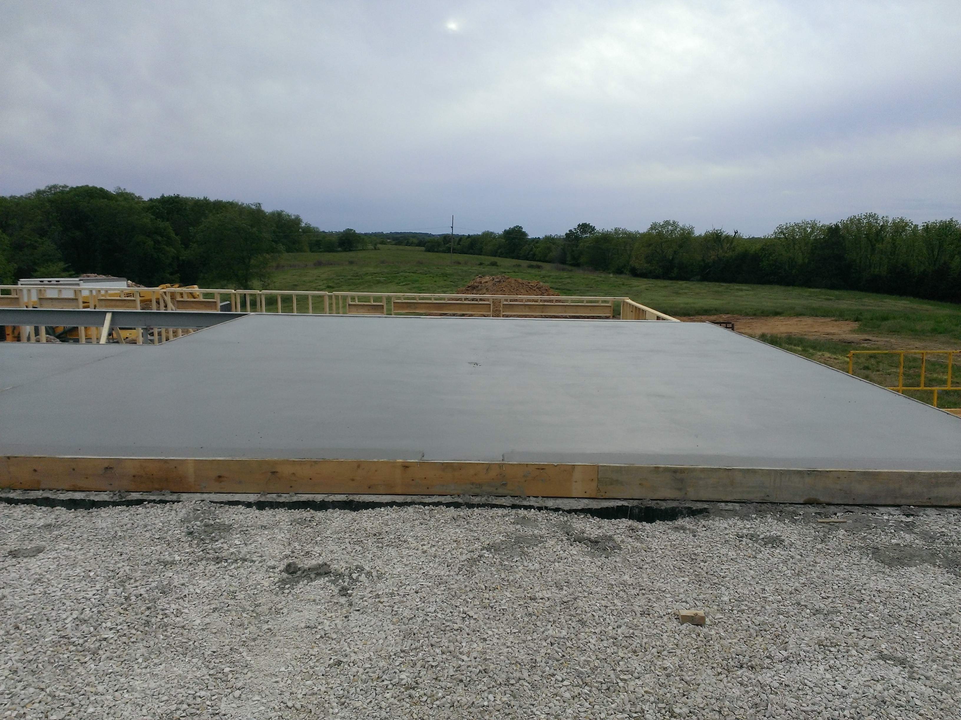

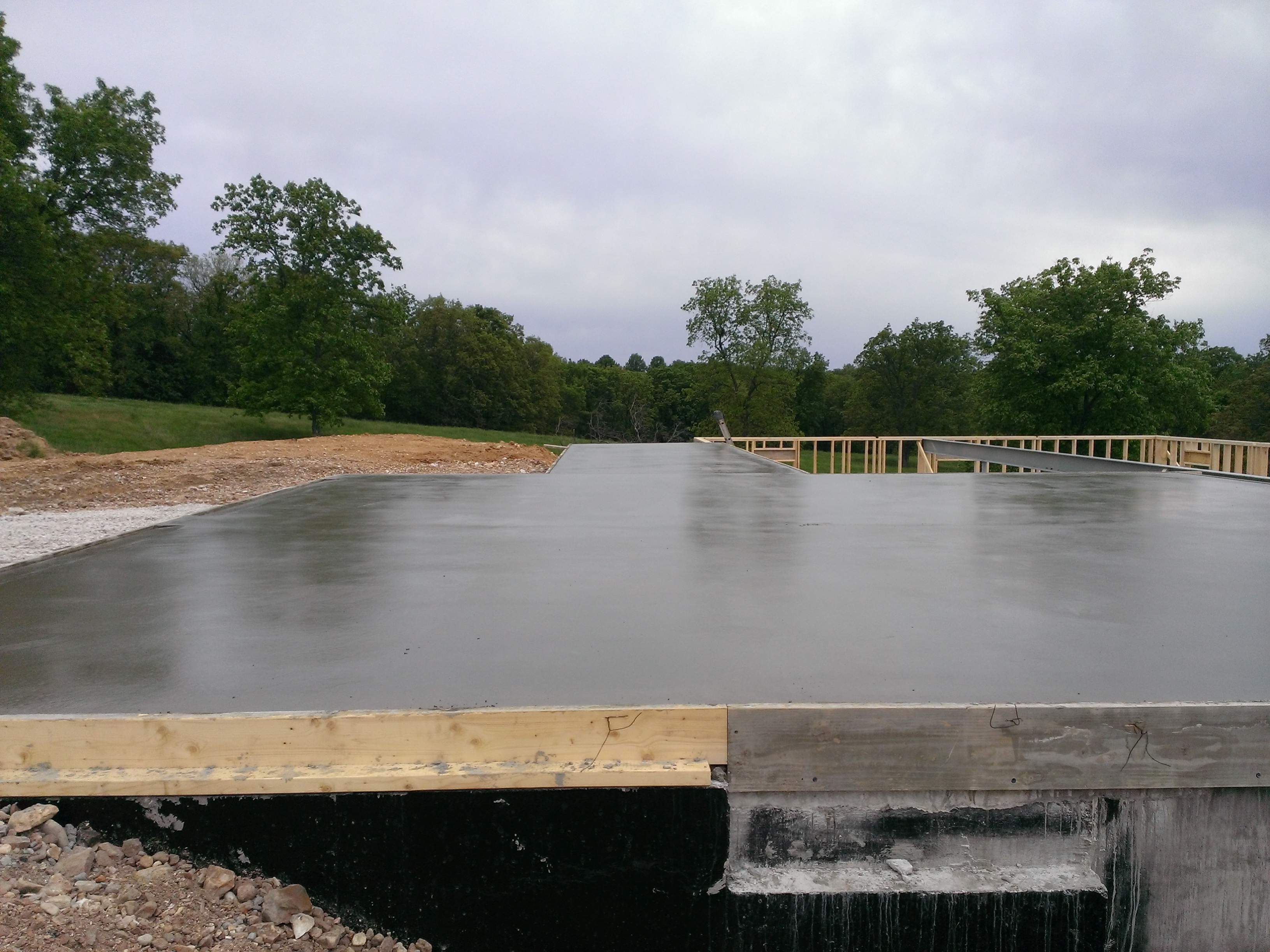

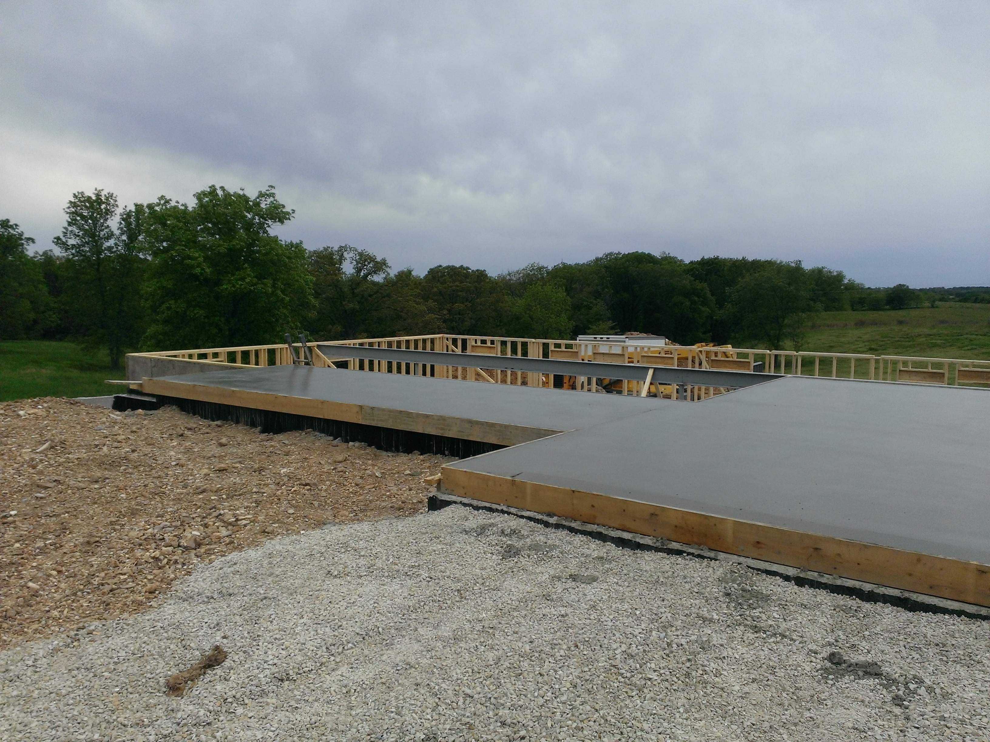

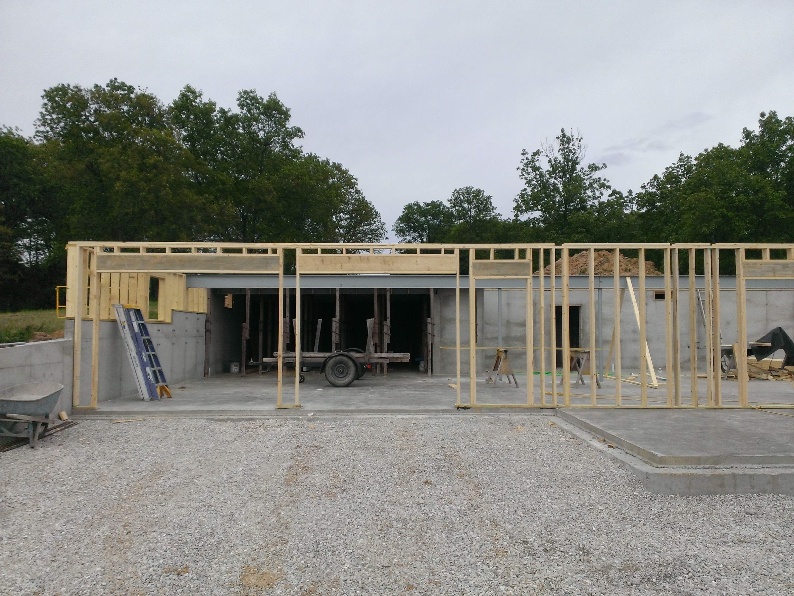

Basically, to form the floor, they frame it up with 2x4's, and support it with Ellis jacks. When they are ready to pour, they will lay plywood down on top of that, and then cover that with plastic. After the pour, after it sets up for 7-10 days, the jacks come down, the supports come down, and the plywood gets taken down to be used on the roof later. In the garage, there are two steel beams that will remain to help hold the concrete up. There aren't any in the storage room (tornado shelter) due to the size and small span. I had never seen this done before, so was pretty interested in it myself.
Here are some pics that should make it clear. The first 3 are the garage, the other 2 are the storage room. Kinda hard to get good pics. Feel free to ask any questions. If I don't know from my discussion with the contractor, I can ask and find out. :)

How thick is the first/second floor going to be poured and will there be wire mesh in it?
#47
The basement floor was around 5". The suspended floors will be a bit thicker just for more support since they are suspended. I don't think they use wire mesh, only re-rods. I know the basement floor did not have mesh, not sure on the upper floors.

Thats a heck of a lot of set-up for the slab. I take it they will be doing a 6"or 12" grid of rebar?
#53
I'm not sure for the suspended floors. I believe it was 2' for the basement floor.

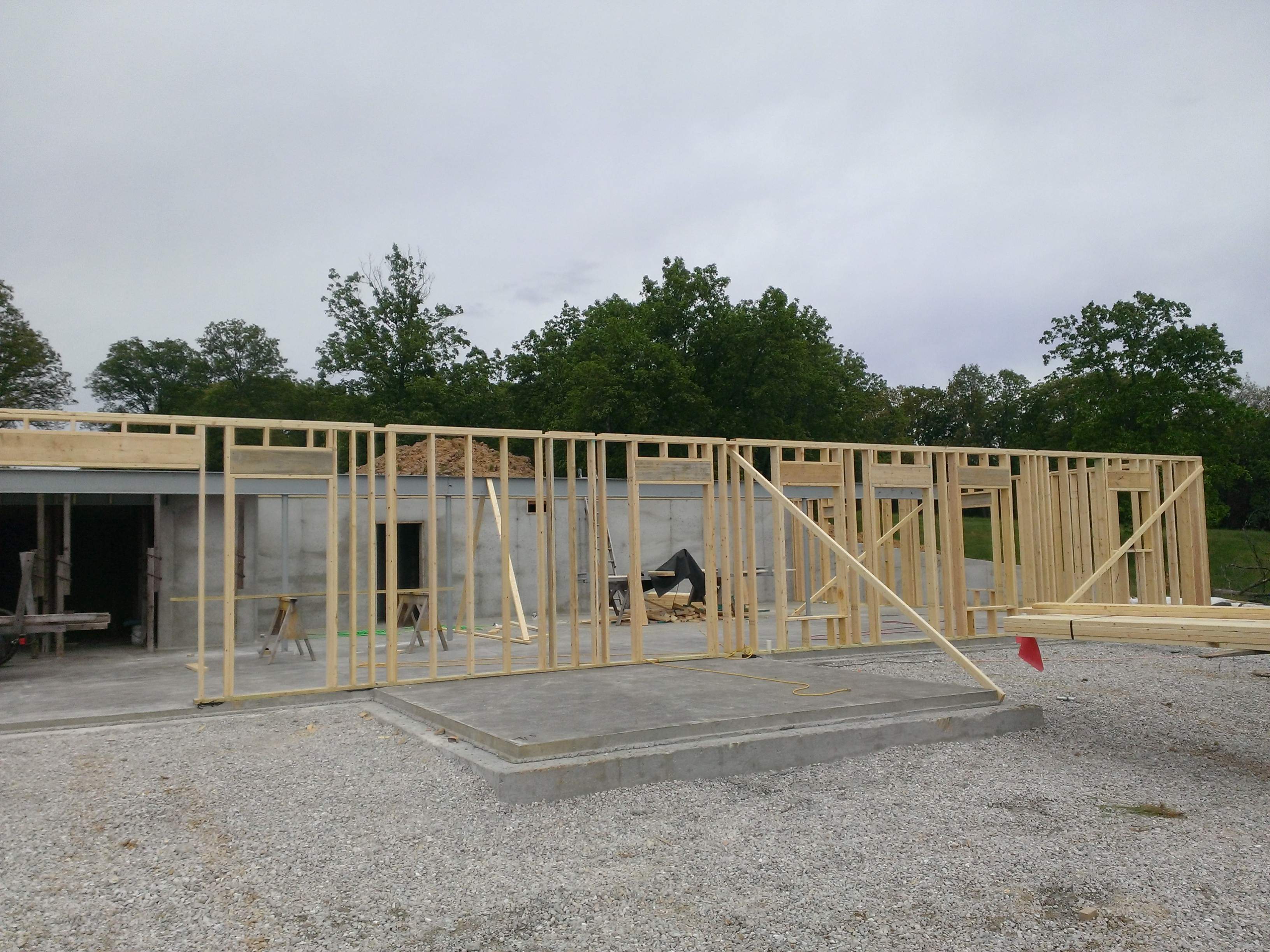

Here are some pics of the suspended floor after the plywood is down. It's been raining pretty much all week, so progress is at a standstill for now.
PS, still just attaching images here for now until I get time to set up an account and just link them inside the message.
#55
Concrete is poured and the back wall is up in the basement. Floor trusses are supposed to be delivered today. We should REALLY start to see some progress now!
