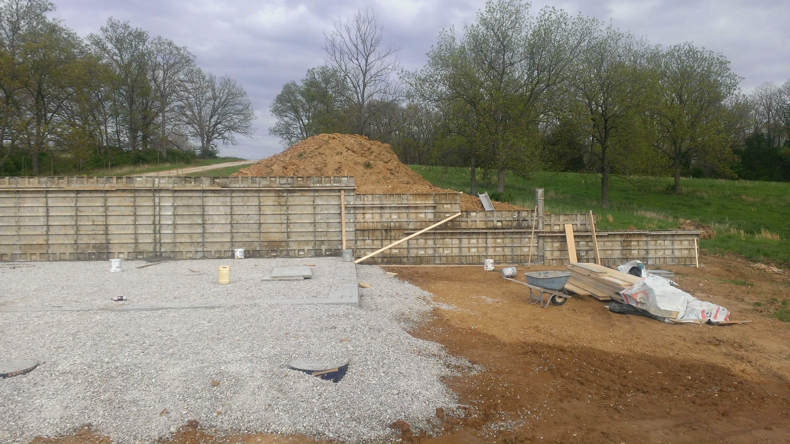

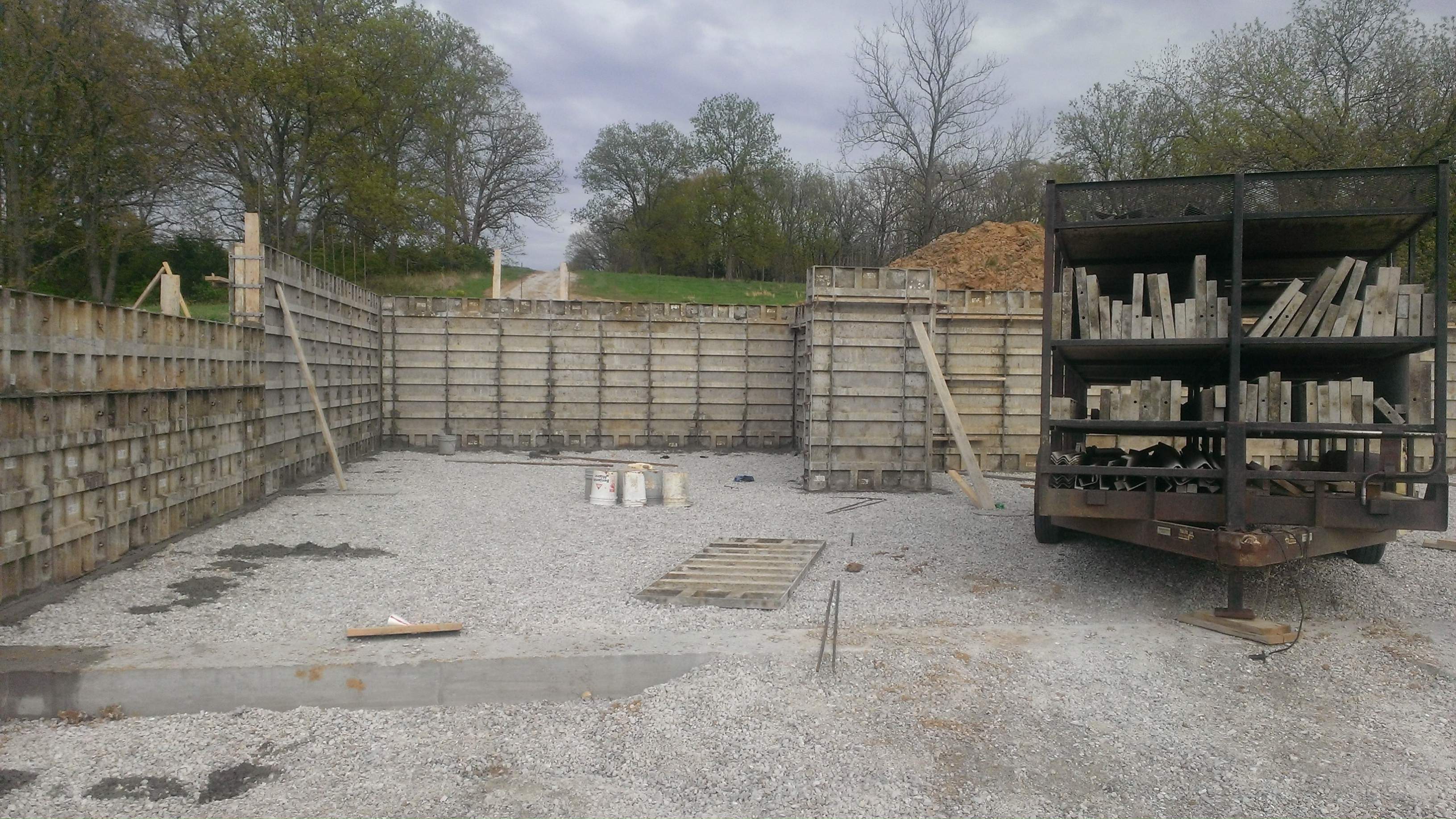

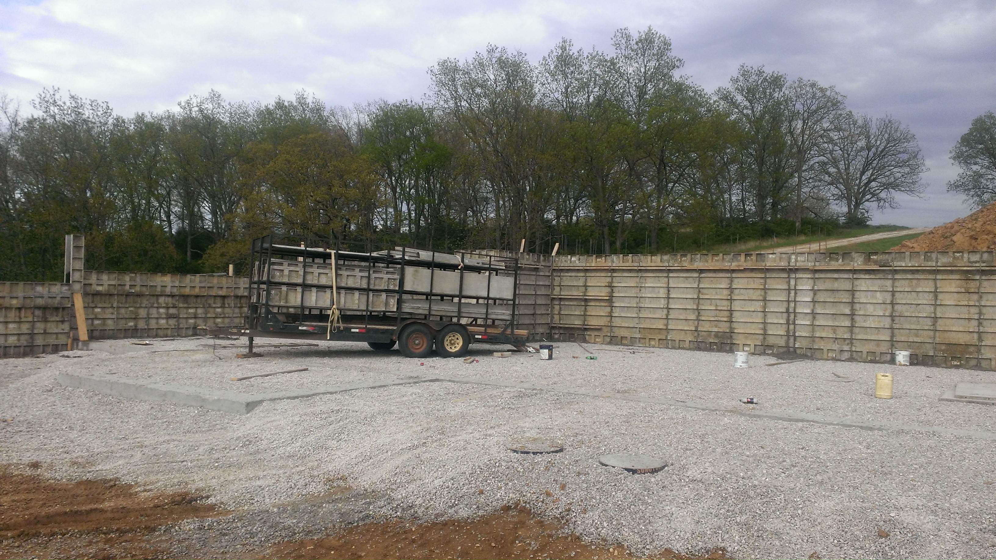

More progress! Foundation and retaining walls were poured yesterday. Forms are still on, so not very exciting. :)
/ New Home Construction #28
Those are some serious forms!!!! Nice to see your contractor has invested in them and not making due with old pieces of plywood or whatever they can find.
Eddie
#29
Yeah, very few contractors around here do the foundation themselves. They sub it out to guys who do nothing but that. You get a much better result, and it takes less time.
