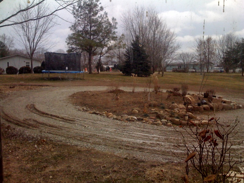

I put in a new gravel turn around this past spring and all was good up till yesterday. All during the year it appeared to be draining good and very well packed up till we had a bit of a warm spell yesterday. I went almost 6 months with lots of traffic on the drive and plenty of very wet conditions and just like that, now its mush (now frozen mush). Building of the drive consisted of box blading down about 6" and laying in some large stone (I believe it was used 52's) about 5" thick. I did not believe I would have any drainage issues. Before the drive was added we would just drive in the lawn in this very same spot and it was fine, no ruts nothing (very well packed). Now I'm in worse shape than before. In the spring I was planning on adding some #9 top stone but I think that has now changed to another load of 52's. Where do you think I went wrong and what would you do to fix it. Is this a typical issue when the frost within the soil melts and I assume there is an excessive amount of water trapped?
And to think I was proud of my very first tractor project.:mad:

Digging down like you did created a trench to hold water. I hear people saying to do it all the time but I don't understand why.
Are the 52's just gravel or does it do have small fines/dust as well? I use ABC which is gravel up to 1.5-2 inches plus fines. This stuff locks up almost like concrete when its set down. The fines help lock the gravel togather. It does not easily move. ABC is what our DOT uses as a road base in NC. I have one area that is just 57 stone and it has rutted up for two reasons, no fabric and no fines. The gravel moves pretty easy where I park the truck.
I used geotextile fabric when I built our driveway. The driveway is at least 600 feet long. The fabric distributes the load from vehicles driving on the drive but also keeps the mud/clay from merging with the gravel. The fabric allows one to use less gravel as well.
My suggestion would be to use geotextile fabric with gravel that has fines.

when you removed the topsoil before dropping down the stones, you created a tub to hold water. The water has got to go somewhere. I betcha if you dug right at the edge of your new driveway with a shovel and just go down 6 inches, , that newly dug hole will pool in with just water. With this being the case, in order to save your driveway , you will need to trench a line leading away from the driveway going downhill. at the end of the trench, if you have no place for the water to run off into like a ditch, you will need to create a drywell filledd with large stones to allow water to drian into. The other thing you need is to lockdown the driveway with mix of fines and different size stones. In my area its called crusher run and once its laid down, compacted and rains a few times, it will harden up like concrete.

I have done several, and short of doing it like an interstate highway, God bless you if you can afford a first class drive, here is what you need to do for a good serviceable drive, for cars and pickup's.
As far as the large stone on the base goes, it seems like a good idea, and makes perfect sense. EXCEPT, as you can see if you do not have a way to properly compact screening into all the voids, it will hold water and you know the rest.
No matter what size the stone you put in mud, it will disappear. No matter how much stone you put in mud, it will disappear.
Because of that, The first thing you need to do different, is use the Geotex fabric. No matter what happens, you won't get mud in your stone. The fabric keeps the mud and the stone separated.
If you are working in an area that is wet, you may consider building up the drive above the grade, for some or all of the thickness your putting down.
Lay the fabric, and spread 2" of #304 limestone, moisten, and compact. If you are too cheap to rent a plate compactor or, the drive is too large, you can drive over it to compact it. If your supplier has a small truck, A competent driver can tailgate this stone for you, and save you a lot of time. Spread a second 2" layer of #304 limestone, moisten, and compact. Spread a third layer of #304, moisten, and compact. "Cap" the drive with a thin layer of #57 limestone, (3/4).
If water tends to settle in this area, consider grading changes, or drain tile to keep it dry.
If you do all this, you will not have any more trouble.

Airic, without drainage you are wasting your money on fabric and additional stone. No mater what material you put down if it stays wet for even a short time it will turn to sh_t. If you don't want to change your grades then consider renting a trencher and putting in french drains to keep the drive dry. You could probably trench down about 18 inches along the edge of the drive and put in 4 inch perf. pipe and fill the rest of the trench with 57 river gravel. This french drain trench would need to be daylighted so what ever water it catches drains out. The key to keeping a good road is to keep it dry. Good material will be bad material if it gets wet and bad material can be made good by drying it.

Remember, the water is causing your problems. And, its going to take a while to dry out, (summer). Especially, if you go over it while it's soft. Your going to have to be patient now.
Yes, you can go on top of what you have. It will rut some, where the tires run on it, because of the soft ground underneath. But, with the fabric, the mud will stay down. When it dries out, (summer), you can fill in the rutted parts, and cap it.
Unless you dig down to China, you have to use the fabric. It does not cost more to use it, in the end.

My opinion is that fabric would have helped, but not been the answer to your problem. Like others have said, water is the problem. Looking at the picture I can't tell if you are trapping water along the edges or not. It doesn't look like it to me. Thats the problem with a gravel driveway, it porus, so rain and water will get into it and the base. The when get alot of freeze and thaw cycles, you end up with what you have. You could ad alot of drains like others have said, but there is still a chance it will do it again next year. The real problem is, as you suggested, the constant freeze thaw cycles.

Do you have a middle buster ? If you do, why not create a ditch on the outside of your circle driveway to give water a place to go. My thinking is you can open a area for hydrostatic pressure water a place to go and it might give the top inch layer a chance to be less saturated. What do you got to lose except gain fun seat time ?:D

Thank you for all your comments and help. I do have slope and before the gravel was brought in we had quite a few big rains. I would observe during and after the rain and there was no puddling and all water would drain off the drive very quick, almost instant. It was highway smooth before the gravel went down. When the full gravel trucks came they did not sink at all and it had rained the night before so I assumed the base was good.
With this being a turnaround and lots of surface area all the drive slopes in one direction. I'm thinking as you state, the freeze and thaw cyles are creating the problem. Water won't drain if its frozen and it continues to accumulate with more snow/freezing rain. I'm thinking that I may have the proper slope but maybe it should be draining in the most direct route off the drive and not in one direction to one end of the drive. This may have been my design flaw as I was taking advantage of the hill it sits on for the runoff. The odd is that the soft spots are at the top of the slope and not at the bottom.
I think I may pull up the drive and start again in the spring and add the geo fabric and perimeter drain as suggested. I did lay drainage pipe for the gutters that run under the drive so I can tie into this. This is a solid pipe that runs to a spring/holding pond for irrigation. I'm going to eventually pour this as a concrete drive but, I'm holding out till we start and finish the house addition. This maybe a few years out

If your ground became saturated because of the area being dug out for the gravel, and the gravel was able to hold water, it could have caused your problem.
I don't think that is the only problem, based on the photo. You simply do not have enough stone there, to hold enough water, to cause this much saturation.
I suspect that runoff, from the surrounding land, goes through this area, wetting it to the point of saturation. This can happen, even on a slope.
If you determine that is the case, you need to divert the water away from the drive area, with a swail, or collect it, with drain tile, or catch basins, or possibly even all three.
No matter what kind of drive you put there, it will not be stable, year round, if the saturation issue is not addressed.
