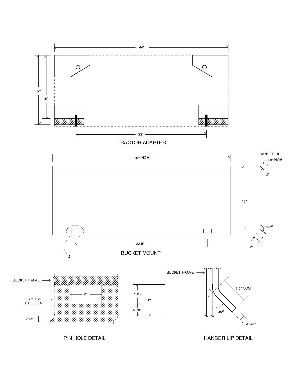

The tolerances for a QA mount are not exactly like those of a camera lens. There should not be slop but a "skid steer" mount is not such a precisely made piece of equipment that it is shocking to find slight gaps. Here is the SAE standard for the skid steer QA mount. http://www.tractorbynet.com/forums/...91d1177387373-here-universal-attachment-mount
I am beginning to see the problem now. Check out the vertical dimensions for your drawing. It states 16 & 5/8ths to 16 & 9/16th. Now check out the drawing dimension given to me...it show 16 inches. No plus or minus. My grapple measures 16.5 inches. My QA tool carrier measures 16 inches. My KMW bucket that came with the loader measures 16.25 inches. So I am thinking there is a difference out there between skid steer and tractor spec. I know, they are suppose to all be the same.................but obviously there are two difference drawings with two different vertical dimensions floating around in cyber space.
hugs, Brandi
The drawing given you is wrong by virtue of being simplistic. Much better referencing is necessary to make parts that will fit.
larry
hugs, Brandi
Brandi look at the drawing again. The 16 9/16"-16 5/8" is the measurement to the edge of the hole at the bottom closest to the tractor/skid steer. The dimension to the left, 15 7/8" is the one you should be looking at. Then If manufacturers build at 16" they allowed an 1/8" for clearance. They may have built at 16 5/8" and that's why you are 1/2" too much gap.
