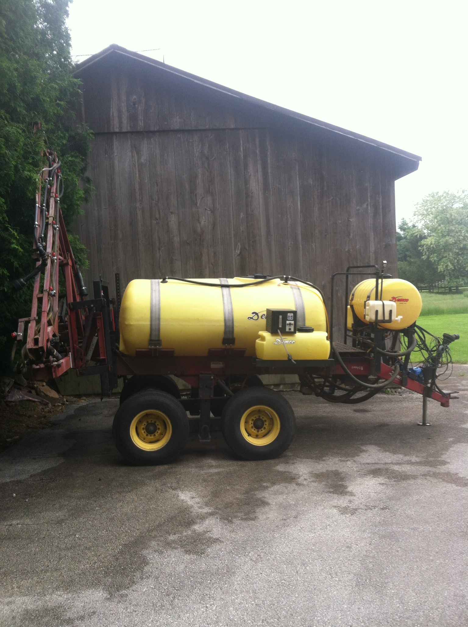

/ New GPS Navigation System #23
My sprayer. Has foam markers
