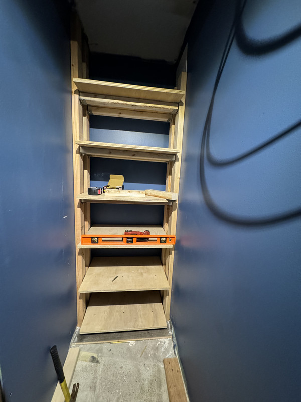

48v = 16 cells in series (51.2v 280ah 14.336kWh)
You would need 6x
Still cheaper than what I got. 🤙 but I am so pleased with LiFePO compared to lead acid.
/ New garage time!
#1,445
Thanks
But I question you actually have 90kwh
You would need 6x
Yes, 6x, that's why there's 6 shelves going into that room. Also they are listed as 280ah, but they test at 304ah which is 15.5kwh, but i just say 15kwh per pack.

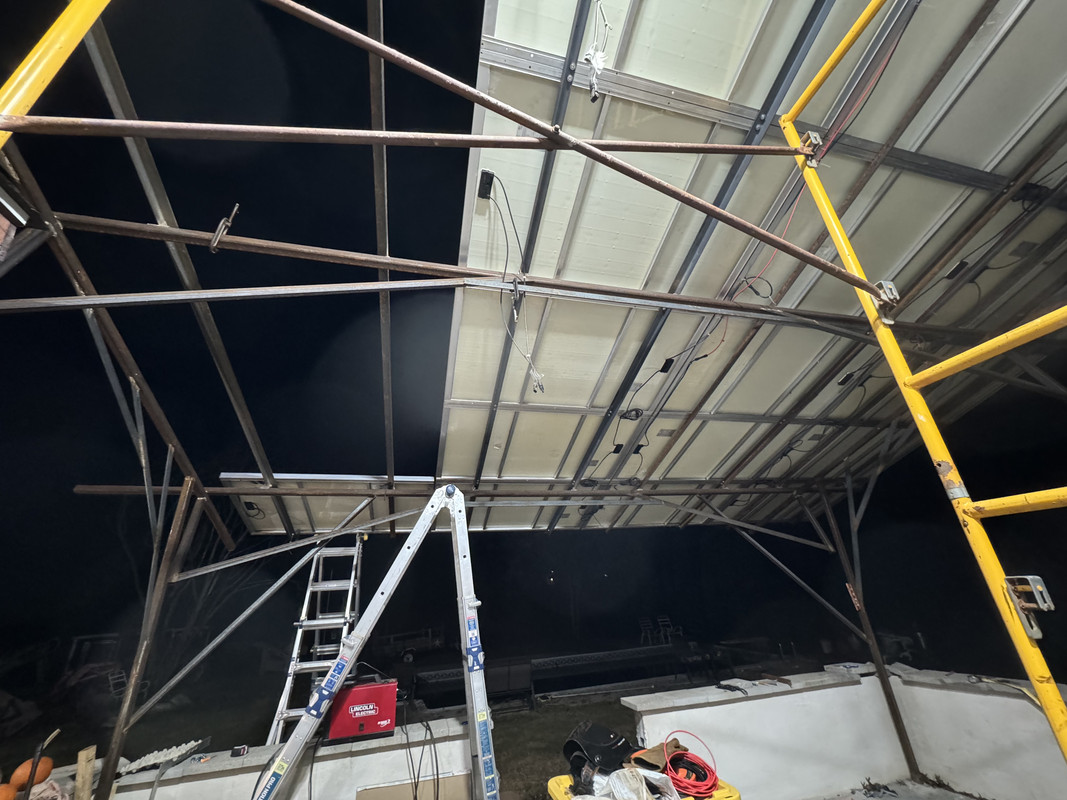

Welded on the 3wk inverter. Peaked at over 3500w welding, didn't seem to fade at all. It's supposed to handle surges to 6k.
Got the 4th set of rails made and up. Broke a bit with the magdrill. That was fun, it spun off and went flying when I tried to go to fast and the bit bit. Tomorrow I'll try to get the panels up. The first one takes a bit getting lined up and spaced, but after that they go up quick.
And finished the battery rack. More cells are supposed to arrive tomorrow, I'll head down on tuesday to pick them up. 600lb in the back of the ocean.
