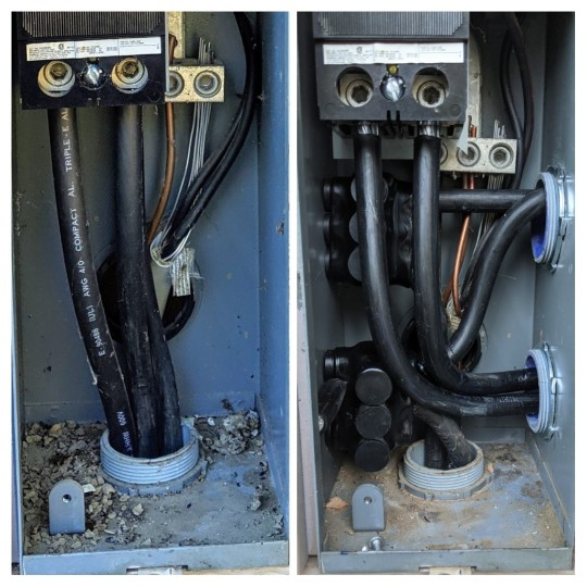

Ingenious use of the buss bar - is it code (honest question, I have no idea)? I used polaris connectors for something similar, though it was also in a much tighter spot
The only code violation i'm aware of is when 3 or more strings are joined there must be fuses.
I got around the issue by putting in-line fuses at the panel connections. The panel wire is 12ga, but the wires going into the joiner are 10ga. When there's 3 or more strings, the amperage is to high for 12ga in the event of a grounding worst case scenario. So between the panels and the wire from the box there are inline 20a fuses.
High voltage arc's, so there's that to consider. However it's 3kv/mm for arcing, so you would need 76,000v to arc an inch.
I'm going to get bigger bus bars to get rid of the strain/bends. The wire is not very flexible. I want it to come strait in.
