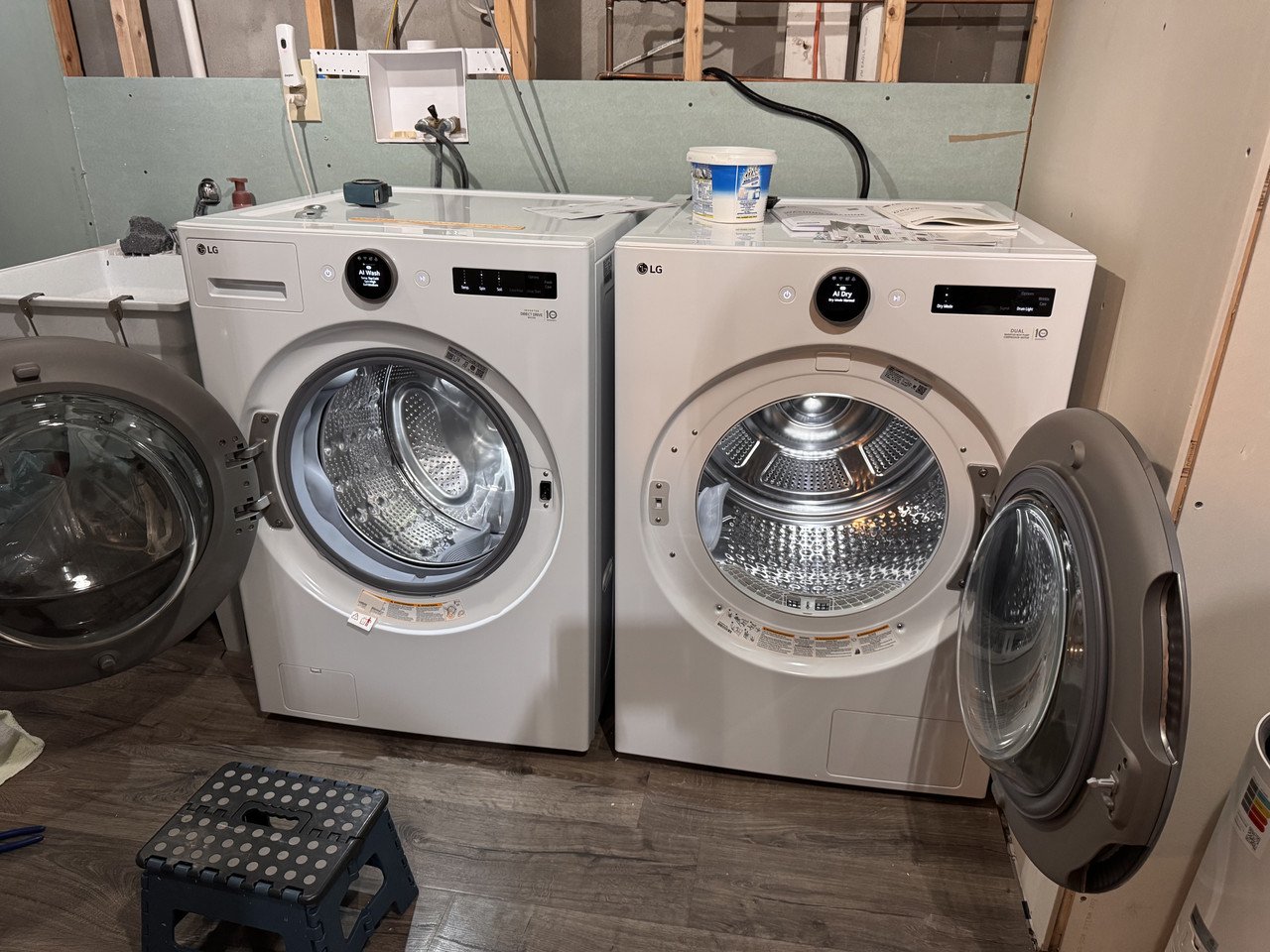

My wife told me to man up, what sort of example am I setting for my son. Get the washer out, it's not that heavy.

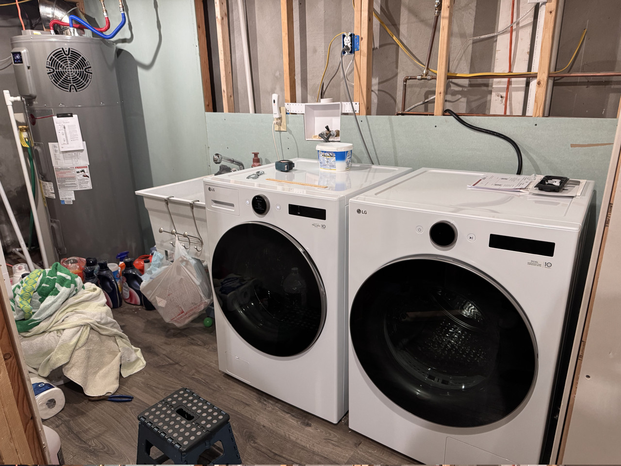

So I did, then got the new washer and dryer in, hooked up, wired up, but not before throwing up a sheet of drywall while everything was out.
2 of 3 heat pumps in place. Dryer is running now and barely notice it.

Similiar capacity, different door design. Virtually same footprint. The doors are bigger than they look, it's sort of an optical illusion.
My wife says she doesn't like hte new ones. They don't look "fancy" with the chrome lining and more buttons than the enterprise. But the new ones have a screen on the dial, in addition to the screen to the side.

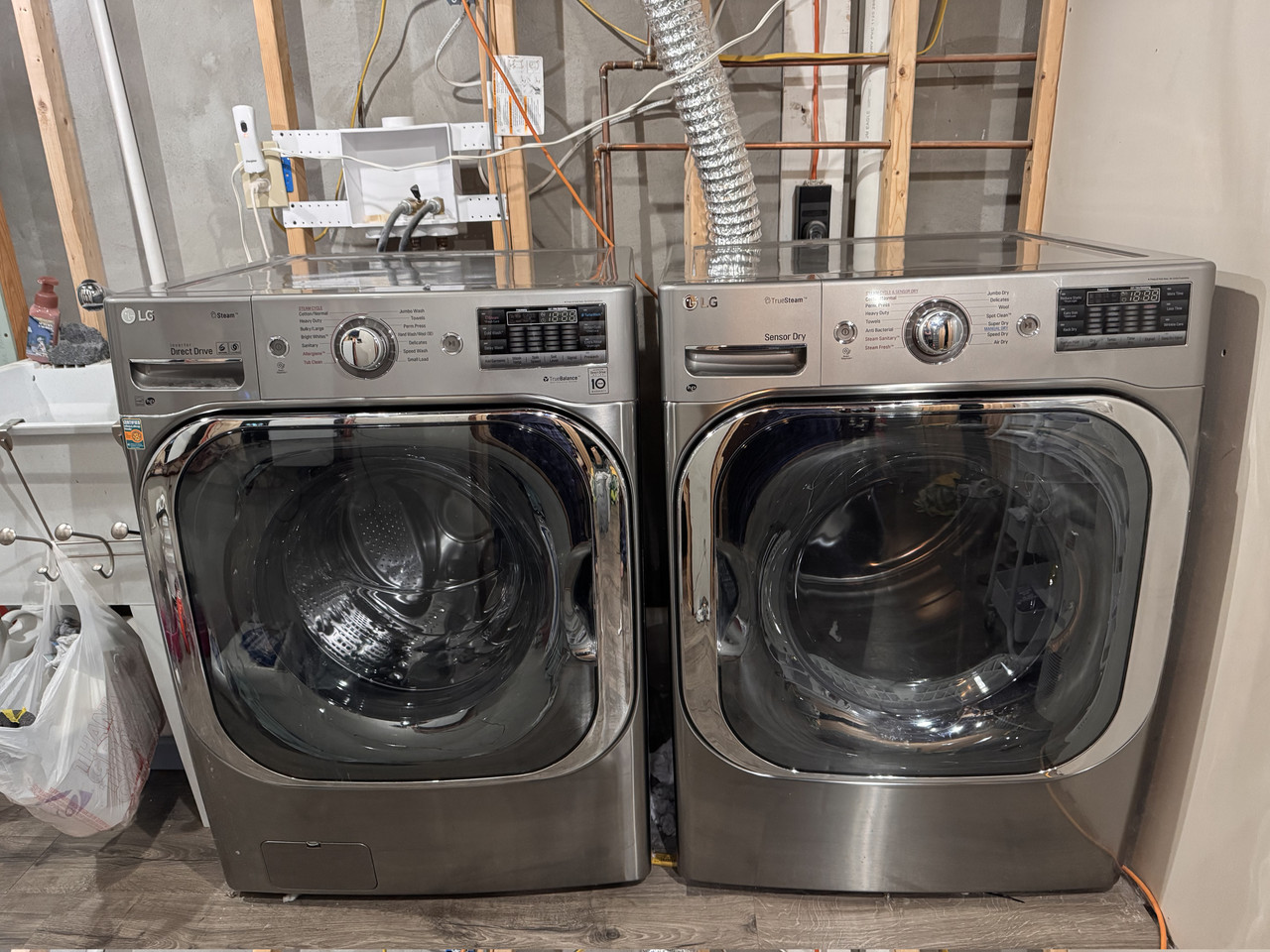

What was wrong with the original washer/dryer? They look quite new, and same brand as the new ones?

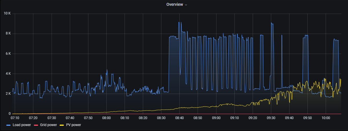

The old ones were 3 years old, still in new condition, and perfect in every way. Except the dryer was resistive coil heating. Which causes massive power spikes.
This is my power consumption when using the old dryer:
And my wife has done 8 loads so far today with the new dryer:

It uses heat pump vs the old one was heating elements. Same as the hot water heater i just installed. So it's still electric, just more efficient. I'll be doing a heat pump mini split next, it's already in the shop on a pallet.

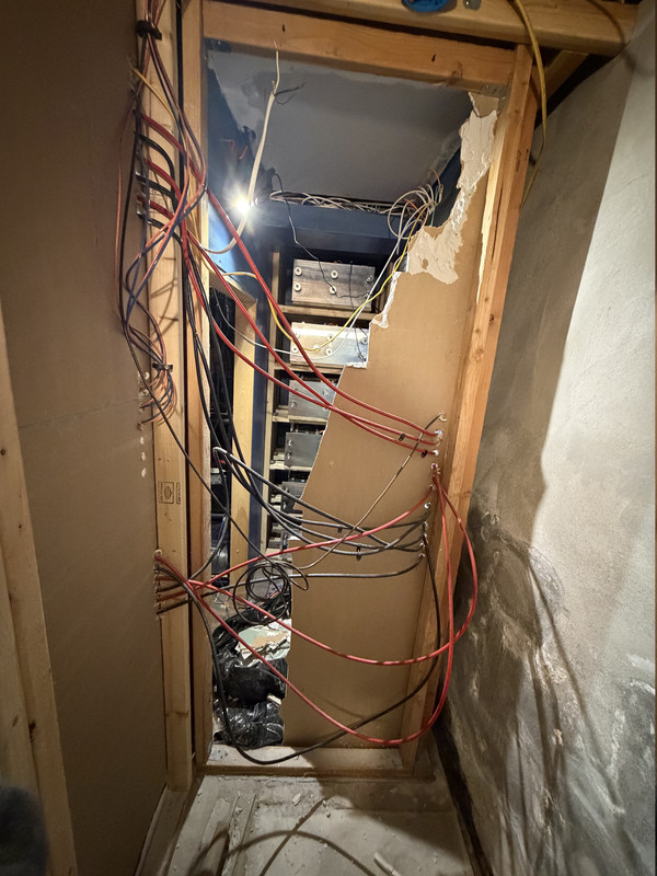

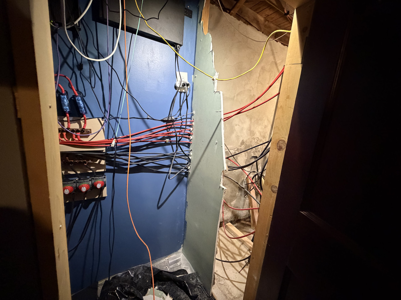

The expansion begins. It'll be fun to route these battery cables from one side to another, without a wall, without unhooking them.
/ New garage time! #1,659
Wow! Talk about spaghetti...
/ New garage time!
#1,660
Yeah, it's hard when there's 2 battery cables per inverter, and they all have to be equal length to the bus bars.
