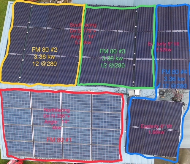

Where are you getting panels at that price?
Marketplace. They're second hand panels 3-5 years old from a commercial installer. The stupid government tax credit is usable every 3-5 years so they do panel upgrades and claim the credit, then sell the used panels off for cheap.
Panels are warrantied for 80% production after 25 years. I have some in place now and they're doing well.

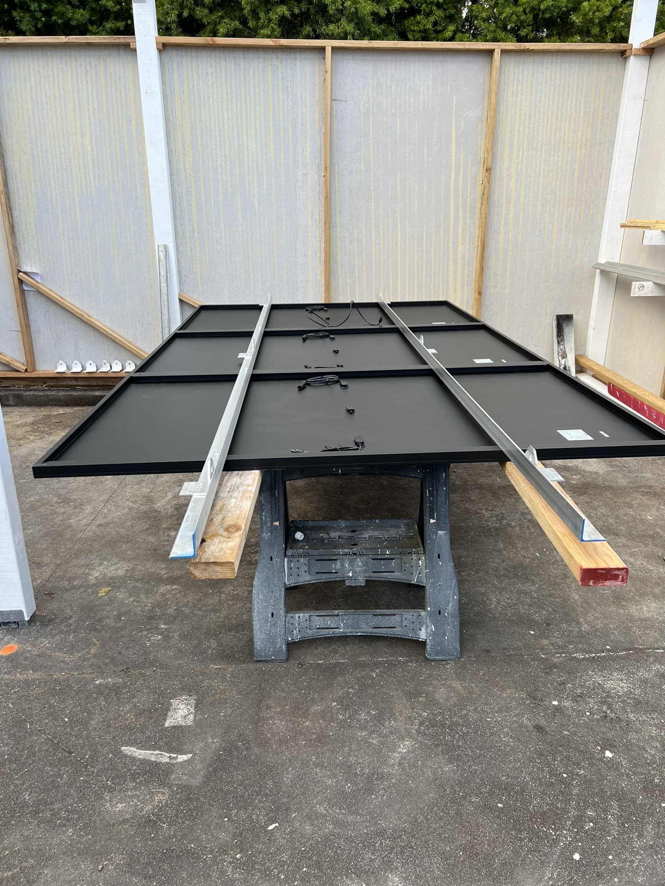

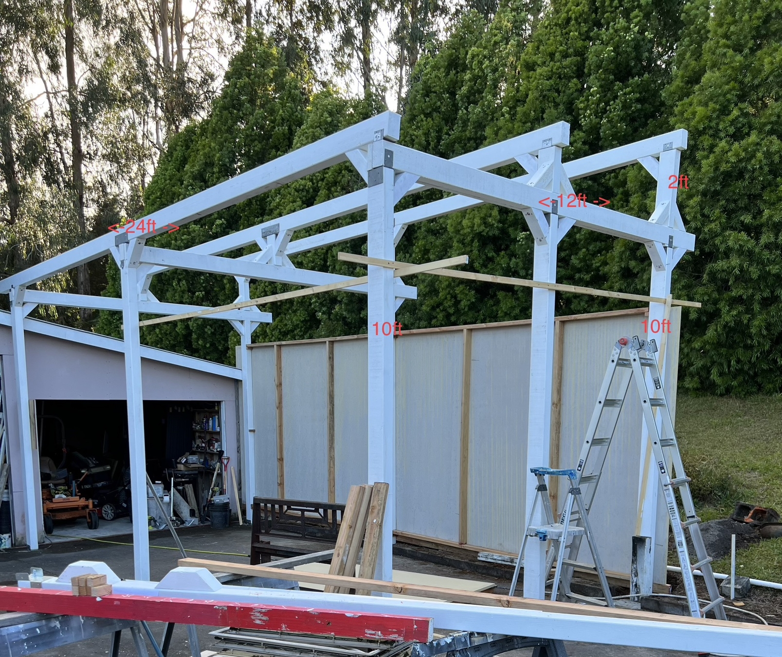

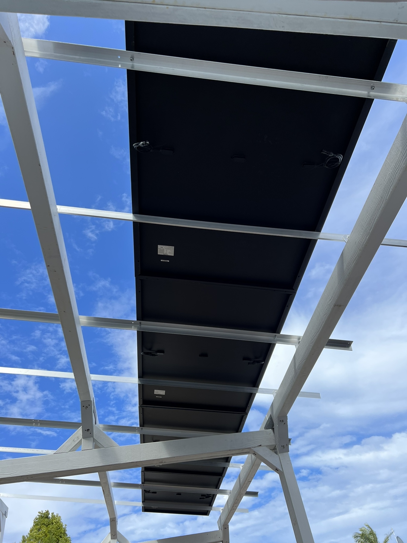

I did a 12x24 solar panel roof a couple years ago. A nice covered area to park stuff. How are you going to address seal between panels? I just ran a bead of silicone, but have a few spots that leak. I I had it to do over, might consider using butyl tape, but there may be something else available these days. Maybe I was too concerned about thermal expansion/contraction. Otherwise very happy with it. I made my supports from 2inch 1/8 alumimum angle
View attachment 877964View attachment 877965
That's exactly what I needed, thank you.
So I wanted to butt them up against each other, but was concerned about thermal expansion. I was looking at a 1/4" gap and using butyl tape even.
So I will have 3 cross members but wasn't sure what to do for the racking. It looks like you have 3 cross members, if it's 12' wide that means a 6' span. Mine is going to be closer to an 8' span, so I was thinking I need something more substantial than angle aluminum. Or reposition my cross members so there will be overhang on both sides.

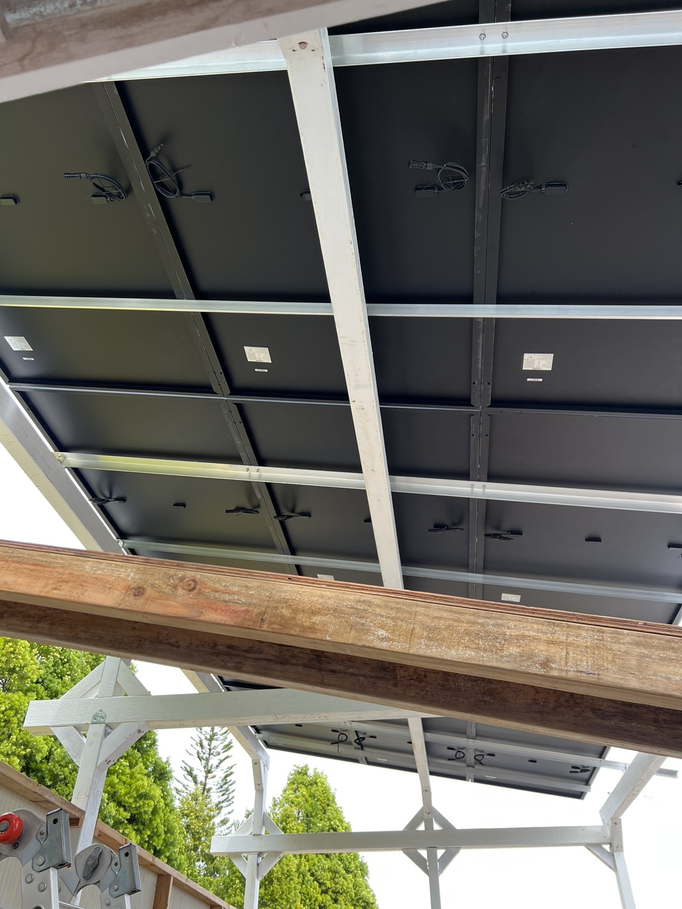

If you think about it, can you get more pictures from underneath?
Before I put the metal frame up, I need to stucco the patio wall. Needed to cut a hole first to walk down to the pool. Now i'm ready for the stucco.

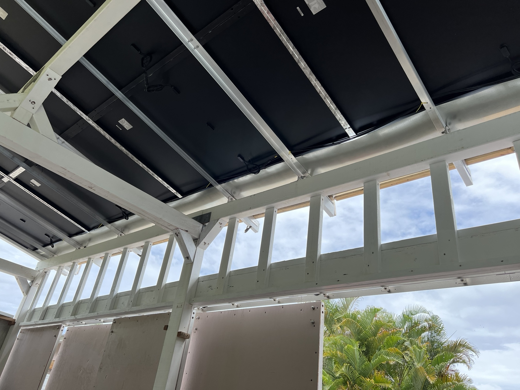

Hope these help
My rails were matched to the PV factory holes
Conceivably, I could have considered slots in the alumimum rails. I used 1/4 SS nuts and bolts. Note my panels were a tad short of 12ft, but that was ok. A 4th row would have been overkill for me, but I did consider it.
Only bolted panels to rails, not to each other. I would use the butyl tape without extra gap. You have a more extreme condition as I only see about max daily 22° temp change (60-82)yearlong. The aluminum sealing tape you see on bottom side was an after thought, would have been more effective on top side.
Hope these help
I agree, wouldn’t go more than 6’ span with my 2” 1/8 alumimum.
I’ve done a couple of PV rackings

Hope these help
Hope these help
That helped immensely, thank you.

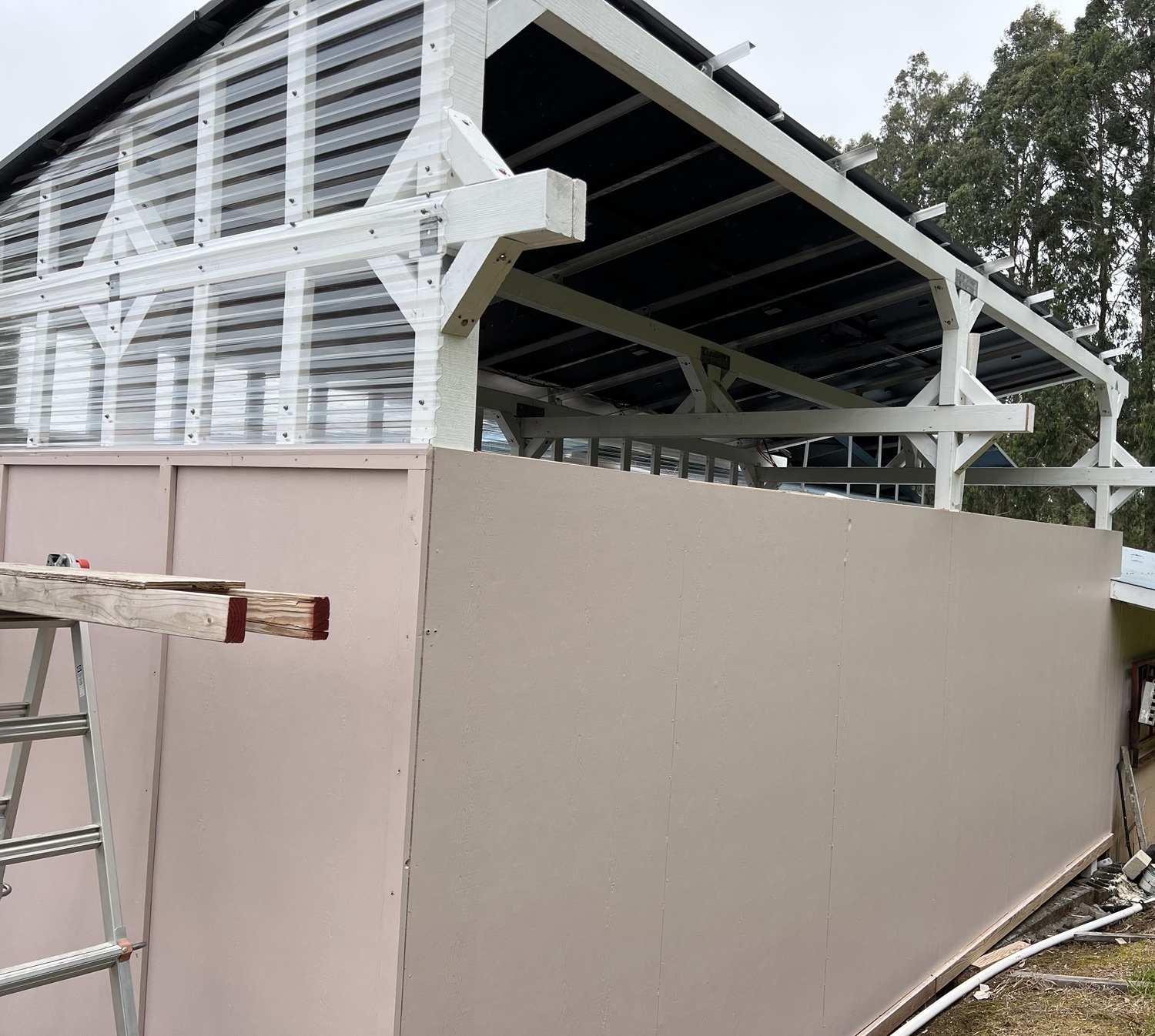

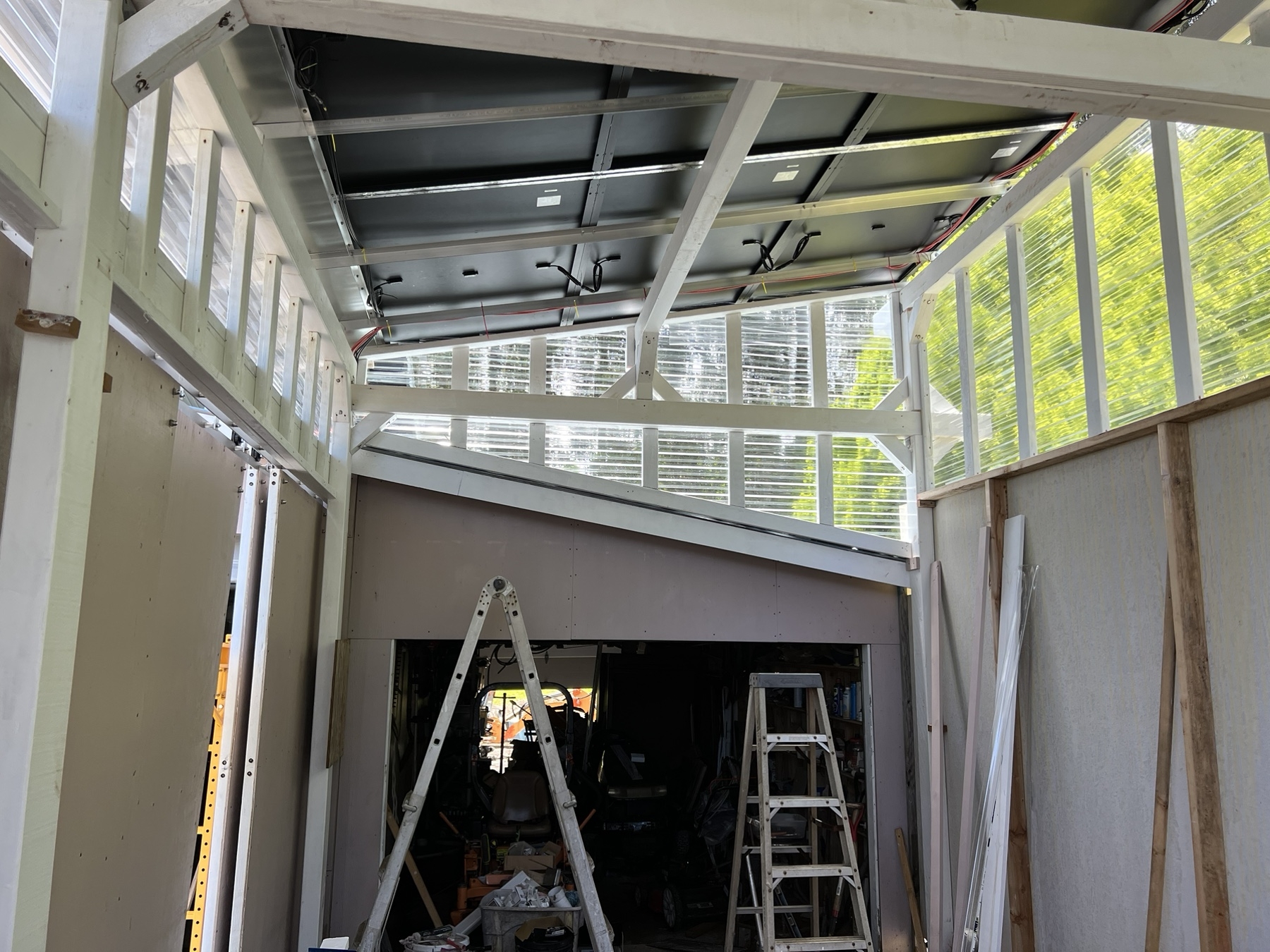

Every night I throw a sack of stucco at the wall. Managed to get everything covered in scratch coat, all interior walls have brown and finish. I do have a bit to do on the wall ends, I need to build that out to be flush so it can be smooth.
I'm no pro at this and it's not perfect, but I think it's good enough to pass a casual glance.
Once that's finished, I'll get the tops back on and glue'd down. Then I can start on the roof structure.

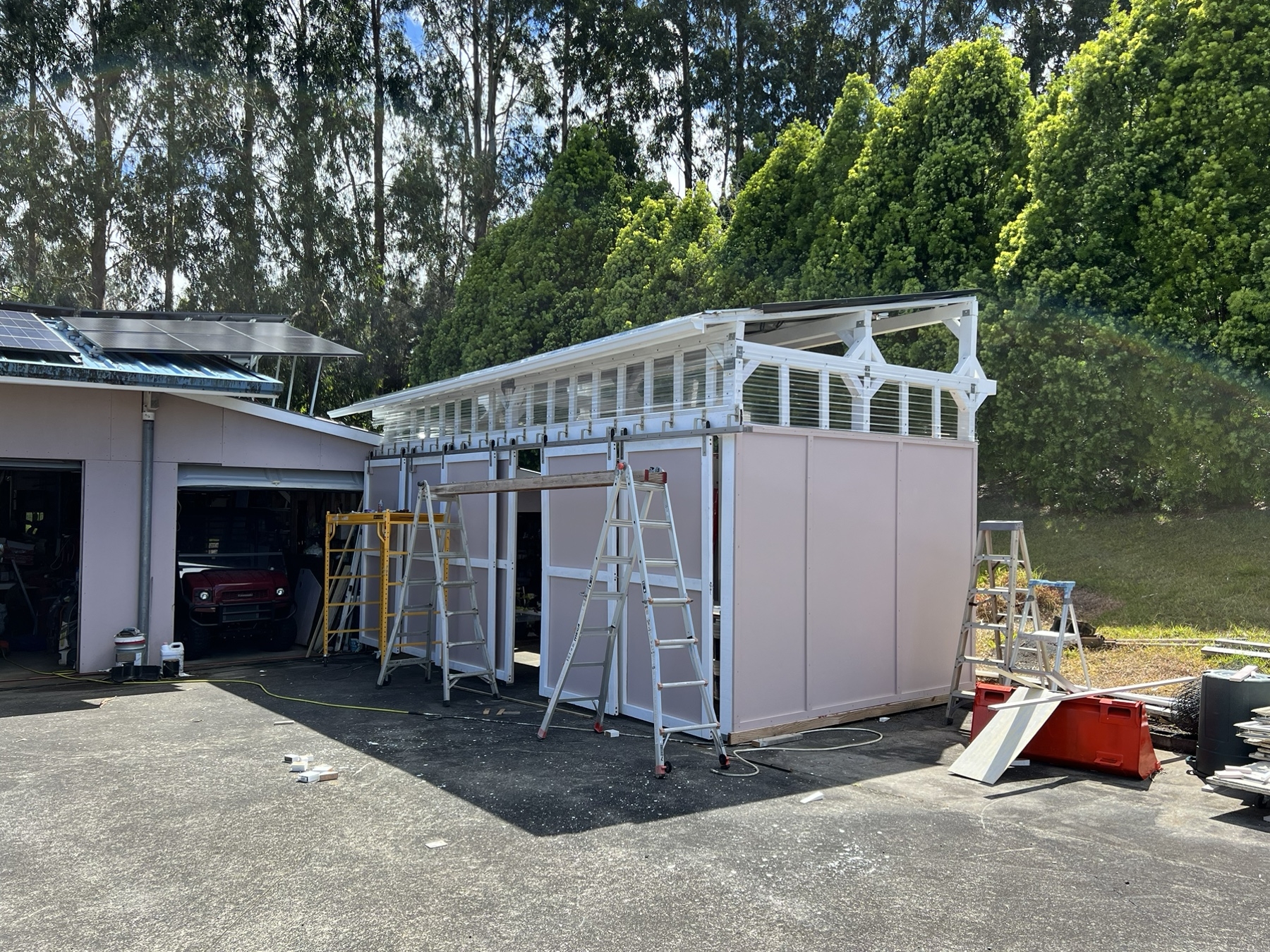

Now that it's a bit cooler, I can get a bit more done.
Signed off from work today, headed to the garage and trimmed around the 2nd door jam, then started on siding. Across the top is annoying, all those 6" pieces 3' wide.
Now off to home depot, i need landscape adhesive and my old tubes i had dried out.
/ New garage time!
#1,278

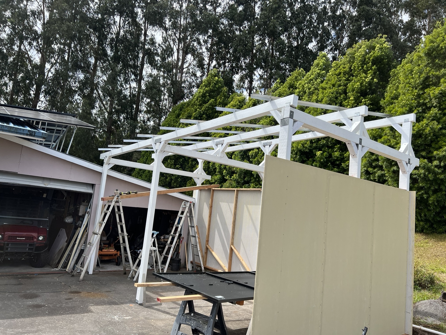

Set the caps on the block, dismantled the solar panels and ground mount, and moved that stuff out. I'm beat and my dogs are barking.
Tomorrow I'll cut the pieces that need cut to fit and set them, then clean up and pressure wash everything.
