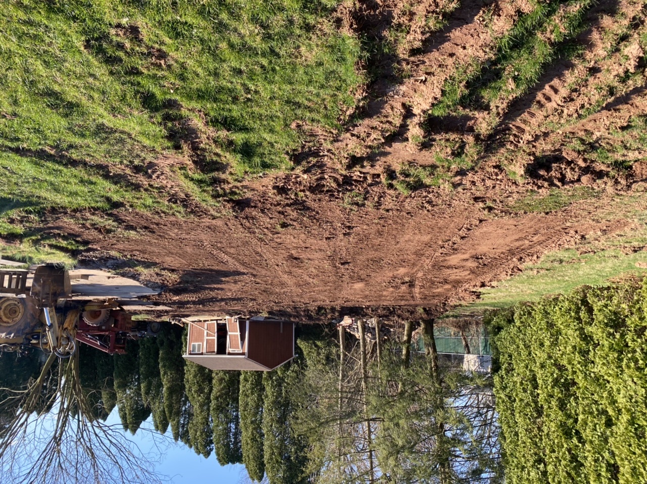

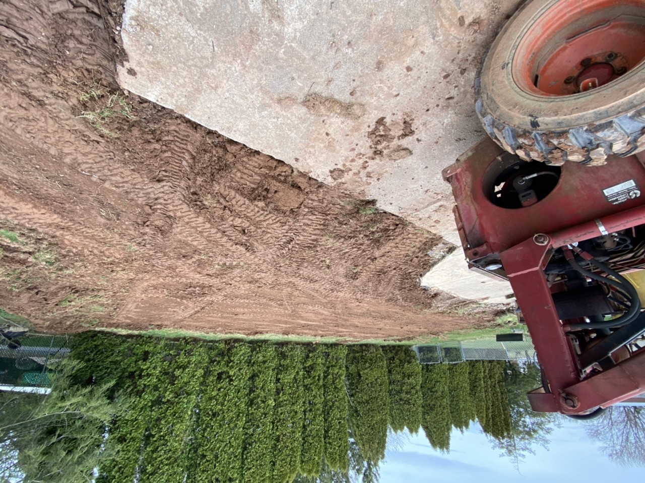

And there's a lot of it.
Finished the footer and dug a little extra at a low point to collect water.

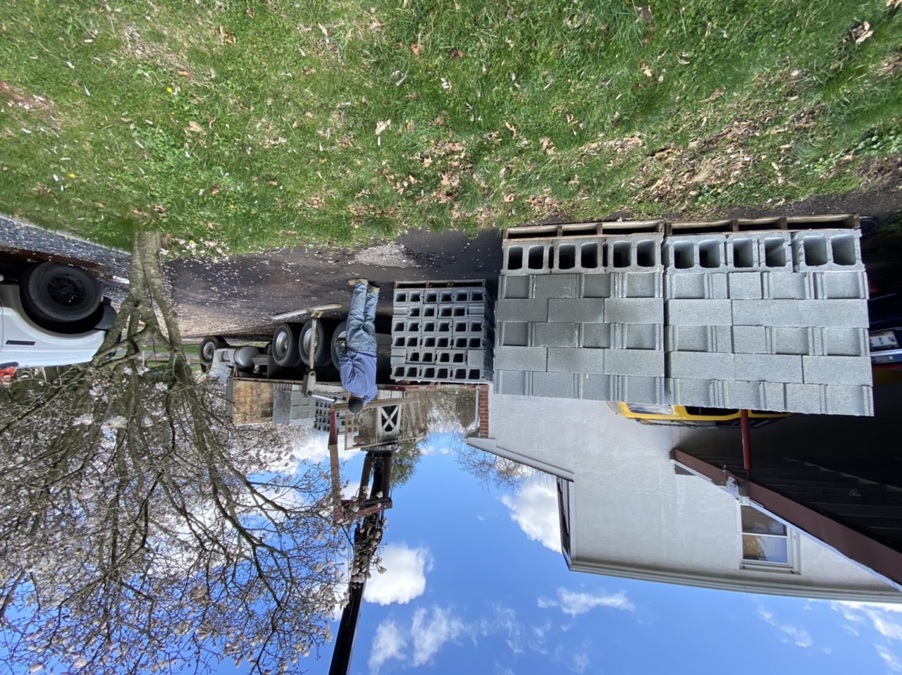

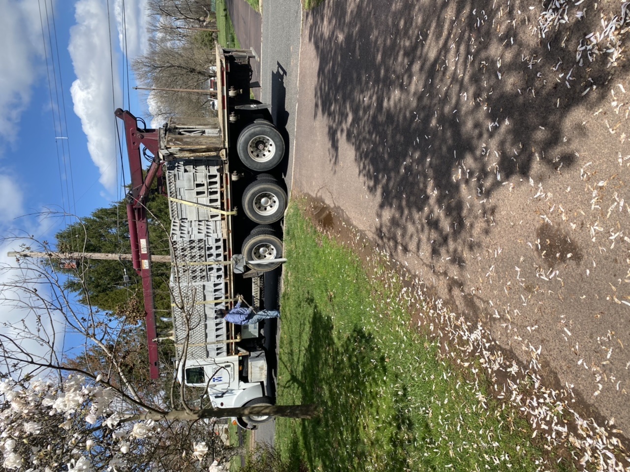

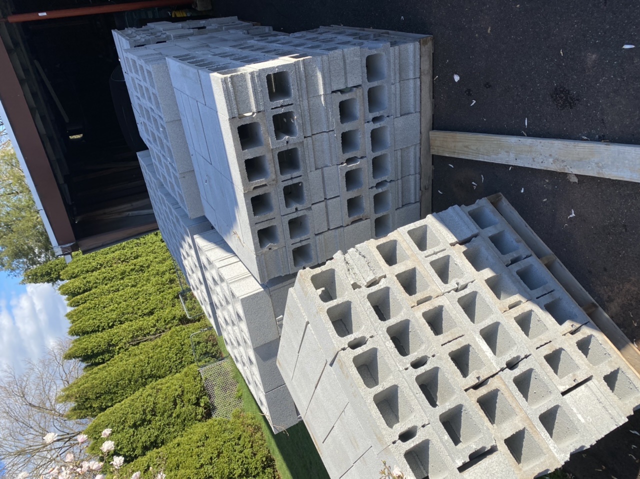

#73
Finished fixing the bobcat, dumped all the fluid and put all new in. The stuff that came out was pretty bad. Swapped the bad clutches, made adjustments, and got rolling. Needed to take 9 12" blocks and 3 8" blocks to each corner to build corners. I was quite nervous.
Here's the video: https://i.imgur.com/KFP8DmT.mp4
