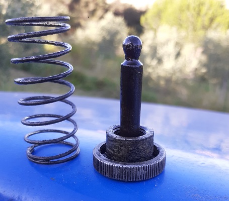

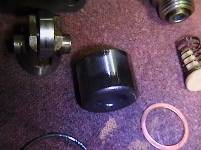

Hi all, I take it that there is supposed to be the primer piston moulded onto the primer rod. I think it is sitting at the bottom of the tube and is possibly blocking the fuel flow, as the machine appears to be starving.
Time for a new primer pump? Jinma 254,Cheers.

Thanks Piper, looks like a new pump on the cards. The unit was leaking a bit as well, from around where the spring sits.

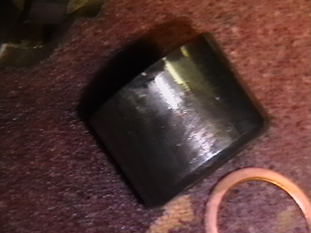

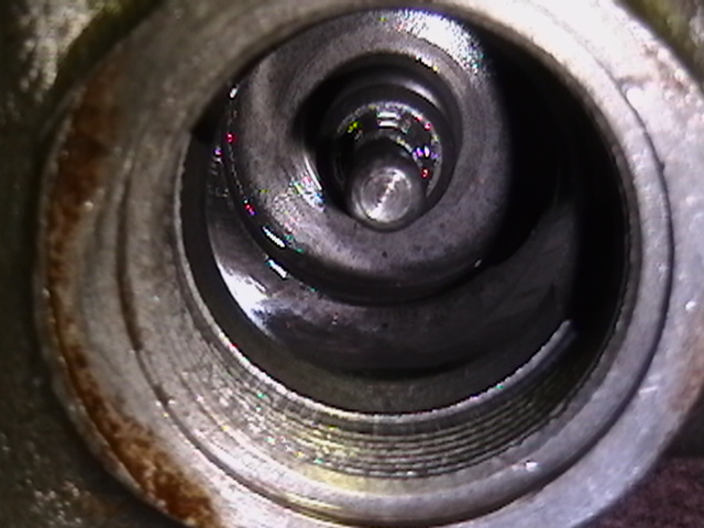

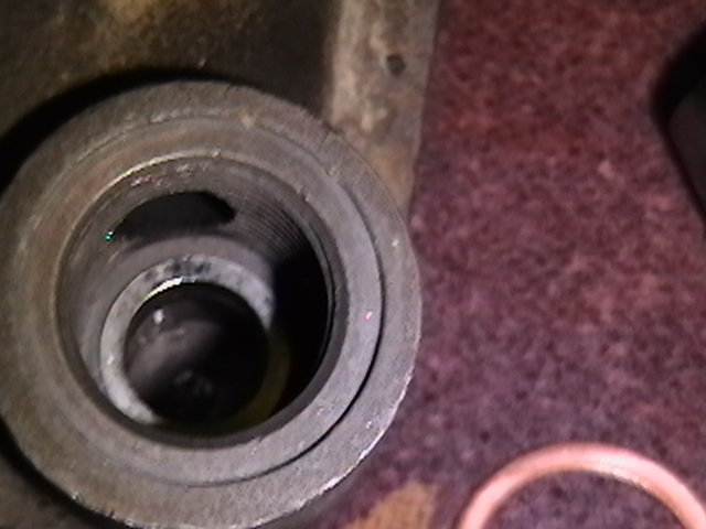

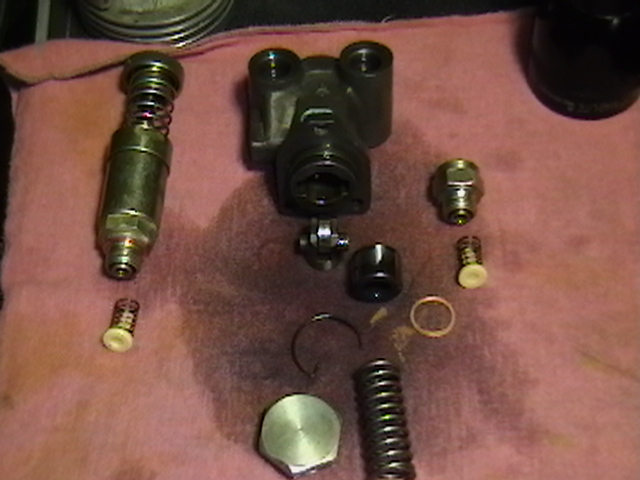

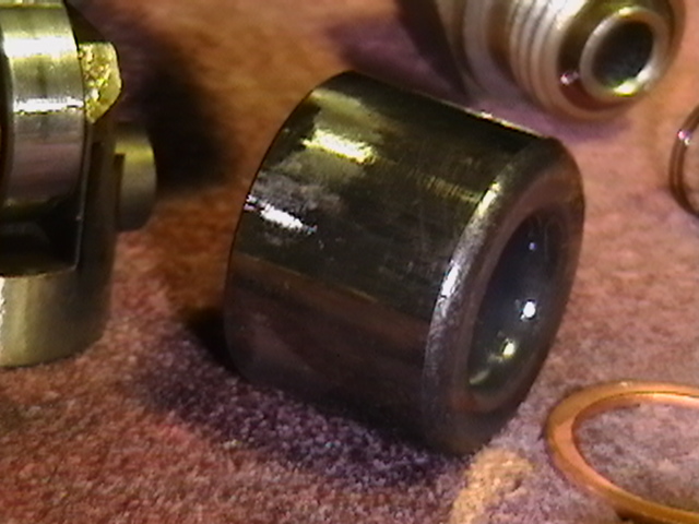

The lift pumps are pretty generic, just make sure the hand priming pump (not serviced separately) on the one you order is on the same side as yours. Better yet, just remove it altogether and go electric.
Pics also show diesel bug corrosion damage. Note pitting on check valve seats. Even the manual pump would not work.
Apologies Piper, didn't mean to steal your thunder. I just had these pics from years ago. Thought they might help.
/ New fuel primer needed? #6
Thanks Bob, good to see what's in there.
Did I mention that I tossed that lift pump too? Went electric and no problems since. I might also mention that my Kubota powered skid steer and the Mitsubishi powered excavator both have factory installed electric pumps.
