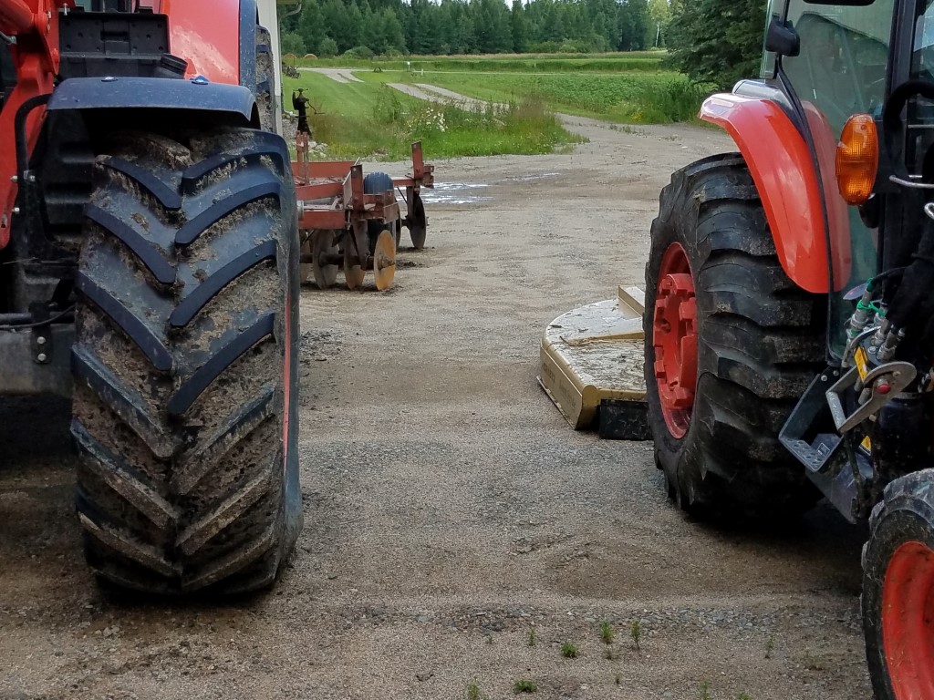

I looked at the BKT and will probably eventually get some for the front. I thought I had a price for them but can't find it. They seemed reasonably priced and I think they had a European looking design. They can still chew things up a bit, especially if the air pressure in higher, the loader is on or you make sharp turns, especially in FWA.
I think there is a guy from Europe or Canada here with an M7040 or 7060 that has those tires on the front. I saw a picture here and am pretty sure of it.
That's me...pretty all the M series sold in Canada came on Metric radials, 360/70R20 was the standard front tire size despite not being listed in the operator's manual or sales lit....
Thank you and yes, that's the tractor. Canada is way ahead of the radials on Kubotas thing. Good looking tractor and I'll bet those tires will pull.
My dealer has been trying to get a set of the 250/85R24's for the front of my M7040 and no luck so far.
/ New Firestone radials on M7040. #23

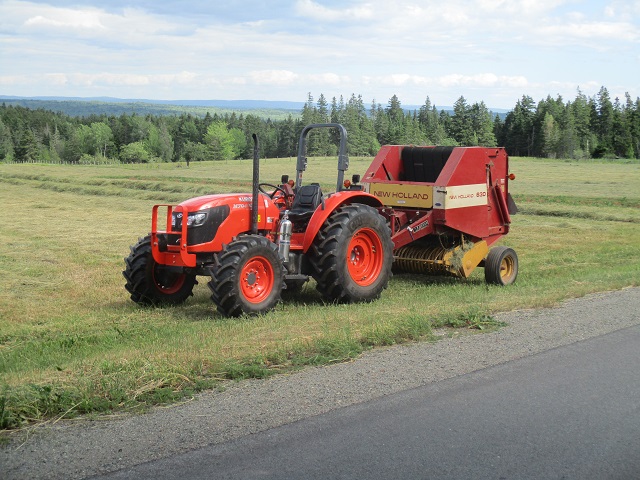

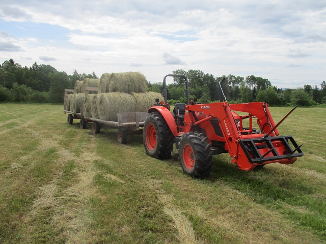

Thanks. That tractor almost floats...rears are loaded plus the cast centers. The fronts carry the loader very well. I've driven over places with the loader on that the tractor hardly made a mark, and the other 2wd tractor with 7.50-16 fronts was sinking in....
Kubota offered the R1W radials standard, where the others had bias ply and the narrow 9.5-24 fronts. The tires were a major selling point on the tractor.
Your new radials look sharp. Ever thing of trying to get 20" rims from Canada? Might be easier, might even find a wrecked one or something.

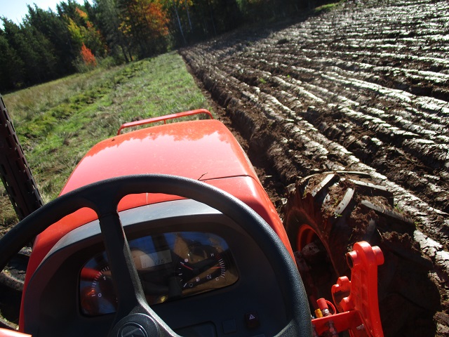

I bought some Kverneland plow parts from Quebec once and it was a costly proposition. I need to find someone across the border--maybe Ontario-- that can buy the radial equal to 9.5x24 and drive across to meet me. I know enough people from Quebec province as well as the Maritimes so here's hoping on that plan. Firestone makes two different radials and other makers lots more.
Your tractor with those tires is a lifetime keeper. Maybe longer. But that soil you are plowing. Maybe I've been to the wrong spot in NS but I didn't see much actual soil/dirt like you have but rather lots of gravel and ledge.

Terrain varies a lot in NS, pretty well all red clay on this farm, go a few minutes away downhill and it's sandy and gravel. The best ag land tends to be near the river bottoms, here's the photo you were asking about, the field being plowed is downhill from this. You can see it's up in the hills.
