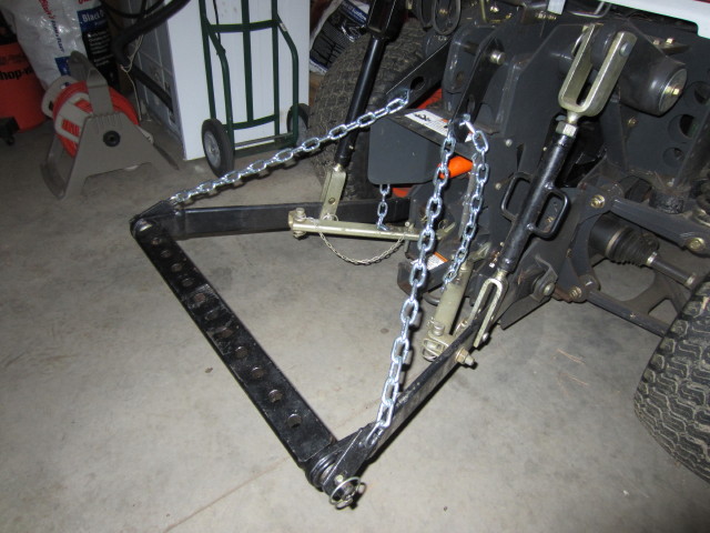

What if you had a set of these sway chains but had springs in place of the chains? You could still raise and lower the blower but when lowered, down pressure would still be on the tractor (whatever the springs were rated at). I had a Yazoo front deck mower that used springs in this fashion to aid traction. If the OP had springs rated for 500lbs, it would lighten the load and put it on the rear of the tractor.

the springs are an Interesting idea but the time you are looking for the most "support" is when the blower is raised because that is when the bouncing stresses the hitch

Clever concept. That would certainly work to add the load to the rear tires, but I believe I have enough weight over the loaded rear tires. I'd be a bit worried about having a set of springs with 200-300 pounds of tensile load each. They would need to have safety cables in order to retain the flying bits if they ever failed, but that is certainly doable. I'll keep in in mind. I believe the issue now is traction. There is a point of diminishing returns by adding weight without increasing the coefficient of friction between the rubber and the road. I just need to get a full season under my belt to get a feel for the areas that could use improvement.

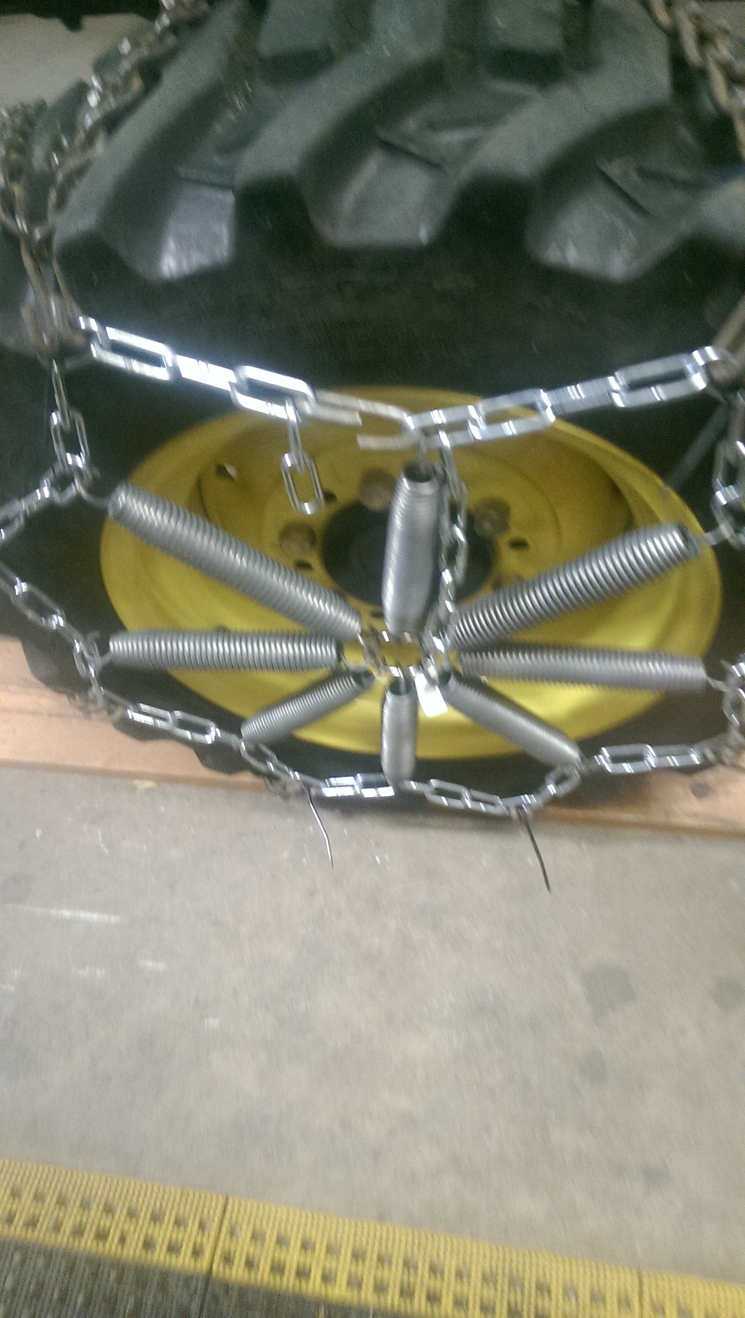

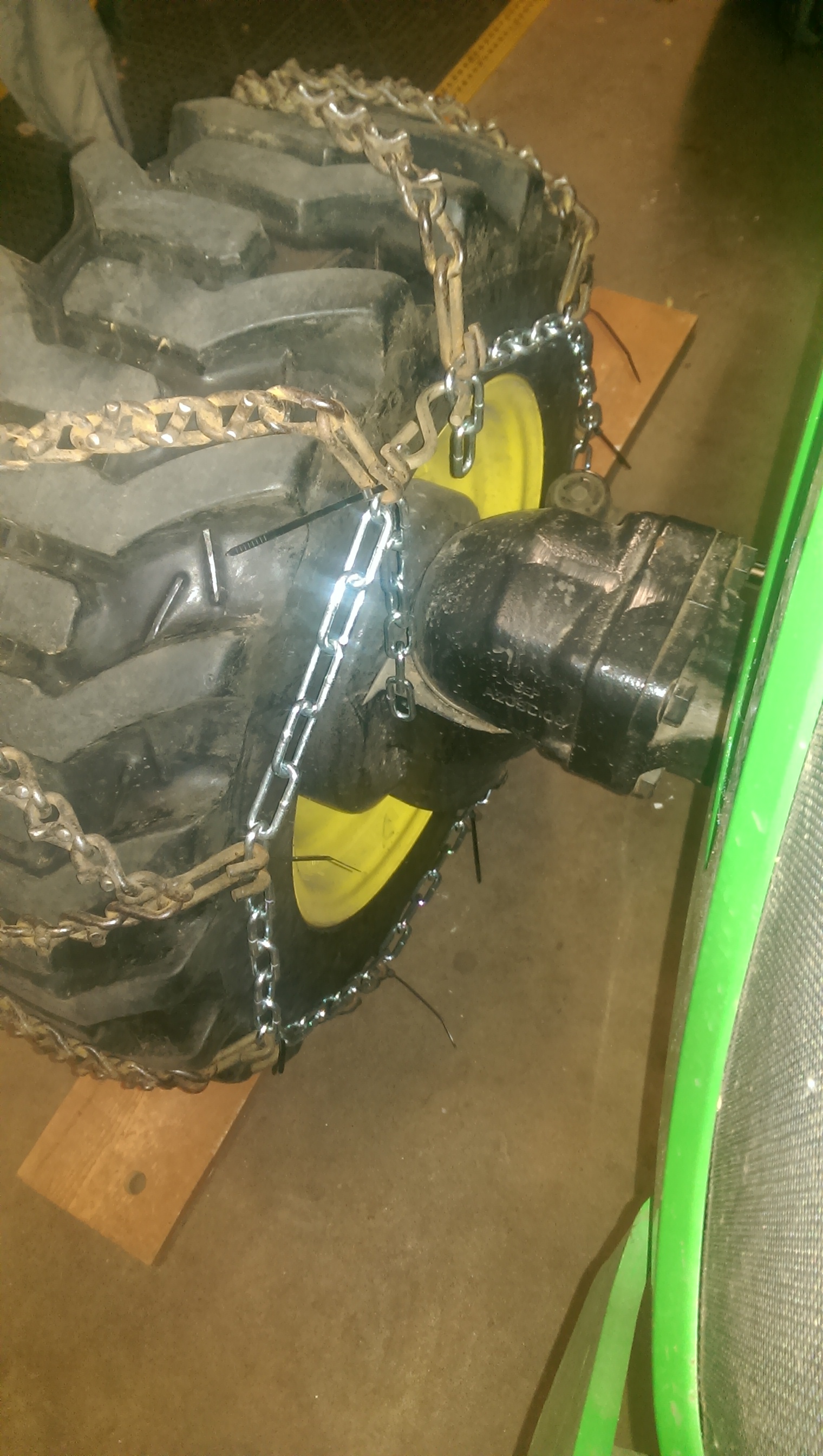

I bought 16 sections for ea tire several years ago at Fleet Farm for my Cub Cadet lawn tractor's rear tires. I scavenged the V-bar sections from the Cub's rear set and made a Jacobs Ladder pattern for the 25x8.5-14 front tires. Basically the sections run diagonally across the tire so a chain section is always between the rubber and the road. I had a 2 link ladder config on the Cub Cadet and the ride was very rough as the tire rode over each chain section. I have 8 trampoline springs per tire that are joined in the center by a 1.5" diameter welded ring. This allows for an easy, loose fit over the tire, but once the 8 springs are tensioned, the chain is tightly secured. This way I don't have to mess around with getting the chain to fit tightly before cinching the knuckle busting over center cam tighteners.

Thought I'd attach a pic or two of the chains with tighteners. I would have liked another section or two to close the gap at the connection, but they will do in a pinch. They only cost me the price of the side chains. i believe it was around $20 total. The springs I found for free.
