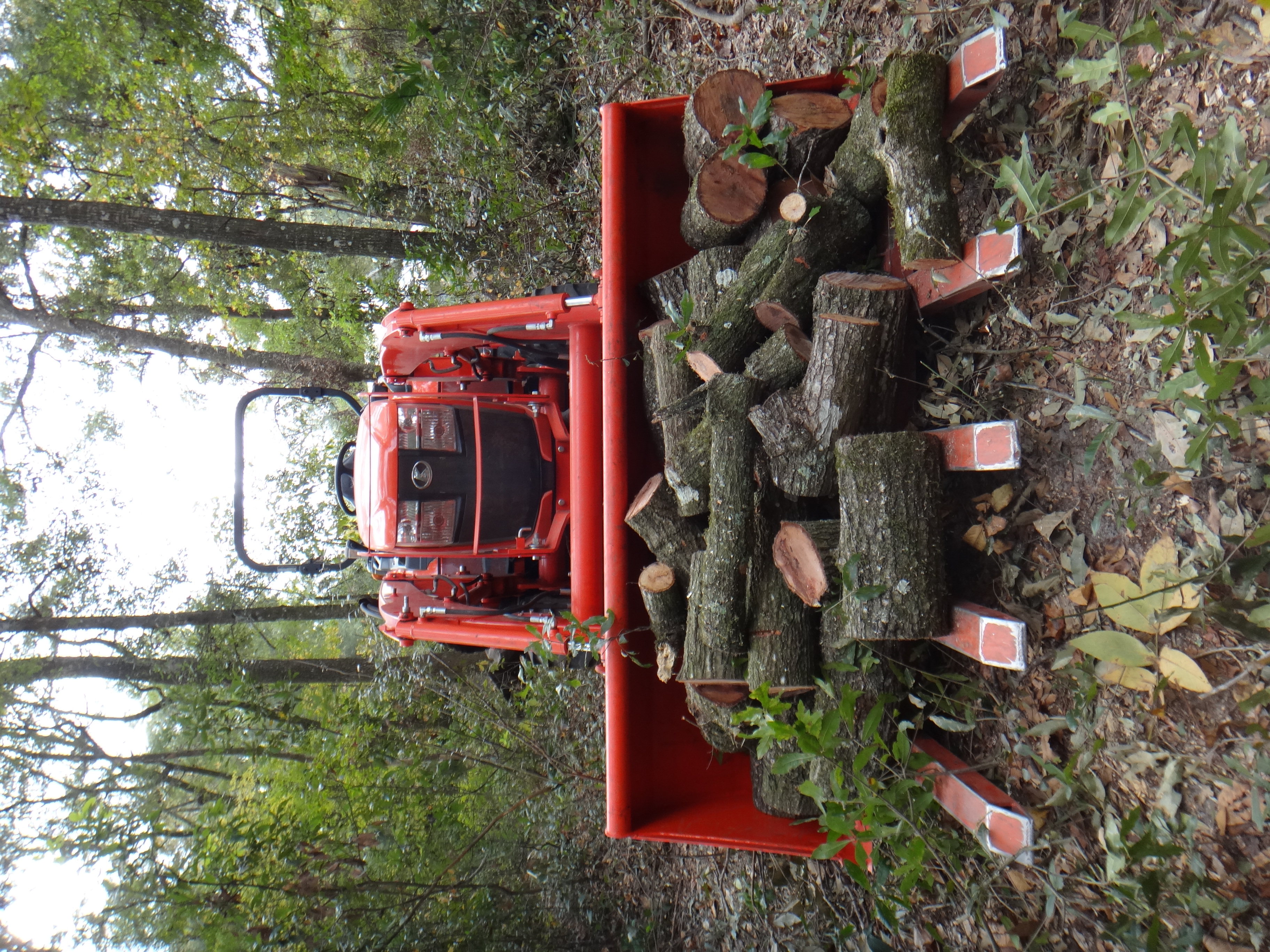

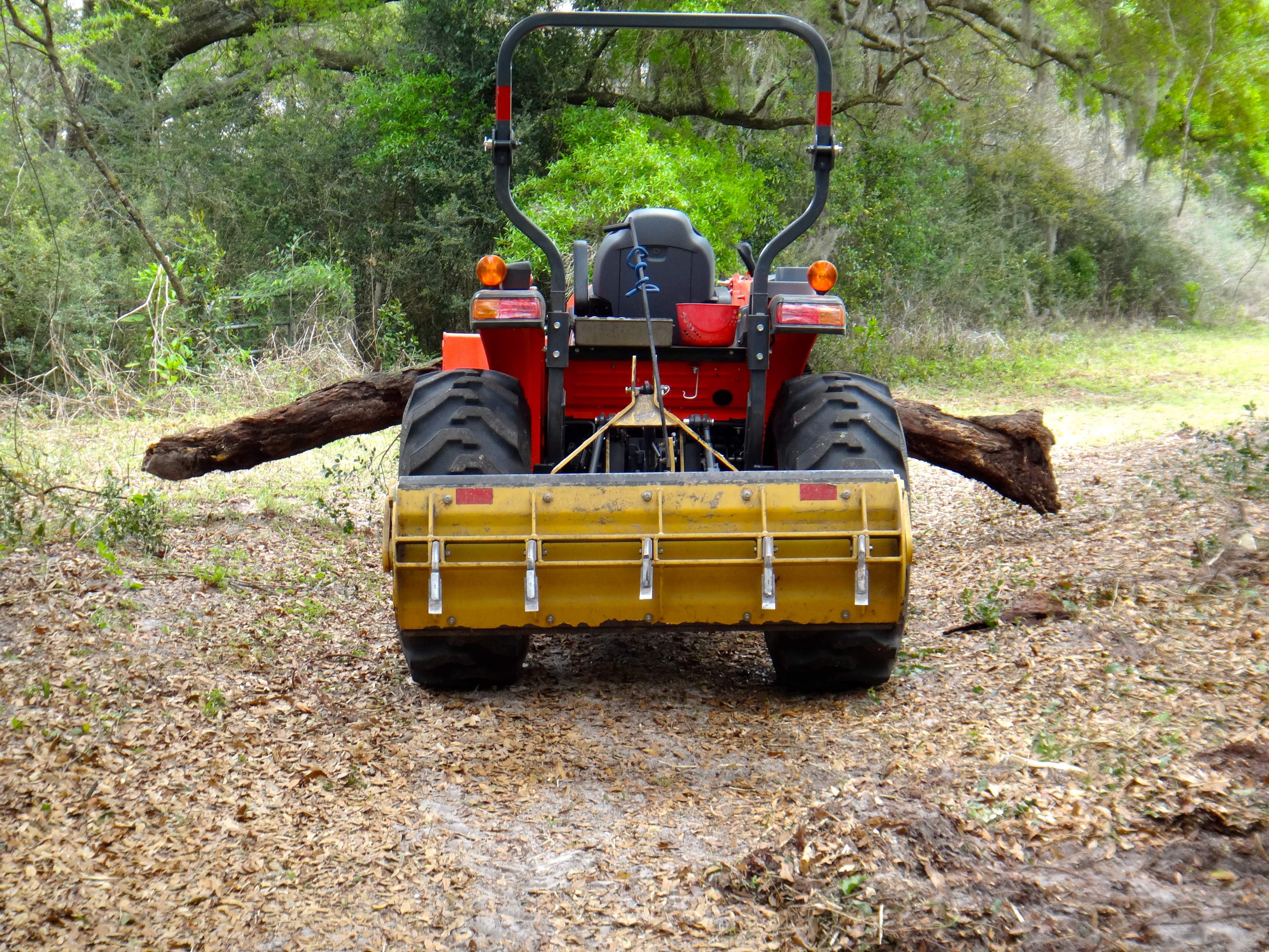

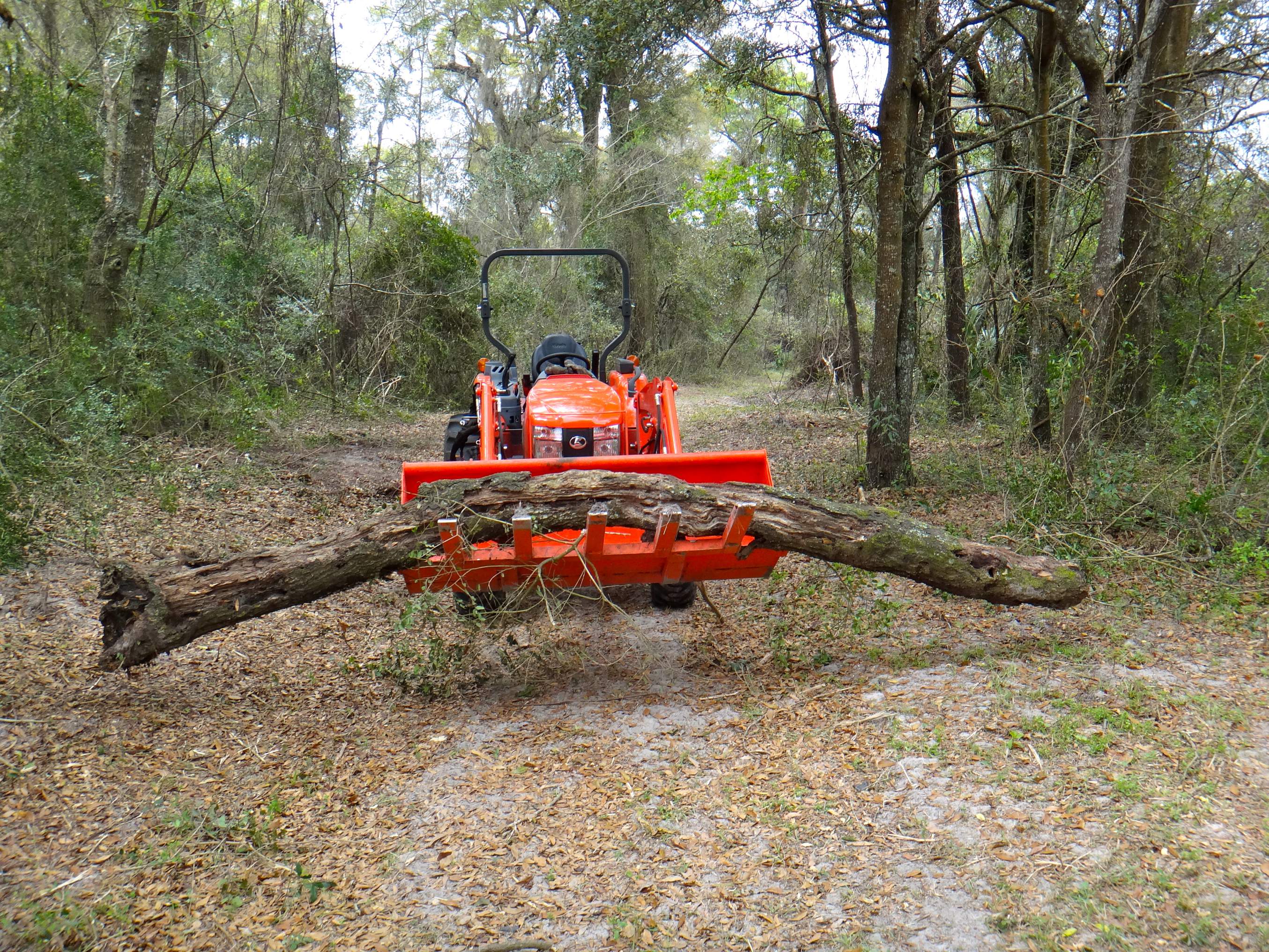

I burn wood for heat so I will need a Loader to move trees and firewood.
Buy a stick of 1-1/4" PVC pipe. Cut PVC to tractor width, 74" long. Walk the pipe through the gates on your new land, barn entrance and into the woodland, to see how a 74" wide tractor will fit through your conditions.
A Loader bucket is almost always used for transporting firewood.

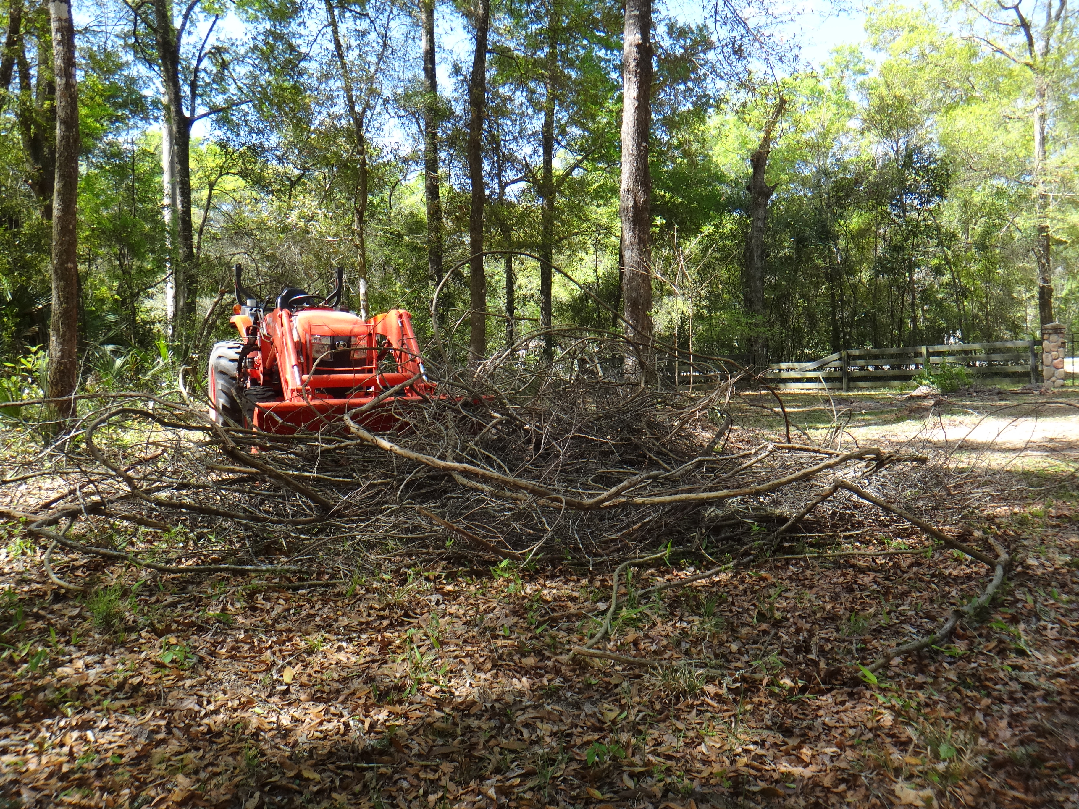

A Ratchet Rake bucket attachment is very useful in woods work. It tears vines out of trees. It is also useful for light grading and food plot development.
VIDEO: ratchet rake brush clearing - YouTube

I burn wood for heat so I will a Loader to move trees and firewood.
