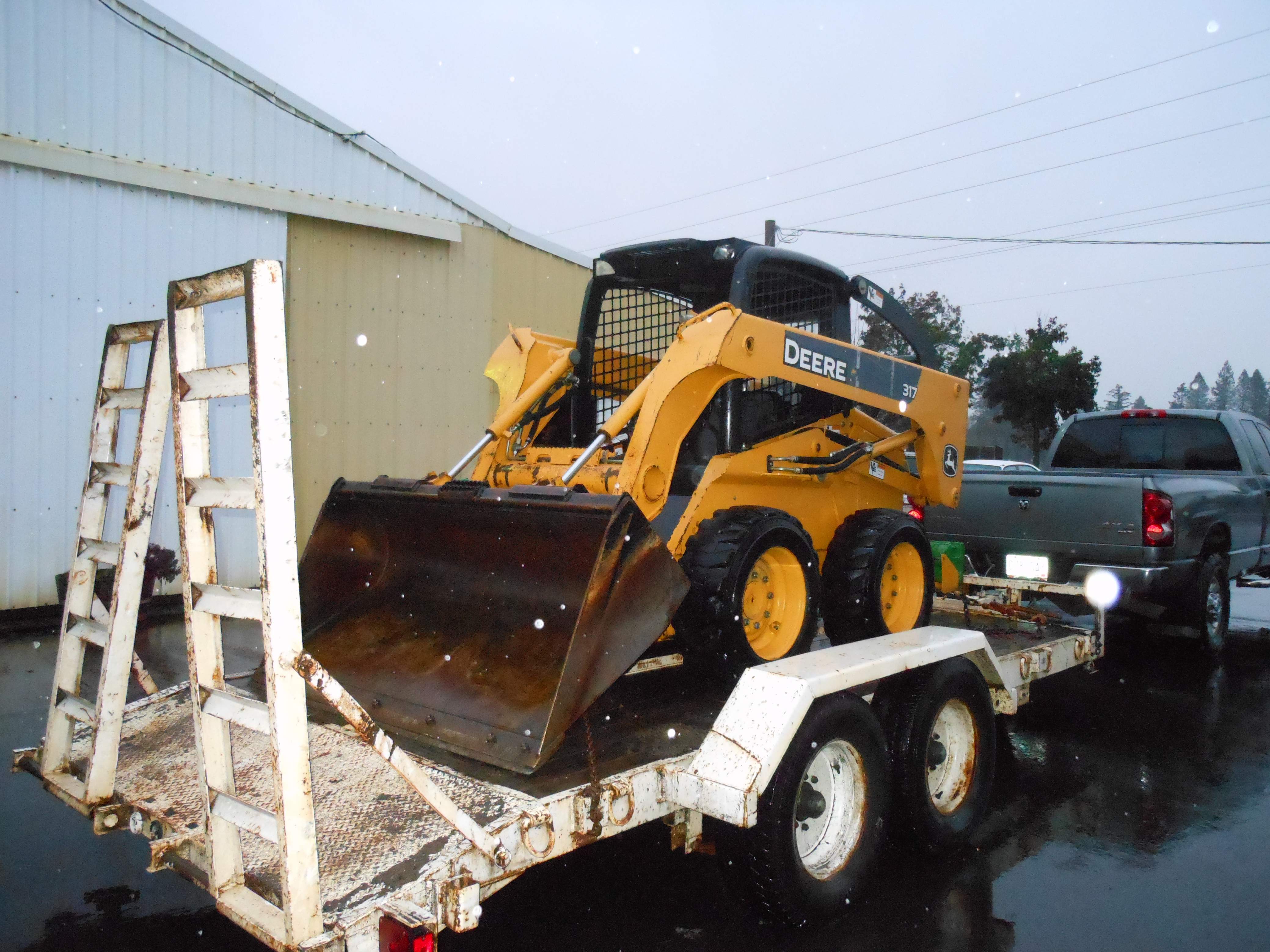

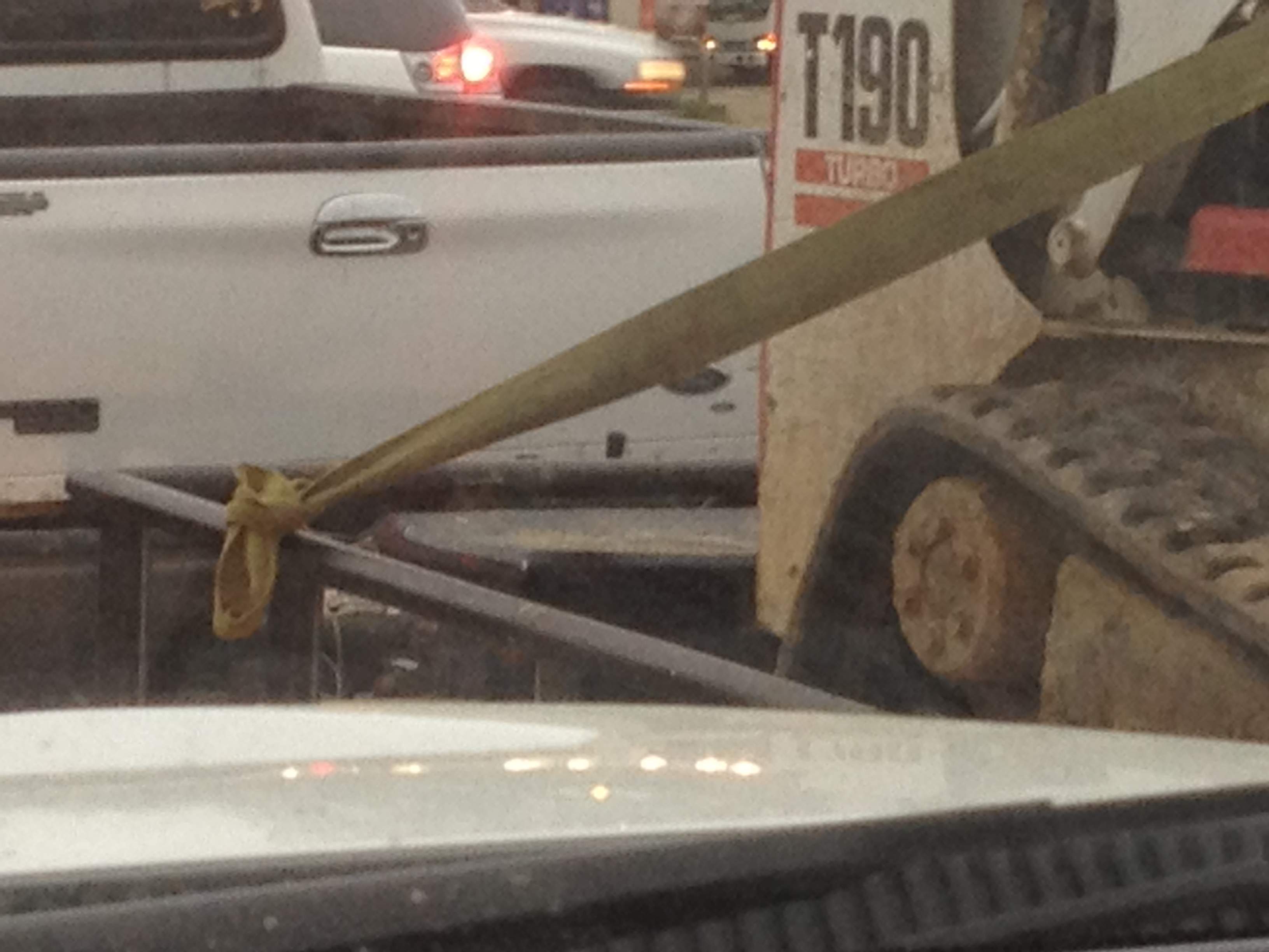

While taking my Kid to school this morning we came across this. The strap is pretty bad but it's also a light duty trailer, with 3500 lb axles. They were driving 65 to 70 down a 4 lane hwy in rush hr traffic.

Hmm, the only thing that strap is gonna do is prevent the skid steer from sliding backwards off the trailer. What happens though if the driver stops fast? :confused2::confused: I also couldn't help but notice that his track is loose, if he lets it be the sprocket will eventually put unnecessary wear on the lugs in the tracks. :confused2: All I can say is i am glad that wasn't my skid steer on that trailer, mine gets strapped down with several chains and binders. :thumbsup::)

I'm a retired truck driver with lots of flat bed and some low boy experience. The rule is pretty much that the load needs to stay put in the trailer under all driving conditions. That's my wording, not the law's.
That driver in your photo would not need to use any additional securement if the skid steer would fight tightly in the trailer on all sides as long as the trailer is sturdy enough to handle the driving conditions and, of course, the truck and trailer are legal in all other respects. You do not need to strap, chain, etc. your load if it will not shift. It is not required that the load be secured enough to stay on the hauling vehicle if it rolls over into a ditch, etc. but it better stay in place if he has a 'typical' fender bender. Load shifting is prohibited.
The pictured trailer and load has several obvious problems. The sides are marginal appearing as far as sturdiness, marginal as to whether they are high enough to keep the skid steer from tipping out on a hard turn, and obviously the machine doesn't fit tightly in the trailer so it does need to be chained or strapped properly. Clearly no knots except for tarps and other load coverings as long as the coverings do not shift.

in Louisiana you have to have all equipment chained on 4 corners and all buckets have to be chained down as well. he is not even close to being legal here. You are right the trailer was way to light, the wheels were tilted inward and the tires were riding on the edge of the tread.

From looking at the machine I don't think this person cares one way or the other. In NY if it is not secured in all 4 corners you will be looking at a ticket. Maybe he thought the strap was a ribbon and he was just gift rapping it :D

Besides the lack of secure bindings, that trailer is a light duty car or landscape trailer, not really designed for that type of load. I have seen similar knuckleheads tooling down the road, I think the worst one I saw was a Mahindra 4510 cab tractor on a trailer like that with the bucket up so the rear scraper box would clear the taillights....and bound down with one strap.

That's his version of the "truckers knot" for that strap so that makes it legal. :laughing: Looks like an Axeman candidate there.

What's the weight of a T-190? somewhere in the neighborhood of 7800 to 8000 pounds right? That's about 4 times the weight of that utility trailer, maybe more. So that's roughly 10K being pulled by that F-250 and it looks like the weight distribution might be a bit heavy on the ball.

i see that all the time here.. a skidsteer on a landscape trialer.. usually no tie downs, and it parked unevenly on a pile of limbs.. or pulled too far front or rear.
at least that one had a 3" strap on it.. somewhere... :)

A T-190 weighs 7775 lbs or 8200 lbs w/ roller suspension, plus 28 gallons of diesel at what, 6# a gallon?
So if it is roller suspension w/ a full load of fuel = 8368 Lbs.
3500 axles x 2 = 7000 minus what, 1400 for the trailer? So a trailer payload of 5600#, so 8368-5600= 2768 Pounds overweight or almost 50% of the axle capacity overweight.
THE TRUCK= GVWR Maximum 9600, The weight of the truck, assumng it is a 2010 model year = Curb Weight MT = 6092, plus 28 gallons of fuel at 6 = 168 + driver maybe 200# = 3140 pounds of cargo and trailer.
Tow Capacity (Maximum) 12500
Truck = 6092
Truck Fuel = 168?
Driver = 200
Trailer = 1400 ?
T-190 = 8368
T-190 Fuel = 168?
Misc stuff = 104
+__________________
16500 on the hoof.
-Tow Capacity (Maximum) 12500
-_____
TWO TON OVER, or 4000 POUNDS OVER on the GCVW
and 2768 Pounds OVER on the trailer.
