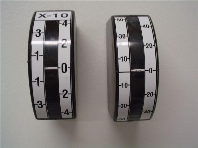

Hi Guys,
Here's the new model on left, and original on right.
I shifted scale 5 degrees higher, tilted body back 5 degrees,
and made numbers larger and X10.
Thanks,
Rick

I think the larger numbers will make it easier for old foggies, of which I am rapidly becoming one of. /forums/images/graemlins/grin.gif

/ NEW DUAL AXIS SLOPE INDICATOR #67
Rick, love the changes! /forums/images/graemlins/cool.gif
How will this connect to the tiltmeter? Still on one side?
#68
Hi Mke,
I plan to offer two placement options for the dual axis part.
One on the side, and one on top. Not sure how to go about
it though. Two part numbers, and buyer must request
which one he wants? Confusing? I do not like the idea of
allowing customer to mount it himself. Needs to be done
correctly, or it will not be accurate. I have also dampened
the pendulum slightly more. Still swings freely. But can not
take much more out of it without causing a drag or hang-ups.
It will never work as well as side to side unit due to different
design. May make more elaborate design someday. Not
any time soon. Need to concentrate on selling for awhile, and
not so much on making new things. Hope everyone likes the
new dual axis changes. Thanks, Rick

/ NEW DUAL AXIS SLOPE INDICATOR #76
Rick.......the dual axis is what I am referring to as the horizontal and vertical...........NO the ball (actually the line on your new what I call vertical device) doesnt bounce around to much because I am going verrrrrry slowly on the hills and turns.........I call it the vertical axis because it measures my up and down plane.............
Accuracy of installation is totalllllllllllllllly..........TOTALLY critical......My whole property is on a hillside so finding a level spot is really hard to do..........I need to find someplace to do this properly as my horizontal reads heavy on one side and when traversing the same slope it reads differently at the same spot..........in the vertical axis I KNOW that I am off by 3-4 degrees..........so what do I do.....mentally compensate until I do it right.........
When mounting I had a hard time getting the total unit where I could see it; the old unit is angled at maybe 10-15 degrees from straight up and down......I took the new vertical device off carefully and used the double tape and placed it at "true" vertical.........Hey a thought!!!!!!!.........how about putting a surface on the end of the horizontal device.....maybe an inch or two square of plastic........the consumer mounts the horizontal device where they need and want it..........then......THEY ......using the excellent douple sided tape you supply, place the vertical device on this plastic surface where they can see it........at they angle they need to achieve level...........anyway......THANKS.......again......the best use is for when going up hill KNOWING that you can safely turn around..........Dennis
