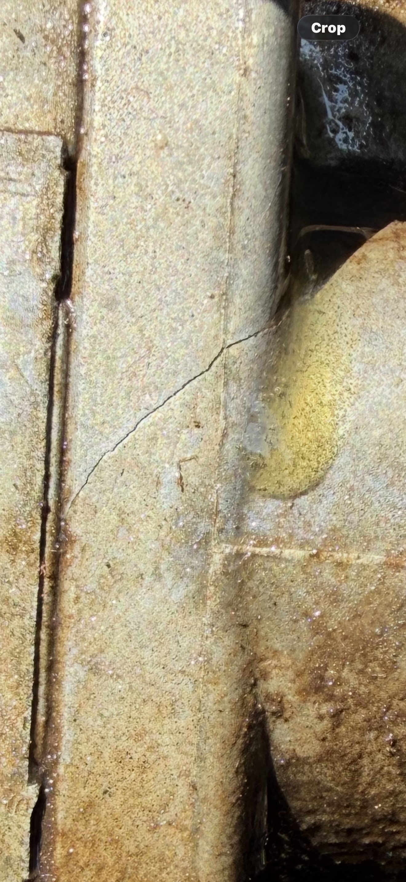

I am going to start this as a new thread with more details, as I have a feeling more people with these tractors or pumps are going to need details.
Originally I piggy backed on another thread - But this is now about more than just a leak.
www.tractorbynet.com/forums/threads/tc55da-hydraulic-leak.138470/
The pump on these units is no longer in production and currently there is not a substitute.
Pump part number SBA340451161
This pump was used on the EHSS models of
Case / New Holland Tractor Boomer 4055 / Boomer 4060 / DX48SSS / DX55 / DX55EHSS / DX55SSS / DX60 / FARMALL 55 / FARMALL 60 / T2410 / T2420 / T2520 / TC48DA / TC55DA
I "believe" it was made by kayaba as an OEM part

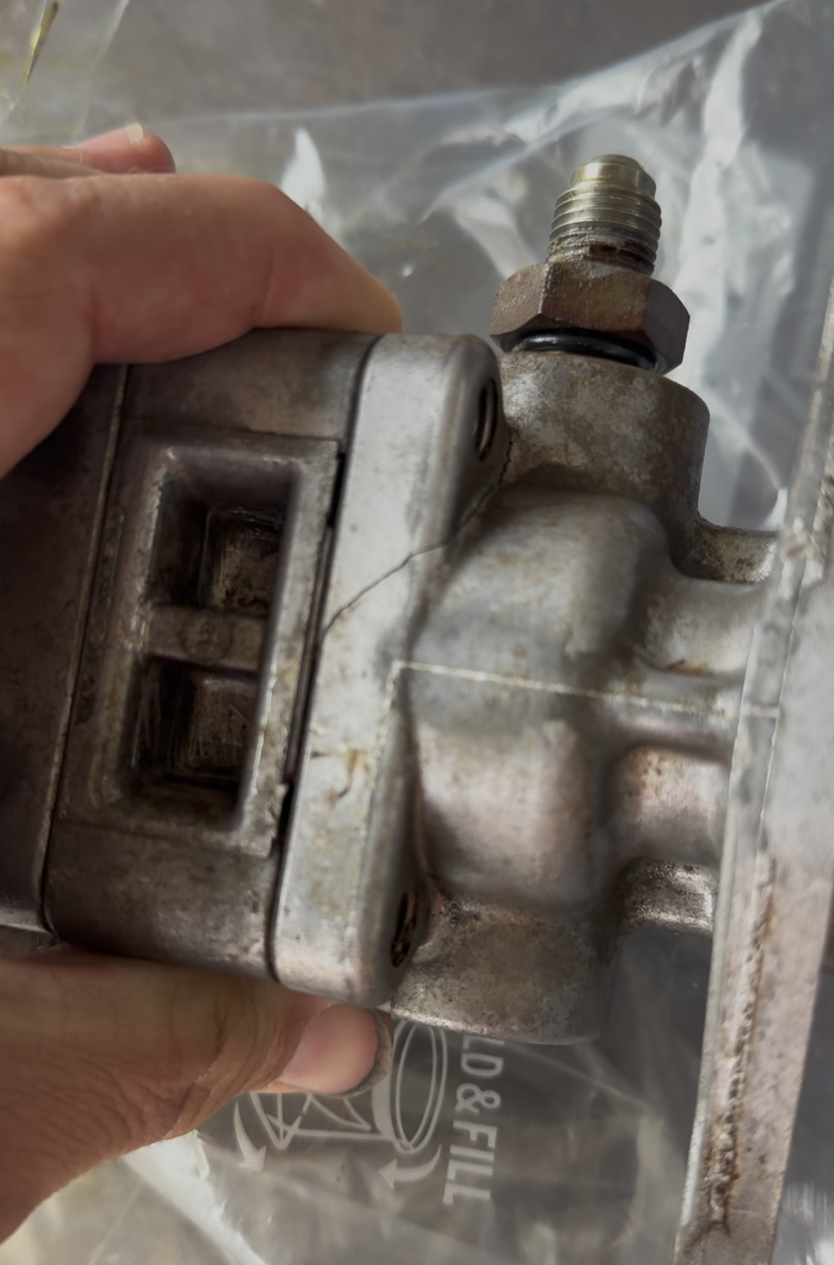

In my case the case housing cracked during a cold weather startup. I believe that is the case for another member in PA.
I have a couple of people working on a remanufactured or aftermarket pump, but they don't seem to be available. There is hope that a company is developing one or at least that was referenced in the original thread.
This is a dual pump / tandem. I am in the process of working with a machine shop to try do duplicate the front end of the housing.
Here is a picture of the crack at the front of the housing as well as a screenshot of a slow motion video I took on startup - showing the fluid rushing out of the crack.

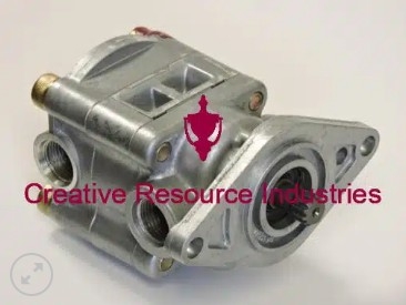

Here is a stolen image from the internet ( stock photo ) The crack is under the companies logo on the portion of the housing.

Why does it cracked with cold start up? What does each section of the pump do? Could it just be made into a single pump?
/ Hydraulic Pump - TC55DA EHSS #4
Typically pump housings cracking is from over pressure or pressure spikes. Cold oil could have or may have caused an over pressure condition.
99k
What is the mounting pilot diameter, drive shaft dimensions, mtg bolt pattern, displacement? With this information you might be able to find a pump that will bolt up but most likely the ports will be in different locations and possibly different sizes.
It is also possible that an OEM pump manufacturer made a custom shaft so you were forced to buy from New Holland.

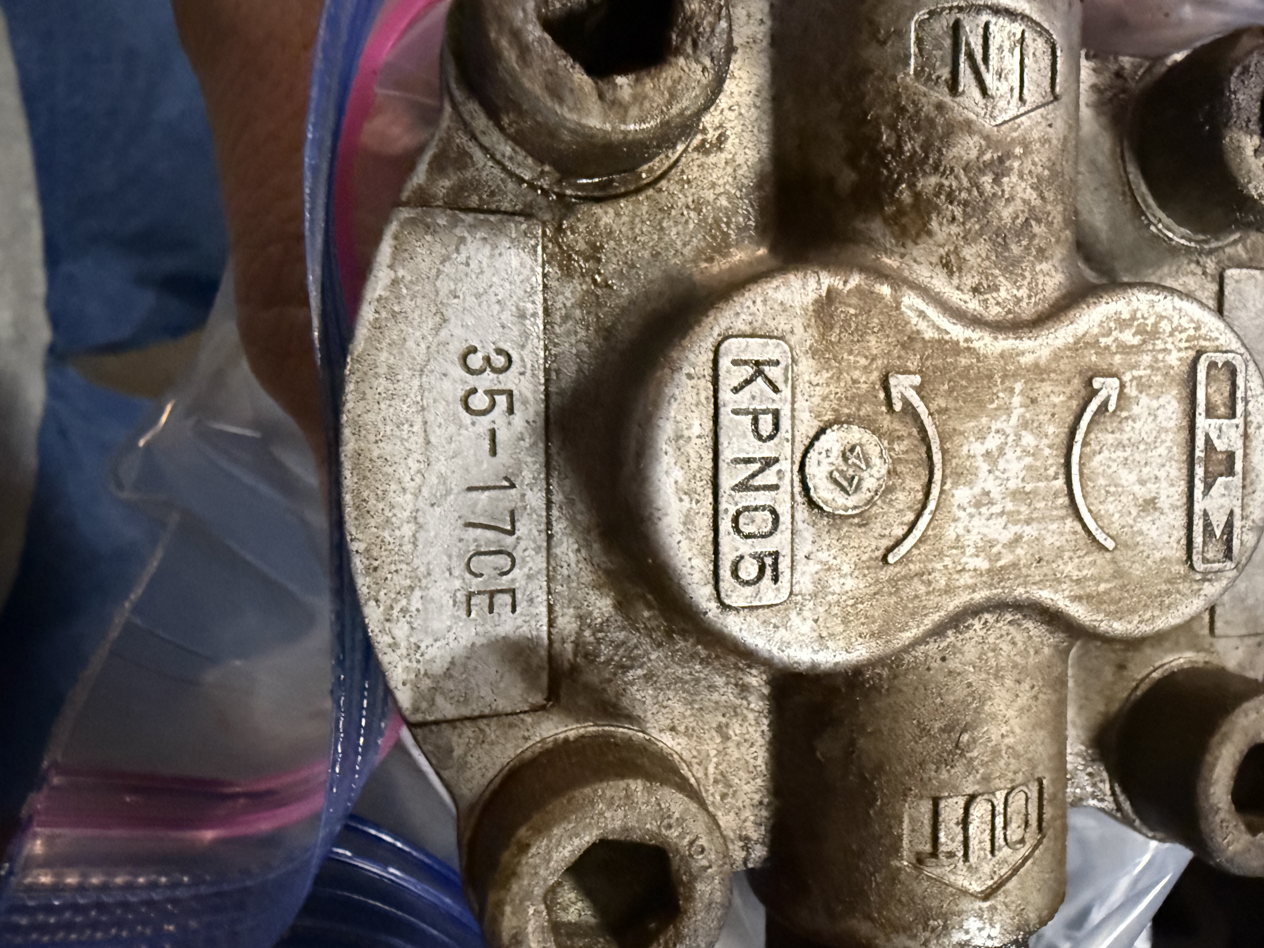

Does the pump have a manufacturers model & serial plate on it? Even though it is likely a special for New Holland, the oe manufacturer's number may provide some information to help to reverse engineer a solution . If it is KYB, I am attaching a KYB hydraulics catalog link that I found.

Thank you! It is a lead.... I had found that same document.... But just got the pump off today. I have reached out to AZTEC

The full number is KPN05-35-17CE and your right about it being a KYB number.

KYB-KPN05-35-17CE

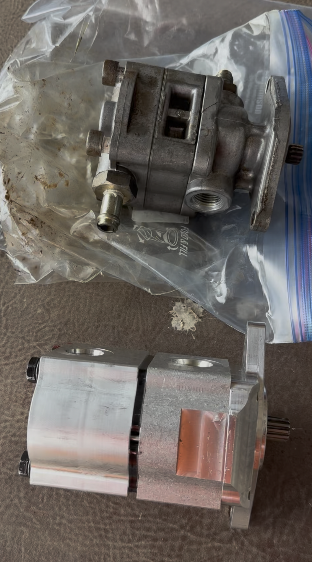

Taking longer than I wanted, but I got some physical measurements to the manufacturer. They machined the part down to fit. They took it to install on a test machine to find out they had used the "other" japanese standard for the gear pitch. They procedeeded to machine the gear drive.... Finally two weeks later they installed it on the test machine and everything looks great! This pump supposedly physically bolts right up to the tractor and all the hard lined plumbing fits as is! I am just waiting on mine to be shipped.
#19

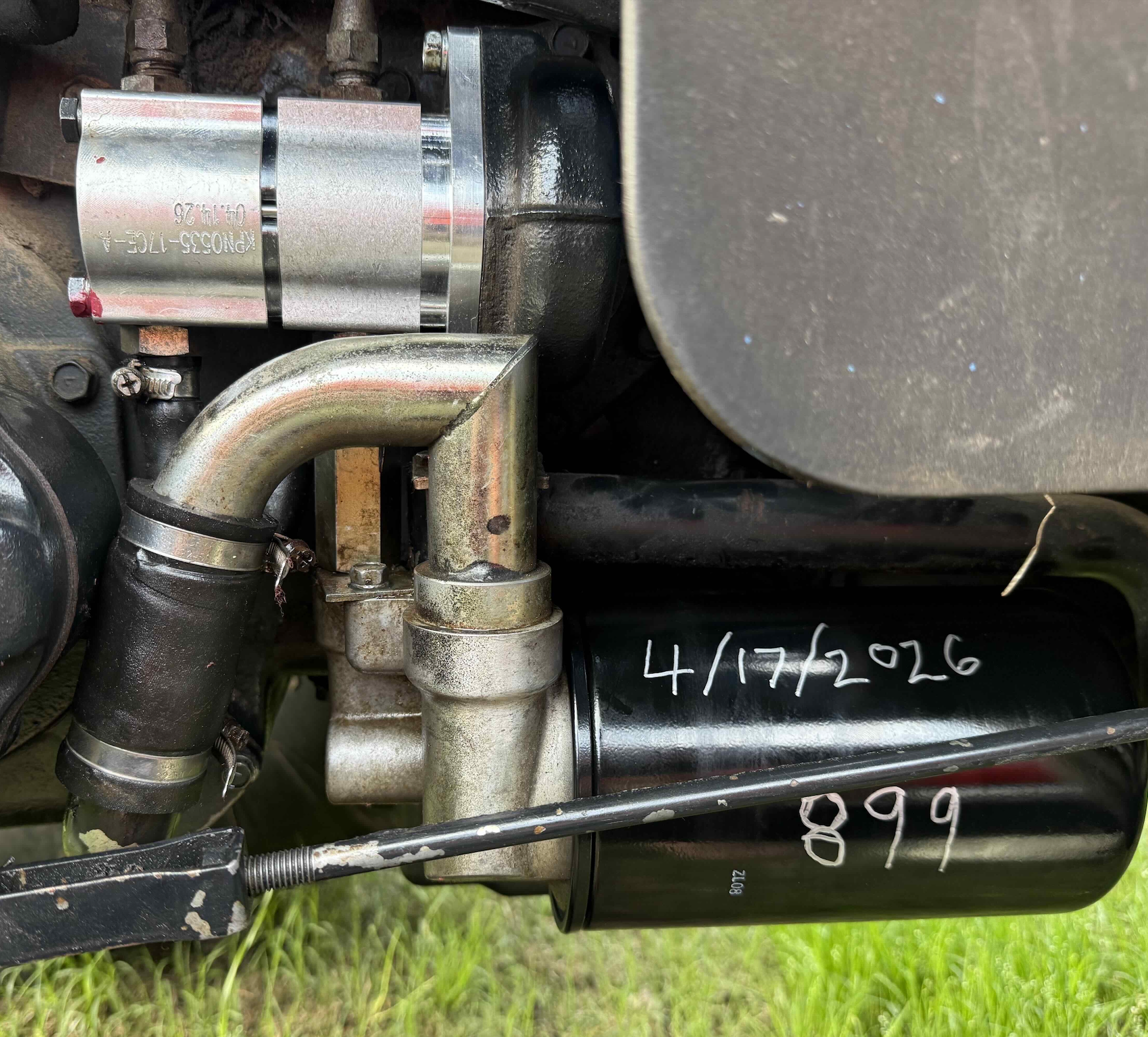

Finally got the pump. It is obviously a machined part vs a cast part like the OEM. The pump fit great! In preperation I had purchased new O-Rings and a pump gasket. I failed to purchase a suction tube gasket, so I am waiting on that before adding fluid.
The factory mounting flange gasket fit perfectly, I also purchased two new mounting bolts, just because I was already paying shipping on O-Rings and gaskets.

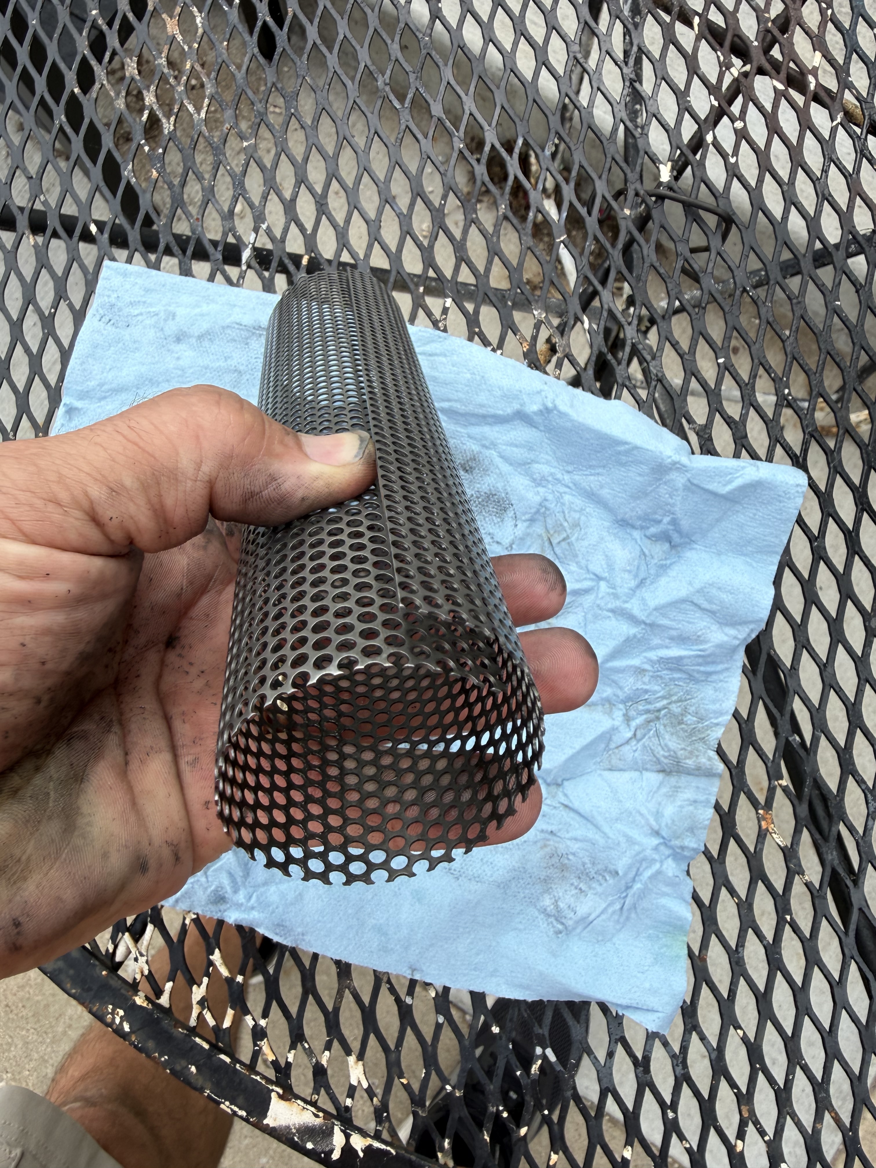

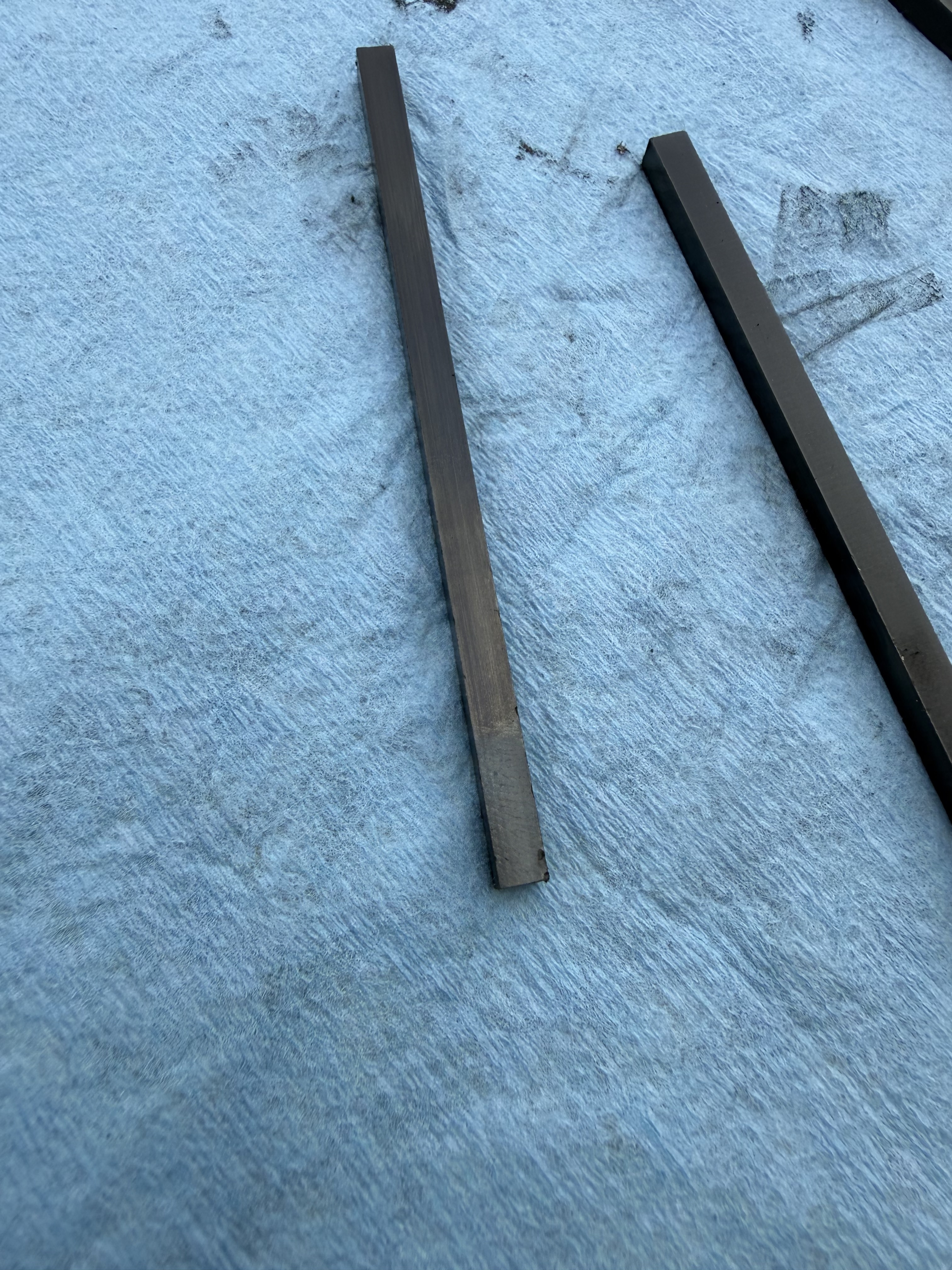

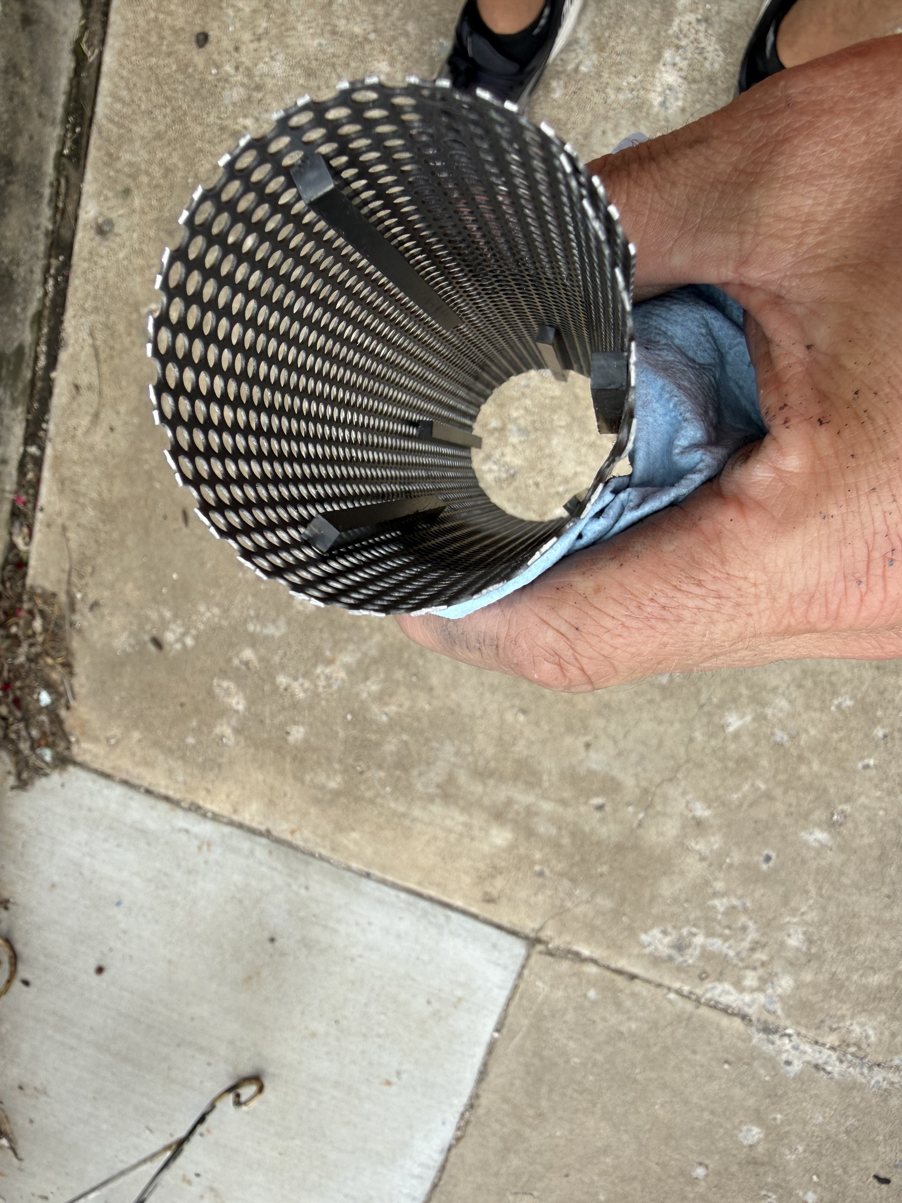

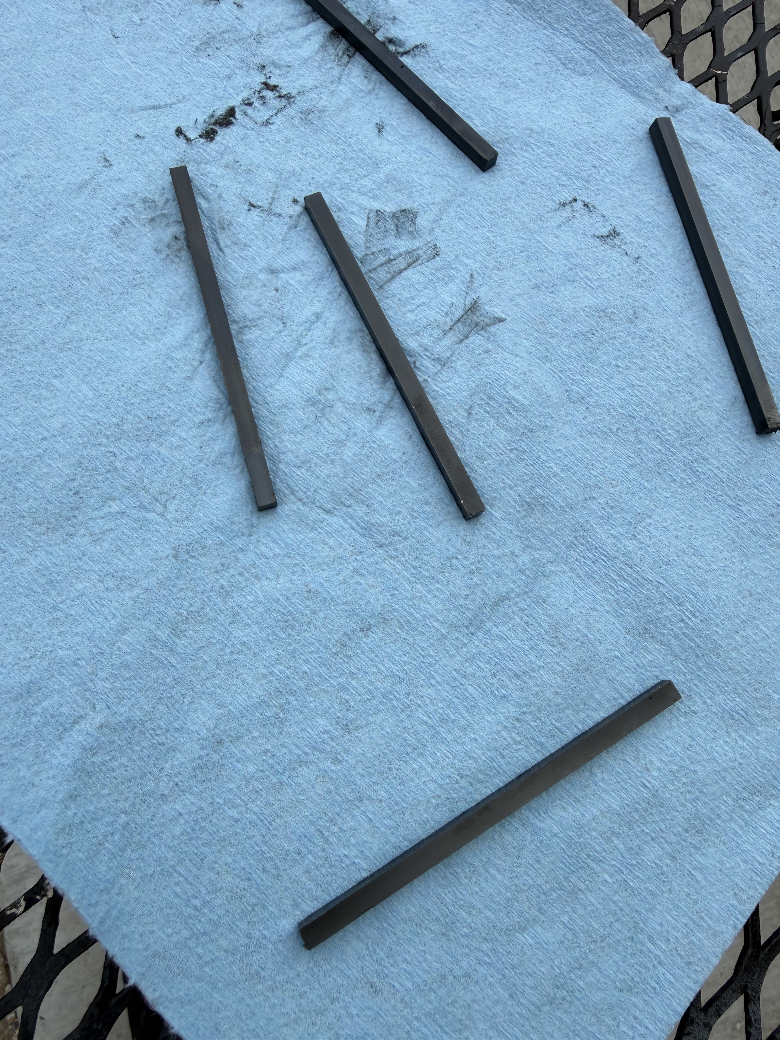

I went ahead and pulled the suction tube screen and cleaned it along with the magnets. I can say that if you have not done this, I would certainly recommend doing it at your next fluid / filter change. It will only cost you a new gasket and several shop towels for cleaning. The magnets had accumulated a ton of metal debris and were getting close to capacity.
My tractor has 899.8 hours on it. I bought it used at 695hrs and I had already changed the fluid and filter once, but did not do the screen.... I should have. The screen had also caught some larger putty like material. I will assume maybe some chunks of some cylinder seals or maybe some RTV type material used elsewhere in the tractor. It was not a lot of material but a couple of pieces I am glad are not in the system now. The pictures are for all of you guys who have not done this and would like to see what you might be getting into. Nothing about this is hard, it is just an unknown for many of us. I am a math teacher / principal / Technology Director by trade, certainly not a mechanic, but prefer to do my own stuff. I did this with mainly 10 and 12mm sockets and wrenches and crescent. You will certainly need to remove the rear tire, but i just rolled it out of the way.

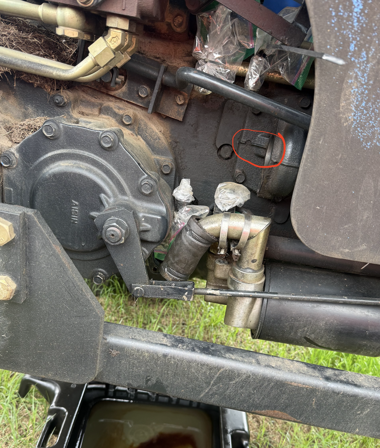

I have marked up a few photos, to indicate where they machined this pump to fit the TC55DA due to clearance issues for mounting. It fit great! The pump comes from Aztec Hydraulics via Creative Resource Industries Inc, out of PA. CRII was great to work with. This is a new pump design they already had in the works, and fortunately for me was almost ready when mine decided to blow up.
'Old Crack.png Old New.png Machine to fit.jpg Gasket and Machine.jpg Clearance.pngMounted.pngScreen Sump.jpg Strainer Screen.jpg Screen Clean.jpg Magnets.jpg Magnet.jpgDirty Magnet.jpg
