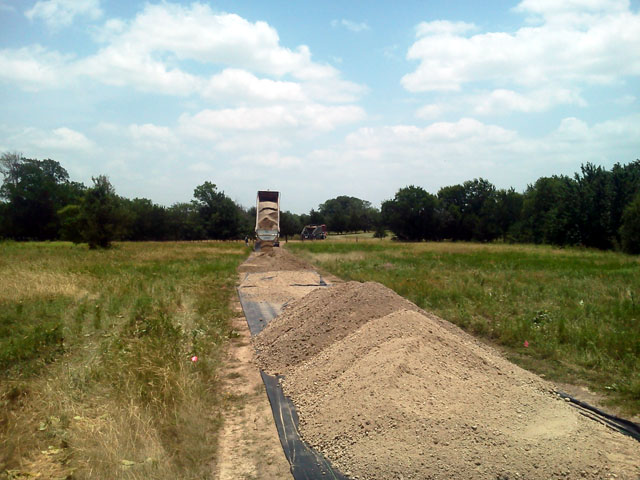

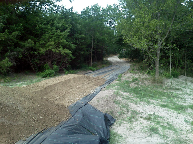

Hutchman - If the soil is compacted well, the trucks won't move it around driving over it. You can also use pins supplied by the geo supplier. I've rolled it out myself and have used one or two helpers too...just depends on the job. Unless the wind is blowing pretty hard, it only takes a little material flung over the geo to hold it down. Just don't let the trucks drive over the geo roll. It smashes the cardboard inside and makes it a real pain to roll out. On some jobs it helps to place the geo and material from the entrance going backwards if the trucks don't have a way to get off of the driveway once they've dumped. In the photos I was averaging 15 semi loads a day and incoming/outgoing trucks could drive around in most places. It was a real hustle for the guys to get the geo rolled out and you can see how far they're dumping in front of me. In the first photo we have geo draped over the culverts since we placed rip rap on the banks to fend off erosion.
View attachment 440796 View attachment 440797
Nice looking road. How did you handle the fabric going around curves? Do you have to cut it, then overlap and re-direct the roll?
Yes, use the cut and overlap method. On gentle curves you can just roll it out, but you can't drive on it with anything until it has a generous layer of gravel over the top or it starts straightening itself out and moving to the inside of the curve. R'4's on a tractor will move it and loaded trucks will move it a lot! Speaking from experience...that's not a fun scenario to deal with on a hot summer day. It also helps to remind the truck drivers to avoid turning the steering wheel when they're driving on the geo. They're more concerned with dumping a load and getting another, and sometimes they forget.

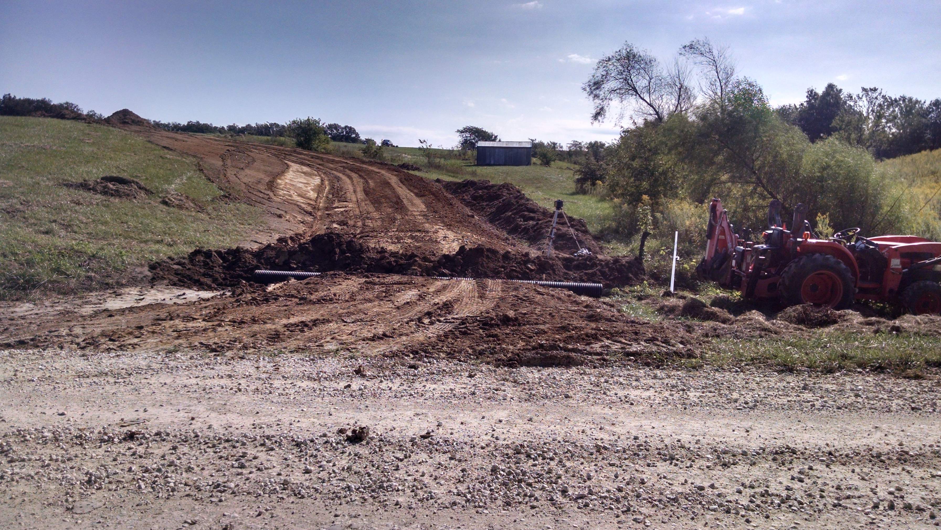

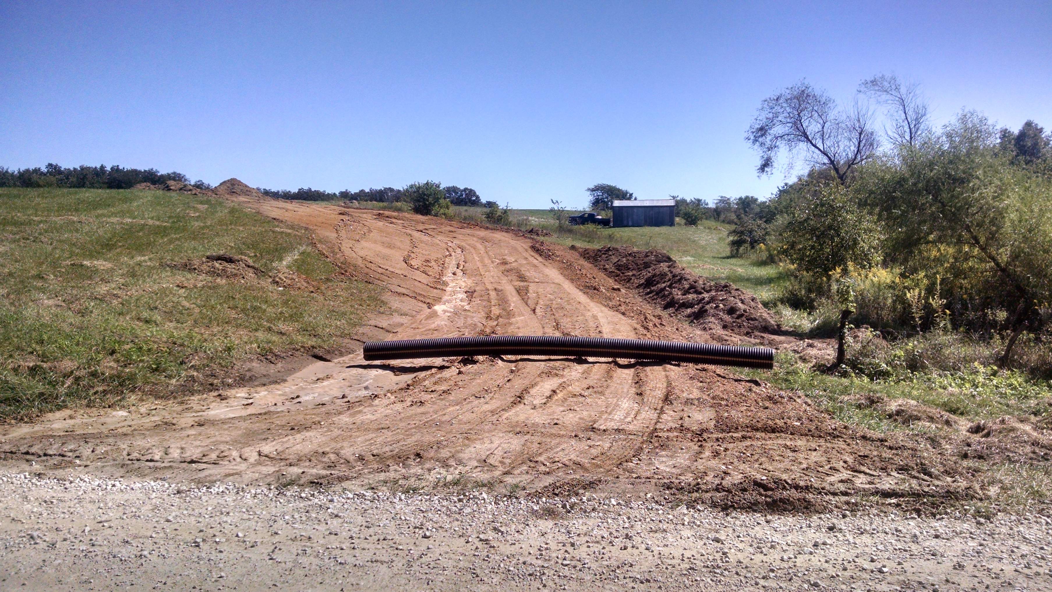

Got the hillside seeded, silt fence installed, and put 3" rock in the ditch. Wishing now that I would've waited to put the 3" down until after the driveway rock was down because it might be in the way when installing the fabric and water will probably just run around it and make a new ditch until the rest of the rock is down. I can't remember why I thought it was a good idea to put the rock in the ditch prior to the driveway rock. Oh well, I've made plenty of mistakes along the way.... at least this mistake hasn't cost me any money yet. Ran short on silt fence so I'll have to install some more this weekend. Hopefully it doesn't rain too hard in the mean time.
On a positive note, the trucking company brought the 3" today and he seemed really pleased with how everything looked. He asked who did the dirt work and he seemed surprised when I told him that I had done it with my tractor. He was also very knowledgeable about how to install geotextile and best practices when spreading rock onto it. Originally they were going to try to spread the rock while in reverse, but after looking at the situation he suggested that they use a trailer that dumps from the belly and allows them to spread more accurately. Unfortunately that means they will be driving on the fabric, but after talking with him a while I'm not too concerned about them doing something that would compromise the fabric. He also mentioned that they would be able to haul the rock cheaper using that truck:thumbsup:

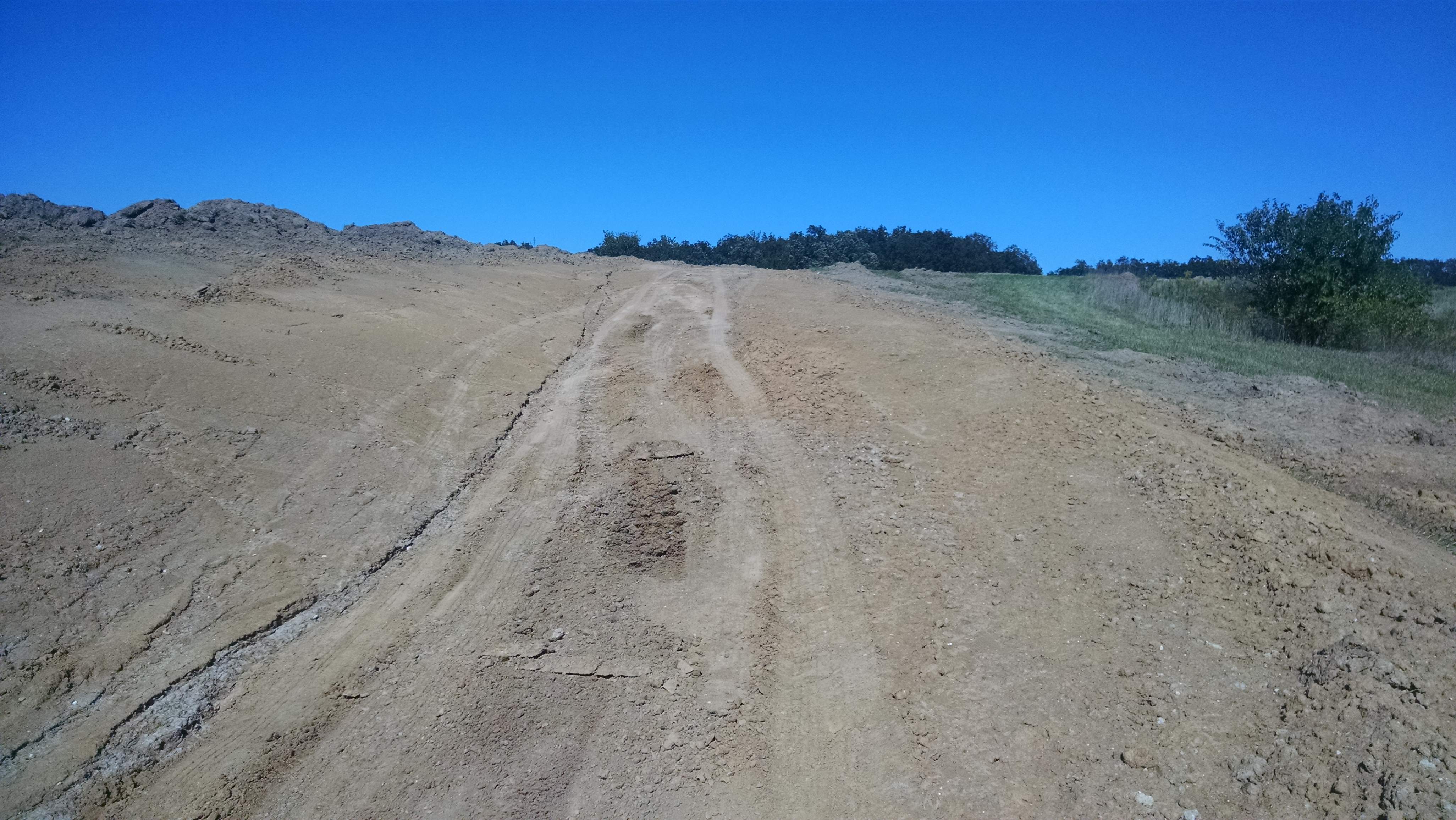

Drum roller, hill, wet clay = fun time.

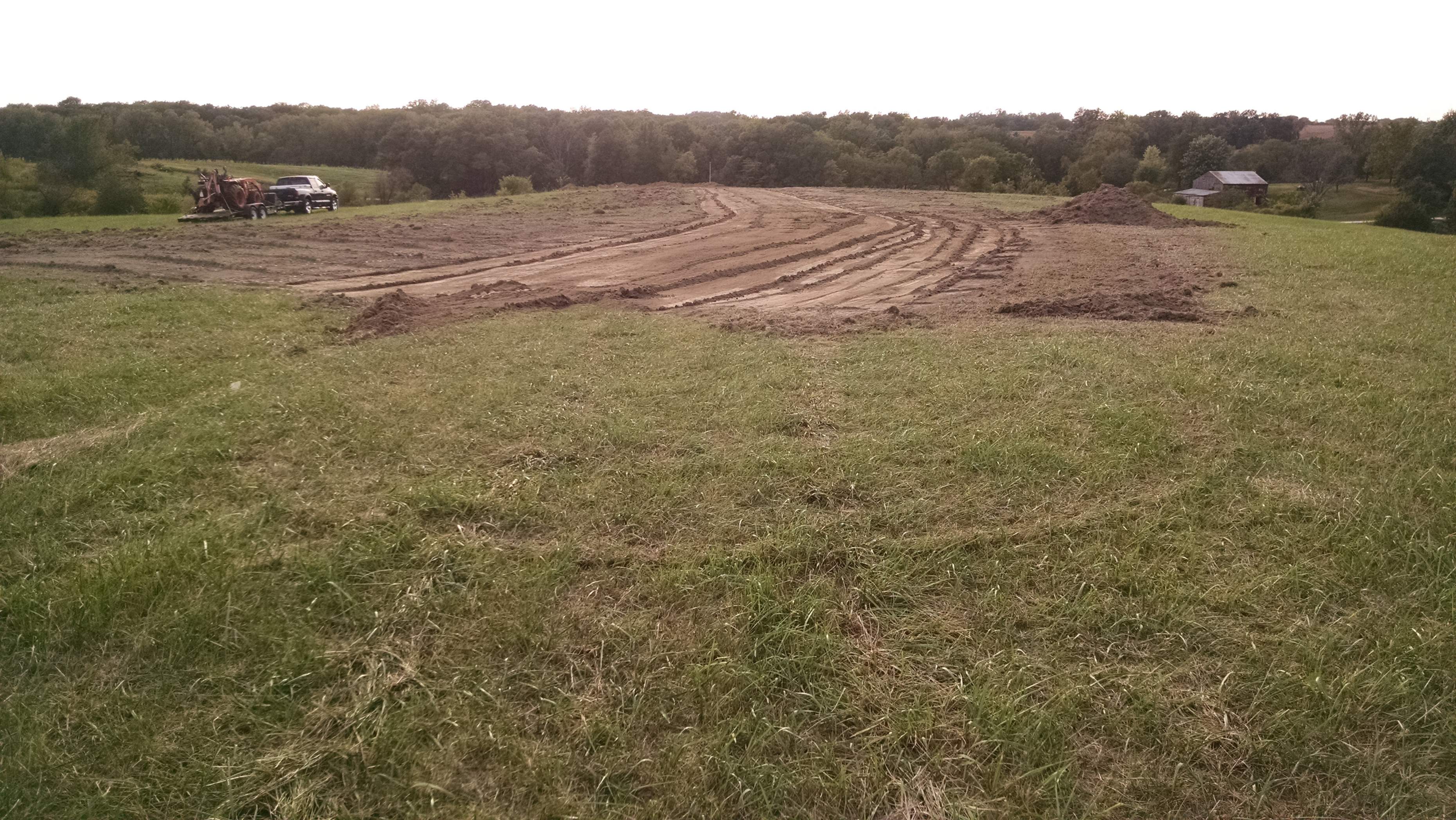

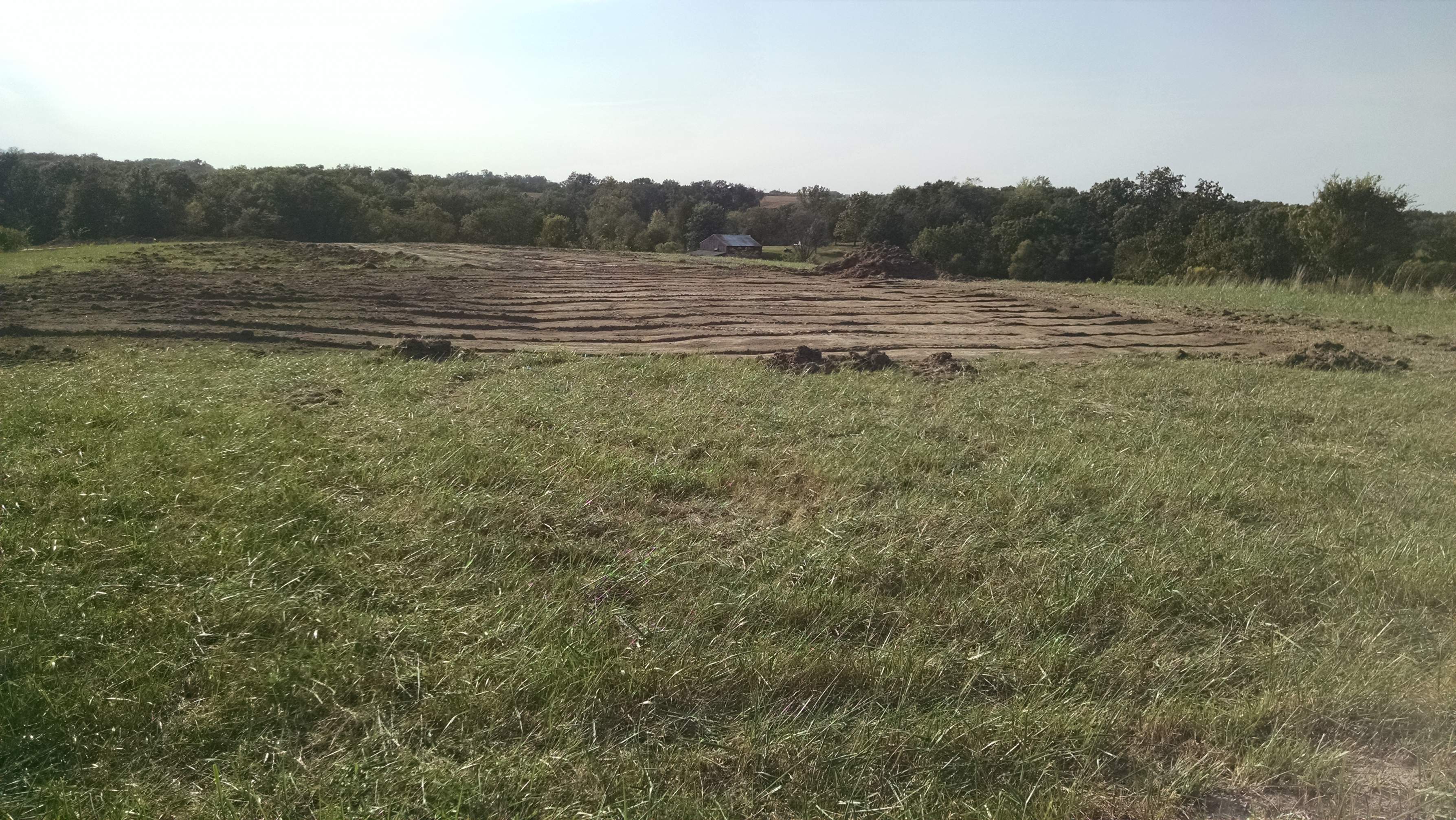

Compacted yesterday and today with the smooth drum roller. The vibration seemed to help quite a bit. The roller has a way of making imperfections in the dirt work show up. We had just enough rain on Friday to help the compaction, but it dried out pretty quick. Spent most of today extending the driveway the final 100'. I'm getting more and more concerned about the loamy soil. It's frustrating because it's 50" deep so there's no way to dig down deep enough to get rid of it. Guess I"ll just have to make sure water runs away and hope for the best. I compacted the heck out of it so hopefully that helps. Rock is coming Tuesday, no turning back now.
