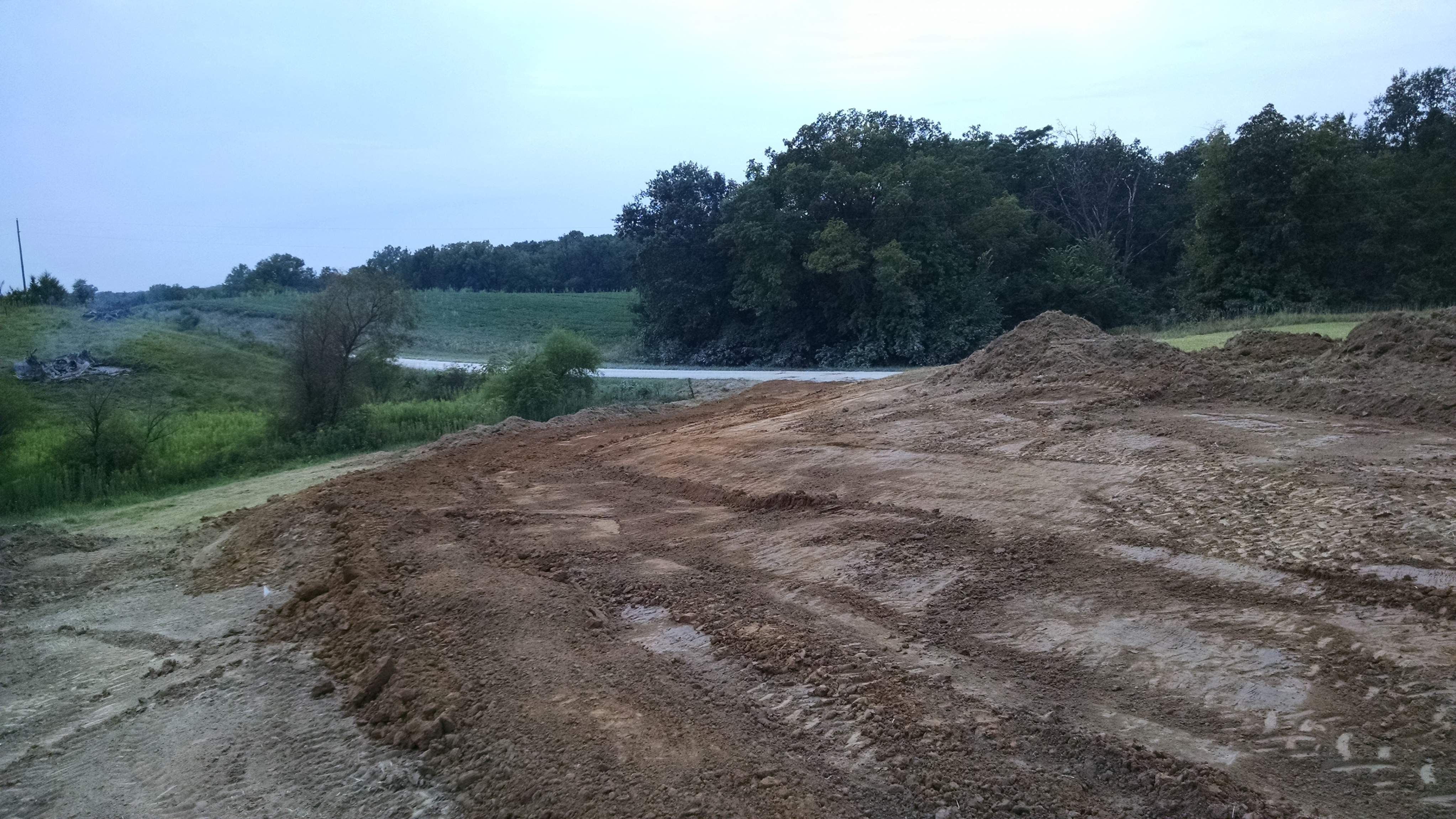

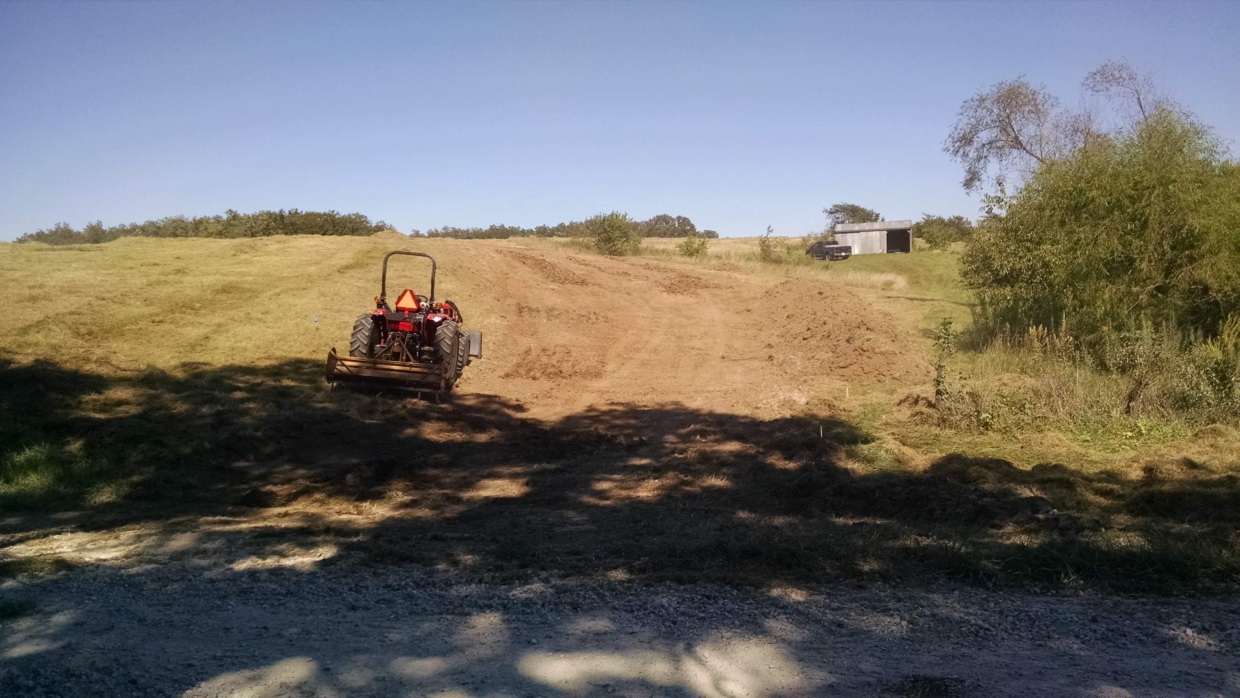

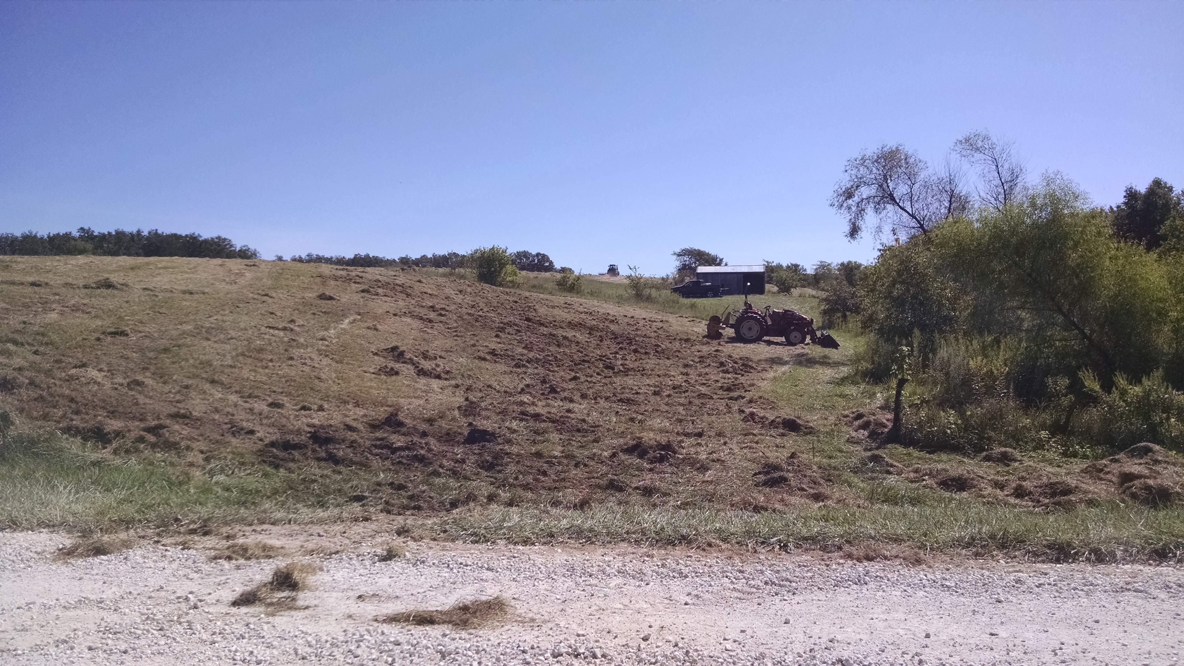

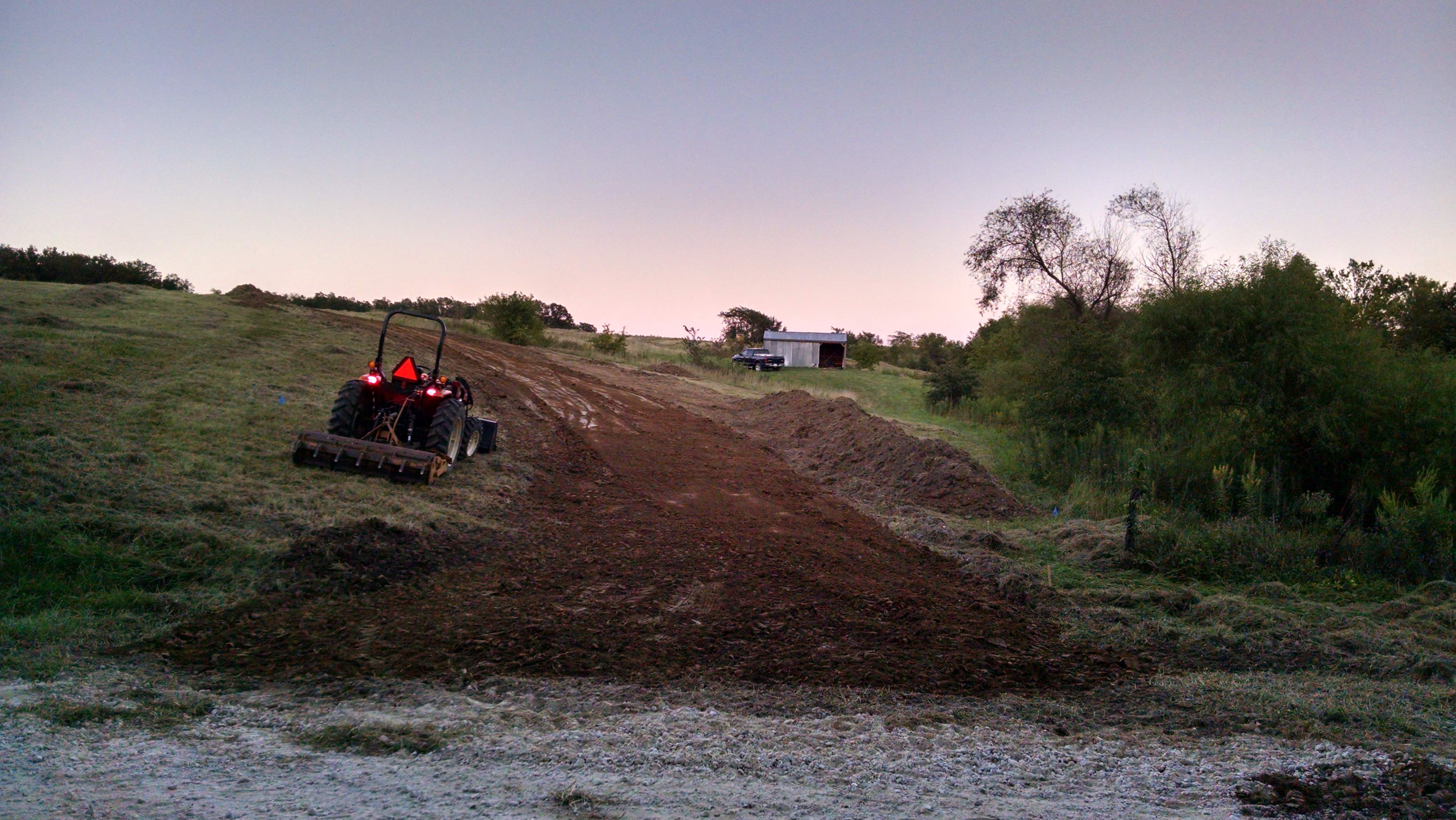

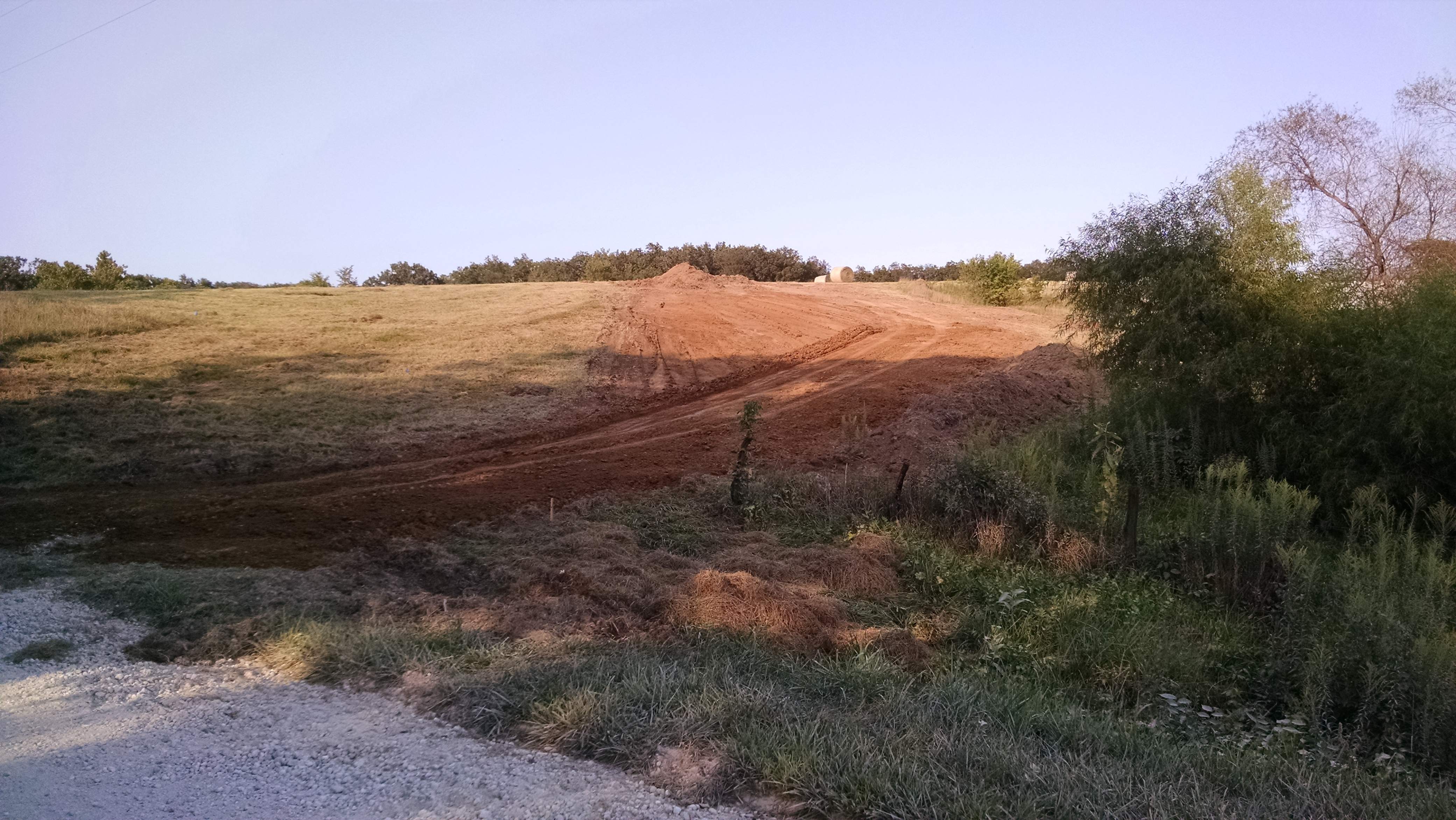

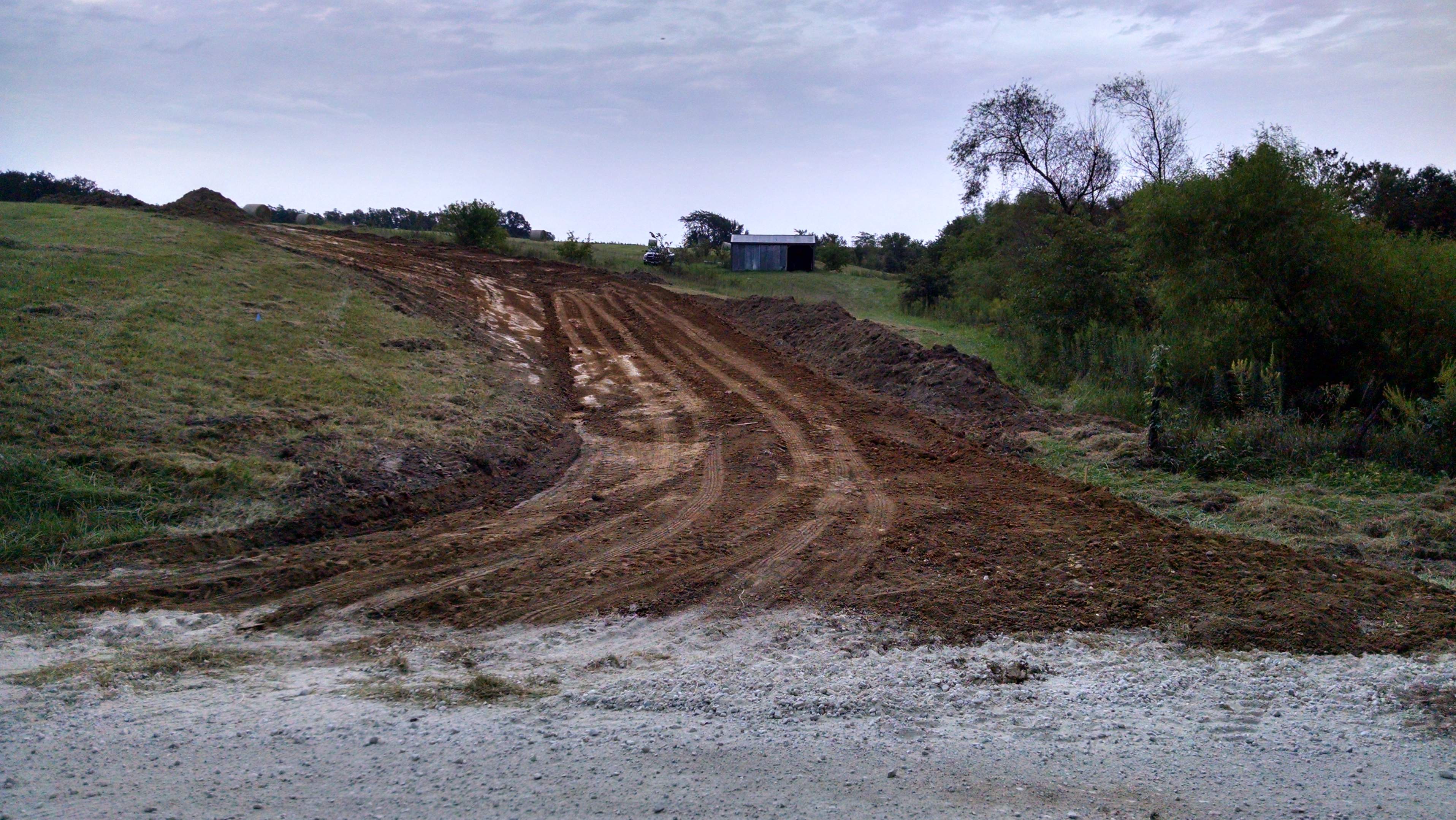

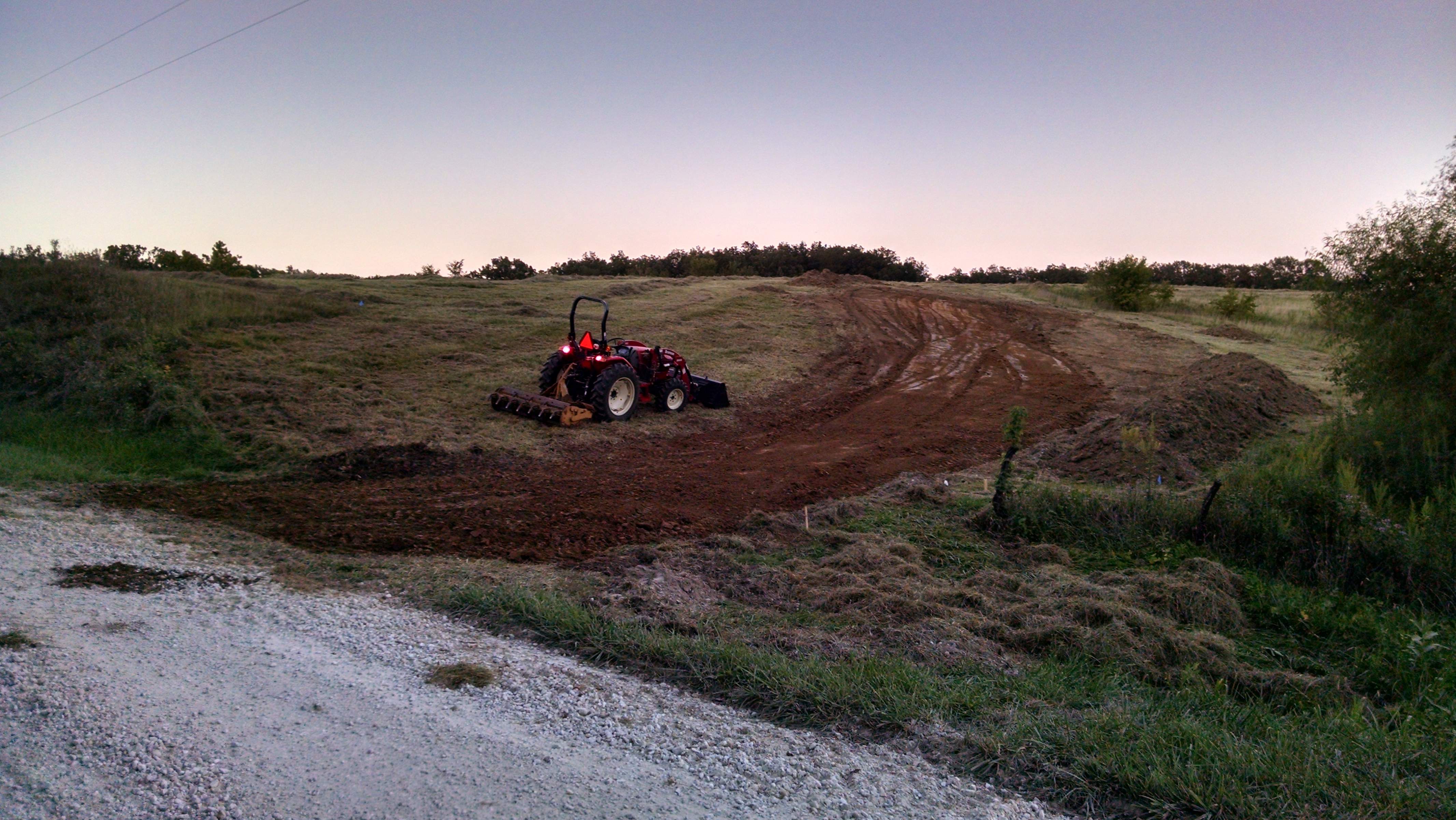

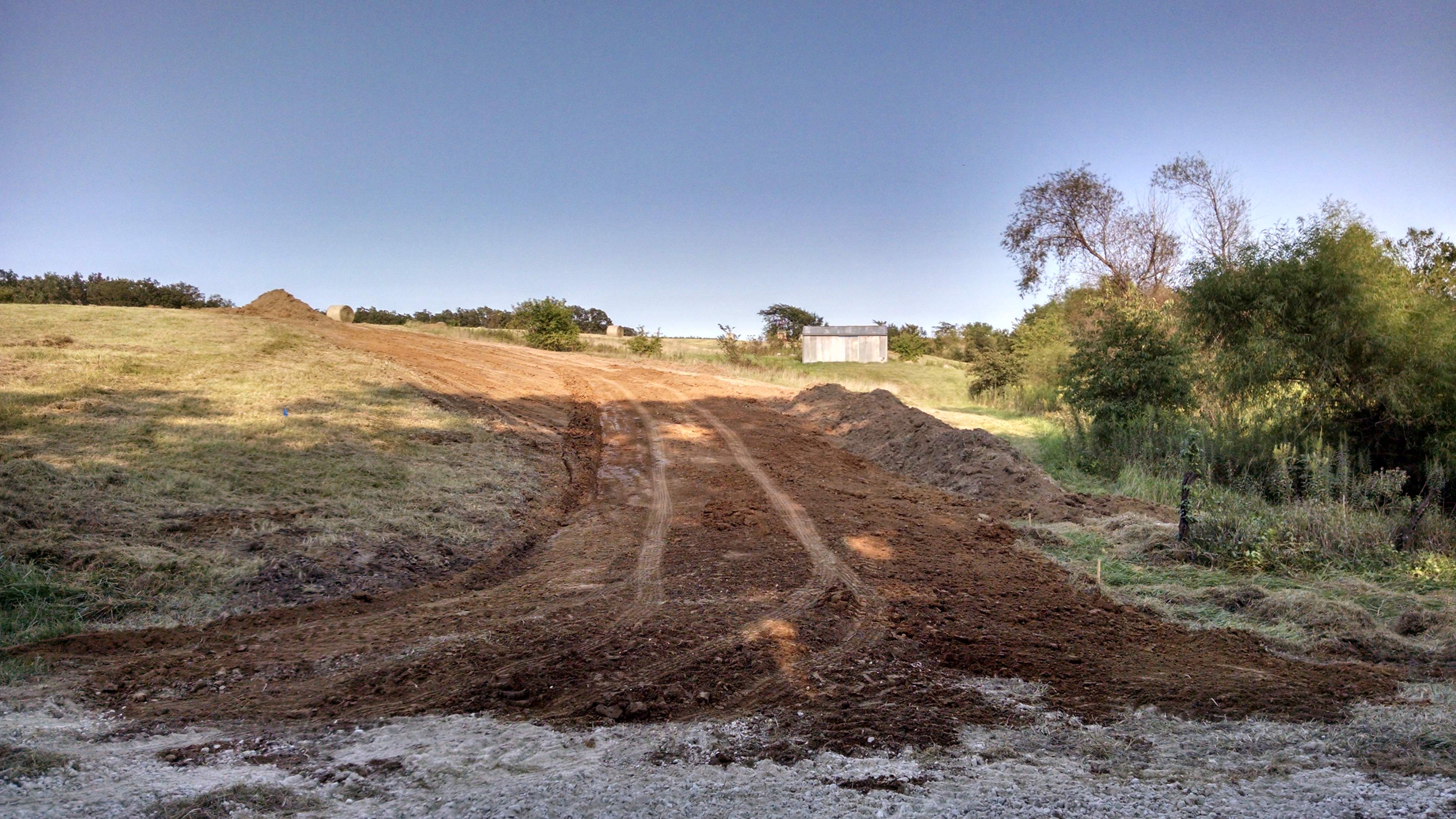

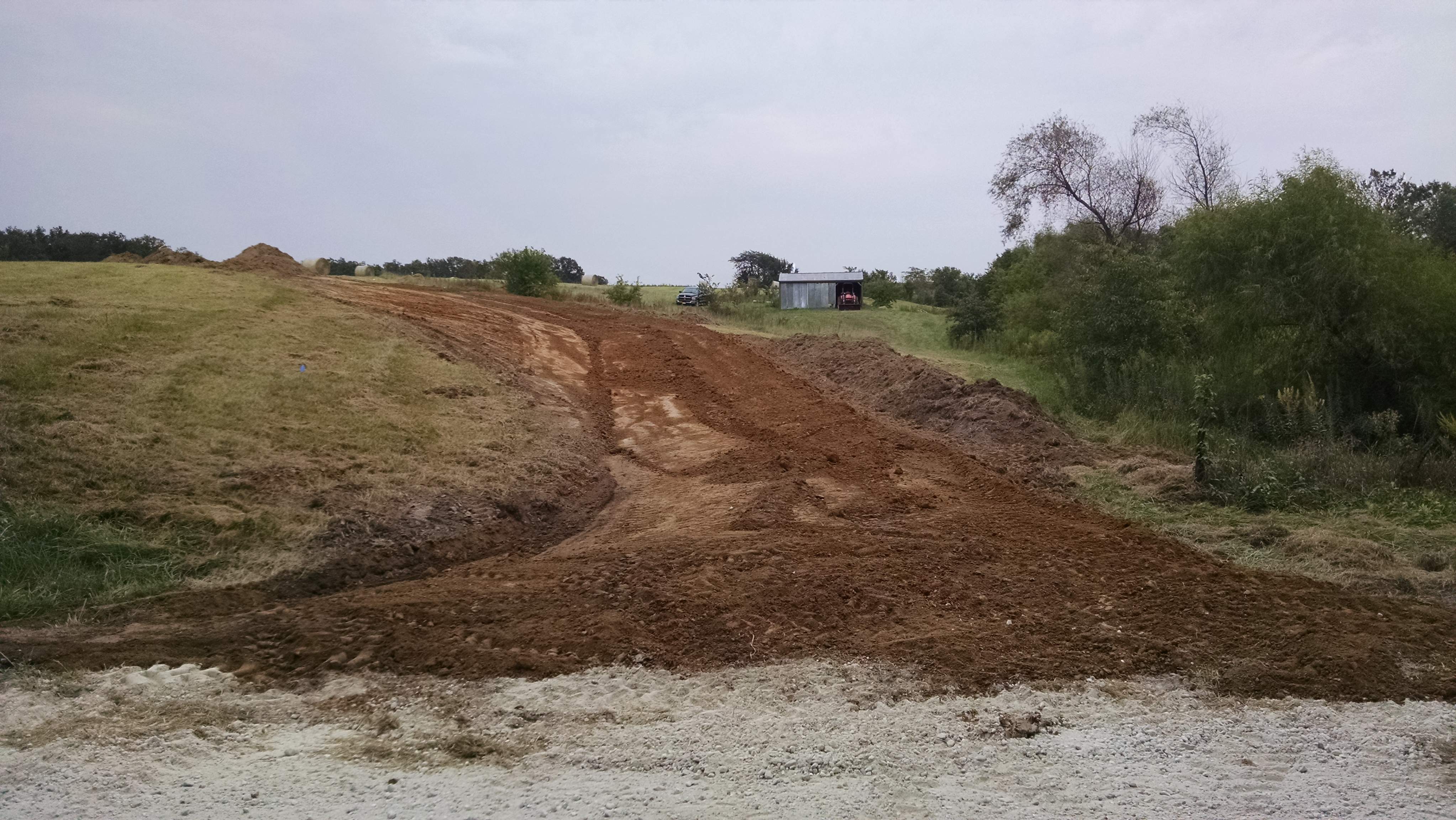

I started dirt work for our new driveway today. It will be approximately 1200 feet to our future home site. I plan on doing the dirt work, compacting with tractor (or a sheep foot compactor), installing 200 lb driveway fabric, covering with 8 inches of 1 inch minus rock (as recommended by the manufacturer), then compacting using a vibrating roller compactor. This is by far the largest project I've attempted, but I figure that if it's too much I'll just hire the rest out. Nothing lost other than my time and some fuel. First step was trying to remove the top soil/grass. This was more difficult than I anticipated because the grass has deep roots. I used the rippers on the box blade to loosen everything up, used the rear blade to windrow the topsoil to the downhill side, then piled it up with the loader. After the top soil was moved, I began scraping soil from the high side of the hill to fill in the low spot at the entrance. The driveway will be located just left of pile of top soil. The shiny area is a knob that I'm scraping dirt from in order to fill the entrance area. There will be a ditch on the uphill side to direct water to the ditch near the county road. If you look close at the last pic there are a couple visitors that walked by to see what I was doing. Like I said, this is my first shot at something like this. I've read a lot of threads and publications, but I'm definitely no expert, so suggestions are appreciated.
Many thanks to Brian at Fit-Rite Hydraulics for setting me up with a top n'tilt setup. I used the heck out of it today. There's no way I would try to tackle this without it.

Several points in no particular order.
1)You will need a culvert to pipe water from the high side to flow under the drive.
2) you will need a drain on the top side of your drive. It is surprising how much water you need to drain away after heavy rain.
3) Allow about a yard for your drain/ (batter or bank above drain is extra and dictated by the natural shear/collapse angle of the soil type.) plus the drive width (unstated) plus another yard on the low side from edge-of-gravel to edge -of-fill. Larger if fencing low side of track or you will feel crowded by the fence.
4) Does your blade have angle and side tilt? needed for topside drain. If not use digger / backhoe.
5) good gravel thickness. Is this going to be a gravel drive or sealed later?
6) what is "1inch minus rock" It seems to be an american term.

As mentioned provide for drainage.
Why do you need fabric? Save some money. Spend it on a thicker gravel base.

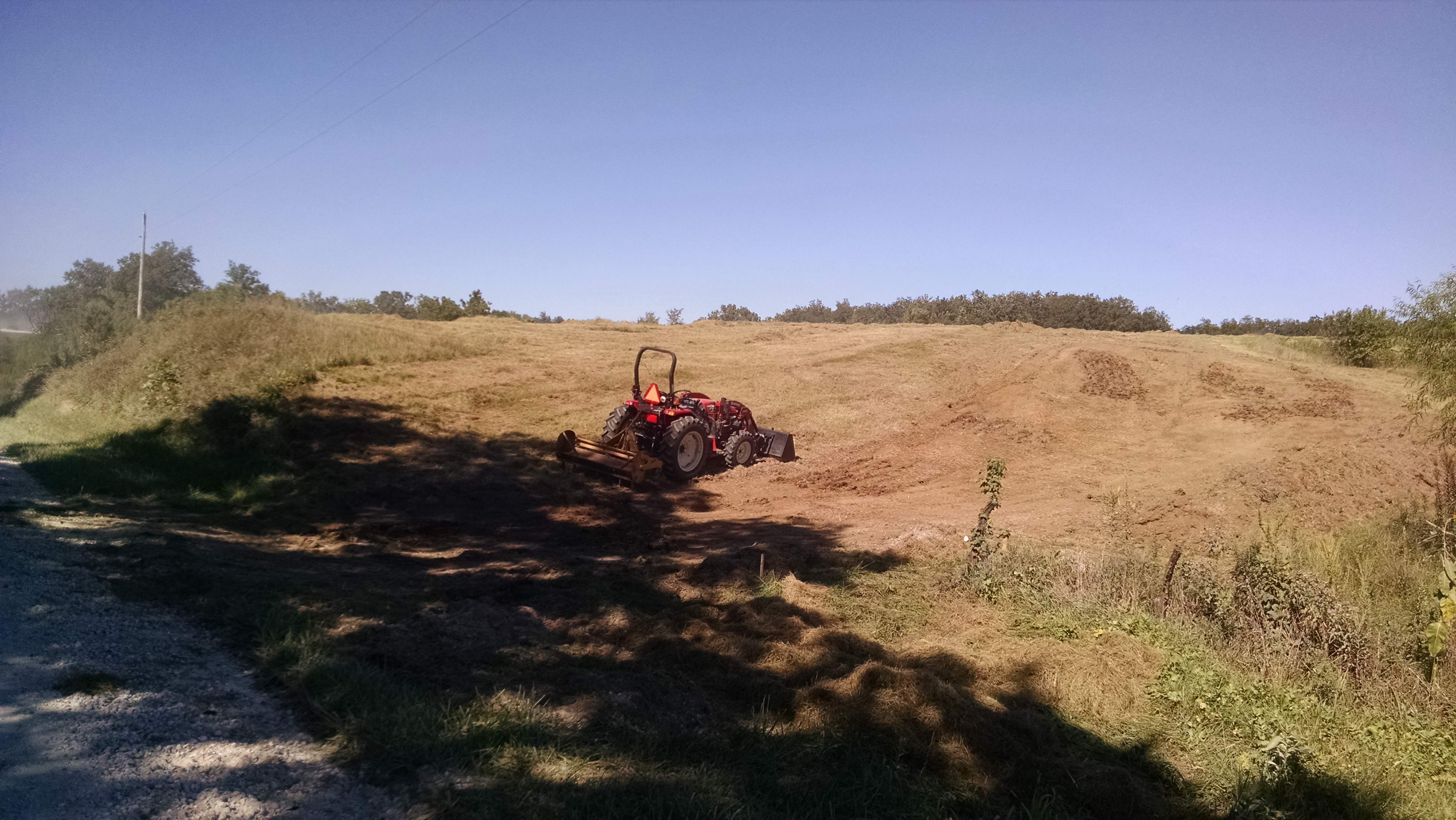

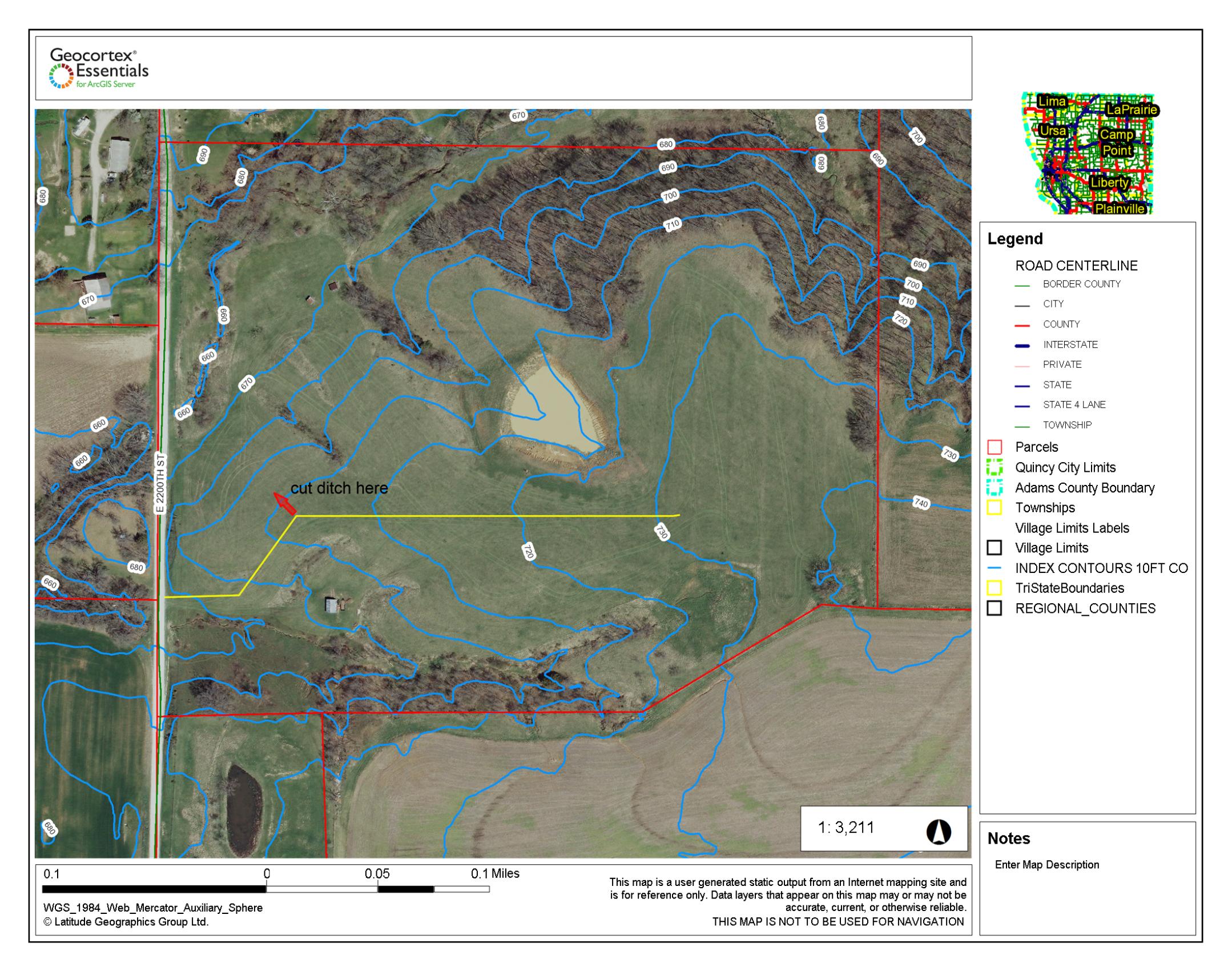

A couple of pics from yesterday. Only had a few hours to work but hopefully it's starting to look right. I hope to hit it hard this weekend.

Got about 8 hours of seat time today. Almost done with the entrance, working more now near the top of the hill. The top soil up there is really thick and very time consuming to remove. Still have some work to do on the ditch and some final grading. Hard to tell in the pics but the ditch it pretty deep, just need to widen it a bit. Might get some rain tonight so we'll see how it performs. Does anyone know how much compaction I should expect? I want to make sure I build up enough in areas so that it's the right height after compaction. The compactor I've reserved is a 2.5 ton double drum sheep's foot roller.

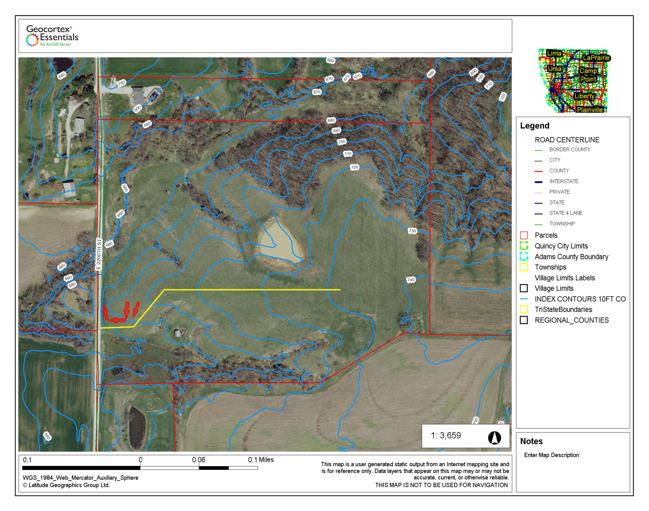

Assuming your aerial map is orientated North up I think you should add a drive pipe where the 680 contour line crosses your drive. The sooner you dump collected water into the gully to the south the better. Yes it would go along that 680 line north to the culvert under the county road but you would be diverting water that now goes to the gully and might overwhelm that culvert.
Another culvert up mid drive near where 710 crosses would also be a good idea to reduce the amount you collect between culverts.
As to the fabric question. In my experience (40 years of road construction) a geotextile does about the same job as an eight inch layer of clean sand and usually costs as much installed as the sand would.
If your over wet mucky mud you can't dig out you might go with fabric but if you are on firm subsoil and want a thicker frost resistant layer go with the sand.
The one inch minus stone is fine and if any thing I'd go a little thicker and chink it with some clean sand to tighten up the top surface.
Looks like a very good start on your project. Enjoy!

I was taking a break today and looking at the driveway about where the 710 contour line crosses and was thinking the same thing you mentioned. The ditch on the north side of the road doesn't have any place to empty until it reaches the county road and by that time it could flood my driveway during a good rainstorm. Maybe another option is to cut a small ditch near the top of the hill to direct water over the north side of the hill? It wouldn't have to be very long because the driveway is pretty much on the ridgeline. I made another picture to show what I mean. As for the pipe near the county road I am planning on calling the county Monday to have the road commissioner meet me out there sometime this week to voice my concerns.
I've already purchased the geotextile fabric, so I'm pretty much committed to using it. I did a lot of research before deciding to use it. Most of the negative feedback I found regarding the fabric revolved around the fact that it is expensive. I shopped around and got what I feel was a pretty good price and I figure that I'll never be able to add it later, so it seems worth a try. I'll have to let you know in a year or two if I have trouble. The reason for the 1 inch minus rock with 10-15% fines is because that's what the salesman recommended. He said to use 6-8 inches, but I figure on having 8-10 to be safe. If you guys have other suggestions for aggregate over fabric please let me know.

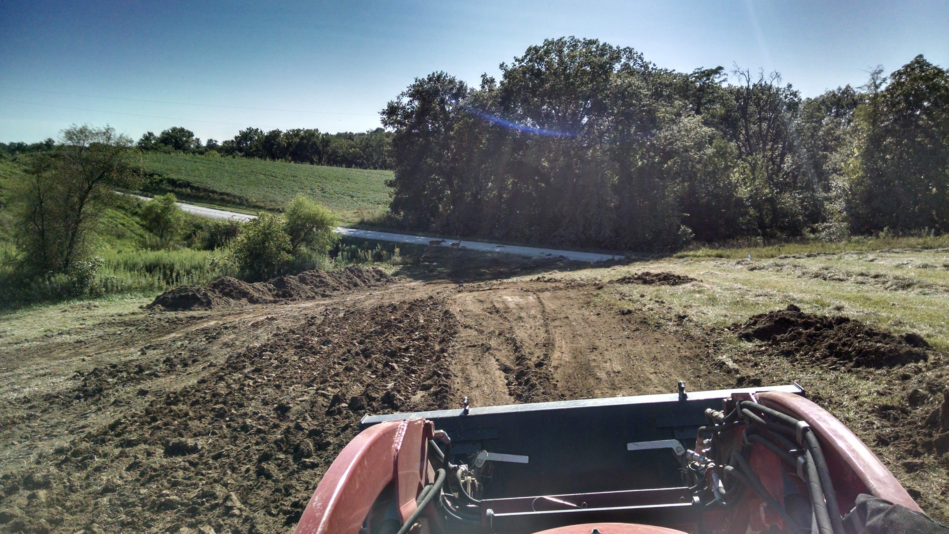

Got about another 8 hours in today and had a couple of setbacks. Pretty much working on the top of the hill now and there is a LOT of topsoil. I really struggled with the first section on top of the hill due to the topsoil depth of 12 inches in some places. It seems like I have to move 3 times as much dirt as I should. My wife came out late today and we were looking at the area we have staked out for the house. Of course, we started thinking of some other options and we ended up moving the stakes. Hopefully I haven't gone too far with the driveway yet....
Struggled so much with the topsoil today that I'm going to try a different method for the next section, hence the picture where I started cutting on the sides with grass in the middle.

If you move your ditch back to the 710 crossing you can direct it to the small gully north of where you placed your arrow and use that already established vegetated water way. If you ditch where you have the arrow you will get a new unnecessary gully. Is the white area in the center of the picture a dry pond?

That's a good point about creating a new gully. I may do that to relieve some pressure on the ditch to the west of that point. The white area is a full pond now. It was still new when this image was taken.
