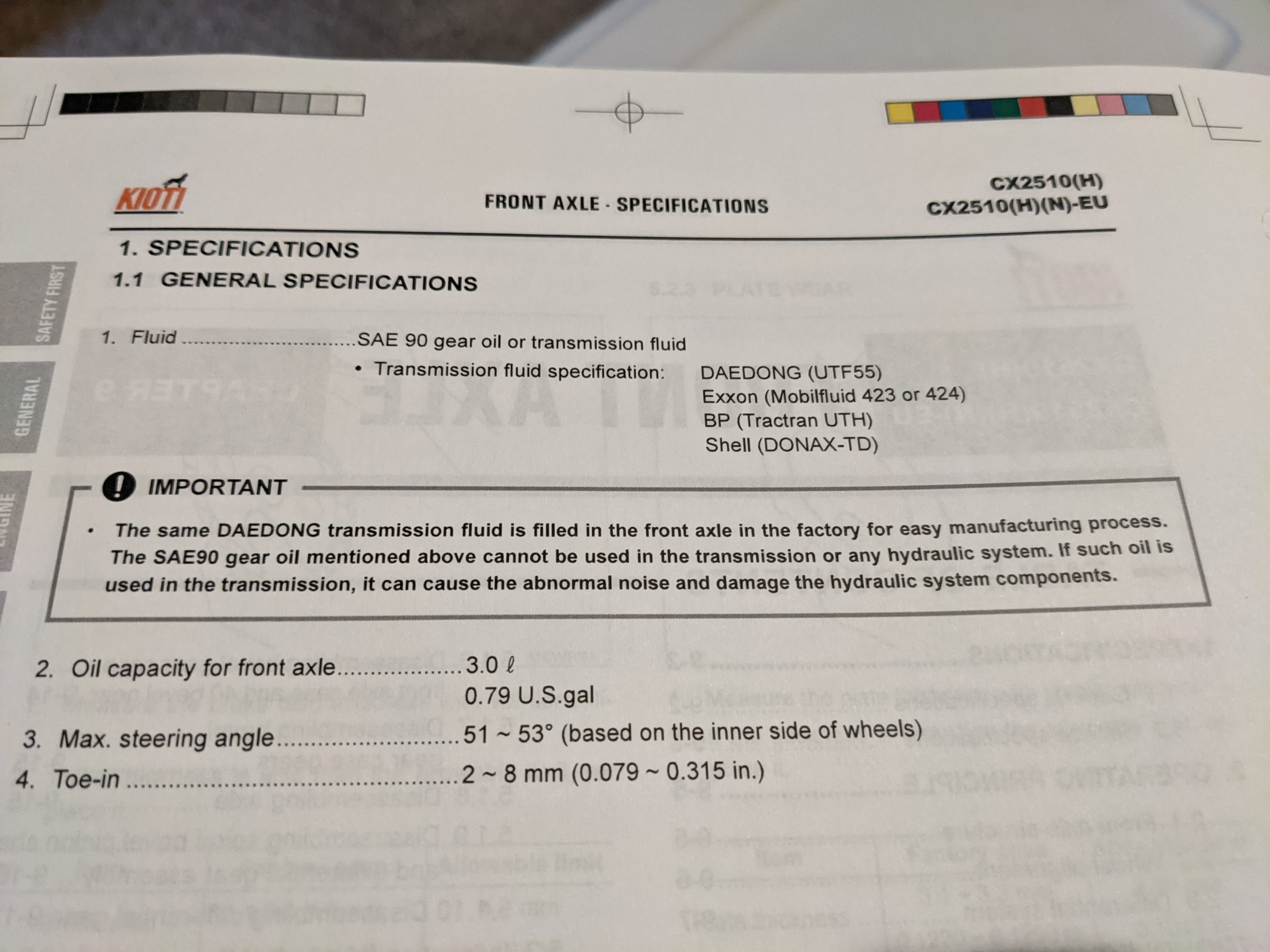

I just started my 50 hour services. I changed the engine oil and filter and drained and refilled the axle with 80w90 gear oil. In the above video of the Orchard Hill guy he mentions the axle is filled with hydraulic oil from the factory and that it needs to be changed out with gear oil at 50 hours. I thought this strange but sure enough that's what was in there. While I was looking for the axle capacity (3 liters) I found this warning in the service manual.
Had I known this earlier I definitely would have swapped out the very thin hydraulic oil with gear oil as soon as I brought the tractor home.
I still need to change the hydraulic/HST oil and filters but I haven't found the right oil locally yet.

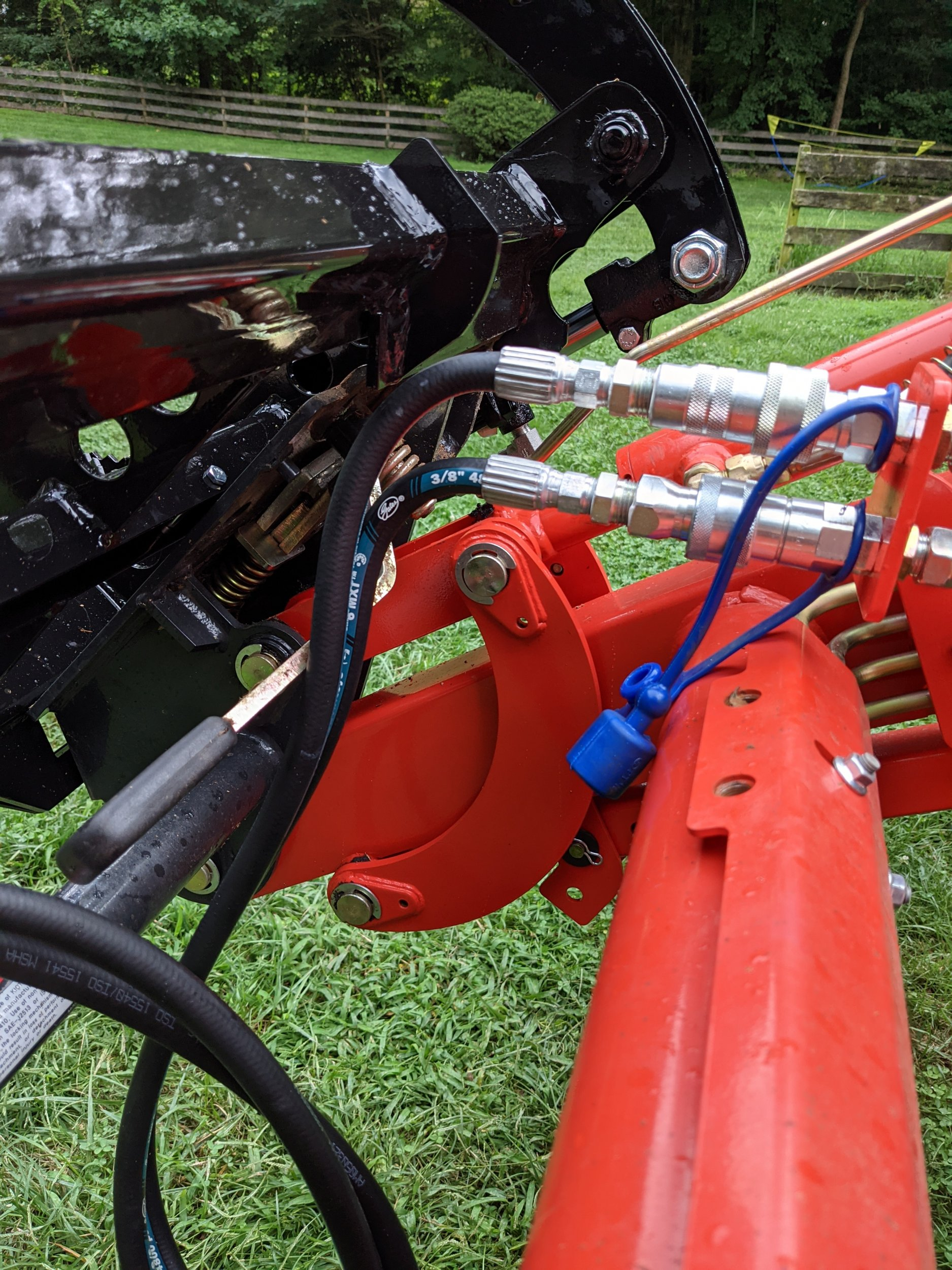

I got my 90s on. Perfect fit. This is full curl. Definitely want to specify 90s on probably all hydraulic attachments for the CX2510 loader. Them sumbitches were on there tight from the factory too.

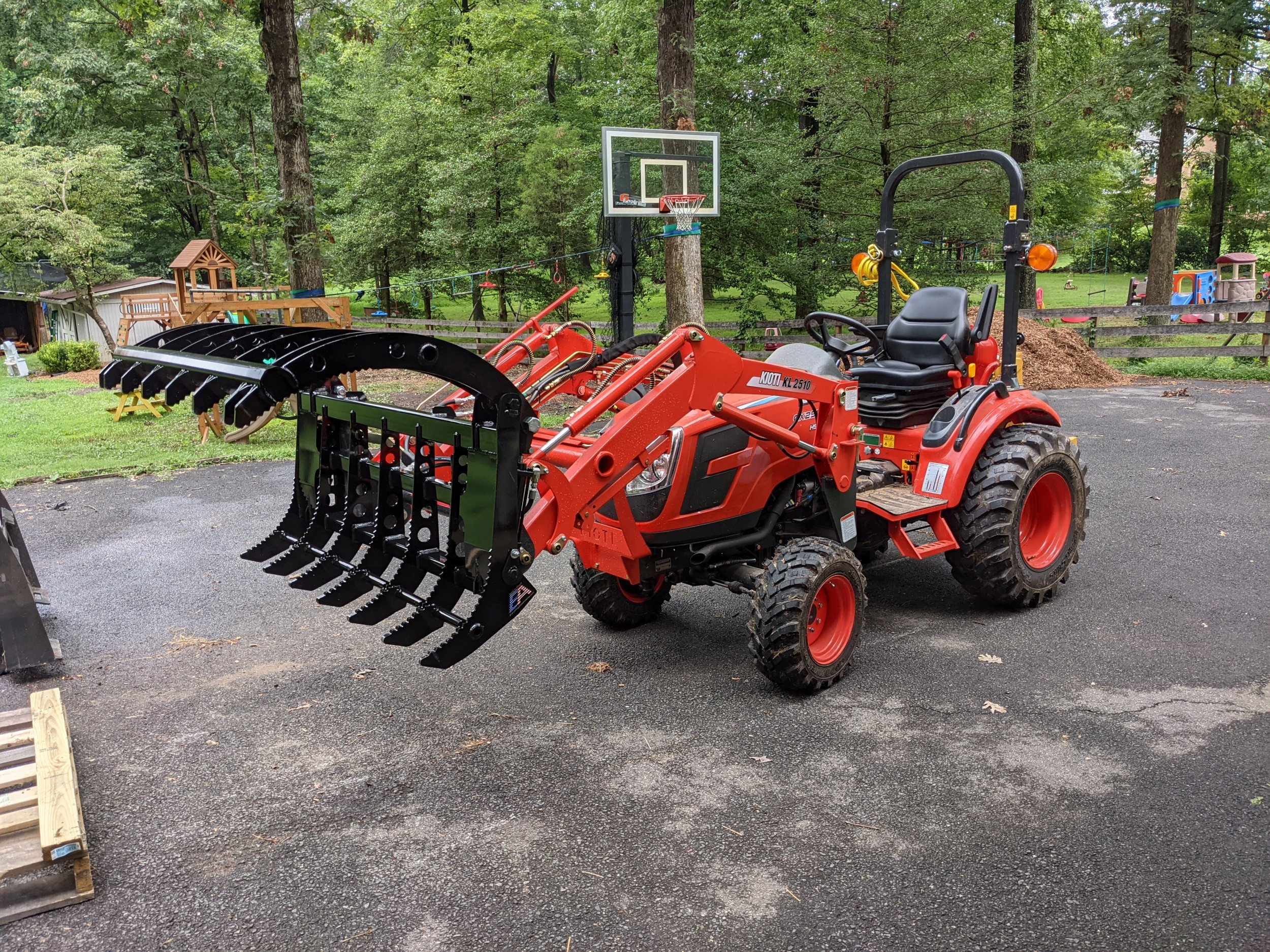

Thanks again @EverythingAttachments! This grapple is a beast. Made short work of a couple trees that fell recently. My only complaint is it took me less than an hour to do the work. :p

I is confuseded. Again
Seems like it says that either can be used in the differential but not to use the gear oil in the transmission.
Makes sense to me. I don't see where it says to R&R the diff oil with 80/90 gear oil.
Mobil's site says it's okay in differentials unless they have a hypoid gear design. Again, I is confuseded. How can you have a differential without a hypoid gear? Unless it's straight-cut gears?? Which. I don't think is possible.

The R&R suggestion came from the video @pirogue1 posted earlier. Rereading the above it certainly does say either oil is ok and in the service manual it states "SAE #90 grade or higher or TM oil" so I guess both work. I am much more comfortable with gear oil in a diff than hydraulic oil although it's not like a vehicle diff that's spinning significantly faster.

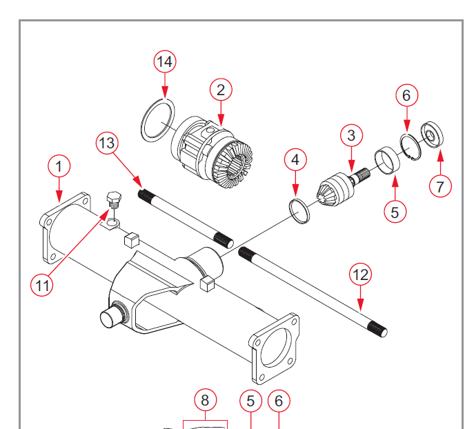

On your other point, the front diff gear and pinion gear (obviously they'd be the same) are actually straight cut. gears.

Thanks for the diagram. Senior moment on my part. I'm allowed :)
