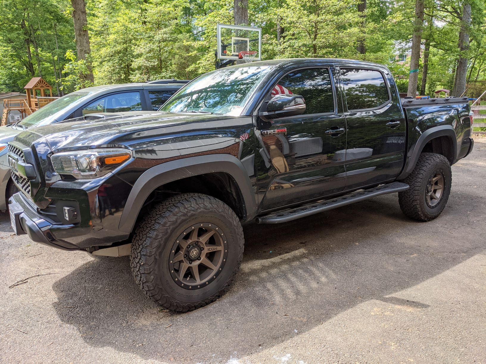

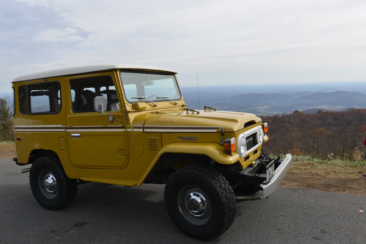

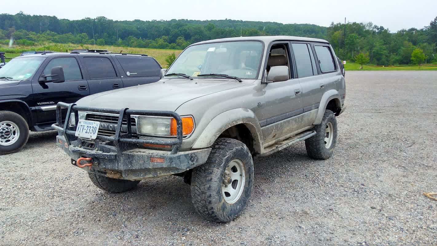

I spy an FJ40 land cruiser hiding in the garage. Fellow FJ40 & lx470 owner.
Nice! You on ih8mud too? I have a stable of Toyotas as well. 77 FJ40, 97 80 series and a 18 Tacoma TRD Pro.

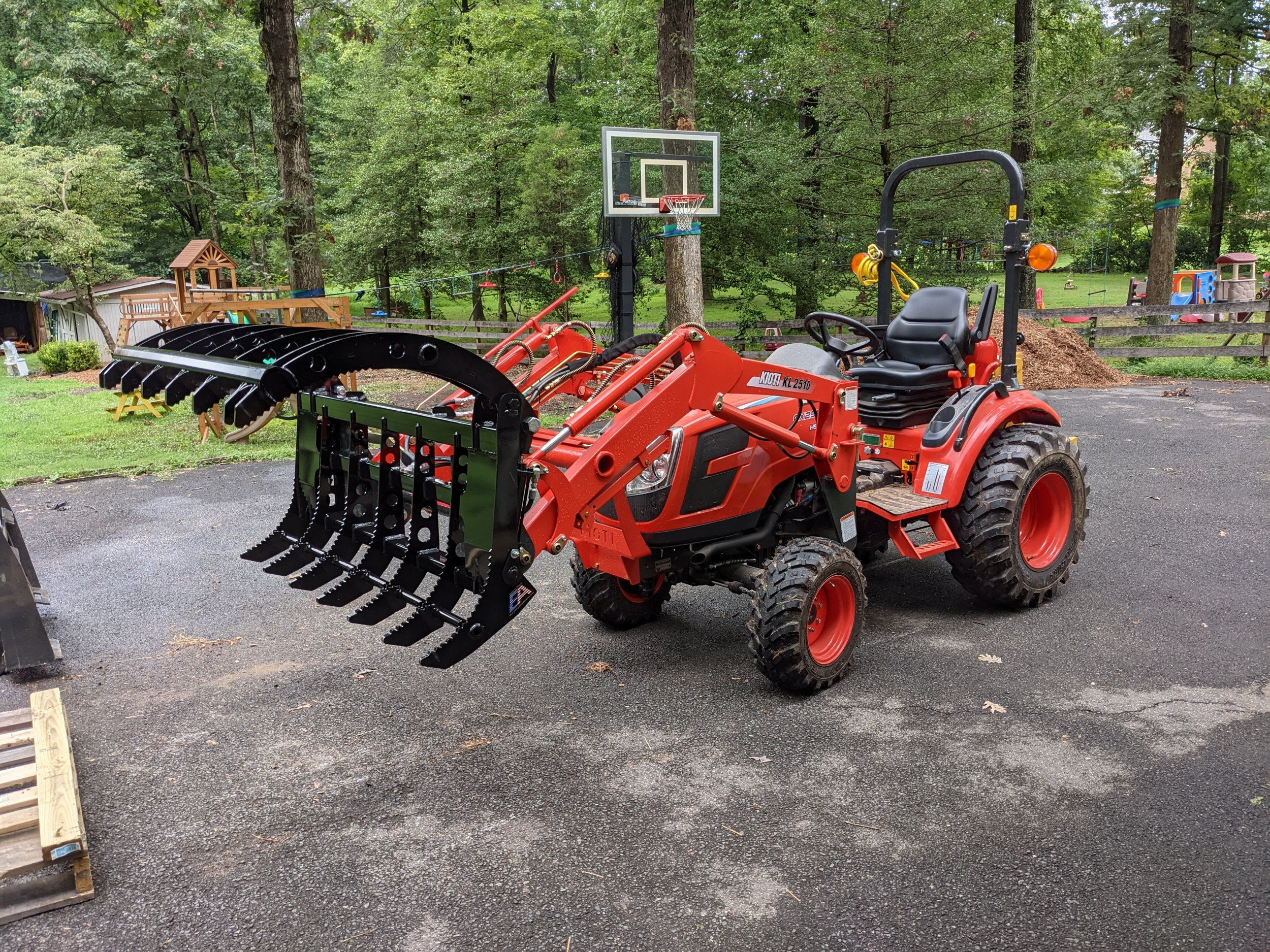

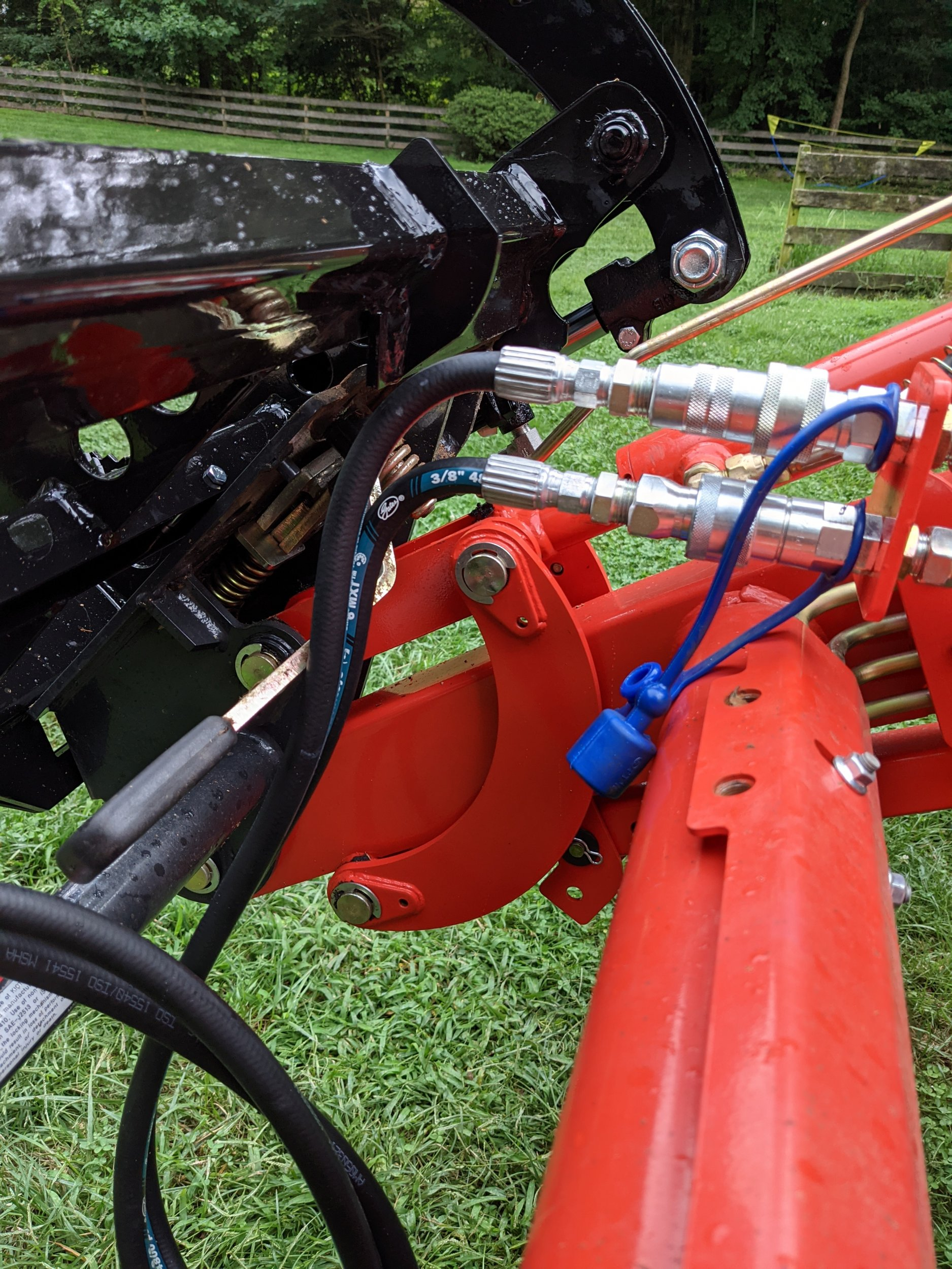

Finally got my @EverythingAttachments 55 Wicked Grapple. It's badass! The only thing I'd change is request EA install 90s on the end of the hydraulic hoses. The back of the grapple hits the hose on full curl back. The pic below is not at full curl b/c I don't want to wear out or risk breaking the hose. BTW, anyone know what thread size those adapters are between the hydraulic hose and the quick attach couplers? They look like different sizes, upper a little bigger.

Also looks like there's some white sealer in the threads. Is that specific for hydraulic fittings like this?

Pipe dope for hydraulic fittings. 2 schools of thought about using it though. I've always used it as a lube to get that extra bit of thread engagement, others say its not necessary and can get in the line and plug things up. IMO that only happens if you are sloppy with it. Just a little smear a thread or two from the end wont get in the lines.

I use Loctite 545. No worries about it getting into the hydraulic system (like other stuff). Seals well: I've never had a leak when using it.

Looks awesome, man!
The threads coming off the hoses are 3/8" NPT with 1/2" NPT thread adapters.
If you give me a call, I'll be glad to send ya a couple of 90s.
