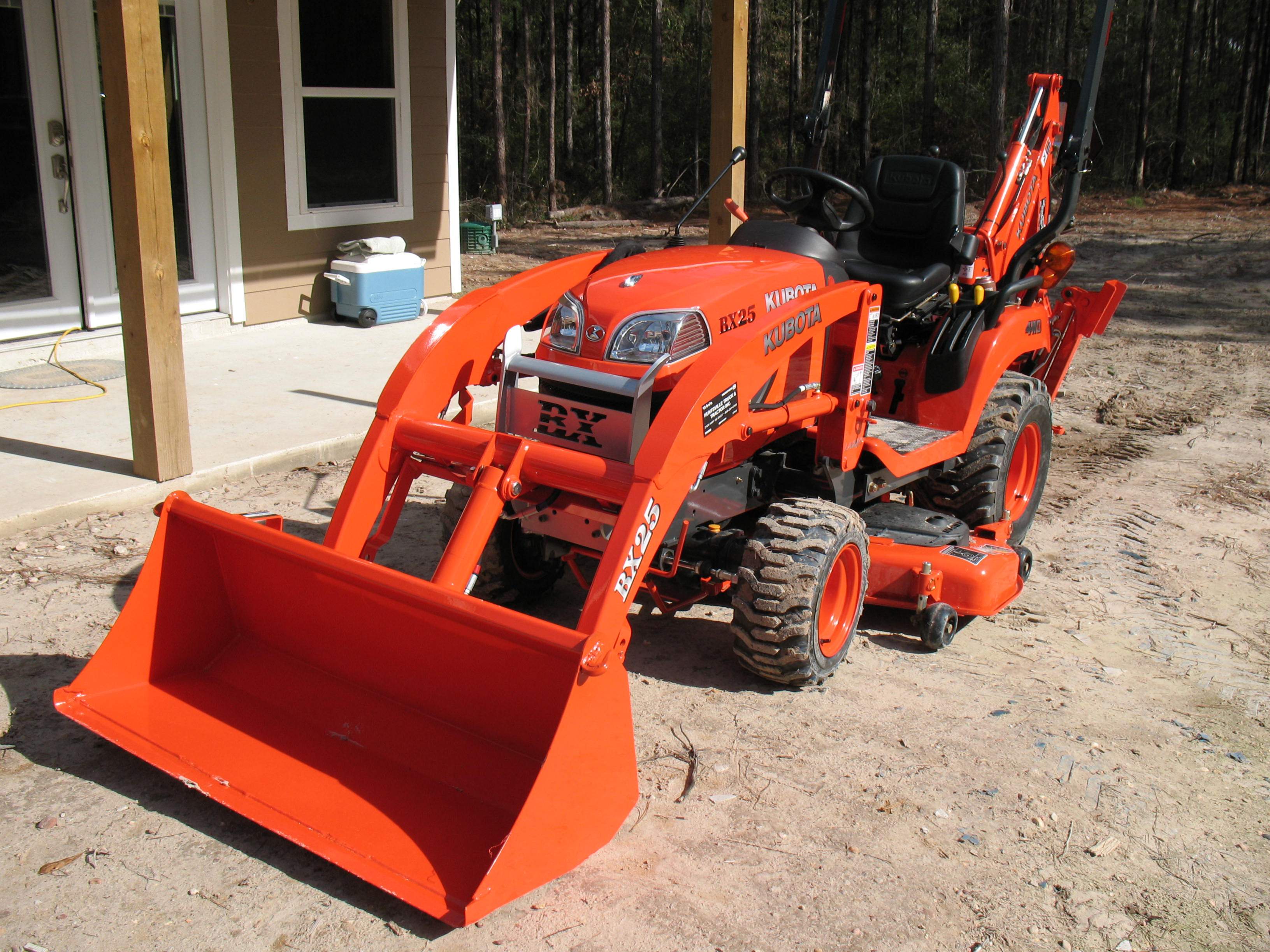

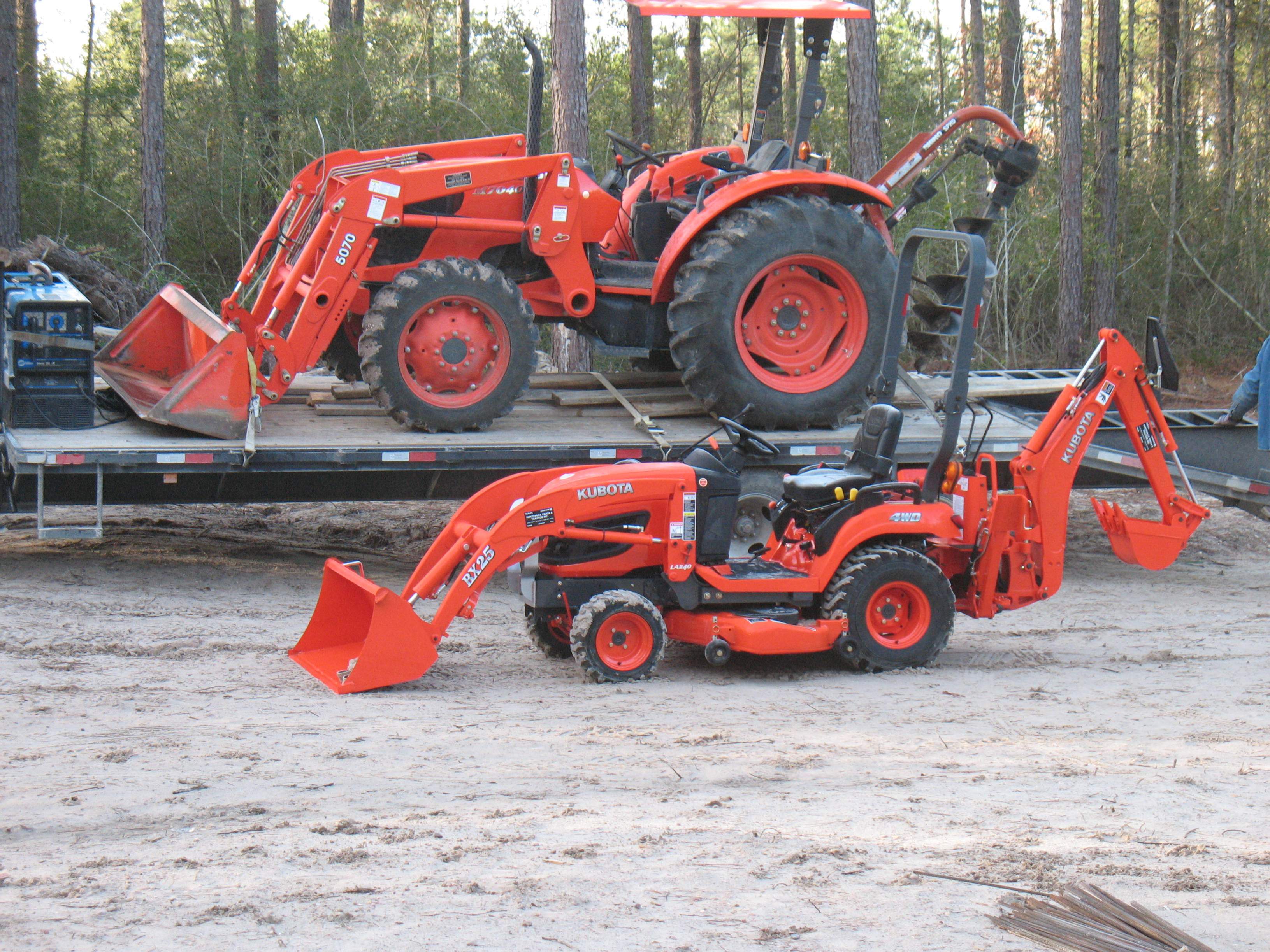

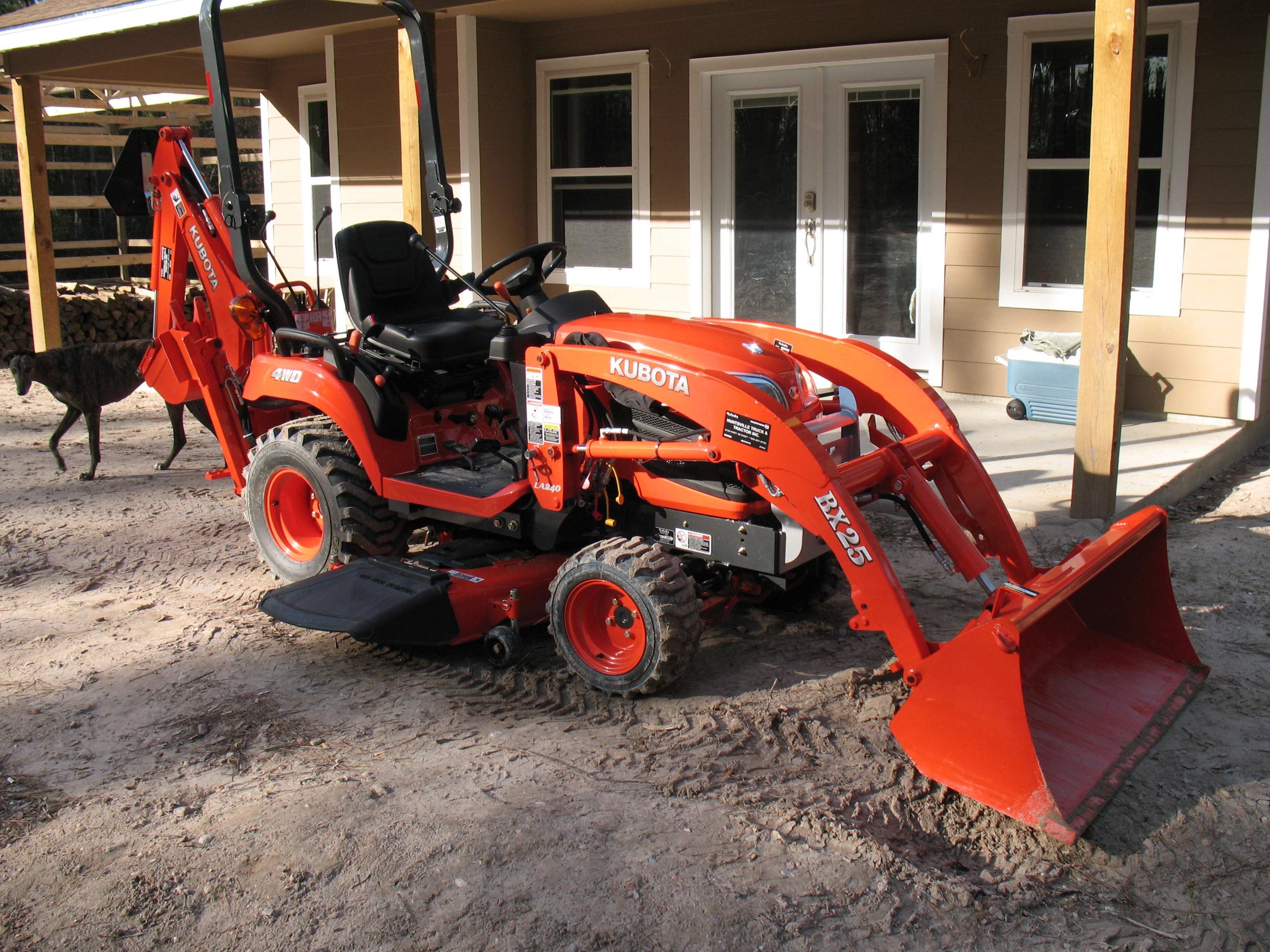

Well the new little baby has arrived! Here she is with her "Big Momma"! Not mine - the contractors. You should be able to see the chain hooks that the dealer welded on the FEL. As posted elsewhere - all the little issues with the BX24 have been fixed. No jerking stops with the HST. Loader and BH both work at idle (slowly of course - but they do move). Seat swings around for BH use pretty easily and is comfortable. Fenders and hood are all metal now. So far everything seems to work perfectly and I'm very pleased with her. I'm taking it easy until I get her broke in but sure seems to have plenty of power to do what I need. Will post a thorough evaluation once I've had a chance to really put her to work. Happy New Year everybody!!!

That was the dealers decision. Not sure of the reasoning behind it.
/ New BX25LB-R #31
I find that somewhat odd with hooks on the side. IF you need to go into places and the hooks are in the way then what ? I would ask dealer if he can modify the hooks location for you since they didnt ask you where you wanted them.
/ New BX25LB-R #32
I agree with moving the hooks. I don't want to think how much brush mine would have caught if mounted like that. I also like being able to get the bucket in close to walls etc. Those hooks would be scratching siding badly in my hands...
/ New BX25LB-R #33
i agree they are in a bit of a weird place. but....
1. i can't think of really any situation where the would have stopped me from doing the things i have done with my bx24 JUST because of the location.
2. you really need a way to lift from the center of the bucket. i have had loads the bucket could lift but the back of the tractor couldn't hold down. it is scary when you have all the weight lifting on one side of the bucket and the opposite rear wheel starts to come off the ground!
3. if you didn't specify where YOU wanted them, and the dealer put them where he thought they should go, you don't have much room to argue. they might change them for free just to be nice, but my experience is the dealer is there to make a profit just like everyone else. the first stab at the job is free, after that and the sale is complete, they need to get their shop rate to keep the doors open.
that said, you could easily add a center hook or d-ring with a welder or a drill and some bolts. there is a perfect, reinforced area for a small d-ring right where the middle cylinder connects to the bucket. i found a small ring rated for 1,200 lbs that far exceeds anything our tractors could lift.
if they bother you on the sides, just grind 'em off.
