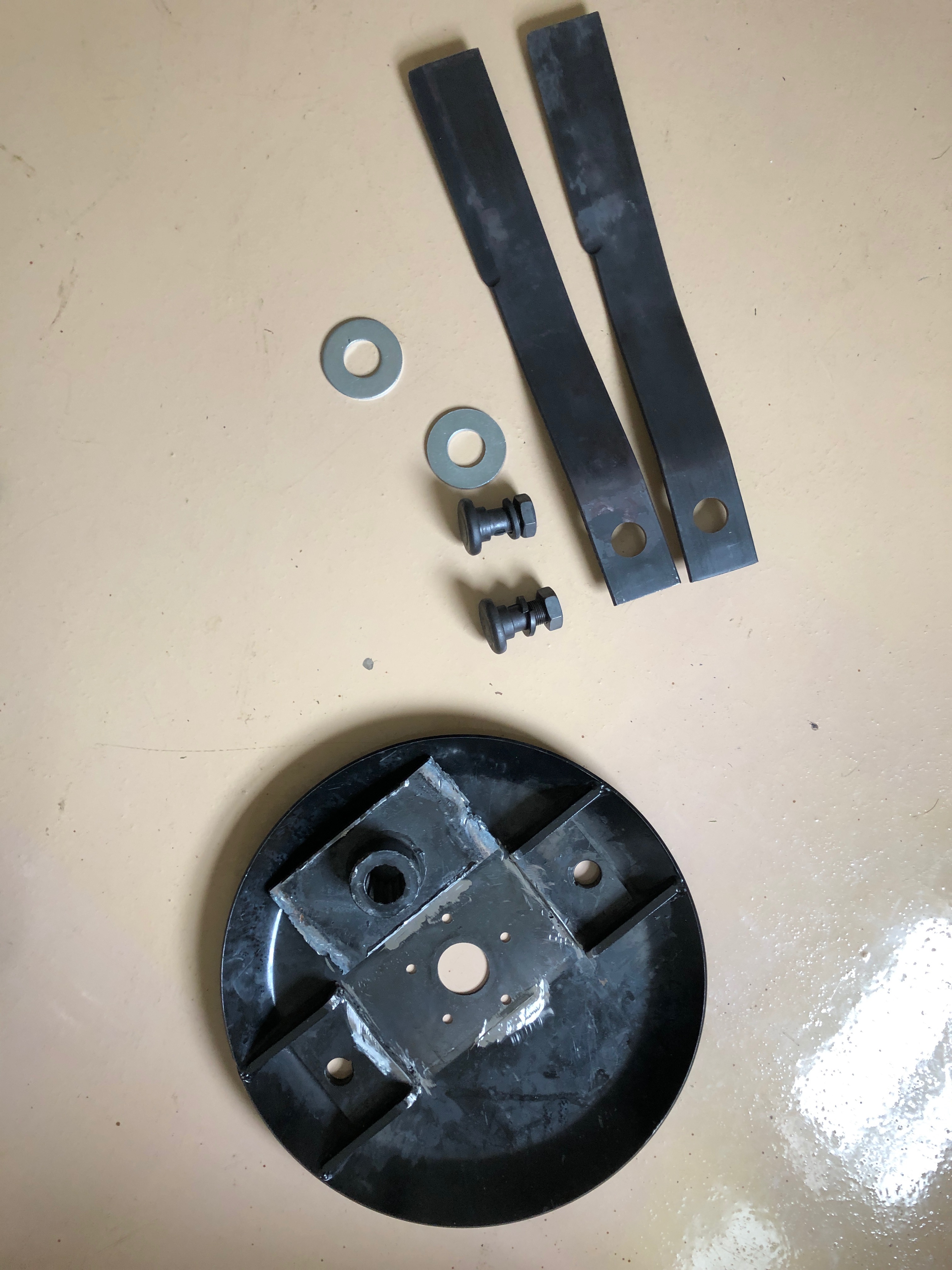

Here it is, and it works well too. I bought the pieces from different places. The stump jumper I got on eBay, the bolts I got down the road at a farm supply retail store, and the blades I bought off of Rotary Cutter Supply.

Very well done. So on the jumper / spindle. What is the third hole / pipe? I get the two blade holes by that third thing. Doesn’t it cause a balance issue? Also is the 1430 just a single spindle? My deck has 3

I cut the reinforcement steel in the middle of the stump jumper out so that I could have the flat surface on the stump jumper for mounting it to the spindle/hub. For the picture I just layed that chunk of steel there. I balanced the stump jumper, but there is a small amount of wobble, and I think that the ring on the bottom of the deck is the issue, because one end of the ring is about 3/16 lower and is slightly catching the blade bolt heads when it痴 spinning.

Great job! How did you get the five holes transferred?
So, how does it cut compared to the prior design? The blades look a lot heavier than the PT blades.
