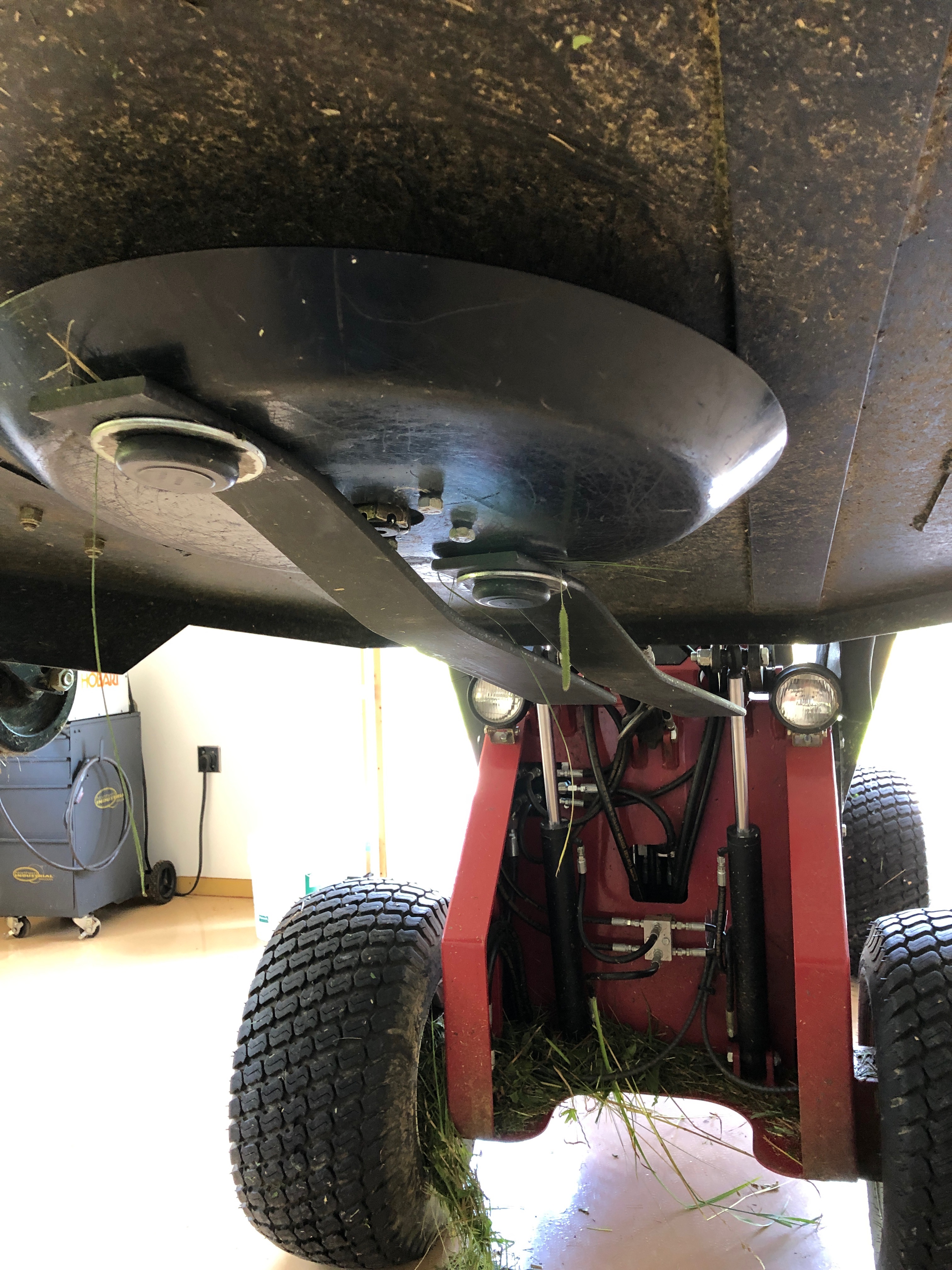

Here it is, and it works well too. I bought the pieces from different places. The stump jumper I got on eBay, the bolts I got down the road at a farm supply retail store, and the blades I bought off of Rotary Cutter Supply.

Very well done. So on the jumper / spindle. What is the third hole / pipe? I get the two blade holes by that third thing. Doesn’t it cause a balance issue? Also is the 1430 just a single spindle? My deck has 3

I cut the reinforcement steel in the middle of the stump jumper out so that I could have the flat surface on the stump jumper for mounting it to the spindle/hub. For the picture I just layed that chunk of steel there. I balanced the stump jumper, but there is a small amount of wobble, and I think that the ring on the bottom of the deck is the issue, because one end of the ring is about 3/16 lower and is slightly catching the blade bolt heads when it痴 spinning.

Great job! How did you get the five holes transferred?
So, how does it cut compared to the prior design? The blades look a lot heavier than the PT blades.

Thanks. The job went fairly well. I done the hole layout, but found out I didn't need to. The machine shop I go to has a tool for making centrical hole patterns . I couldn't get the hub off of the spindle for laying out the holes, even with a really large 3 arm puller and a impact wrench. I know heating it is always an option, but heating up that spindle / seal wasn't worth doing. So, I used that stock drum with the five holes to make the hole layout.
The blades are heavier. They are 3/8" material, the same as the PT stock blades. Do you know if the PT blades are tempered? I took a file to one of them to test if it was tempered and it didn't seem like it. It was like filing mild steel. These new blades are definitely tempered.
The stump jumper is where the weight is. It's much heavier than the stock drum, so there is allot more mass swinging around there, for sure. As far as how it cuts compared to the stock set up, there is a difference. It has a different feel to it when your cutting. It takes out 1 1/2" trees no problem, and cuts down thick field grass like nothing.
