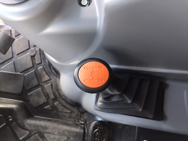

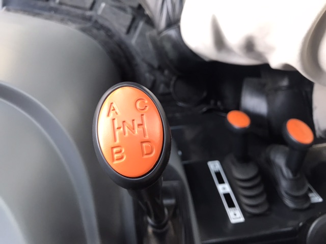

Is the range transmission synchronized- can it be shifted while moving?

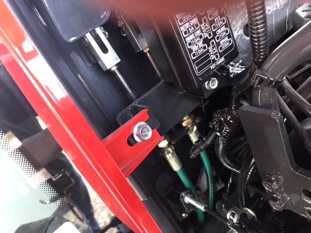

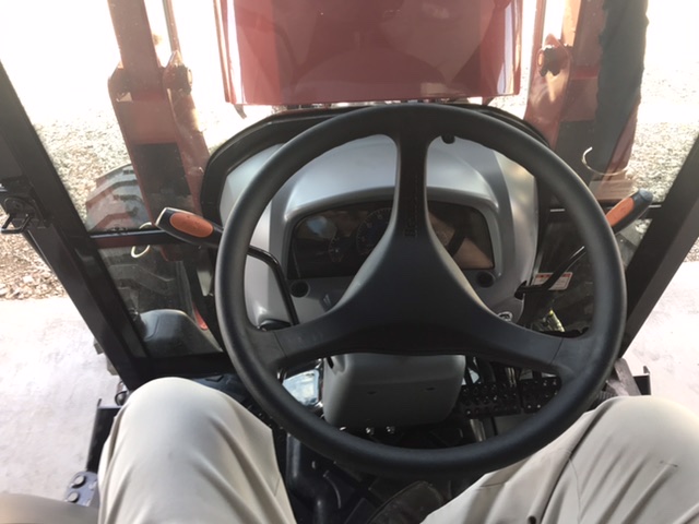

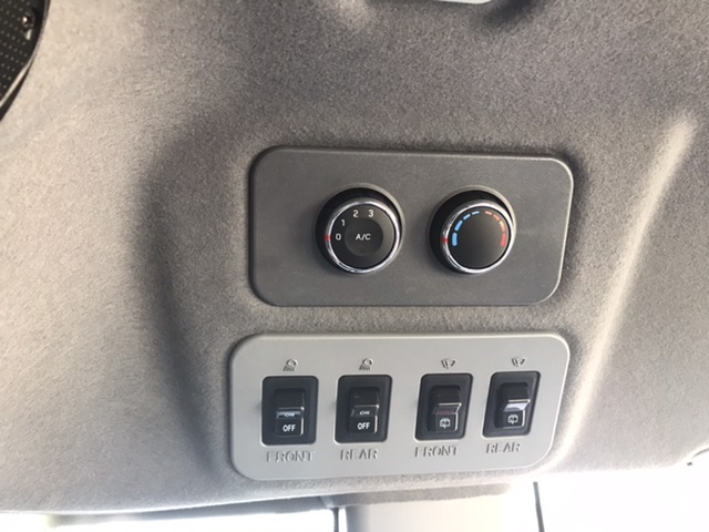

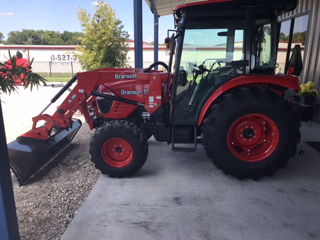

Okay, I stopped and checked out the new 5520C and have some thoughts. First I will say it is a very nice tractor with a lot of added features that should perform well.
The price point is around $33,000 for Shuttle cab and around $35,000 for HST cab.
Eric, I drove the tractor and the range transmission is synchronized. It is a H pattern shifter that is comfortable to reach.
The cab had plenty of room and is very comfortable.

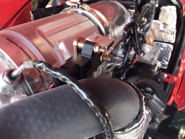

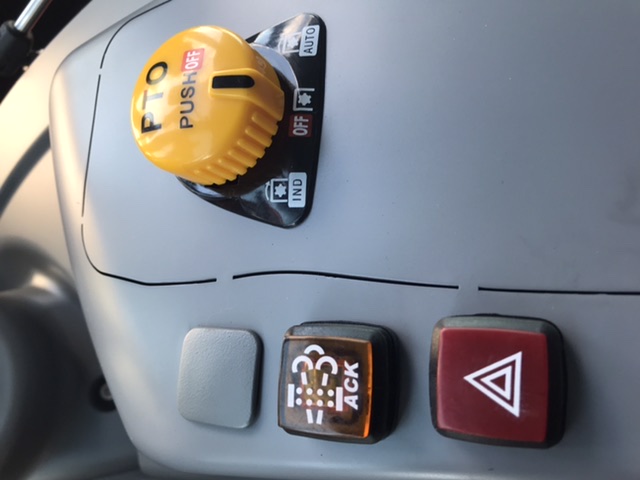

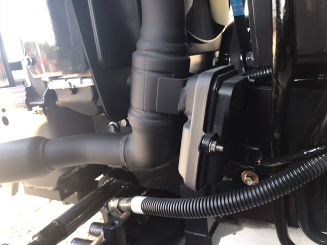

Now I will give you my take on how they are doing the regen. This is a theory as they have not released the service bulletins yet. There is not a computer control module that I could find anywhere. It seems to be using the data recorder as the triggers to let the operator know a regen needs to take place. The DOC is the same setup as it has been.

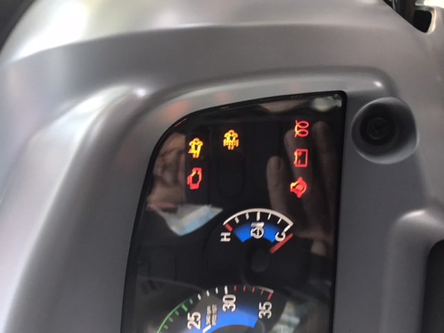

The operator gets the light telling him to regen so he parks the tractor, brings RPM up to high setting and pushes the regen button.
Then he lets it do it's thing. The button activates a butterfly control motor located on the tailpipe just before the last turn. This would restrict the exhaust some holding heat in the filter allowing it to get up to the proper temperature. It would remain closed or maybe even modulate to maintain somewhere close to whatever temperature they deemed necessary, until the exhaust pressure differential gets back in line. Then it would go back to normal operation.
Again, I do not fully understand the process but this is all I could come up with. Maybe y'all have a better idea. :confused3:

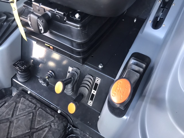

The only thing I did not care for is how everything is cable controlled. Loader valve, rear remotes, clutch and brakes all cables. I personally prefer mechanical linkages. This is the brake cable.
Hope y'all enjoyed this review as much as I enjoyed checking this beast out. My wife might shoot me but man I would like to have one! :laughing:

Thanks for the great review K5. Is that the Differential Lock heel pedal that's black on the right side of the operators station?

Yes Sir Bob, that is the differential lock. Not sure where it will be located on the HST model.

Synchronized range gears it's not something you'll see very often. Nicely done Branson.
That's an interesting approach by Branson on increasing the exhaust temps for a regen instead of using an injector to spray extra diesel like most systems. Time will tell how this works but by the looks of it, it still might be a standalone unit, easily removed if needed.
I wonder if it's a manual system or if it will work automatically as well. I can see a lot of people just skipping the regen and having troubles in the future, if it's only a manual operation.
/ New Branson 5520C #12
Ptsg, I don't know brother if it is automatic or not. We did not understand how the thing worked as we were looking at it. It wasn't till I studied the pictures a bit that I came up with my theory. Again, I may be way off base on this one. Lol
If you think about it, as the exhaust closes off, the engine would naturally get richer because of the decrease in air flow. It might be enough to pull raw fuel through the exhaust valve into the filter where it could burn. I have never fully understood the approach of using fuel for burning off a filter. Seems to me it would just create more carbon. I would think you would want things to lean out. :confused3:

i will be aa completely manual regen system nothing about it currently will be automatic, there will be a light that will come on the dash when the tractor senses the filter getting full ( it does that now on the current models there just isn't a way to regen them) the light will tell you , hey it's time to perform a regen cycle, and yes it will be a slight increase in fuel consumption during the process but they went this route because otherwise they would have had to install a DEF system and computer control for that system and Branson has been adamant about no computer control on the tractors.
while i agree is is going to be a waste of fuel, i would much rather waste a bit of fuel then have to buy DEF and have those systems on Bransons equipment, i think Branson just decided the lesser of two evils was the best option so to speak, especially with the tier 5 emission regulations now in place in the US. Time will tell though how well this system works out, but i have been told by Branson all of their models that have emission filters will be eventually switched over to this style.

I wonder how you shift the synchro range transmission on an HST where there's no clutch? Yea I know you can do clutchless shifting by speed matching but that's not really a tractor operator type skill, and unless it's done right it's hard on the gears and synchros.

The way it appears Branson attacked this issue there should not be any more fuel consumption then when you have the engine set at high RPM. The systems that use more fuel have a way of injecting fuel into the exhaust. The fuel injectors on the Branson will deliver the same amount of fuel as normal.
The engine would be richer only because of the lack of air flow. This could result in some raw fuel to be pulled into the exhaust. I still am not convinced this would generate anymore heat that could be created by increasing back pressure in the filter.
I do not believe they changed anything in the DOC/DPF. It appears to be exactly the same as mine.
What I would like to know is if the gate valve adjust to maintain a certain temperature or if it closes to a predetermined setting. My guess is that it can modulate because the plug has 5 wires going to the valve motor. It would only need 3 wires to open and close.
It also appears that when there is an issue with the gate valve, you would have to buy a new tailpipe with the valve assembly. That probably will be costly. Then the question becomes how long the valve motor can last with the high temperature being produced during a regen?

Looks like the valve is basically a stepper motor. The Data logger or whatever will control the DPF, will adjust the valve as needed.
Regarding the durability of the motor under the extreme heat, the variable geometry turbos use the same stepper motor style to control the geometry without any issues. I think it'll be fine, plus Branson did put the butterfly valve the furthest away from the DPF they could without being visible with the hood closed.
/ New Branson 5520C #20
The same style valves work fine for the life of the vehicle in a sports motorcycle which has 180hp, and the valve is inside the fairing where it gets less air. A 55hp engine makes much less heat. Also diesels have cooler exhaust than spark ignition engines.
Branson already had a temp sensor on the DPF+DOC and the data logger reads it.
I wonder if Branson recommends a stopped regen (and monitoring it so you know when to turn it off) or its ok to work it during the regen. If the regens are just to deal with that small percentage of owners who have problems now, few people would ever need to do them.
