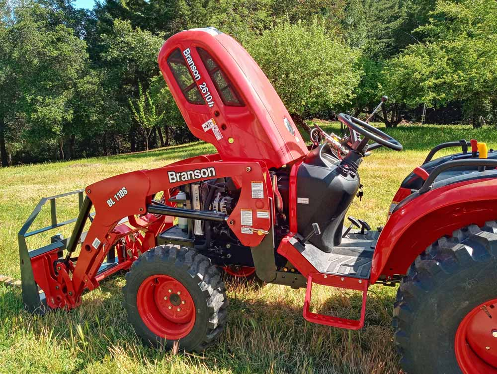

Last fall, I went looking for a CUT with HST for my neighbor. Something fairly new and low hours in the 2000-3000 pound weight class (naked) with loader. Slim pickens in the local used market.
So I got a quotation from the Branson dealer 100 miles from here, and got a price for a 2610h with FEL, BB, mower, and forks.

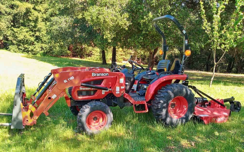

Here it is, delivered this week.

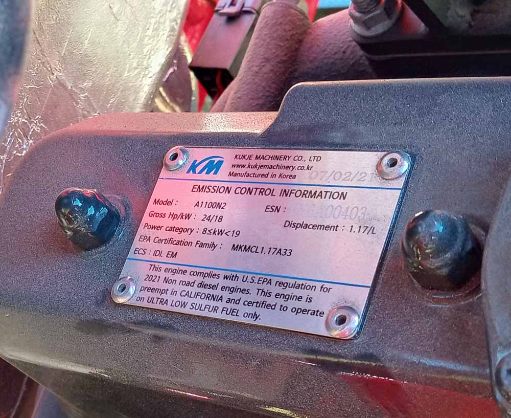

Runs quietly and drives very smoothly. Since this CUT only makes 24hp, no DPF or DEF. Simple mechanical FI, with heated intake. Beautiful red paint on steel fenders and hood.
Surprisingly, the 2610 has old-fashioned foot clutch and forward-mounted FEL joystick. And no split brakes.

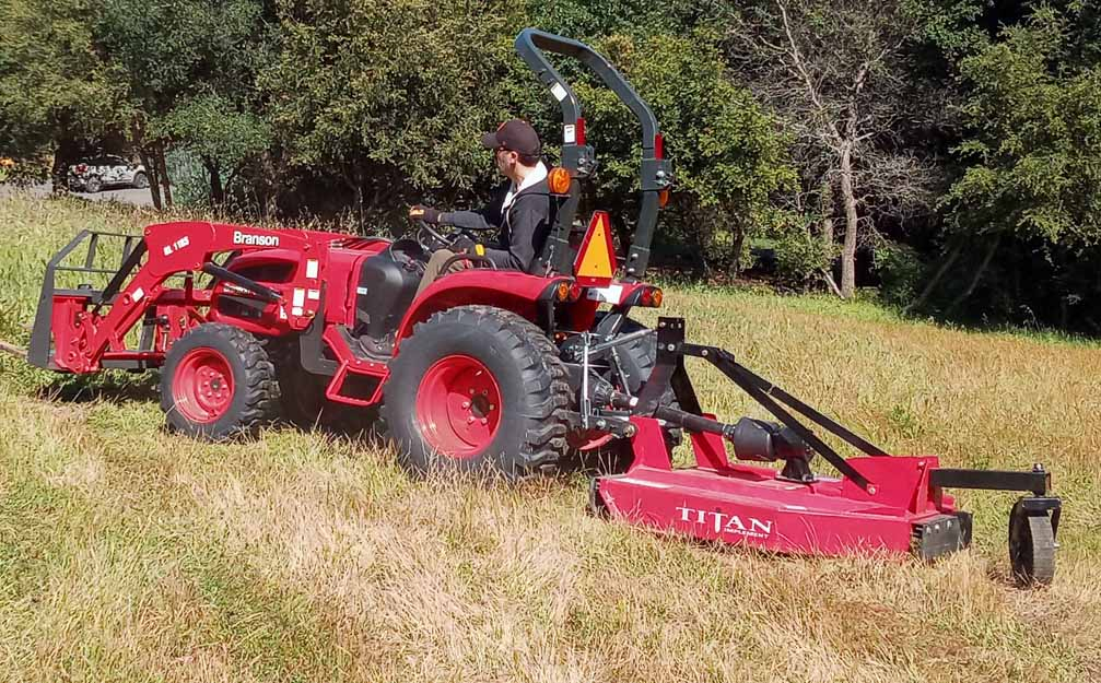

The safety nannies do allow the tractor to be started in gear, which is a plus. The seat presence switch kills the engine if you use the brakes while the PTO is engaged. That has to go.

Yeah, it did that for me as well. I and the new owner were testing out the mower when I discovered the seat switch issue. If I was not really careful how I rotated to look behind me, the seat would come up enough to kill the engine.
