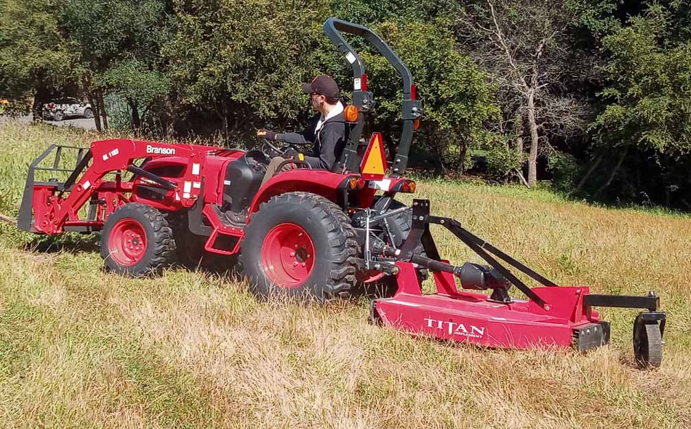

Last fall, I went looking for a CUT with HST for my neighbor. Something fairly new and low hours in the 2000-3000 pound weight class (naked) with loader. Slim pickens in the local used market.
So I got a quotation from the Branson dealer 100 miles from here, and got a price for a 2610h with FEL, BB, mower, and forks.
Here it is, delivered this week.

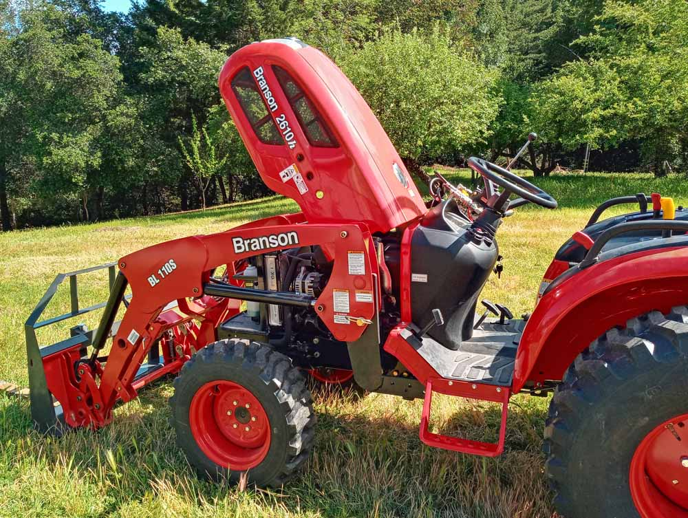

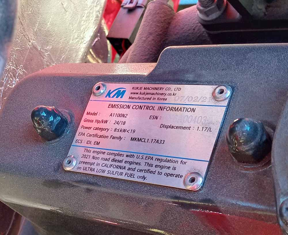

Runs quietly and drives very smoothly. Since this CUT only makes 24hp, no DPF or DEF. Simple mechanical FI, with heated intake. Beautiful red paint on steel fenders and hood.
Surprisingly, the 2610 has old-fashioned foot clutch and forward-mounted FEL joystick. And no split brakes.
The safety nannies do allow the tractor to be started in gear, which is a plus. The seat presence switch kills the engine if you use the brakes while the PTO is engaged. That has to go.

applying the brake causes the engine to quit sounds like a wiring error to me. On my 2400H applying the brake just activates the tail - stop lights. No interface with the seat switch that I have ever noticed. The seat switch was super sensitive on mine so jumper wire solved that problem on a permanent basis.
   / New Branson 2610h just arrived. Initial impressions.
I have yet to find a service manual for this tractor. (!)
Seat presence switch problem is due to when you push on brake pedal, your a55 rises up and kills engine when PTO is on. Not a problem if you are well-fed and larger than I am. I had the same problem with my new Bobcat CT230. Even worse, the Bobcat's PTO did not have to be on. Push brake hard and engine dies.
Most CUTs have parking brake integrated with the foot brake, making this kind of safety switch problem worse. The Branson uses an automotive-style hand-operated lever for the parking brake.
Seat switch on the CT230 had to be immediately jumpered to use the tractor.
