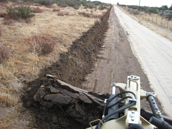

/ New Blade for 40 HP Tractor #2

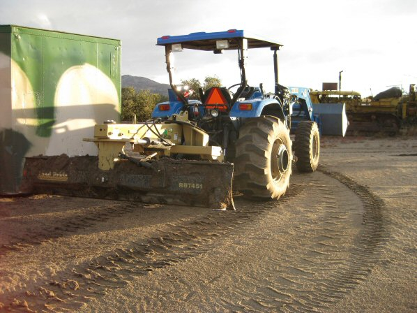

Land Pride RBT3596 or equivalent. I think that you will find that a 30* blade angle will still allow material to flow off of both ends of the blade. I find that 35*-40* works well depending on the consistency of the material (type and moisture content).
If you get the gauge wheel setup, you are about half way there to getting a land plane grading scraper.

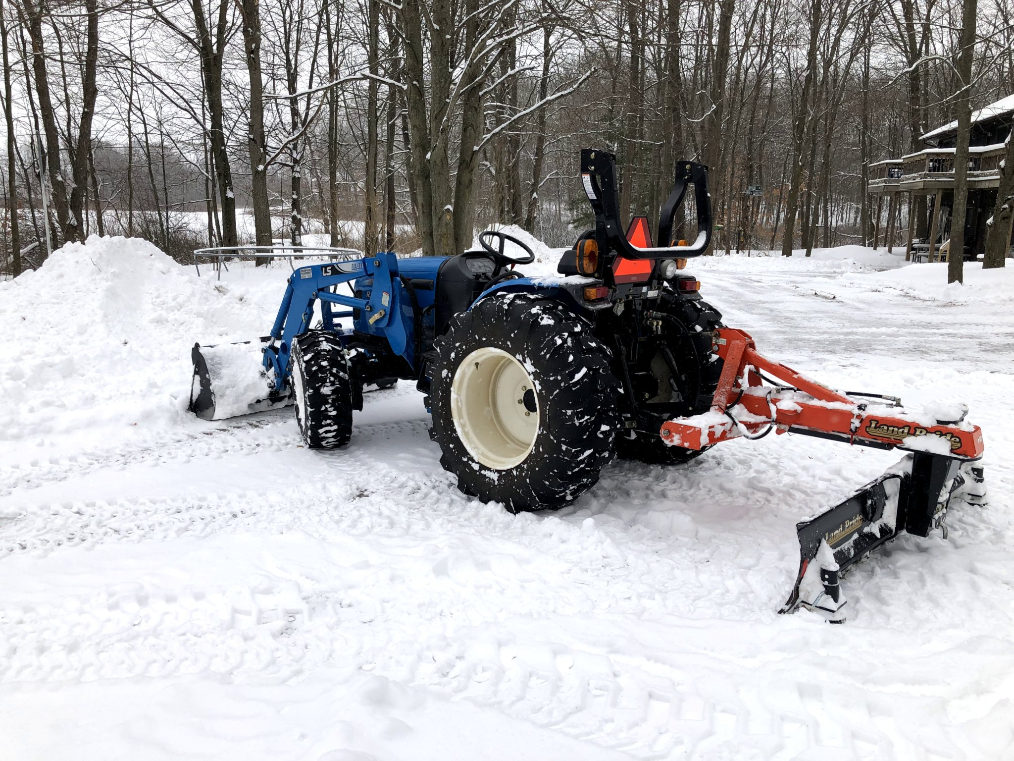

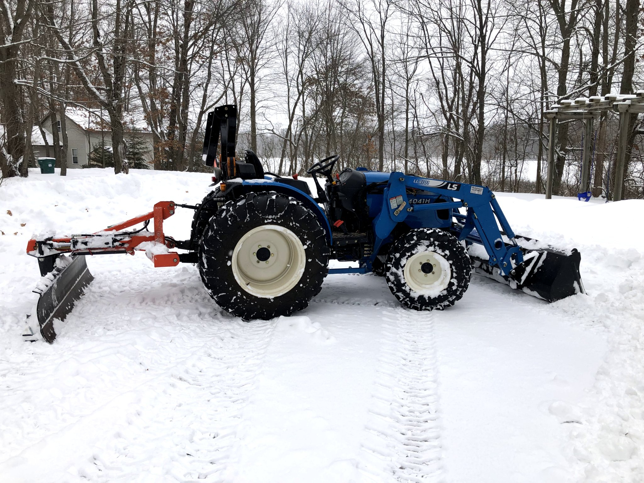

I have the Land Pride RB 3784 with hydraulic angle and skid shoes. Been a great blade for 8 years now, I use it mostly for snow plowing. To reverse the blade you could pop 2 pins out and move the cylinder to the other side
