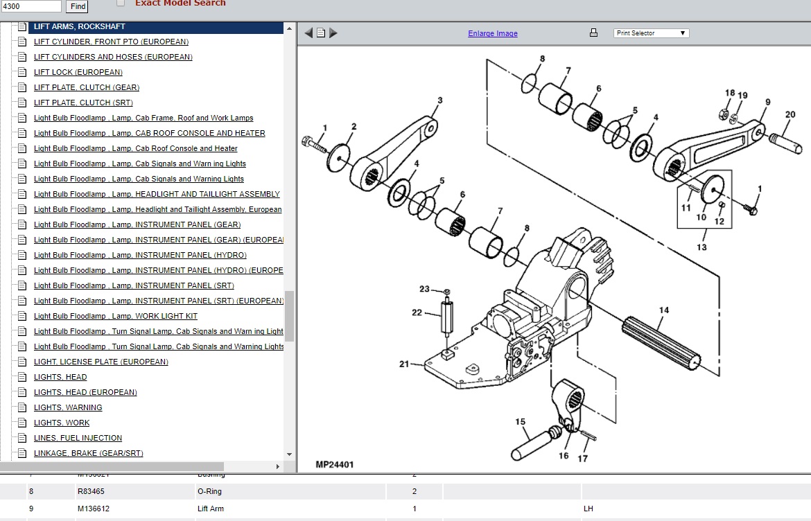

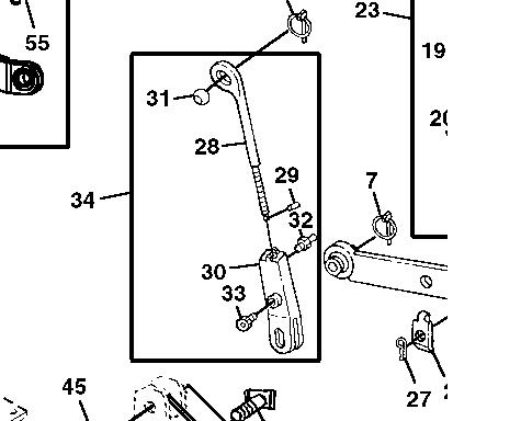

I think you mean the "lift link", and not the lift arm, as you mentioned it is "without the easy adjustment. Welding it should work, as seldom need to adjust that side from my experience.
Here is pic of the left lift arm. and of the left lift link.

Yes, sorry for the confusion. The link #28 in diagram broke right at the first thread. Why are they $250-300 for that part? WOW, they are proud of them.

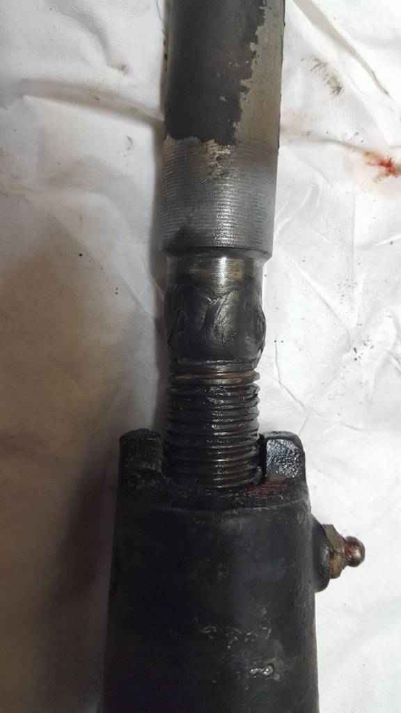

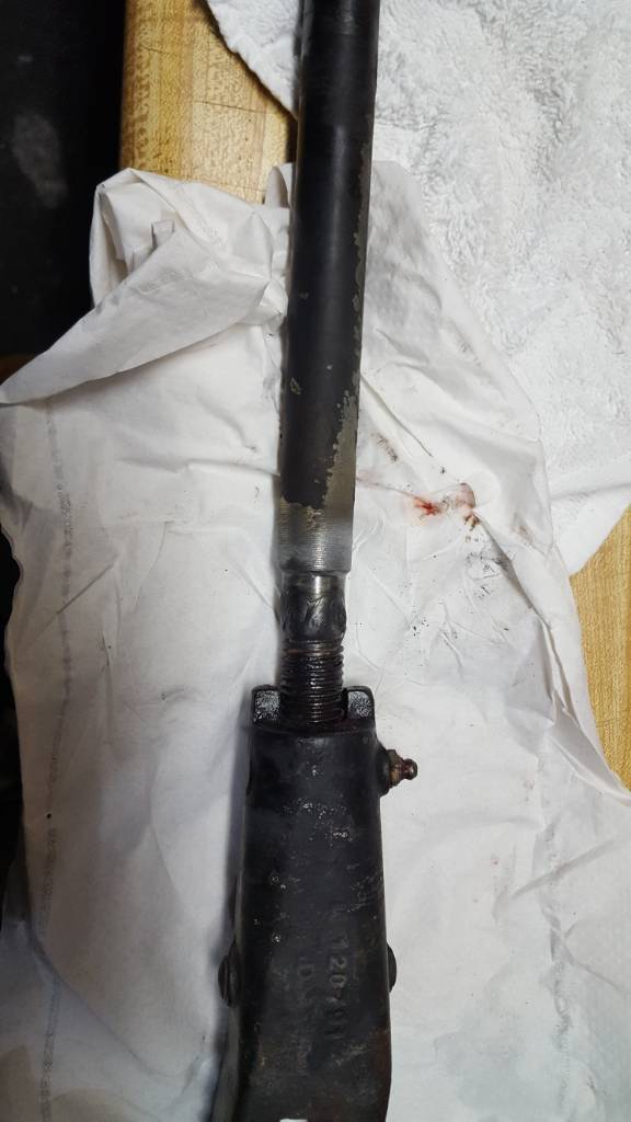

I busted a turn buckle that makes yhe5 connection of the top member of the 3 pt to the tractor-implement. Same situation and don't really know how I did it. One of those flukey deals. Welded it back together and still going today. That fix you got there just may out last the tractor.
