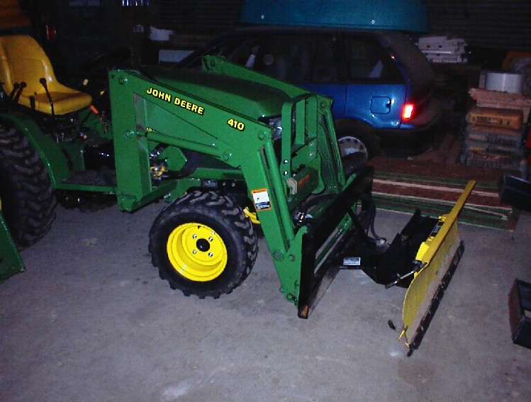

Here is a picture of my 4110 with a blade mount that I fabricated from my old 425 front hydraulic blade mount. It is the same blade that is used for the 4110 except that I made it work with the loader. I have an additional double spool for the hydraulics which I ran an extra set of lines out onto the loader frame. Everything is quick attach and I can go from bucket to blade or back in less than 3 minutes. One thing about the 54" blade is that the tractor could really handle something in the 60" to 72" range. My next project is either adding hydraulic wings to the 54" blade, or creating a new hydraulic V-blade.

Nice job on the fabrication! I assume you prefer to use the blade for plowing rather than the bucket?
   / new 4010 #18
The blade is much faster than the bucket, plus I use the rubber strip between the blade and the cutting edge to minimize the damage to turf. With the blade, when you start to pile your snow at the end of a pass you can automatically change direction (reverse), but with the bucket, you must first lift and dump. Plus with the ability to angle the blade on the fly, you reduce the amount of rework. Don't get me wrong, I love seat time just like the next guy, but when you’re out making a buck, time is money, and rework or spring time repair to turf damage is not adding to your bottom line.
