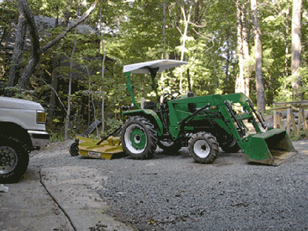

All Just got a new 224-LT today, she is really a nice tractor. It came with a FEL and 5'BH. I spent the afternoon learning how to use the BH on my mountainous land. It is a little spooky trying to go sideways I took it very easy and slow. I didn't mow anything I was not comfortable doing. It might have been a mistake getting the BH, I have a DR Field & Brush Mower that beats the hell out of me but I have never tipped it.
After reading several posts I turned the front wheels around to gain a couple of inches. Does anyone know exactly how many? I am planning on tackling the rears tomorrow, is it the same procedure as the fronts? I have weights on the rear, will they have to come off? How many inches will I gain from this? Also does anyone have any experience filling their tires? What material did you use? Water? Would you also give me the procedure for do this?
Thanks
Gavin in Charlottesville, VA

There should be a chart in your owners manual identifying the four rear widths. Depending upon which you select, it may involve removing the rims from the spokes. If you don't care whether or not this weights are inside or out, they don't have to be removed from the spokes.
Don't try this alone. It's a two man job. Jack up the tractor on very level ground. When you block the axle housings, keep in mind the inside of the tires will not be in the same position when remounted. Space the jackstands accordingly.
A lot of folks who've "been there, done that" will recommend against widening the front track when a FEL is mounted. Due to increased vulnerability of the front steering and drive hubs, I personally don't recommend it at all.
//greg//

</font><font color="blue" class="small">( You are saying that I should not reverse mount the front wheels due to overstress on front end? )</font>
I too have very steep acreage, mixed woodland, watershed, and pasture. Lots of rocks, tree stumps, critter holes, washes, ravines and the list goes on. I've had the all four wheels pulling/dipping/turning at the extremes of their geometry - with the fronts "right side out" the whole time. I've been in three wheel situations where only one rear is on the ground. When I engage the diff lock, the fronts take a lot of stress till both rears are back on the ground. I'd hate to think what might have happened if I'd have had them reversed - ESPECIALLY if I happened to have a bucket load at the time.
I'm not going to try and fake my way throught the geometry of this issue. But at the same time, I have visions of both front wheels splayed out under an overloaded front bucket. But FEL users quickly learn the capabilities and limitations - otherwise they end up buying new tractors too often.
The fact remains though, that reversing my rims would unnecessarily expose vulnerable front components to my 30 acres of rocks/stumps/holes/washes, often at speed. Therefore - I don't.
If you don't have an owner's manual, I can scan the appropriate instructions on rear wheel stance - and email them to you. Dunno how much you'll be working in wet conditions, but the widest stance puts most of the rubber outside the fenders. Throws a lot of water into places you may rather it did not.
If you've got a Jiffy-Lube or equivalent in your area, they drain customer anti-freeze into drums/tanks for recycling or disposal. Good cheap source of ballast that won't rust the rims. Assuming 6x12 fronts, you'll gain at least 37# per tire. 9.5x20 rears will gain at least 167# per. I had a local Goodyear store pump mine in for me. One 55 gallon drum will fill all four of your tires.

No problem Gavin. First lets consider the components of the rear wheel assembly. In the center is the hub. Next is the spoke plate, onto which the weights are bolted. Then the rim is bolted to the spoke plate, and finally the tire is mounted on the rim.
Note that the spoke plate can be mounted to the hub with either side out. Of the two choices, convex out is narrow - concave out is wide.
Note next, that the rim can be bolted to the inside or to the outside of the spoke plate. Of the two choices, inside is narrow - outside is wide.
When you consider that there are two spoke plate directions, and that the rims can be positioned inside or outside the spoke plate - you should be able to envision the possibility of up to four different rear wheel widths. Narrowest would be convex spoke plate with the rim bolted inside (950mm). Widest would be concave spoke plate with the rim bolted outside (1100mm). And two widths in between.
Word of caution. Tire lugs always must face the same direction. Depending upon which of the four combinations you choose, it might be necessary to move a rim/tire to the opposite side of the tractor. One last thing to consider is whether or not you want the wheel weights inside or outside.
Think ahead.
If pictures help, take a look at http://www.johnstractor.homestead.com/WideStanceJM.html
//greg//
