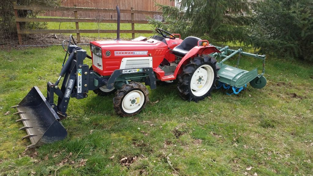

Hi all,
Just picked up a new to me 1610D and have a few questions. First tractor and first diesel so I don't want to screw it up. I have managed to figure out what everything does without killing myself so good start. Should have bought this a year ago when I moved. I hope to never use a shovel and wheelbarrow again!
I have already changed the engine oil and filter, dumped the transmission fluid (there was barely any) and cleaned the screen. Haven't found any issues yet.

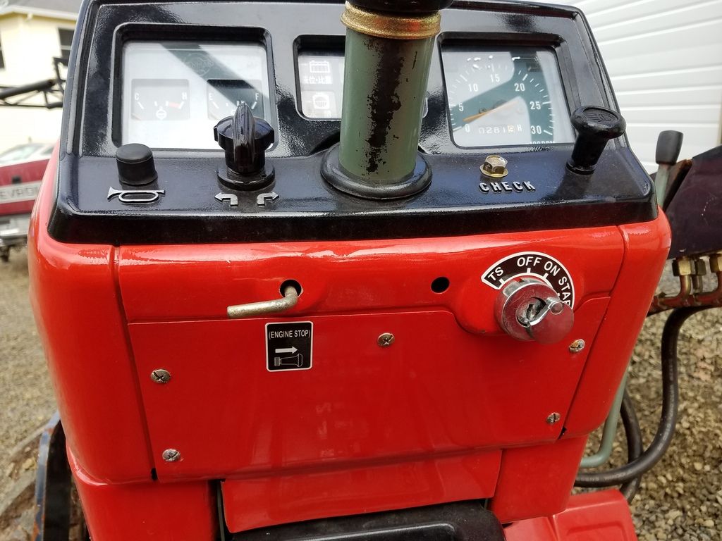

Second question is about the engine stop lever under the steering wheel. Should I use it vs pushing the throttle all the way forward? When I push my throttle all the way forward the engine dies. Normal?

Nice looking tractor! - Find a manual for it if you don't have one. I never use my foot throttle, Just there for an extra burst if you need it. The hand throttle does all of the work. Run the tractor with a bit more power (RPM) to get work done. You don't want the engine lugging down. A tractor beats hand work! - Nice tiller.

Sweet looking tractor! I just bought my first and it's a Yanmar too so we'll be on the journey together. I've used tractors for my day job for quite some time, though, and I've always thought that driving with the foot throttle is a bad habit you don't want to pick up. Don't ask me why. As tcreeley says it's there for quick bursts if the top of the hill is a little steeper than the bottom, etc.

It would be normal to kill your engine by pushing the throttle all the way forward. I believe the lever under the steering wheel is the decompression lever. It should not be used to kill your engine. When you use the lever it holds your exhaust valve open just a tad so no compression is developed. This is to allow a fast spin for cranking, especially in cold weather. Your starting procedure is fine. Might want to try use the compression release on cold starts. Some hold the compression release long enough for the oil pressure light to go off, a tractor in good shape might go off in 2-4 seconds.

I think my tiller is a little big for the tractor but I'll try it again once we are actually in tilling weather. Tried it out once and all I was doing was chruning mud and bogging the poor thing.
I think this thing was probably fresh off the boat because the paint is way too nice and the oil filter was painted on.:shocked: Seems to function fine so fingers are crossed.

Forgot. This is the lever under the steering wheel. I believe you are correct about a decomp. It is connected to a linkage on the valve cover.

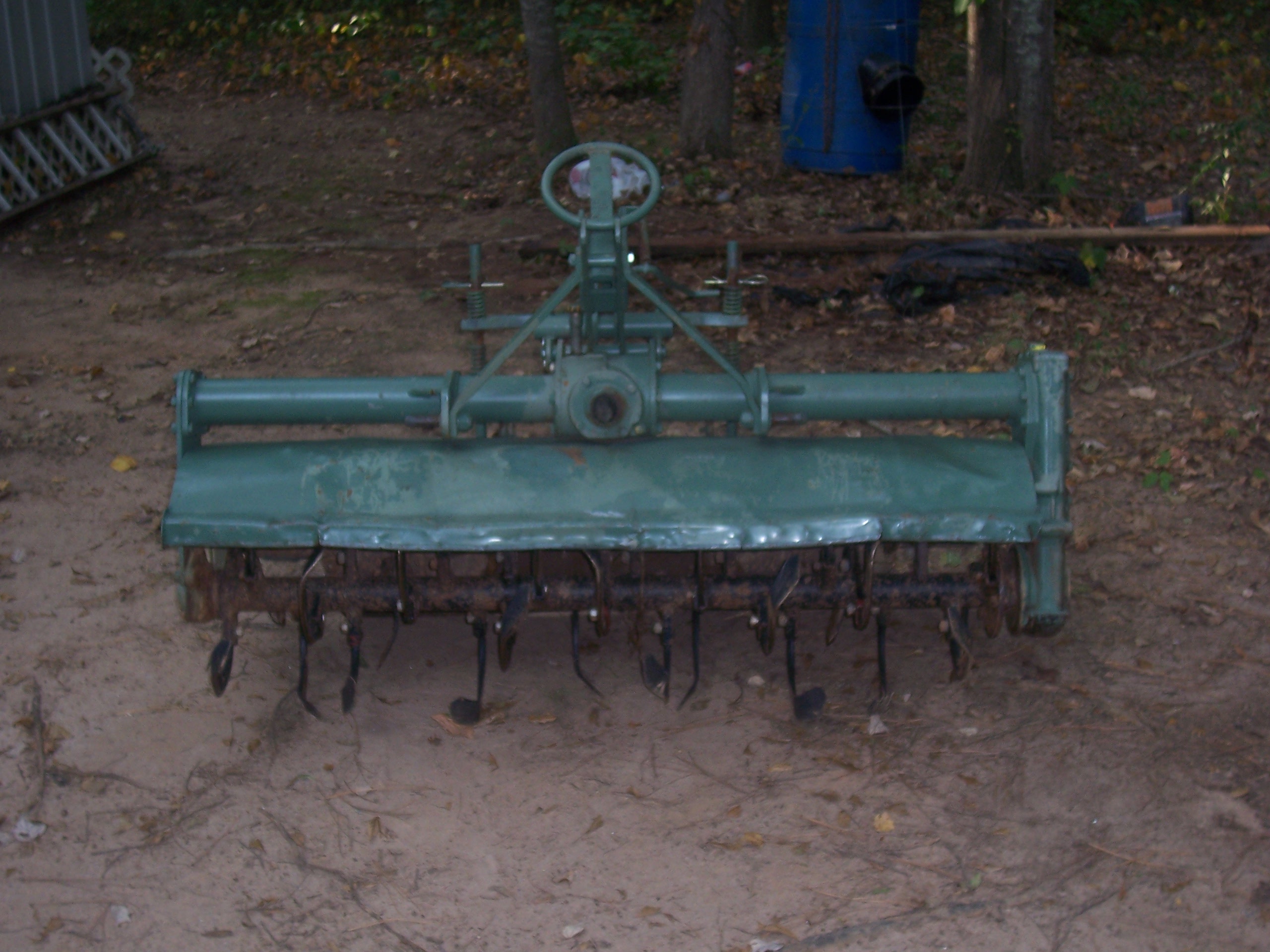

Yeah that is a lot of tiller. I'm 20 HP.@ the PTO and used a RS.1400 and it worked good except in fresh untilled soil and it was rough on it and slow going. But what I bought it for was a garden that was tilled with a walk behind. My soil is rock hard Ga. clay and if the soil was already tilled or broke it worked really good. This is the first turn of the year and the tiller is buried to the max. It won't go no lower and the pic. shows the results. With new tines of course and no Blk smoke. Yours looks in much better condition.

Might consider taking some tines off your tiller if it is to much for it.

That's the Decompression lever beneath the steering wheel. That Engine Stop decal on there doesn't belong there.
I've never seen a loader like that before. Brand name? Does it have a sub-structure to carry stresses to the rear axle when you ram into something?
