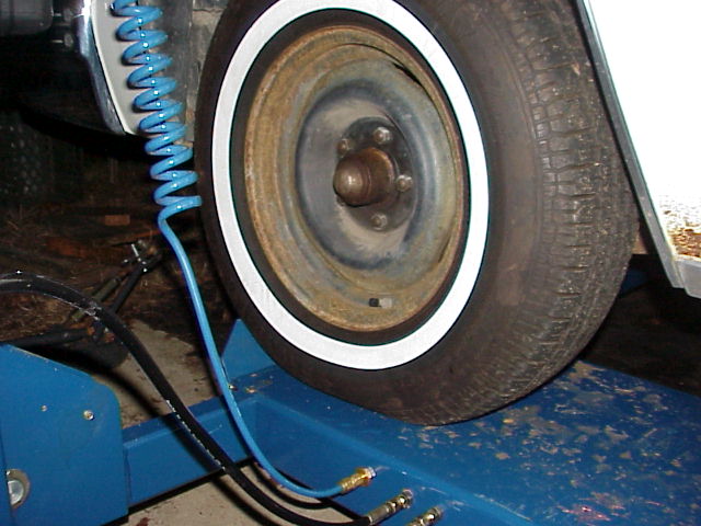

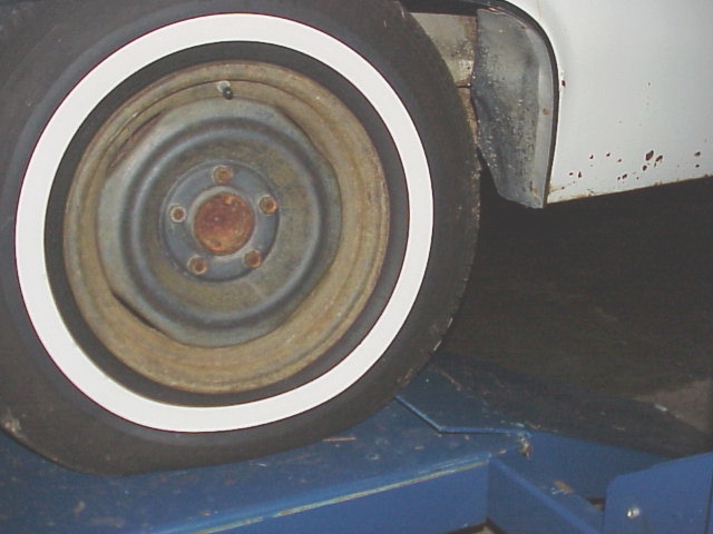

The runways are the full 164". I did add air to the tires, but it didn't make a noticeable difference. I have been trying to figure out how to get a few extra inches, and I think that I might have hit on a solution. The one important thing is that the tires fully rest on the runways, not any home made part. I am thinking of changing the front tire stops slightly so the front tires can move forward about 2 inches. I think that might be enough. I have also advertised it on Craig's List and a few other places. If I can bail out with a small loss, I will get the 2 foot longer lift.

I see two way's to fix this problem.
1) Either have the ramps extended at the front by a professional fab shop.
2) Make pull pins so you can remove the ramps after the car is on the lift. Then make up some simple roll off stops to replace the ramps with once they are removed. No ramps, no problems.

Guess I just don’t understand everything that comes into play. It sure looks to me like some pieces of 6” angle, some gussets and a new tire stop on the front would solve the problem. The tire would actually be centered more on the cross beam than it is now. I don’t think the extension would even be carrying any significant load. Certified welders that do on site work around here charge $35 to $45 per hour and would have it done in no time if you already had the pieces cut and the surfaces cleaned.
Have you considered calling the manufacture to see what they had to say about extending the ramp the small amount needed? They may have to him and haw because of liabilities but if the mechanics of the lift are the same as those used with longer ramps a certified welder can attach an extension as strong or stronger the rest of the ramp.

Dusty, would driving your tires over a 2 X 6 or a 2 X 8 lift the tires enough to clear these ramps?
