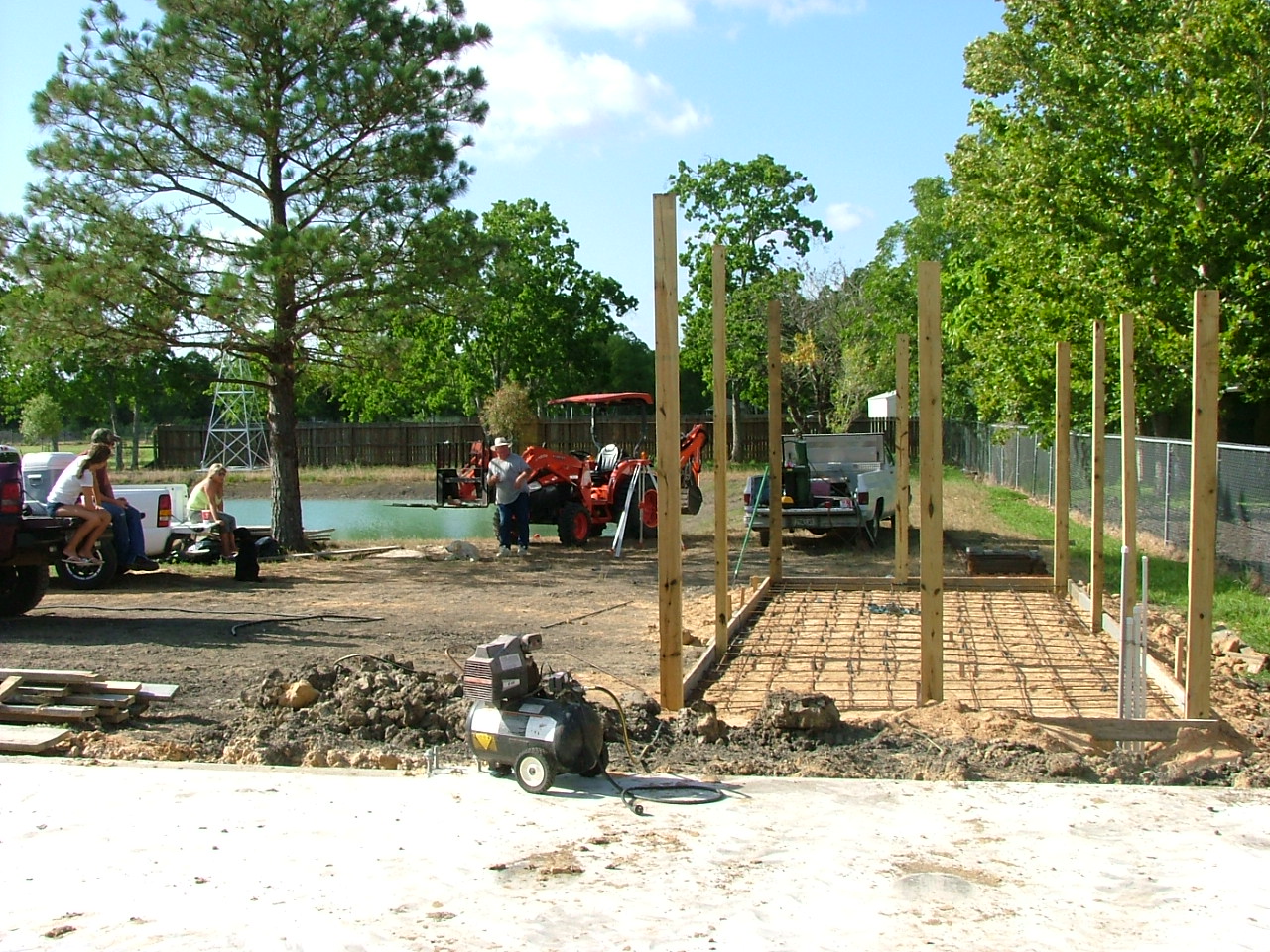

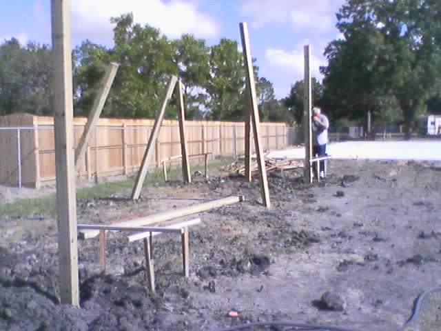

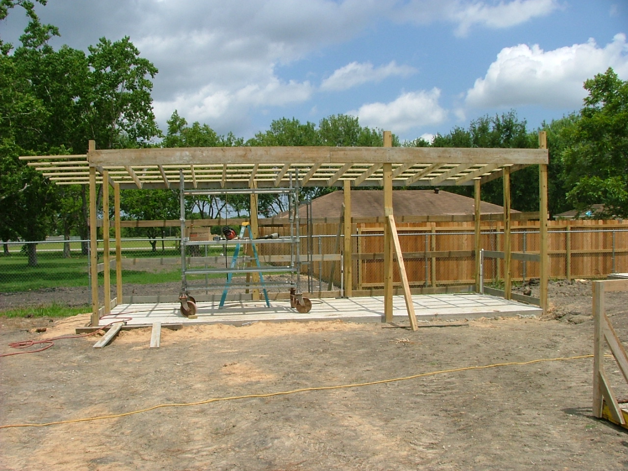

Well its been months but just realized I never posted any finished pics.. Well if I did I dont remember :(
Anyhow., Many thanks to all that help me with fantastic advice.....
BTW it made through 8hrs of hurricane IKE without any damage and the guys who skinned it left the bottom row of screws out and I had not yet put the diaganol braces in!
Chuck.
   / Needing some advice building a lean-to. #44
Great job there, Chuck. When you said "lean to" in the topic, I thought you meant something that was actually attached to another building, not a free-standing building. Anyway, looks great. If the water I see is a pond... I couldn't get any work done for wanting to fish!
