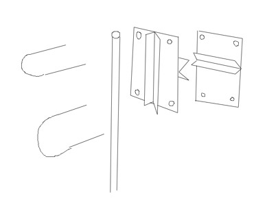

What I would do:
First, an old style machine/welding shop (not something full of CNC machines, with a floor you could eat off of) could make one that would work in a half hour or so.

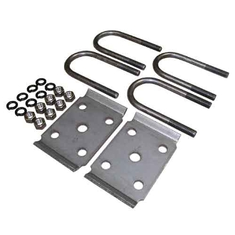

Second, I would try something like this if I needed to use as many ready-made parts as possible. Only a little cutting and welding is needed.
Buy a trailer axle U-bolt kit like this. 2 3/8 is a common size.
Discount Trailer Parts Direct-Shop U-BOLT TIE PLATE KIT 2 3/8x1/2 ROUND BLACK
On both plates, weld on one side a short angle iron parallel to the U-bolt holes, V-corner of the angle welded to the plate. This will clamp the tool bar.
On one plate, weld an angle iron on the other side 90 degrees to the first one. This will be the round shank seat. Or use half a short piece of pipe or pipe coupling instead of angle
Using all 4 of your hands, place a plate on each side of the tool bar, put the shank against the vertical angle, insert the U-bolts, and tighten the nuts.
