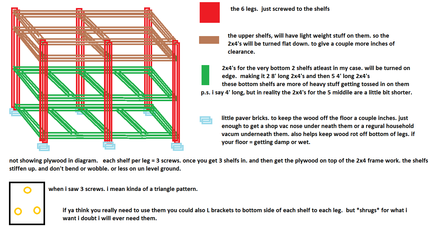

building my mom some shelves.
2x4 construction, with 4' by 8' 1/2" plywood
6 2x4 legs. (one on each corner then one in each center)
then each shelf. using a 4'x8' plywood. will require 2 8' 2x4's and 3 4' 2x4's ((i say 4' long but it will be like 3' 9" or ughs 3' 7" lengths i think that is right gotta double check width of a 2x4)
for the heavy shelves like the bottom shelfs. i will stand the 2x4's on edge. but for the upper shelfs that may only be 6" to 10" high. for the smaller light stuff. the 2x4's will be laid down flat. to get a little extra room.
i am just going to be using 1 1/4" screws for ply wood. and 2 1/2" to 3" screws for all the 2x4's.
4x8 shelves are rather big and basicly require you have access to both sides of the shelves.
i will be building some 2' by 8' shelves. and will most likely use same building techniques.
granted how i am building = less cuting of everything. but i could notch out corners of plywood. so i could put the 6 legs on the inside vs outside of the shelving. so i could have better support. but i could care less about that.
for basement, i would opt to get some paver bricks, and put under each leg. it raises the ends of the 2x4's up a little. and if there is a little water that ends up on the floor. there is less likely the 2x4's will rot up and got moldy on you.
that and having a couple inches off the floor. can allow you to get a shop vac hose up under them. to clean stuff out.
if you are not looking for full shelving from floor to ceiling. and just want a shelf or perhaps 2 shelfs near the ceiling. and you have either concrete block walls, concrete poured walls, or regual 2x4 or 2x6 stud walls for the interrior walls of the house/basement you can due some diagranal bracing and keep from having any legs going down to the floor. which result in saying placing a deep freeze below the shelfs or a coach or what ever else you might want to have below the shelfs.

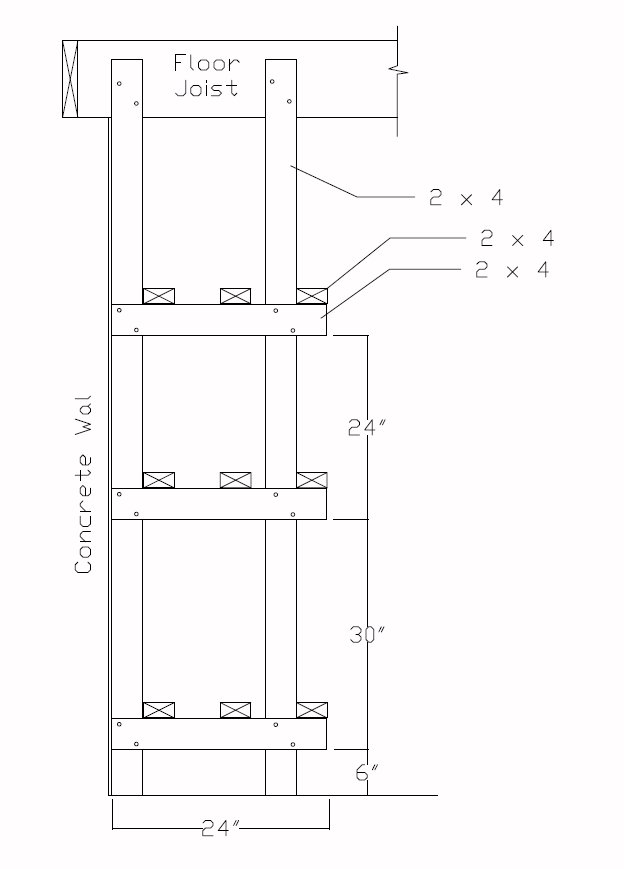

What I did was get a bunch of 2x4 and make some shelving.
9 pcs 2 x 4 x 10' - for shelving
6 pcs 2 x 4 x 8' - for uprights (or studs if cheaper and long enough)
2 pc 2 x 4 x 10' - for ledgers
I cut the ledgers to be 24" long.
I nailed the uprights to joists so they were 20" apart and nailed the ledgers on so there was a 3 5/8" cantilever to carry one of the 2x4s. I nailed a second pairs of uprights so they were on a joist a little less than ten feet away. I nailed another pair on a joist about half way in between. I then tacked the 2 x 4 shelves to the ledgers. There is space between the 2x4 on the shelves but most every thing will fit, especially boxes etc. I made the bottom shelve a little higher, just personal preferance. Verandah flooring would be plenty strong (as long as you don't put an engine block or the like on it). I actually carried on another ten feet so I have five pairs of uprights to get 20 feet of shelving.
I had 20 feet of room, thats why I went with ten footers, you could use a different lenghts if it works for you. Hope you can understand the drawing.

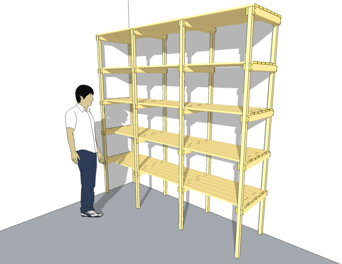

How about something like this? I have build several for my basement 2'x8' and 4'x8'.

diagram to go with my previous post.
just remember. if you measure from your armpit to your fingers. if that measurement is wider than the shelf. you are going to be a predicament. of trying to grab stuff that someone managed to get stuffed back into the shelving. witch exception you can access the shelving form both sides.
OK--so this is the one I'm thinking the most about. I already have lots of steel shelving and just want something cheap that has little residual value should I move.
How about I make this shelving out of 1x3 strapping and glue and staple it together? Uprights on a two foot center? is simple. repetitive cuts.
The 2x4's are fine but cost is an issue. It's not that I'm cheap but this is just for light stuff i want my wife to move anyway.
Thoughts?
