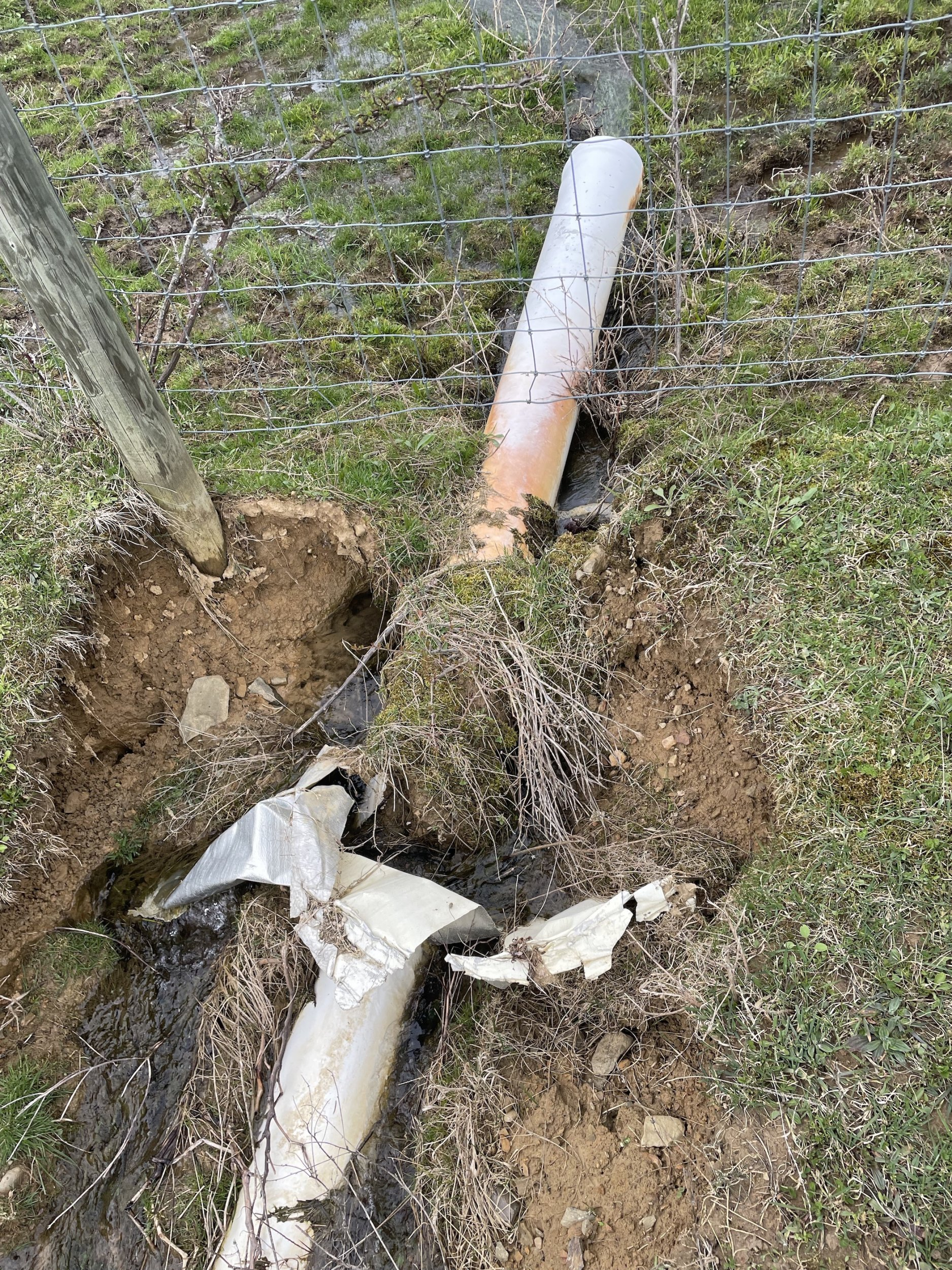

I have a problem with a small stream eroding away and need some advice on how to best stabilize it. I have 2 small pastures separated by a fence. The upper field has about an 18" pipe feeding into what used to be a small pond (maybe 15ft across). The water exited this pond through a 12" plastic pipe, underneath my fence and then dumped into what used to be a larger pond. The land bridge in between the two was only about 10ft max. The lower pond I drained years ago. The land bridge has eroded and I don't know the best way to stabilize it. I don't need a pond in the upper section but would like the stream to continue so the animals could have water in that field. I am going to try to add photos to show what is going on. If I could end up with a stream all the way through that would be fine. I seem to be having trouble with the pics....no matter how small I make them it says they are too big

so land bridge passe on top of the 12” pipe ? and the erosion is happening around the pipe ?

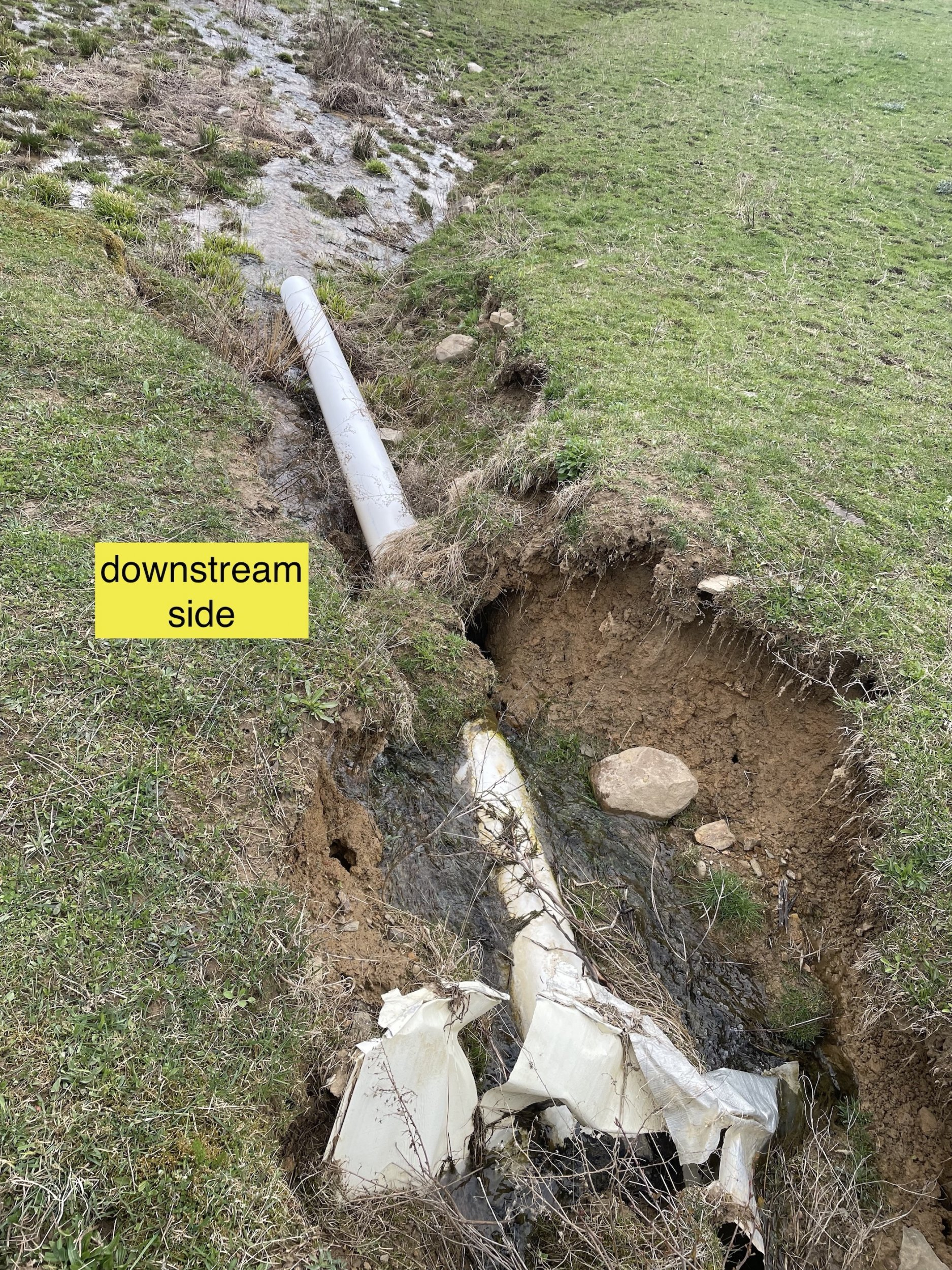

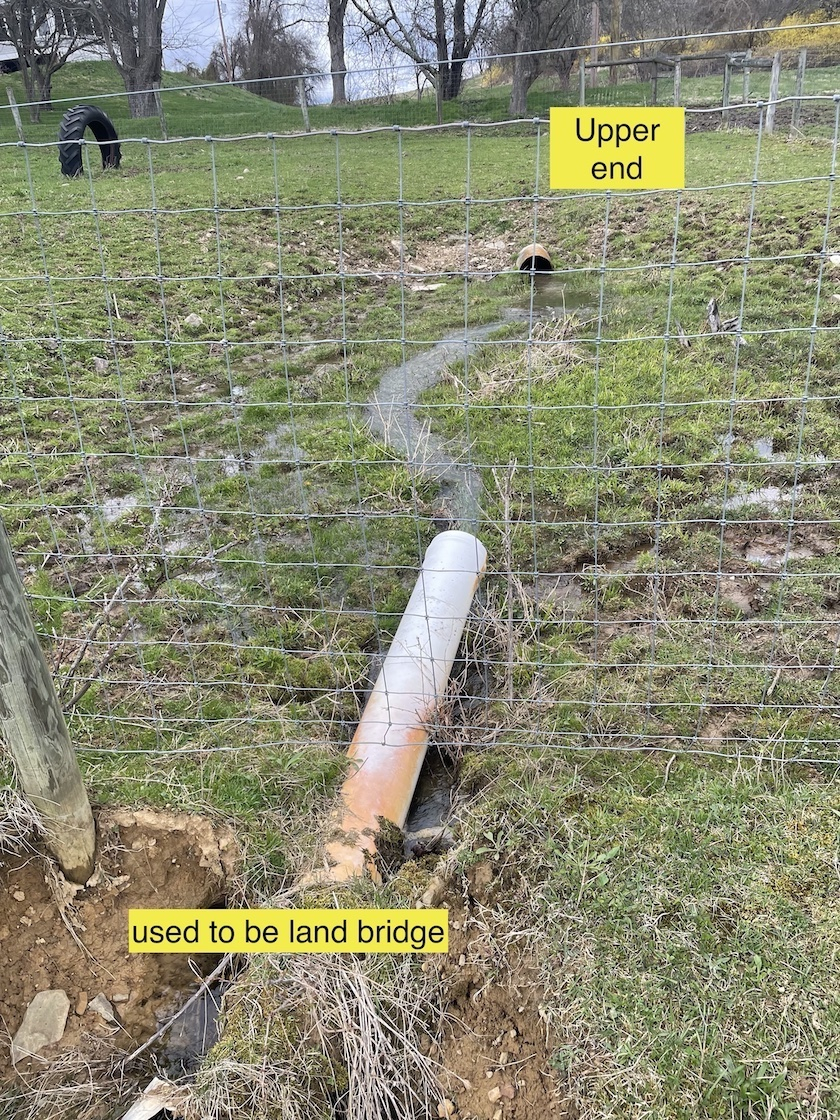

Ok, finally figured out how to upload pics.

It looks like the water followed the outside of the pipe.
Also with the inlet being above the natural grade you will get a lot of ponding before the water can start flowing in the pipe,
which does seem to be a bit on the small side.
You mention watering animals, are trying to water on both sides of that fence?
If so I'd say get a shallow water trough and put it in were the first pipe can dump into it,
then pipe the over flow under the fence into another trough for them to drink from.
If they can walk in that ground it will be all punched up and you will have little control of what the water does.

Generally, if you can flatten the side slopes of the channel, in effect make more like natural streams, where there's usually an area where water can temporarily spread out in heavy flows, plus add in native emergent-zone plants, bulrushes, bur reed, arrowhead, etc, you'll begin to get a handle on that erosion.
Bits of hard armoring can be placed at bends where washing is occurring, riprap type stuff. But be aware, when one spot gets armored, the force of the water is now directed at the point where this armoring ends.

#20
thanks for the replies. I do have animals on both sides. I will definitely put a larger pipe in with gravel at base and compact to rebuild land bridge. I like the idea of a drinking trough at the mouth of the other pipe. It would be nice if I can run the outlet of the trough into the culvert to contain the water. Are there any commercials troughs with outlets for a pipe? Maybe I can form one out of concrete?
